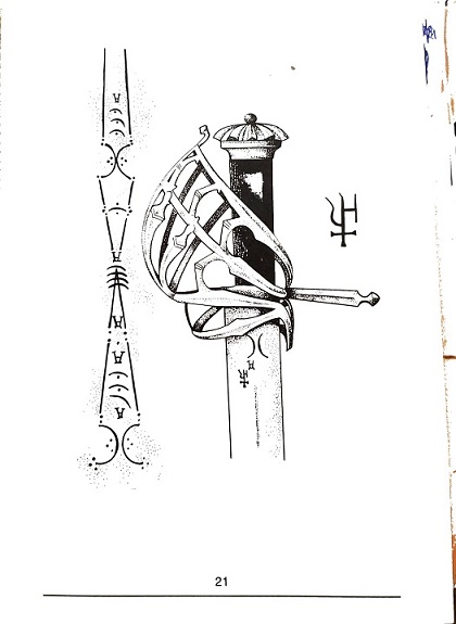

The styling of this hilt shows the later departure of these arming swords into more developed elements from the simple S guards of earlier in the century, and this as noted seems more toward the early 17th. The ring guard on the hilt comes from a feature often on Italian swords of these times.
The flattened sphere pommel recalls the 'kosarice' type types on early schiavona (attached) and similar on early katzbalgars.
It has been noted that by adding a outward guard bar from the knuckleguard to the cross guard, this might be deemed the beginning of the development of the basket hilt and though unrelated, the schiavona hilt. That would be a far more complicated discussion.
The illustration from "Sabres of the Hapsburg Monarchy" (Konipsky & Moudry, Prague, 1991, p. 21)
While of course not a landsknecht example, it has a similar feel so added it for compaison on how these earlier swords were evolving. In the photo of the grouping of weapons one of the katzbalgars can be seen with the kosarice pommel.

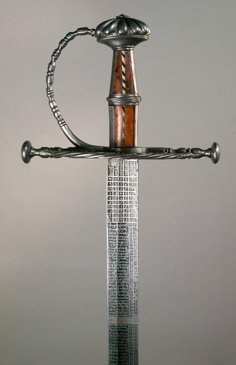

This form should be dated around 1530-40, as this both similar examples proofs. The first you could find https://www.khm.at/kunstwerke/schwer...rklinge-372826, the other one from martin luther
