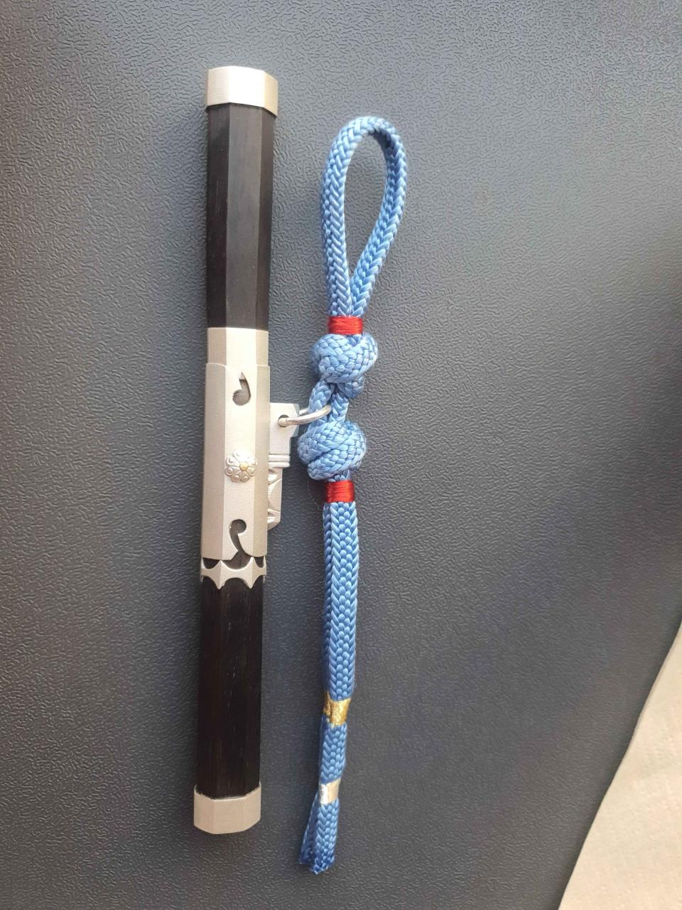

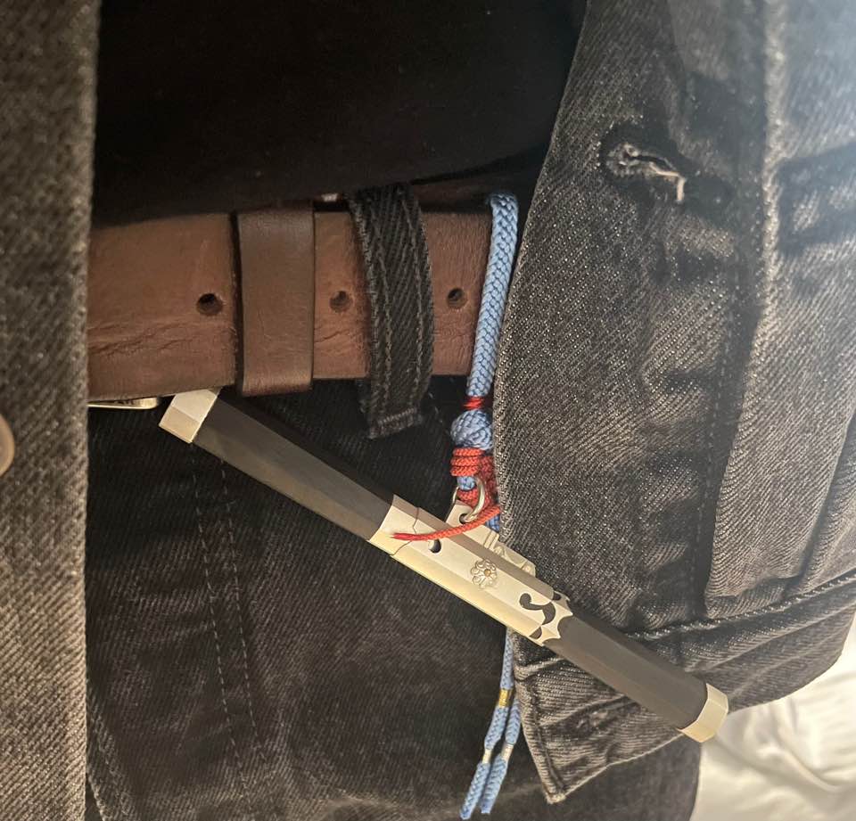

The uploaded photo shows an example where I attached asilk knot I purchased to a silver jangdo crafted by a Korean Master Artisan officially designated as an Intangible Cultural Heritage holder (a title awarded by the government to those who preserve traditional crafts). The decorative fittings are made of silver, while the scabbard and handle are crafted from ebony. The person wearing it at the waist is a friend of mine.
I’ll tell you about the blade itself another time—based on what I know.
