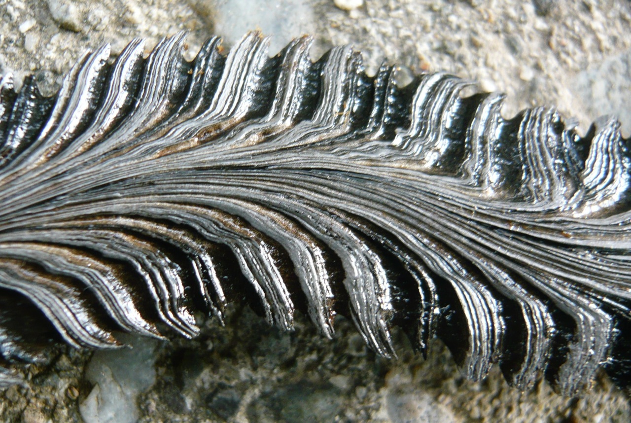

During my last trip in Jawa i found this dapur. Someone may teach how is the way to make this keris ?

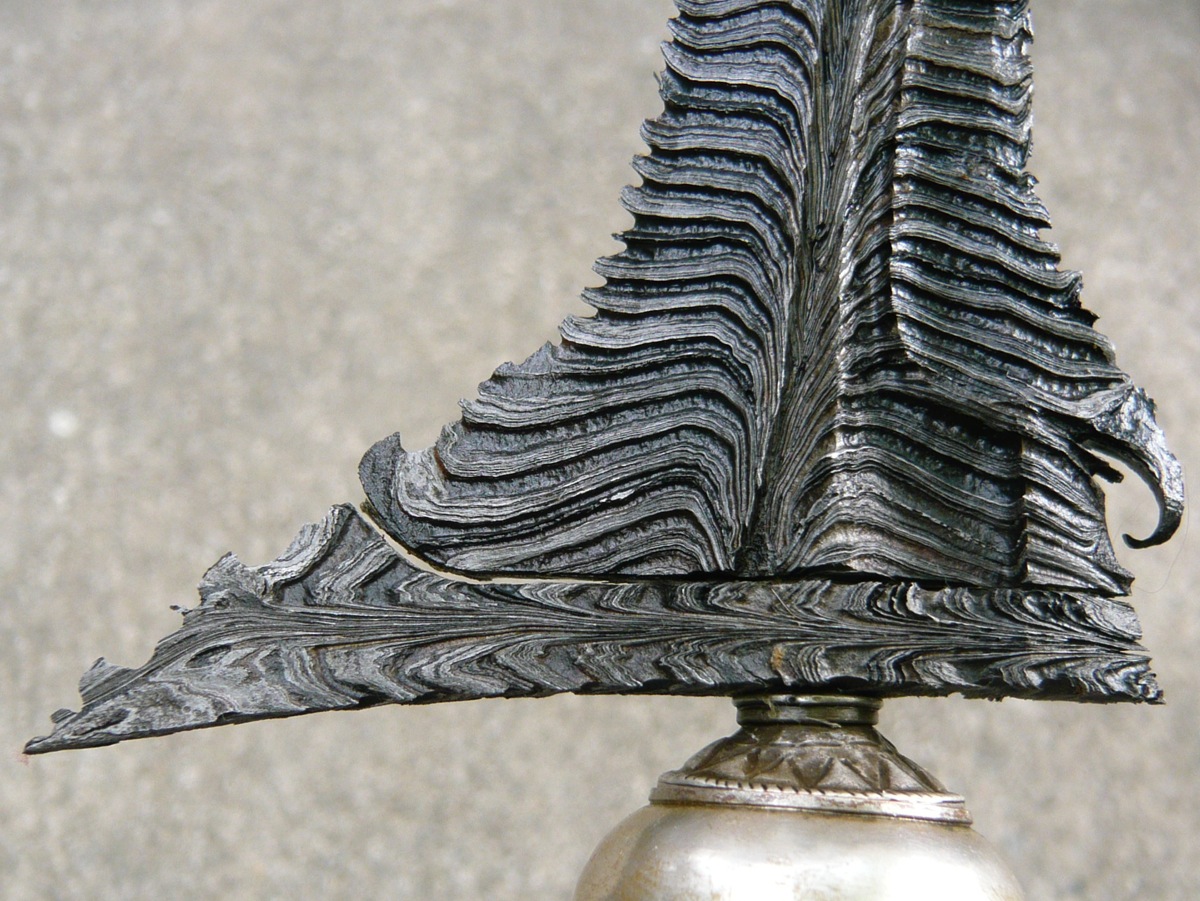

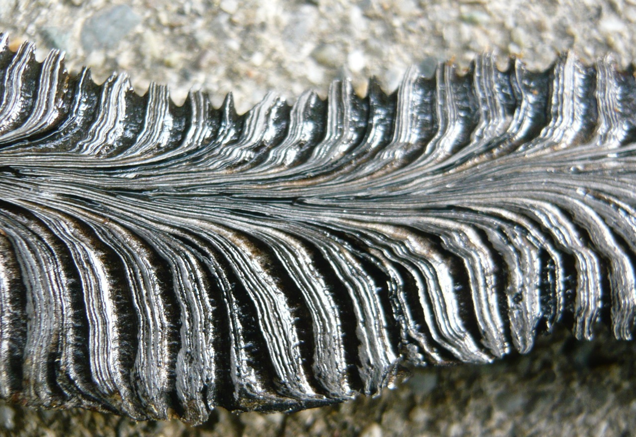

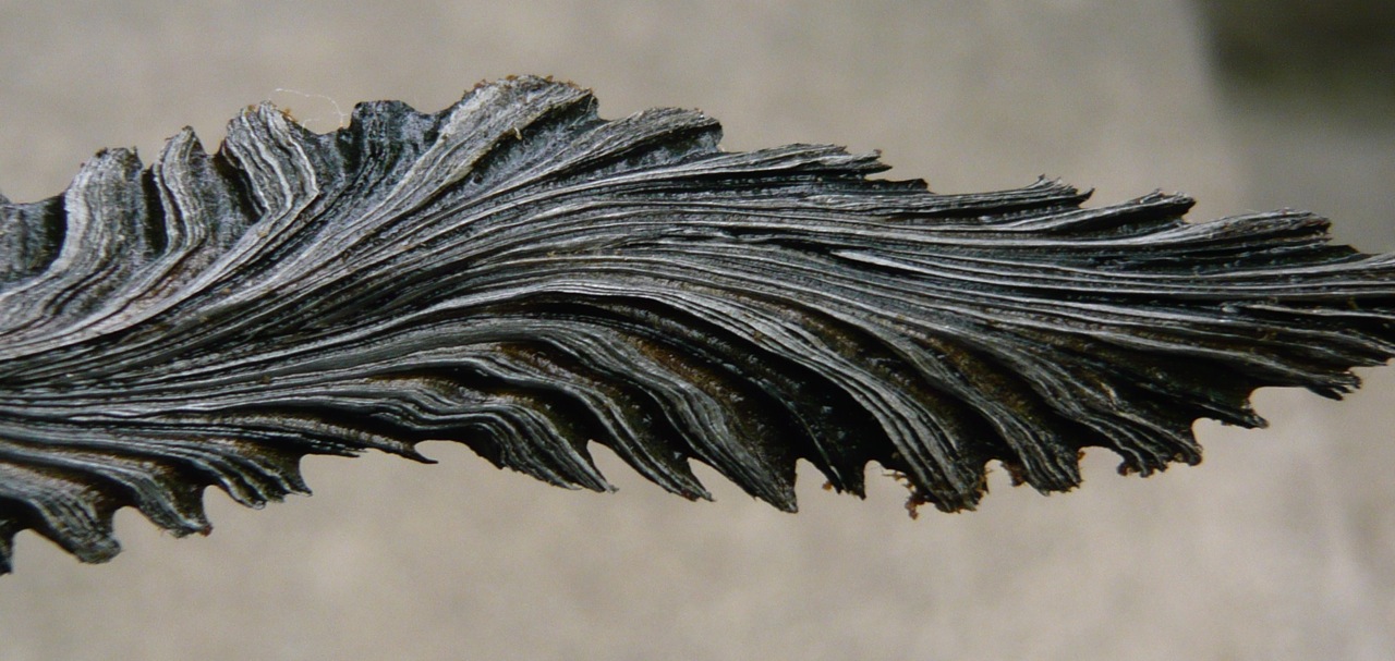

some other pics (mendak is not Solo but.. i like it )

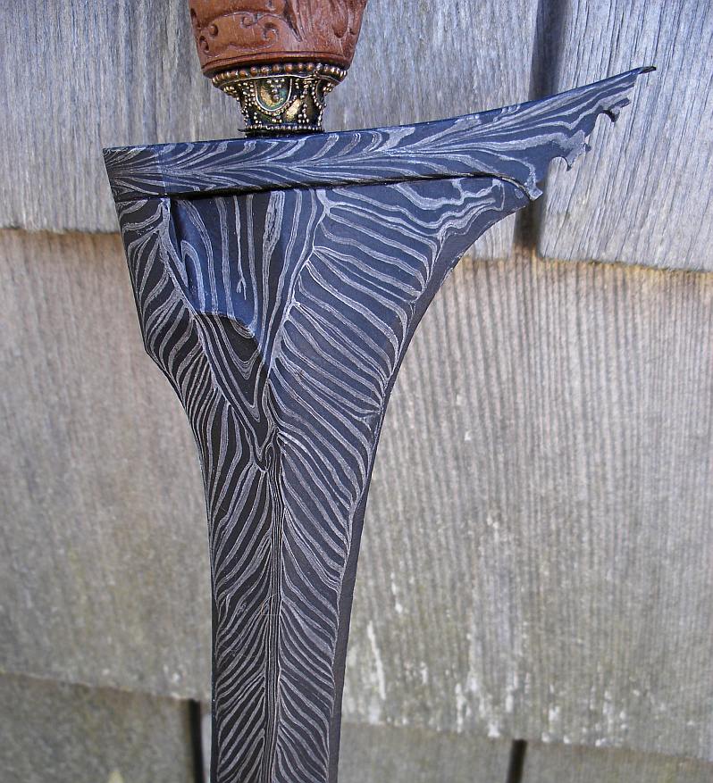

This seems to be a solid pamor version of the motif pictured below .
The pamor on this keris has been applied over a core and has not been heavily etched .

Posts: 7,303
Marco, is your question about the dhapur or the pamor. The pamor looks like Blarak Ngirid without a core. I think the lack of a core is what is giving it the unusual appearance you are wondering about. Looks like a contemporary piece to me.
That's pamor Ri Wader alright, it's the vertical type of pamor (pamor miring).. I like the structure, although it has no core.. imho, battle worthiness is questionable, but aesthetically pleasing.. I've had the opportunity to closely look at a few of these before, nice find..

I would like to know, about this dapur, if the maker uses acid to have the ragged edges or if he uses some tools or if the edges comes .
Old 14th April 2009, 11:28 AM   #9
Marcokeris
Marcokeris's Avatar
Location: Italy
Posts: 928
I would like to know, about this dapur, if the maker uses acid to have the ragged edges or if he uses some tools or if the edges borns in this way during the hot work. (I suppose strong acid )
Old 14th April 2009, 02:16 PM   #10
Posts: 7,303
Marco, obviously the blade has been etched, but i think the raggedy edges is, as i mentioned before, due to the lack of a core to the blade more than anything else.
