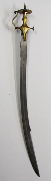

Hi All,
Looking for some practical ideas on this one. This was described as an 'Arab Sword' with 'teeth marks' on the blade. It was removed by E-Bay U.K. because it had a curved blade longer than 18 inches (U.K. knife and sword legislation 'anomaly'). To cut a long story short I bought it privately very reasonably which might be just as well but you never know! As you can see from the sellers photograph the hilt has been painted and the blade may or may not have been varnished. The question is what to do when I get it i.e. the best way to remove aforesaid paint and varnish? Thanks for all and any replies.
Norman.

Stripped the hilt and I am very pleased with the results. David kindly suggested an early 20th Century date on the basis of the previous photos, looking at these photos do you think it might slip into the 19th? The removal of the paint revealed a 4 stamped into the hilt, any suggestions? There also appears to have been numbers/letters stamped into the blade at the hilt but unfortunately they seem to have been lost. Any ideas welcome.
Norman.
Old 21st March 2009, 02:48 PM   #12
Pukka Bundook
Join Date: Jan 2007
Posts: 803
Hi Norman,
I don't see anything that would suggest a date later than mid-19th century really, other than the blade doesn't look to have been re-sharpened as have many.
If I guessed, I'd say 1850 -75.....but there are many here who know more than me!

Its a nice sword. Does anyone think its a late 19th/early 20thC military tulwar?
Old 21st March 2009, 04:19 PM   #14
Norman McCormick
Norman McCormick's Avatar
Posts: 1,657
Hi Guys,
Thanks for the input, the original photos were unclear and with the painted hilt the piece did look newer than now supposed. I'm pleased we're now into the 19th Cent, the blade on this is exceptionally sharp and 'beefy' in my experience with an unusually large pommel disc and a nice yelman even the grip is a wee bit bigger than usual. I don't think this is a military issue Tulwar, blade is too well made. Somebody has had a real go at the blade so I want to take some photos and see what you think. Thanks again.
My Regards,
Norman.
