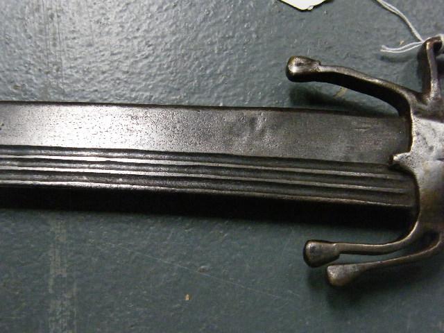

I thought I'd bring this ole thread back from the depths and add to it what I think could possibly be a pirate's nimcha.
regards
Gav
