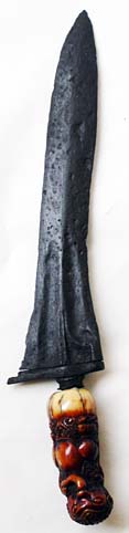

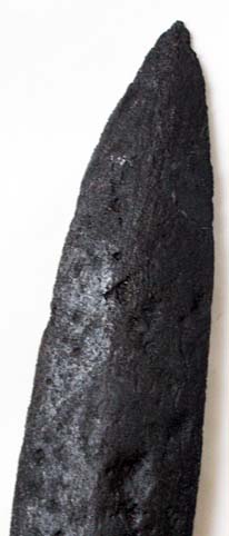

It needs archeological research on that. But there are some pictures of "supposed to be the earlieast form" of keris in Candi (temple) Borobudur in Central Jawa (9th century) and also Prambanan temple (in Yogyakarta) and Panataran in east Java. (See pictures).
Some people believed, that the earliest form of keris, was dhapur "jalak budo" (compare the form in the picture, with the form of 'keris' in the relief). Old jalak budo, some of them, believed to come from Singasari era or older...

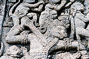

Pak Ganja, the picture of the relief from Panataran with a monkey warrior about to stab an enemy with a large, straight keris-like dagger is a falsification.The blade in this image has been retouched to make it appear assymetrical. If you visit Panataran you will find that this blade is symetrical. Below is an image of what this carving really looks like; it is not all that clear, because of the weathering, but I think you will probably be able to see that the blade base is in fact symmetrical.

Yeah, lousy pic. Not at all clear. Try this one. If its no good you'll have to go to Panataran yourself and have a look at it.

Thanks, Alan, for giving your valuable time to make this discussion developping. I will try to follow the rules you proposed, even though I have limited ability in expressing all what I think, in English.
The main disagrement for me, is the "stand point" view about comparing kerises. As if the small size keris that is called as "keris majapahit" in this book, is the "stand point" of comparison. This quotation below, is the "earliest" sentence that mentioned "keris majapahit" in this book. Let's start discuss with this...
(AH Hill first article, under title "The Keris and Other Malay Weapons". Please see page 4)
2. Types of blade
Keris blades vary considerably in shape and size. Original keris majapahit blades are only six or seven inches long and must have been almost useless for fighting. Yet one would have thought that it they were used only as charms there must have a still earlier keris of proper utilitarian value for their efficacy to be recognized. No such prototype weapon has ever been found. Indeed, as will be shown later, all the evidence there is goes to show that the keris was a new type of weapon in the thirteenth century. The rapier-like keris panjang of Sumatera and the sword-like keris sundang of Celebes, adaptations of the normal keris for special purposes, are sometimes over two feet long from handle to tip. If extreme like these are excluded the length of the normal keris blade may be taken as twelve to sixteen inches...
(Comment -- For mostly Indonesians, the word "keris majapahit" with the connotation of this very small size keris, will be confusing. Keris majapahit -- in the mind of Indonesian -- is keris that came or supposed to be made, or that has style of they believed to be keris from Majapahit kingdom era. The word "keris majapahit" to mention that small keris, is "unknown" in Indonesia. That kind of small keris, in Indonesia known as "keris sajen" or "keris for offering"...)
