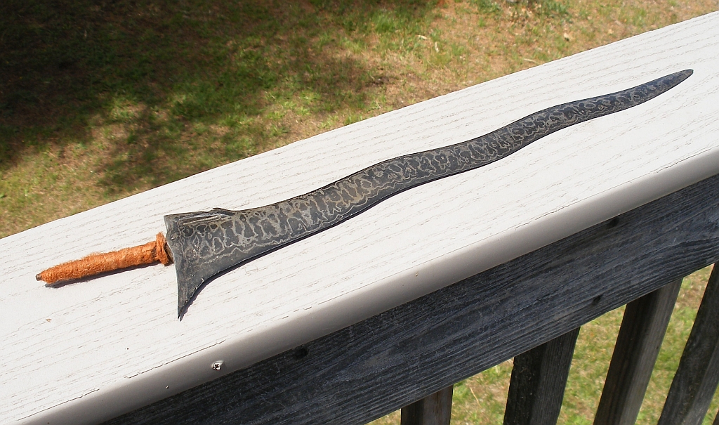

Old Today, 06:13 PM   #5
Posts: 6,420
Here's my Iras blade.
I have a feeling, that due to the size (15") and polish, it may be from Lombok.
