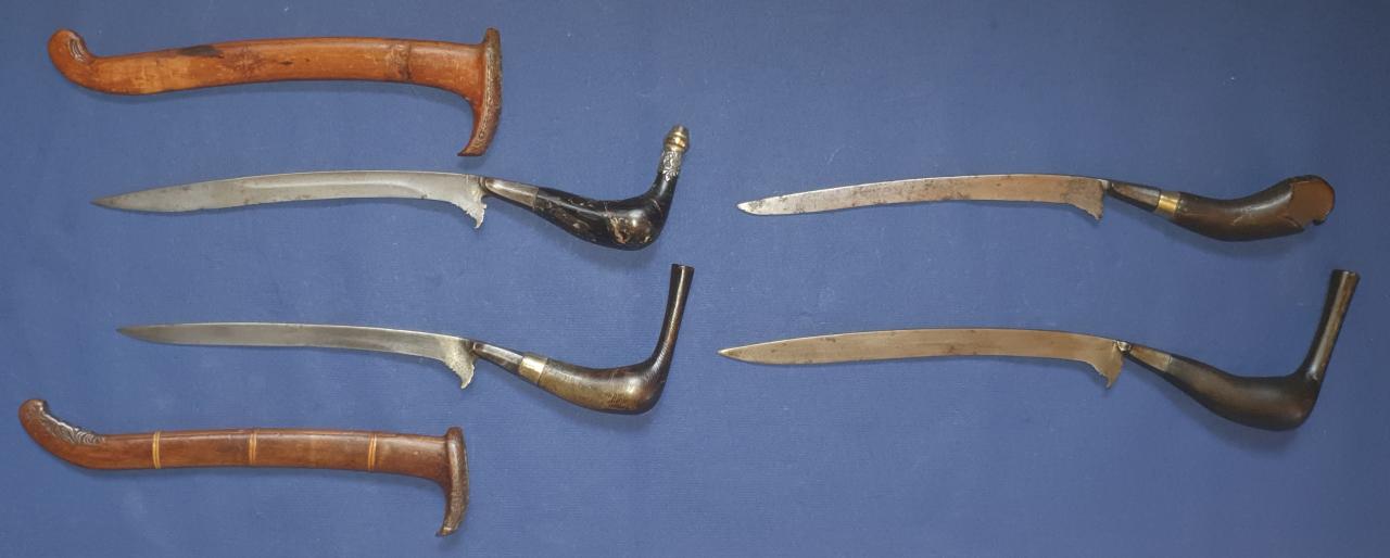

Originally Posted by francantolin View Post
Strange the choice of hippo for the hilt,
Do they import it from Africa ?
If I am not wrong, they aren’t hippo in Indonesia and Asia.
Yes, hippo ivory got imported from Africa, it's a very common material in South-East-Asia.
I wasn’t sure about the ferrule who has often a crown shape on the rencong I saw.
This one is ́’flat ’́’ so I thought it was more recent ( but the quality is ok )
These ferrules are quite common on rencongs, see the attached pic of some rencong from my own collection.
Old 2nd May 2026, 12:06 PM   #7
francantolin
Join Date: Sep 2014
Posts: 973
Thank ́s a lot Detlef !
