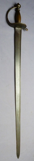

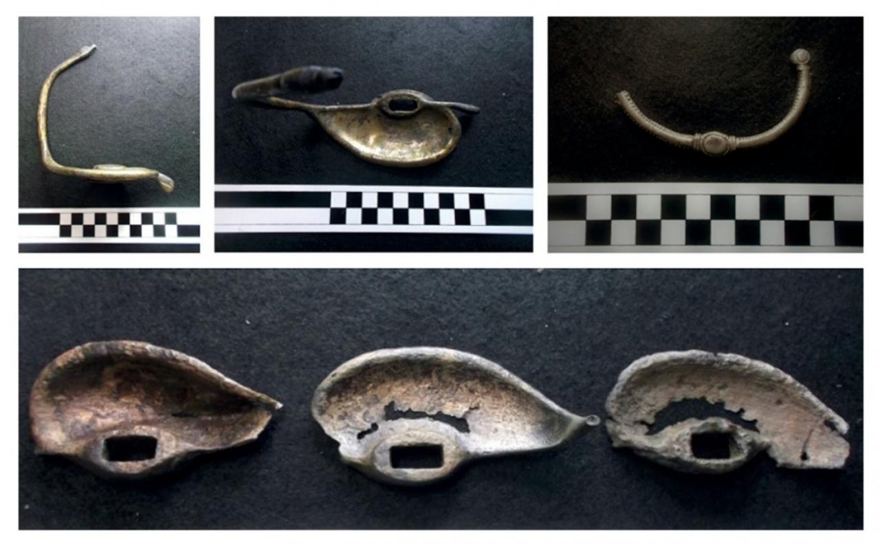

For example, in the war of the Spanish sucession (1700-1714) French supplied the weaponry of many Spanish regiments with French models from St Etienne and Charleville manufactures. However there are no survivors of these weapons and Spanish authors ignore the subject alltogether. But there are exceptions... underwater relics.
The picture show French naval sabres hilts found at the Nuestra señora de Guadalupe galleon, sunk in 1724.
This is the subject of a book I ordered recently.

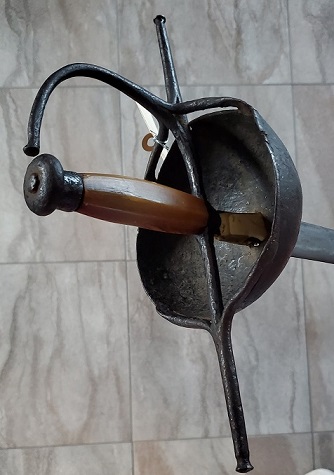

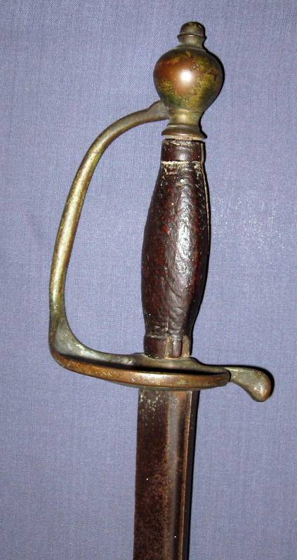

I am a bit puzzled about the 'Caribbean' rapier reference, are you referring to the cup hilt forms which often seem mounted with heavier 'arming' type blades? In the brief glimpse of the wreck site from 1708 in the linked Utube entry, there seemed an intact cup type hilt with the quillon across.
I could not make out the shell type versions. Are they in accord with these images attached? you indicate these are from the book shown by Mr.Wells, but going through that I could not find the images.
Please forgive my confusion, just wanted to be sure I am following.
I have always understood these much simpler versions of the often smartly embellished Spanish cup hilt rapiers, especially in the 'arming sword' character were indeed from makers in the colonies, hence being labeled 'Caribbean' in most references. I had always thought of the very crude example shown in "Arms and Armor in Colonial America" (Peterson) which I cannot seem to find an image of, were the typical examples of these forms.
However, I later found that better quality examples but still relatively austere were also deemed 'colonial'.

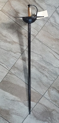

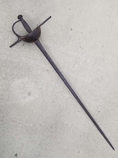

Attached are images of one with what appears cross hatched ebony grip, and my humble example which as had a crude bone grip refurbished.
Regarding use of these kinds of swords aboard Spanish vessels, I had understood there were small contingents of soldiers aboard vessels, especially those with valuable cargo, including precious metals.
Not surprising that Spanish authors do not refer to the sources of these arms whether France or Solingen. As noted, these munitions grade arms were seldom preserved and ended up as scrap or repurposed.......the exception as always, the in situ wreckage of these vessels.

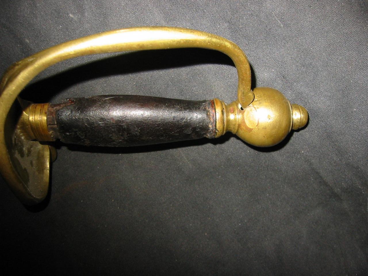

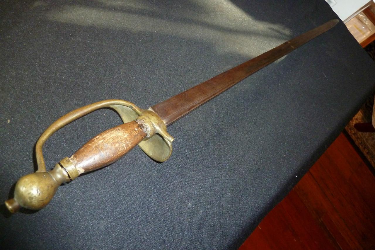

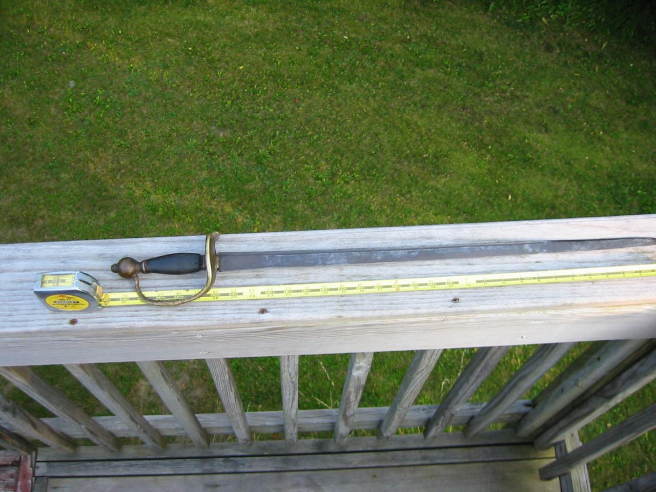

Hotspur
Hotspur's Avatar
Join Date: Jul 2009
Location: Nipmuc USA
Posts: 556
Great stuff!
I have one of the French swords and have found a few more. It's super to have a good date for them.
Cheers
GC
Old 15th December 2025, 03:14 AM   #4
Hotspur
Hotspur's Avatar
Join Date: Jul 2009
Posts: 556

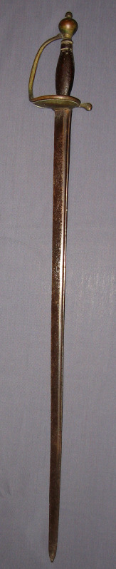

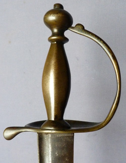

David, of The Royal Sword shared his at one point and I saved that set
Old 15th December 2025, 03:28 AM   #5
Hotspur
Hotspur's Avatar
Join Date: Jul 2009
Posts: 556
They are almost peas in a pod. The Rose hangers, from a century later are very similar

The pictures of the relic hilts from the 1724 galleon came from this Spanish 2019 pH D thesis (UNA INVESTIGACIÓN HISTÓRICO-ARQUEOLÓGICA. EL NAUFRAGIO DEL NAVÍO NUESTRA SEÑORA DE GUADALUPE Y SAN ANTONIO. FLOTA DE AZOGUES DE 1724, BAHÍA DE SAMANÁ, REPÚBLICA DOMINICANA).
https://repositorio.uam.es/bitstream...d565d/download
page 360.

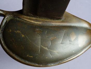

I have found what appears a survivor from those French hilts. It has a Spanish blade with the no me saques motto, possibly from Barcelona, and the markings of the Spanish Royal Navy (RA).
I have not received yet the book By Noel Wells.
