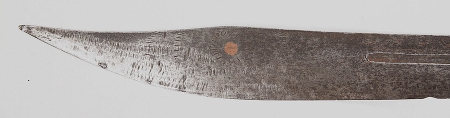

Towards the tip is an inset brass dot with radiating rays of brass. There are two rows of "arrowhead" marks incised into the blade and pointing towards the tip.

I have owned several similar dha with Chinese markings (including the HuSa inscription). The blades have varied in shape, from straight to saber form. Some have had brass inlay decorations. One had numerous hunting scenes in inlaid brass. A couple had brass dots similar to that found on this one. Marks at forte have included the running tiger mark and a rifle.

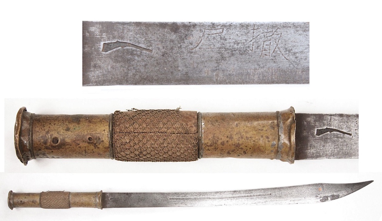

Default Another example (without scabbard) with a different blade and hilt
Here is another one that I have had for many years. It has a rifle mark stamped at forte, the HuSa mark in Chinese characters, and a brass dot adjacent to the tip of the blade.
