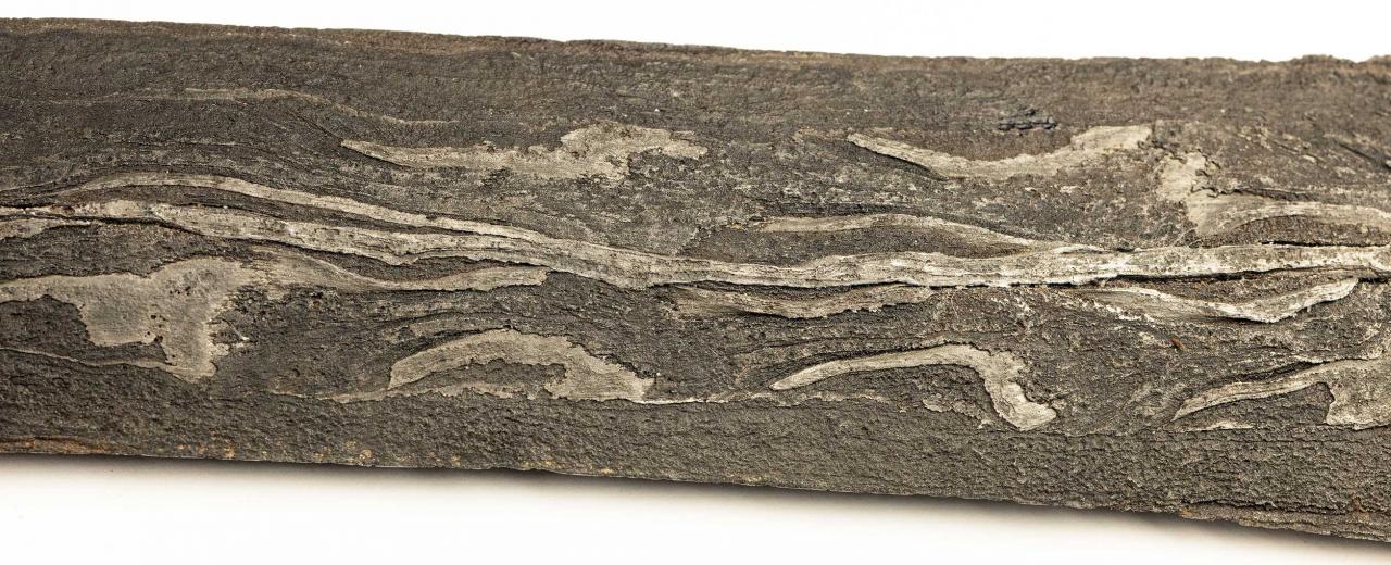

Hi,
Can this be a random mlumah pamor - perhaps Wos Wutah?
Length of Blade - 42cm. Tip to base of ganja.
Were these types of islamic themed keris commonly produced for sale or mainly commissioned?
Cheers.

In what I can see, this pamor looks like the remnants of a pamor miring, but i cannot guess what it might have been made as from these photos, I alsi cannot name the pamor in the sorsoran from memory, to give a supportable opinion I would need this keris in hand, along with a decent reference book & a 3X loupe.
Keris dress with Islamic motifs can be both made to order or made as a stock item. It appears to have become much more popular in Indonesia, along with the rise of Islam in recent years.

To me it looks like two twisted bars with low twist frequency on a side, divided by a Miring stripe, plus Puser.
As Alan said, remnants of Pamor, the structure of twisted bars still recognizable in a couple of places on Sorsoran or better, lower third of the blade.

Agreed Gustav, the overall impression is as you state, however I cannot see sufficient detail in the photo to let me identify the grain orientation.
The little roundish thing in the sorsoran does not have a form I recognise, so I cannot name it.

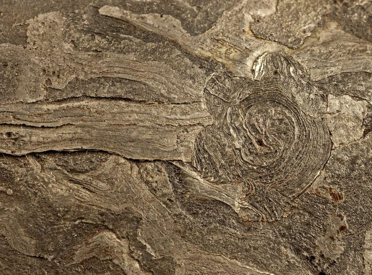

I agree with Alan that this pamor, though similar to pamor puser, may be something a little different. All the pamor puser i have seen are a fairly standard spiral in a circular pattern. This pamor very specifically steps out of that pattern. Though i am not sure if it has a different name or intention.

Posts: 52
I got a bit closer to the puser.
