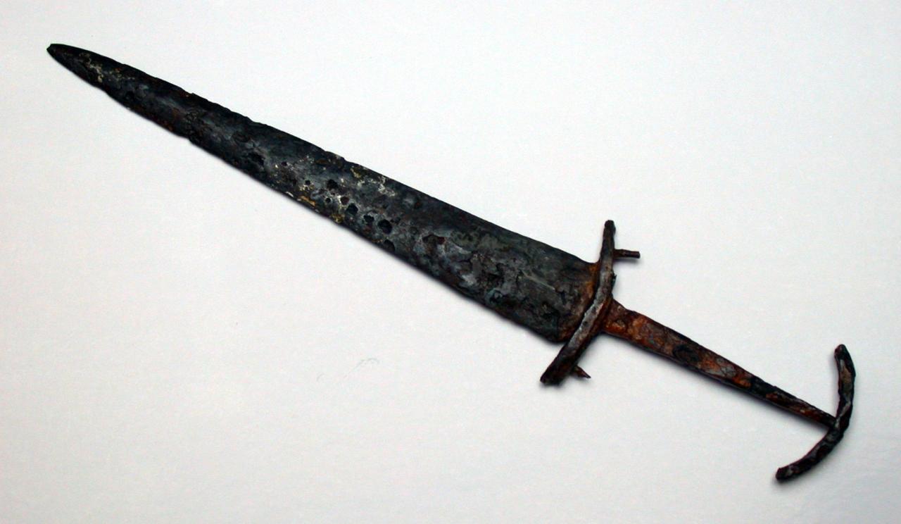

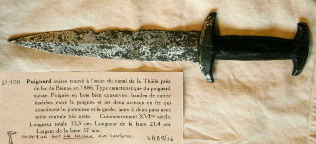

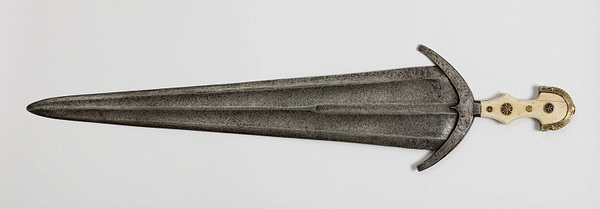

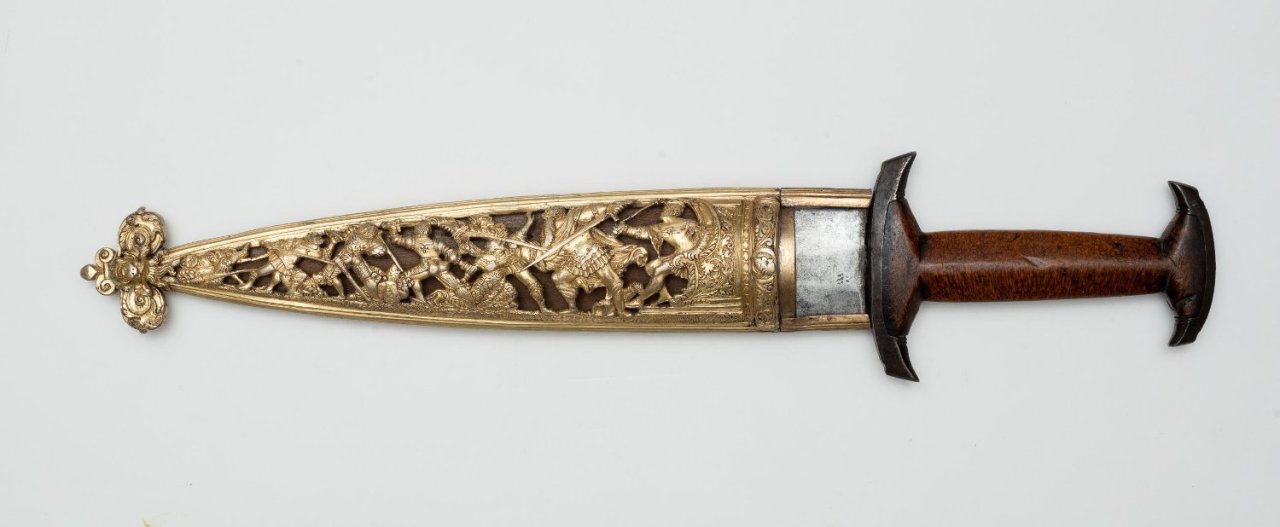

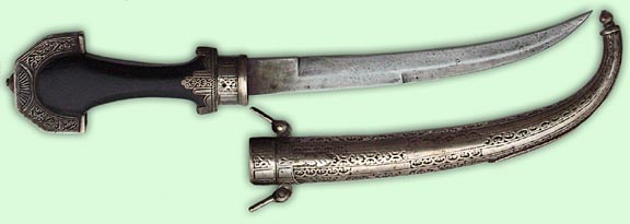

1. left, a Moroccan koumyya
2.Italian cinquedea
3. Swiss dagger early 16th c.
4.Swiss basler dagger 14th-15th c
5. 'Holbein' dagger (for artwork typically on scabbards)
