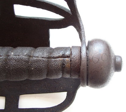

It does not indicate however where these were marked. Typically it seems the guard was the field for such administrative marks.

I have one of these (attached) which has been remounted with a M1788 light cavalry saber blade, and I have seen two others over the past 4 decades also with such blades. It would appear that a number of these which had been placed in stores were remounted, reason or distribution unknown, but with these blades becoming the type known with Scots as 'turcael' (with curved blade).
The other pic is a British dragoon basket hilt with number on pommel, same period, so it would seem the pommel was in cases a proper location, and quite likely in field application. Pommels were easily changed out so it seems to make sense with issued weapons.
