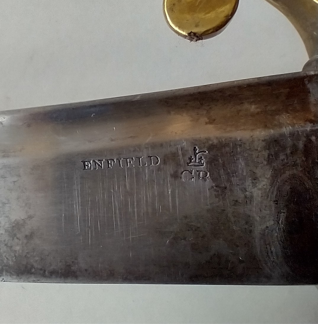

Markings on the m1804 vary. The classic fancy-scripted GR under a crown marking (for George Rex, Latin George III and IV for these pattern swords) are found on many of them. When i first purchased mine, the cutlass had block letter GR under crown, which both intrigued and concerned me. I had heard of spurious markings of this block letter type appearing on later swords of the m1804 pattern made by Schnitzler and Kirschbaum in Solingen after 1850. However, upon doing research, I soon came across information that many different cutlers and merhants were involved in supplying the British Navy and many of them used the exact marking (block letter GR with this specific crown) as found on my example-
I thought I would post pictures of this British Coastguard cutlass because it has a good example of the block GR and is also marked Enfield and a rather worn crown. The cutlass can be dated to between 1823 and 1830 as Enfield did not make swords before 1823 and William came to the throne in 1830.
It is also interesting because the shape of the blade looks like it took its inspiration from the very rare 1814 cutlass. Sim Comfort suggests that the 1814 exists with two different grips (page 235) - the same as the 1804 grip and a later version.
The coastguard cutlass grip is like the later version. It is more shaped at the palm and the end with 20 spiral rings and does not have the vertical slots of the 1804 grip.

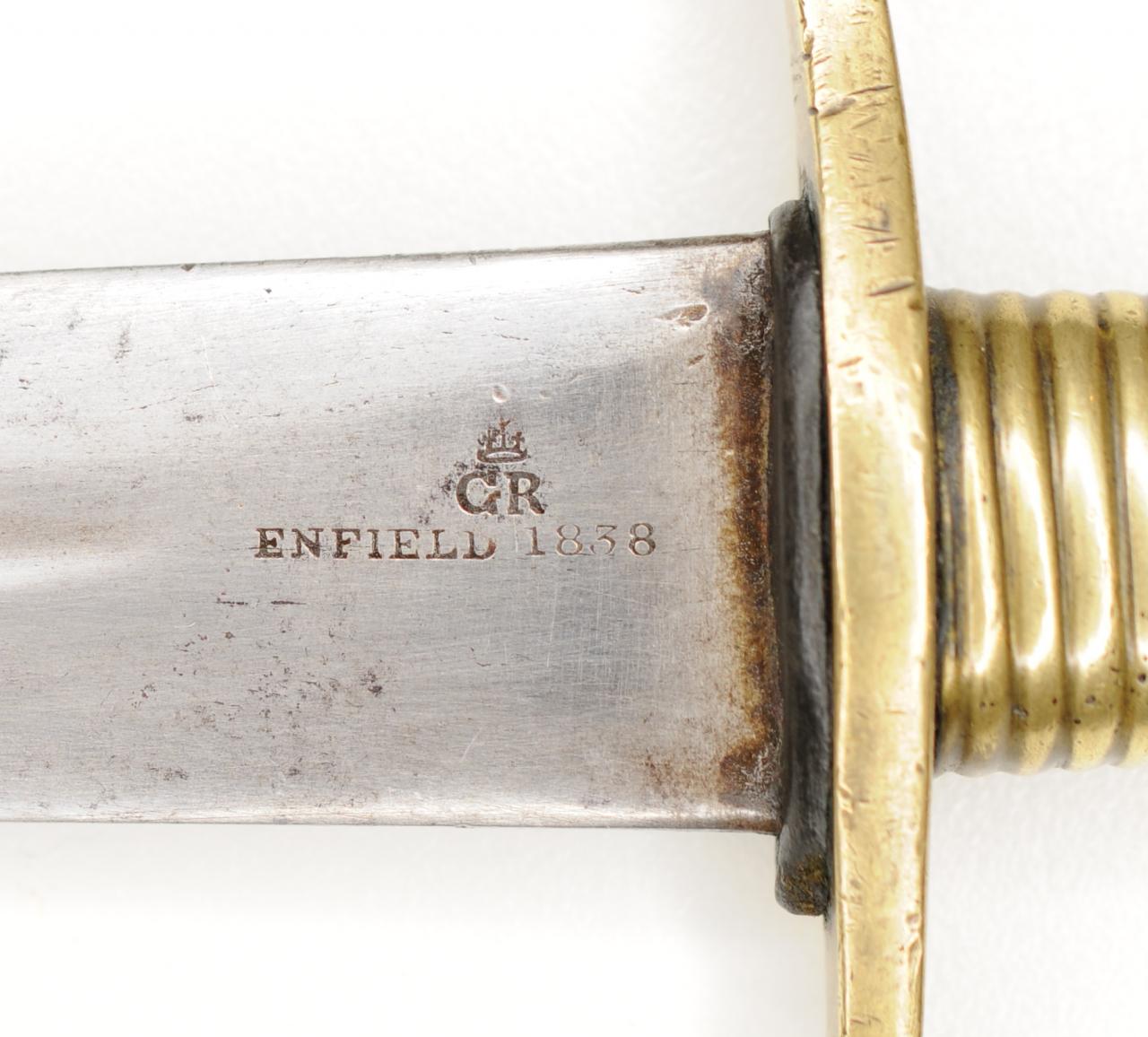

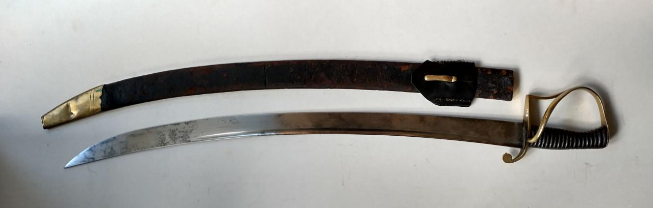

Unfortunately the 'end date' of 1830 cannot be ascribed and should be extended to c1840 given the evidence of other blades of later date with the same stamps. Take for example the early Brunswick Rifle swords that are also stamped ENFIELD and have that same crown/GR stamp - those date to the early reign of Queen Victoria.... an example from my collection below. I have yet to come across a convincing reason for this other than that they had yet to replace the GR stamp that was used for such blades; Blackmore cites evidence that the 1800 dated storekeeper's stamp, applied to the stock (butt) of small arms, was still being used in 1824, so it would not be an isolated case of an 'old' stamp continuing in use.
