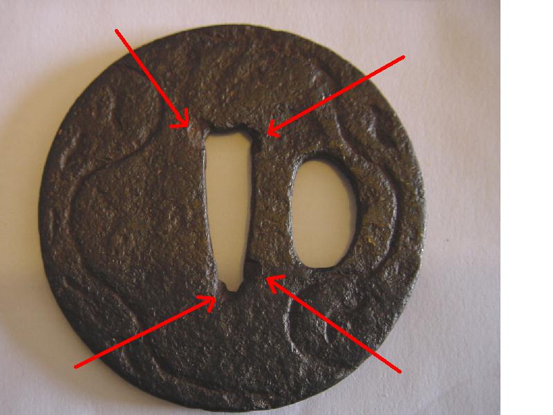

To further validate the age of your piece take a moment to look at the tsuba. When a tsuba is fitted to a blade, it is "punched" in four corners (either side of the front edge, and either side of the back edge). This is much the same concept as center-punching to prep for a drilling. The metal is pushed into the void where the blade passes through and then filed down to fit the cross section of the blade so that the fit is snug and well aligned. These punch marks should be somewhat distinct. Sometimes tsuba are cast and these marks are much softer in their form (if they have not been re-punched to fit the blade). This may also help you shed some light on your piece.

The tsuba has indeed a few punches, but apparently only on the other side, as shown in present pictures. However its center hole seems to be too large to adjust to the section of this blade. Possibly this tsuba belonged to a larger sword, as i don't see how the ( missing ) seppas woud eliminate this problem.
