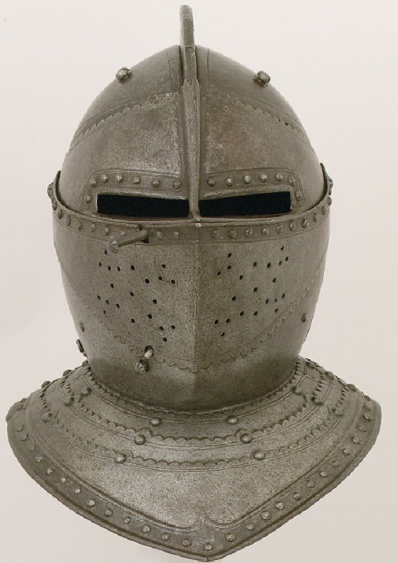

this armor is obviously from a high ranked officer and more decorated , but if you look closely it has also brass decoration on the sides , decorated with similar lines across the torso and even a resembling shape. It is in Musee de L'armee in Paris and is described as " armor for the siege circa 1670" if you look closely you can see that this helmet has also reinforcement plates on top. I wonder if the two bolts on the breastplate are used to attach extra reinforcement plates to, this method was used at the time on both helmets and breastplates. This closed helmet for the field circa 1620 with bolt on ( removable) reinforcement plates is in the Metmuseum weight 6,293 kilo.
