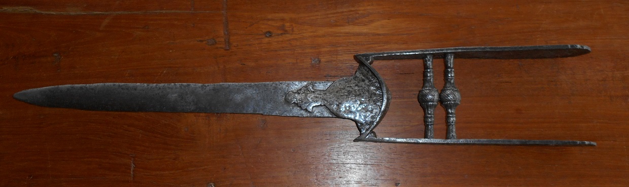

An attractive and quite interesting catter, kronkew! Looks like a recycled European blade, or the tip end thereof? Interesting that laminations are visible which are in keeping with pre-industrial manufacture.
Old 31st October 2019, 10:44 AM   #9
Yup, I like it a lot, broken off tip of a euro blade I think. the carrier was a bit more decorative once, but is well worn and a bit pitted, but the blade is still tight and functional, wish it were a bit wider tho, can only hold it with 4 fingers.

Southern catter hilts are often a tad cramped, the peoples of the deep south are mostly of Dravidian stock and are of smaller stature than northerners. They sure were great metalworkers, though. Their cut and pierced steel work is tops, as is that from the nearby island of Sri Lanka at the tip of the Subcontinent.

All these katars had originaly 3 rivets but as you said the blade was not securely fitted. So the owners have to do some basic soldering to reinforce the thing.
Most of these katars have the same problem: disgusting and ugly soldering and it cannot be the armorer who did this lovely katar...
