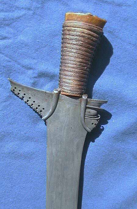

How about a discussion on this sword?;
http://cgi.ebay.com/ws/eBayISAPI.dll...tem=7418102449
It looked good to me and I wanted to bid on it but due to a recent
purchase here, several keris from doecon and a wife and 2 kids I let it
go. The more I look at it though the more I think I should have sold a kid.
Can I put them on ebay? Yes, I am right now suffering from auction regret. Man I hate that. Ok, enough rambling. What do you think of this kalis? It looks to me like upper class quality, maybe even Datu class. I think the buyer made a good deal.

I wouldn't want to comment on price .
The ivory pommel is broken ; I have misgivings about the veracity of the hilt wrap being of human hair . The ferrule is in quite nice condition as is the blade from what I can see .
This is (according to current knowledge) an average Maranao combat blade ; it has been over polished for my tastes ; on the other hand it's ready for a nice etch .
Maybe I'm just jaded from the good old days of ebay but I would not have bid on it .
Broken stuff puts me off but that's a personal thing I guess .

Understood. Would that mean you would have to ban yourself?
Yeah, I was giving the seller a little salemanship on the human hair thing. I agree on the ferrule.
Rick, what makes this average based on current knowledge? I really want to know, because I may have blown this id (Which eases my auction regret a bit) Without having it in hand I looked at these cues;
1) ivory pommel
2) silver handle wire
3) stirrup(baca-baca) is(could be) silver
Any and all information as to what goes through your mind when you evaluate a sword is most appreciated.

No , one of our members bought the piece I believe .
The stirrup is most likely steel ; a silver one might well have been decorated but steel is so much stronger , for combat .
You'll notice that I said the *blade* is an average Maranao combat example ; granted it has a great fit to the gangya but there is no engraving and unless there's something I can't see because of the polish it looks to be of simple piled construction .
Doubtless with the silver ferrule , wire and ivory it belonged to a man who was not on the bottom of the social totem pole . Still in all it is a no nonsense combat blade .
After all you don't take a delicate sword to war .

Just received this. I really like it. Has an incredible balance. Thin older blade really feels good in the hand. A bit overcleaned. Can't tell what the clamp is made from. Gotta get one of those silver testing kits.
I like the price.
