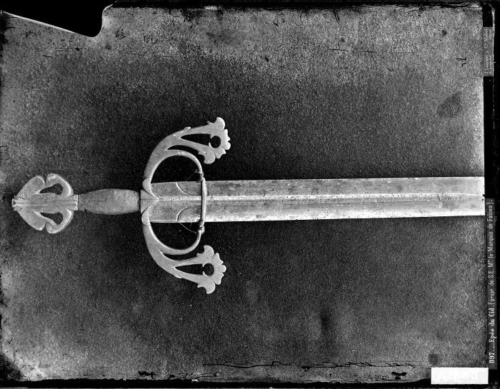

Robert-Jean Charles in ÉTUDE SUR LES ÉPÉES DU MOYEN ÂGE AU 17° SIÈCLE
http://www.bertrand-malvaux.com/fr/p...70-siecle.html
Focuses on the early evolution of the sword guard in the late XVth early XVIth century. Taking into account especially Iberian examples. He has nothing like your guard.
Not in Norman, Rapier, and Smallsword. Not in Seitz. Not in Ada Bruhm.
On the other hand, this is the equivalent piece a cup hilt would have without the bell...
The closest example i find is the XVI century hilt El Cid Tizona blade has:

But of course, midleburgo, this is much too evident to be otherwise. The thing is that, i and my fellow collector skipped such hypothesis from the beginning as we became blinded by the double tang hole "detail". This differentiation only prevents us from calling it a replica in a strict sense but, this guard has definitely followed the Tizona style.
Now, what are we facing here ? The seller said this was found in the manor house of a family with military tradition, in the center of Madrid. Could it be ... or not. But then, why has the smith made it with with such particular difference; to fit a blade also with a particular shape ... or some kind of personal (or customer) innovation ? i (also) have paged a dozen books and found no guard with such mounting style.
A question i would ask: how old would it be ? It looks as having been hand beaten made ... no cast seams.
And worthy of note are also its specs.; 22 cms. between guard ends and an impressive 600 grams.

What I find weird is not the present piece design, which seems logical in the evolution of sword guards, but the lack of similar examples.
1)The first possibility is that it is a real early XVIth century Iberian hilt. But these swords are fairly light. 600 grams just for the guard is a lot.
2)I have been checking copies of Tizona, some of them well 130 years old, and none have that design in the lower guard. There have been pictures of Tizona for longer, some 160 years. If somebody wanted to make an accurate copy that was easy. But your piece is just a resemblance. I wonder why. If somebody would have just the picture from Laurent below, possibly he would have come with that design, not knowing what is at the other side, but the rest of the hilt would have been closer to Tizona.
3)Another possibility is that the guard was made in XVIIth or XVIIIth centuries for a San Miguel or Santiago church image. They wanted something looking medieval but at the same time technically closer to what was done at that time.
