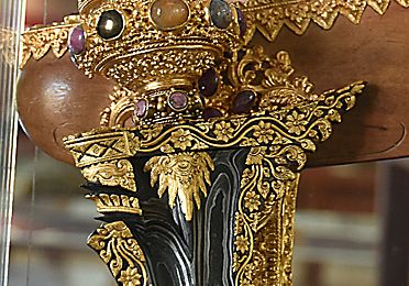

I was in Bali recently, and as usual I did the required visit to the Neka Museum in Ubud.
There are quite a few more older keris there now than the last time I went there in 2016. Amongst these older keris are two royal keris from Karangasem.
I apologise for the photos. It is more than a little bit difficult to photograph display items in this museum, unless you are lucky with time of day and light, I've been there a number of times, but I just haven't got the timing figured out yet.
Anyway, these two take the blue ribbon in the bling stakes.

Alan,
these are wonderful Keris. Imho a little bit too much decoration but this is subjective and it is most difficult to find the perfect balance. European aristocratic swords of the renaissance are also hopelessly overdecorated in many cases.
I have one question, the Cocetan got a symbol on its base, which looks like an eye in flames, similar to the eye in the pyramid.
Is this an eye and what is the meaning of this detail?
Roland
Old 28th May 2018, 01:58 PM   #8
Posts: 7,217
Roland, this motif is upside down in the larger image, I've cropped it and turned it right way up.
It is the Karang Bintulu motif.
This is a common "fill" motif in Balinese art, the motif consists of a bulging eye above a row of teeth and tusks, above the eye we usually find a mountain. The eye and teeth relate back to the well known Kala or Bhoma motif that we find above gateways, the mountain or rock relates back to the Gunungan, a foundation motif of indigenous belief. F. Bosch believed that the Kala motif was influenced by Surya (The Sun).
In this representation of the Karang Bintulu the Gunungan form is rendered in a form that resembles flames, so the flames are probably indicative of the influence of Surya.
Since the bintulu relates to Bhoma, and Bhoma is a protective motif, the bintulu can also be interpreted as a protective motif, even though it is only a fill motif, never a dominant motif.

Posts: 7,289
Alan, thanks for the explanation of the Karang Bintulu motif.
Certainly you are correct that kings do not dress their keris the same way as farmers do. I believe that is way many of us find these keris a little too blingy for our personal tastes. We are farmers...or at least, not kings.
I do actually like the kocetan hilt however, though i find the other one (do you recognize who it represents?) quite ugly. The gold work on the sheaths gives me the impression of new work, though i suppose it could be new goldsmithing done over older wooden sheath. As you say, that doesn't really matter in this context as new dress is a common and expected thing within the culture. It's only us collectors who seem to value preserving old and original dress.
It isn't really easy to get more than an overview of these keris from these photos and there is so much kinatah on the blades that it is difficult to get a good sense of the garap of the blades, but i would image that given the provenance they are probably well conceived beneath all that gold.
