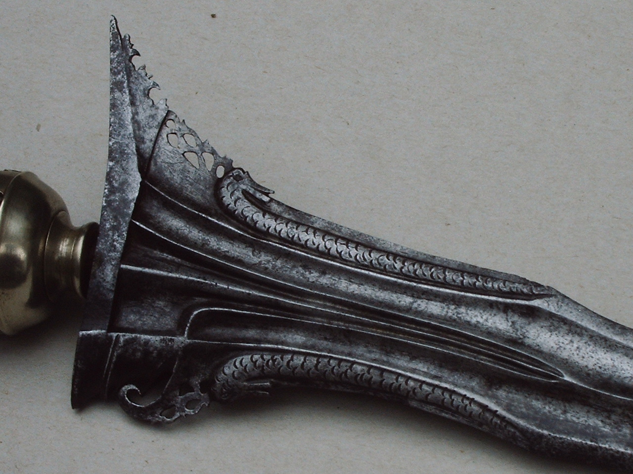

Actually, this keris is inspired by the unduk-unduk (seahorse) keris of Terengganu state, peninsular Malaysia. Please see attached image. The sarung is a traditional form called Kusriwo, which is also associated with Terengganu state of peninsular Malaysia.

Thanks for posting the Terengganu keris, as well. Gives some perspective. Roughly how old is the unduk-unduk in the photo?

The photo was taken from another thread in the vikingsword forum. I think it should be at least pre-war in age.
IMHO there are only very few nicely chiselled unduk-unduk and even fewer well-sculpted blades with this feature.
Legalities and the merlion being some kind of commercial modern idea aside, I don't think its placement in the pudhak sategal area is well advised: IMHO the stocky body completely breaks the flow of lines of the whole blade. If you have to, it might possibly work out reasonably well as a figure at the gandik area though...
