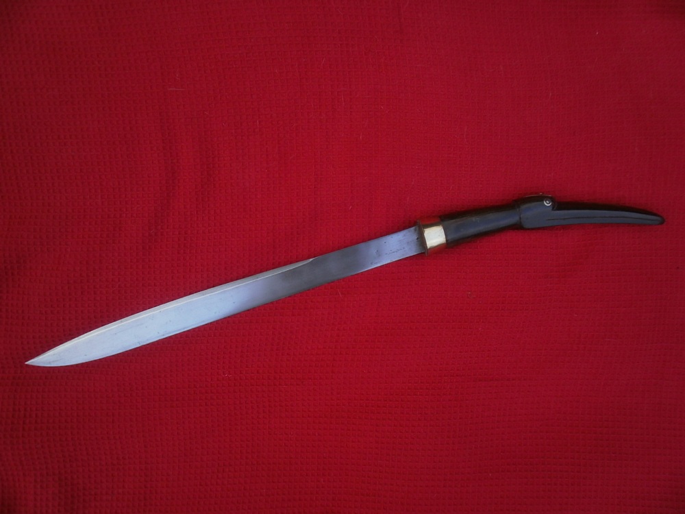

Just bought this very intersting knife, it's 39,5 cm (approx. 15,5") long overall, sadly no scabbard. I was listed as "Indonesian kriss dagger" but I strongly doubt this origin and have already an own opinion but don't want to influence any other opinions and want to read first what others think about this knife. So all comments are very welcome! The pictures are from the ebay auction/seller.

First thing that came to my mind was Thai, Detlef.
Blade profile and ferrule at least.
The figural handle...

I almost bid on this! I like it but like you couldn't pin point the origin.

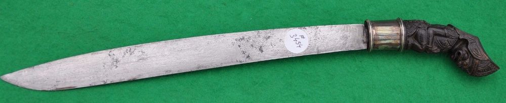

thank you for your kind comments! I for my part think that Rick is on the correct path. I think as well that it is a dha knife or short sword. For the origin I am unsure, it could come either from the Thai Tak province Mae Sot river region since the blade shape remember strong to the bird dha's (see picture) or from the bottom of Thailand at the border of Malaysia (Pattani region) but I think that the first region is the better guess since the blade shape is very similar. Any other thoughts?

Very nice knife. That heavy "chunky" ferrule is not really typical of Thai work and reminds me more of what we see sometimes on Sumatran pedang and similar knives/swords. I think I would favor southern Thailand near Malaysia as its source. Nice find.
Any thoughts about the figure on the hilt?

thank you for comment. I think both guesses are good as the other. The Thai Tak province Mae Sot river region (border to Burma) I've had in mind because this bird head dha's coming from this region and the blade shape is very similar, see also this thread: http://www.vikingsword.com/vb/showth...ight=bird+head
But the origin from the Southern Thai (Pattani) region is also a very good one, like you said, the chunky silver ferrule is a good hint for this origin.
Maybe the blade construction can give us a hint when I have it in my hands. The blade looks laminated which would pin point to South Thailand IMVHO.
And no, I haven't a clue about the deity hilt, do you have something in mind?
