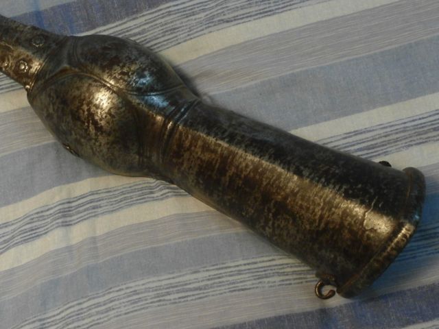

Inspired by Kubur's pata - here is a recent acquisition. A simple steel pata - some small losses to the gauntlet. Still in the condition in which it was received. My suspicion would be that it is of northern indian origin.
What interests me however is that the blade is single-edged. I've probably only held twenty or so of these weapons, so I acknowledge the test sample and my knowledge-base are both small, but I've only ever personally seen double-edged blades on these. Does anyone have any pictures of anything similar to this one shown?
My first thought was that it was a double-fullered, european blade mounted on a local hilt. But closer examination altered my mind - specifically the fullers - if you look closely you'll see that the lower fuller seems to widen out to accommodate the shape of the langet. It almost seems to countersink it on both sides. Which must surely mean that the blade was forged specifically to/for this hilt? In the knowledge that it would have to fit a pata's extended langets. If it is a local blade it is very well made. If it's european-made perhaps it was specifically made as part of an order for patas? Has anyone heard of anything like this? I seem to recollect that Wilkinson made tulwar blades at one point?
There are no identifying marks visible on the blade - perhaps hidden under the langets.
The blade is slightly flexible, a little bounce in its extension. Nicely tempered, bends to at least 30º then springs back.
The sharp edge of course is on the outside for a right-handed grip.
All thoughts welcome.

Some more pics;

Hello and thank you for this rather exotic example!
I have never seen a single edged Pata myself, so this is a first for me also.
As with regards to the blade, my bet would be on a European blade that was adapted to the mounts at the time of mounting. It wouldn't have been a difficult task to widen the already existing fuller to better fit the mounts to the blade.

Hi,
I have seen a lot of blades like this on Firangi.
Just Google and you will see.
Now I'm not an expert and I don't know where these blades come from...
But I bet that they are Indians...
Kubur

Hello Kubur,
Firangi were in their majority fit with European blades, and those that weren't, have Indian immitations of European blades.
https://en.wikipedia.org/wiki/Firangi_(sword)
In your example it seems to be an Indian immitation of an European blade, but for a more educated guess, more photos would be necessary.

Very nice. I really like the flower rivets securing the blade, and the helical pattern on the grip.
And up until now I was unaware that single-edged pata existed. Always nice to see something unusual.
