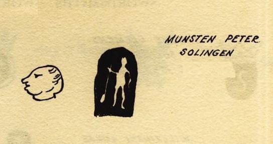

Meanwhile, these are the usual marks of Peter Munster.

I would note that the markings Fernando shows in post #3 were puzzling to me (they are in Gyngell, 1959, which I always thought reliable) as the date 1516 is too early for the recorded Munstens. Andreis and his brother Peter were born in 1547 and 1552, respectively. Thus the Gyngell date is far too early and the head mark seems more attributed to Andres than his brother Peter.
