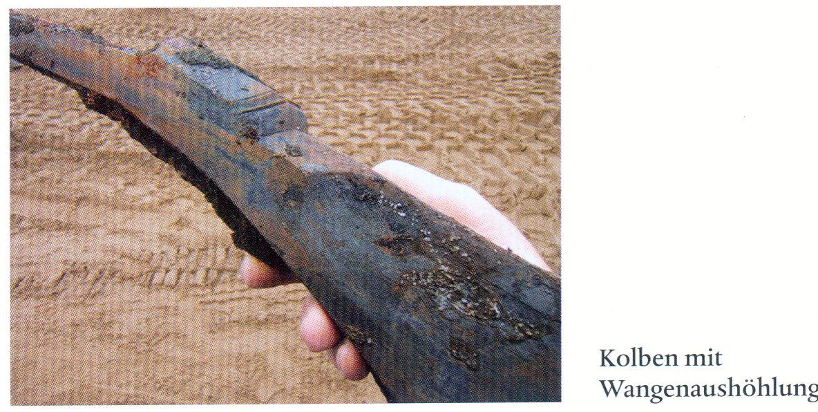

While most people still seem to be interested in diamonds and gold most of all, dreaming their 'pirates' vision inspired dreams, my first thought was right away:
THE c. 1525 type NUREMBERG SNAP-TINDERLOCK ARQUEBUSES
that, among other goods, the Bom Jesus was taking to India!
Way before even taking a first glance at what actually turned out to be two stamp-size (!) printed photos, showing some details of an arquebus stock salvaged, I was well aware of the doubtless fact that the Nuremberg gunmakers guild was trying to sell off first, and especially overseas!, the remaining number of a technically outdated model of Landsknecht guns - rather than the latest stage of Nuremberg technologic evolution of mechanism (in terms of all mechanical parts being united on an iron! lock plate).
So I feel sufficiently sure to exactly predict what the mechanisms of the Bom Jesus arquebuses must have looked like - before even getting a glimpse of an actually salvaged specimen.

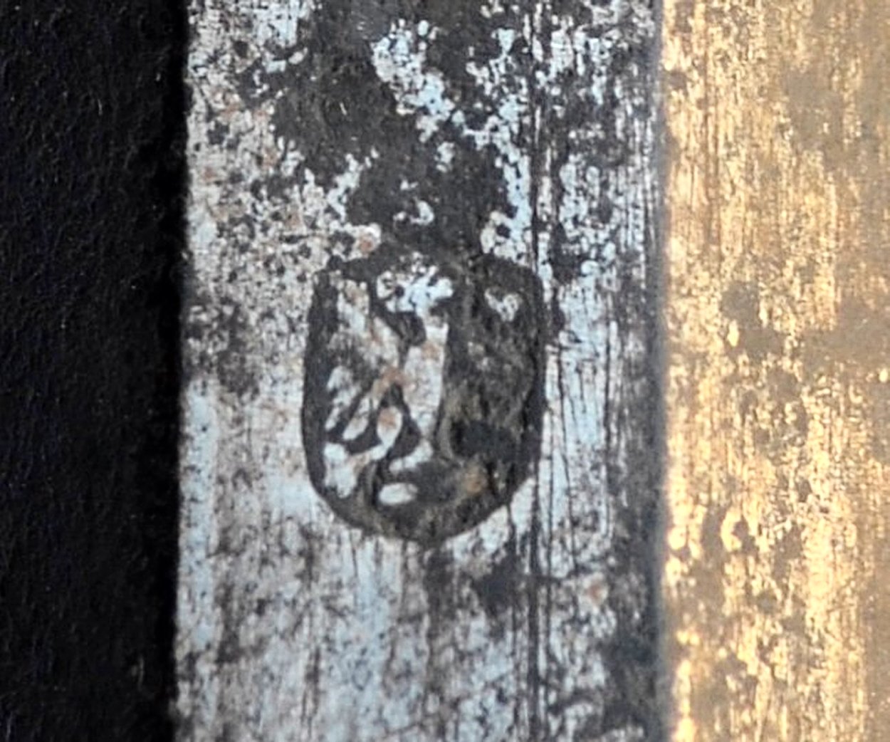

And mind you: At least a chest full of completely preserved arqebuses was found:
See attachments no. 2 and 3!

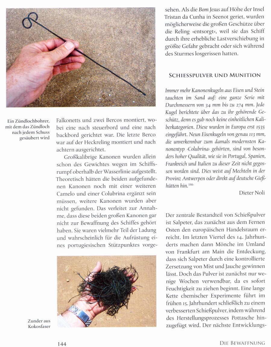

I definitely doubt the alledged fact that attachment no. 1 shows a touch hole prick (German: Räumnadel); in my opinion, this long needle with the double scroll to its upper end was a bodkin used for long hair.
Such a long and delicate object would have bent and broken right away, at the very first tryto prick the fouled-up touch hole of any
gun ...
Further down in this thread, I will attach photos of two actual wrought iron pricks preserved in
The Michael Trömner Collection.

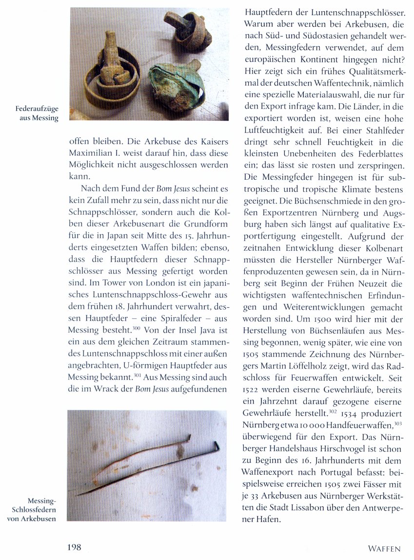

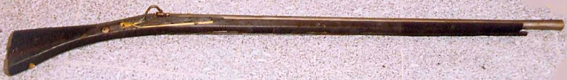

Attached to this and the following post, find some photos
of Nuremberg made snap-tinderlock arquebuses with lateral push-button triggers, and with only the serpentine riveted on a small brass plate while all the other mechanical parts like the long forward-mounted one-armed main spring (mostly made of hammered brass) were inlaid in recesses cut out of the stock, and covered up with a thin plate of wood.
A long brass-hammered spring of exactly this type is illustrated on one of the scans I made of photos of arquebuses discovered in the wreck of the Bom Jesus.
The arquebuses on my photos are preserved in the historical armories of
the
Západočeské muzeum v Plzni, Czechia,
and
the Brukenthal-Museum Sibiu,
Romania
Please note the Nuremberg control mark struck as a sign of quality on the barrel of one of the Sibiu arquebuses.
The latest stage of technological development, now uniting all parts of snap-tinder/snap-matchlock mechanism on one iron lock plate, Nuremberg, ca. 1530, is represented
by a short arquebus preserved in the reserve collection/storage rooms of the Hessisches Landesmuseum Darmstadt (bottom attachments).
Although the lock mechanism is missing from the latter gun, the lock recess cut out of the limewood full stock clearly denotes its pointed triangular shape.
Please also note that this arquebus, for the first time, features the 'modern' form of a trigger (German: Züngleinabzug or Abzugszüngel), which is protected by a rectangular trigger guard!

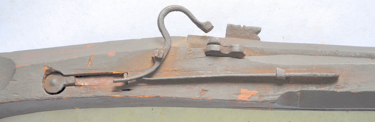

Top 5 attachments:
A Nuremberg made snap-tinder/snap-matchlock arquebus of ca. 1530, the lock recess showing the contours of a triangular shaped lock plate which united all the mechanical parts of the action.
Together with a contemporary Italian snap-tinderlock arquebus preserved in
The Michael Trömner Collection,
this gun at the storage rooms of the Hessisches Landesmusum Darmstadt, inv.-no. W 61:100, is the oldest known gun to feature, for the first time, showing the presence of the 'modern' type of trigger replacing the lateral push-button that had been used to trigger the snapping serpentines from ca. 1490-1530.
Furthermore, these two contemporary arquebuses of ca. 1530 are equipped with a vertical type of trgigger guard, for protection of the first triggers mounted on the underside of the stock, beneath the lock mechanism. The Nuremberg made arquebus in Darmstadt features an especially delicate type of trigger.
Attachment no. 6 depicts an action of the very same type, on another Nuremberg imported arquebus in the Brukenthal-Museum Sibiu, ca. 1530-35.
The author's thesis is that the arquebuses on the Bom Jesus were not yet equipped with that kind of 'modern' triggers and trigger guards.
Michael
All photos copyrighted by the author, Michael Trömner.
