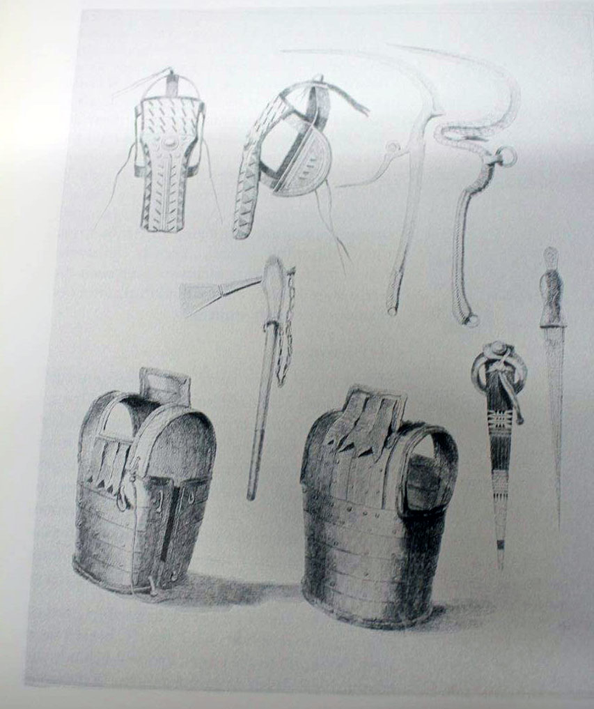

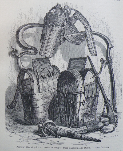

From "History of Mankind" by F. Ratzel 1898.
Thanks! Its a very similar sketch to the Denham one. The high neck protector I think was leather, I haven't seen an extant example with one, however mine clearly has holes where it could be attached.

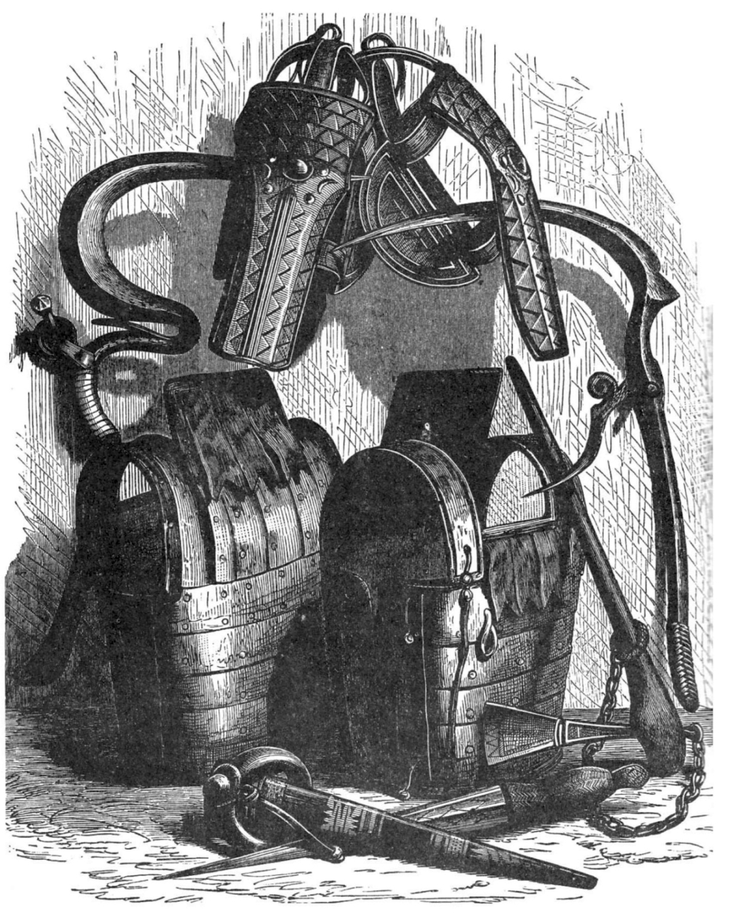

Posts: 1,492
A bit larger image, no text though.
Old 19th September 2017, 02:49 PM   #23
Iain
Iain's Avatar
Join Date: Mar 2010
Location: Olomouc
Posts: 1,720
Its based from the Denham sketch, including all the objects pictured. Friend was kind enough to send me a quick pic. Looks like the later book simply copied and changed up the pose a bit.
