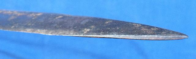

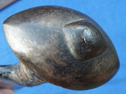

Here are some more images of the takouba. I usually think of these swords with the "walnut" one-piece pommels as being older than the layered types of pommel ??
The tip of the blade may have been reshaped - but if so, probably some time ago. The sheath has a slight curved profile, so perhaps not originally made for this sword ? Most likely a native-made blade.
Anyway, hopefully the images will explain more...

Hi Colin,
Thanks for the extra images. Yes, in general I believe these pommels are much older, or at least reflect and earlier style. The other point of age on your piece is that the leather is stitched, newer hilts tend to have glued leather.
Agreed that this is 100% a native blade. Looking at the point, it does look reshaped to me now. Seems to be a pretty aggressive edge on the tip which doesn't match the rest of the blade? Or maybe the angle is confusing me. Perhaps done to fit the scabbard? But as you say, looks like it was done a while ago.
The curve on the scabbard is perhaps due to shrinkage? I don't recall seeing anything similar, although the style of the leather work is consistent with a lot of ethnic groups in the Sahel.
The pommel I think is the standout feature of this sword, much harder to find swords like this than the flat or stacked pommels.
