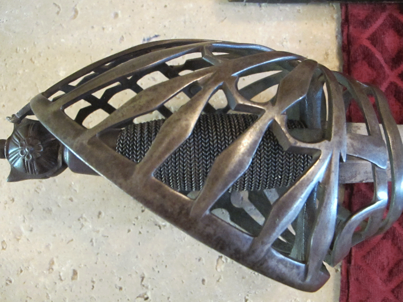

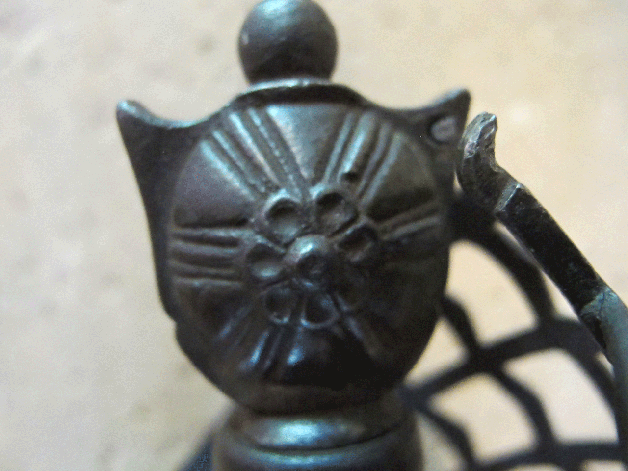

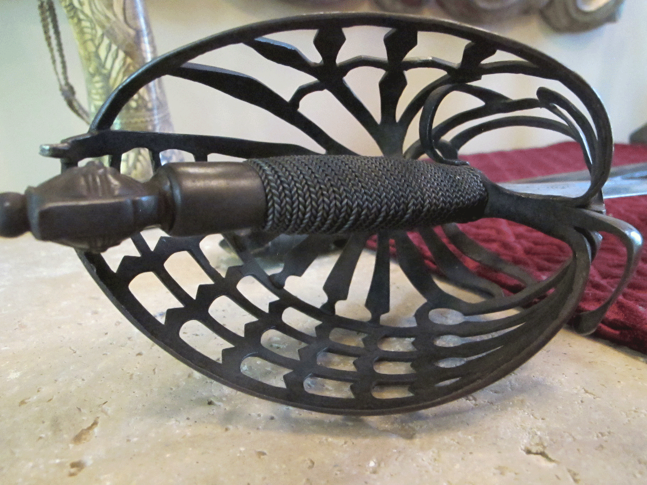

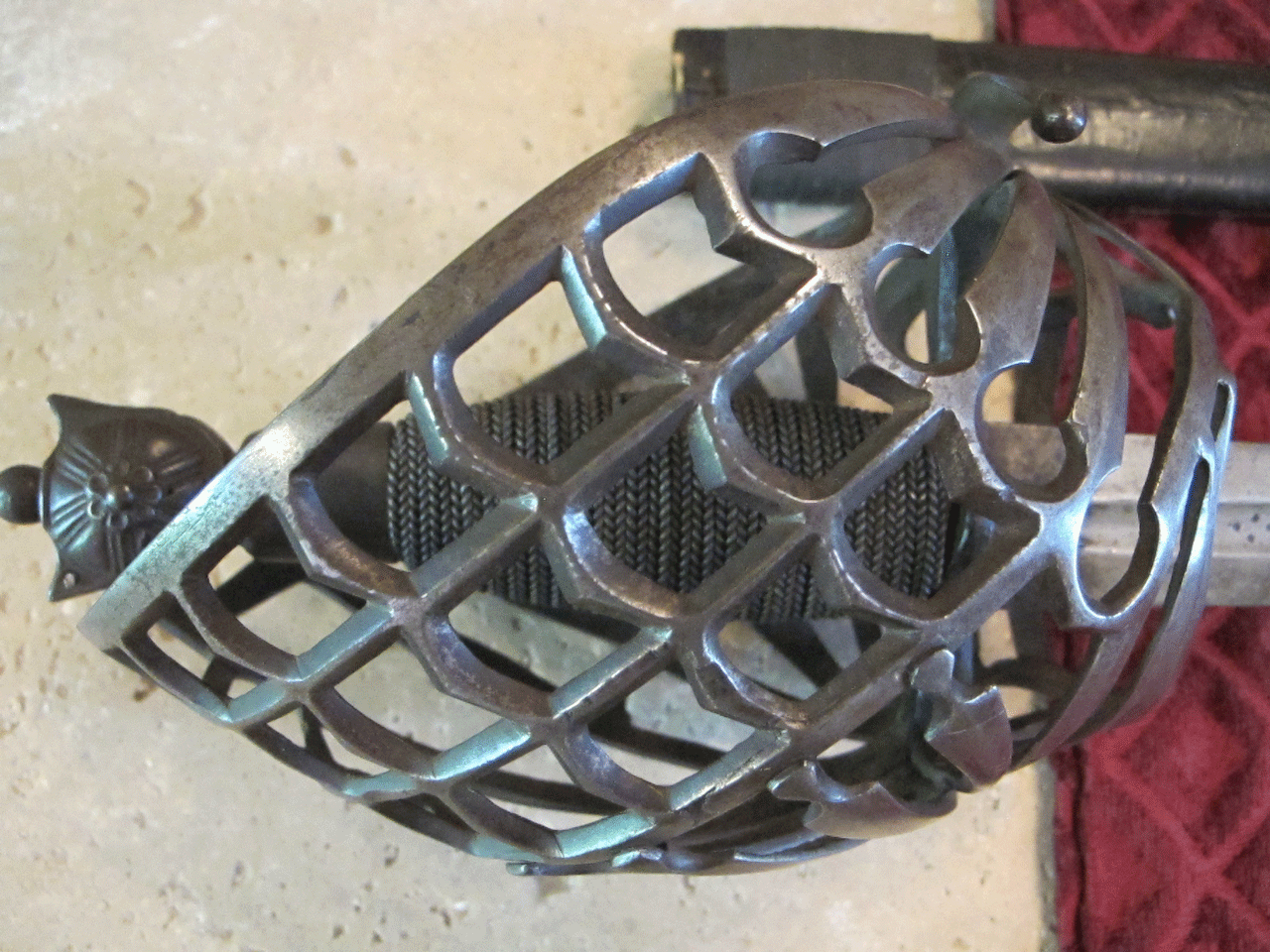

I HAVE ALWAYS LIKED THESE SWORDS BUT HAVEN'T SEEN ONE IN MY PRICE RANGE BUT PERHAPS A GOOD REFRENCE WITH PICTURES WOULD BE IN ORDER. MY KNOWLEGE OF THEM IS LIMITED BUT FROM WHAT I HAVE READ THEY WERE OF VENETIAN ORIGIN. THESE EXAMPLES ARE ALL SAID TO BE 17TH CENTURY EXAMPLES.
I HAVE ADDED PICTURES OF 6 VARIATIONS, FEEL FREE TO COMMENT OR ADD MORE EXAMPLES AND INFORMATION.

Venetian in use. However, used by central European/Slavic mercenaries, and the square cat head pommel is seen on other central European broadswords and is reminiscent of some katzbalger pommels.

Note the upturned rear quillon on two of these. Upturned rear quillons are certainly a thing one sees on European swords. This pertains to a thread about a Batangas/Luzon sword recently.
Note how the pommel lies within the basket.

"THE VENETIAN BROADSWORD OF THE 16TH CENTURY. IT HAS A BROAD, STRAIGHT BLADE WITH A VERY HEAVY ELABORATE BASKET HILT THAT COVERS THE ENTIRE HAND. THE NAME IS DERIVED FROM SCHIAVONI, HIRED SOLDIERS. THE SCOTCH BROADSWORD OF THE 17TH CENTURY AND LATER IS COPIED FROM IT. "
CAN'T ADD MUCH MORE TO THAT EXCEPT THE POMMEL IS OFTEN REFERRED TO AS A CATS HEAD DUE TO ITS SHAPE. ADDED THE LAST TWO PICTURES IN MY FILES.

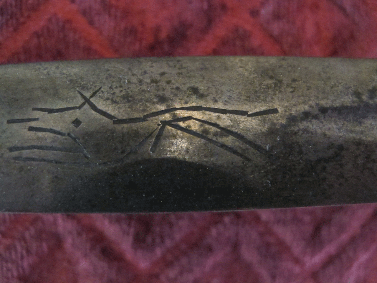

Here are photos of another schiavona for consideration and member comments. I purchased this recently at auction because I love the look of schiavonas. This sword has some interesting characteristics. The auction description listed as 18th century in the style of 16th century. Based upon another member's comments about the mouse ladder of the guard, it appears to be after 1750. the overall length of the sword is 40 3/4 inches and the blade itself measures 34 1/2". The blade is also very interesting as it has an inscription "INTI DOMNNI" and a mark which appears to be the Passau wolf. I found a web link to an opinion about this inscription. The writer believes it means something like "my esteemed lord's gift or property". Based on an often displayed chart of the design of the wolf, it is from 16th century. If the blade is German, could this still be a Venetian schiavona or dalmation schiavona? The sword is in good condition except that the wire guard which attaches to the pommel seems to be broken. The pommel is in the cat's head design, but has a flower outline instead of a cat or lion's face as we have seen with other schiavonas. Also the grip may very well be a replacement since it is a wire wrapped style and not leather wrapped as would likely have been in original condition. So what does everyone think? Is this a composite sword with a blade from a different source, or is this an original sword with a replacement grip? Any ideas on true age based on the design? Thank you all very much for looking and providing your opinions and guidance. I am a brand new member and have just begun collecting in the last year.
Bob Hurley is offline   Reply With Quote
