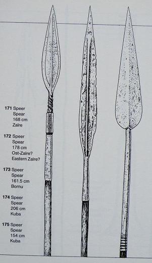

Hi David
The best I can lay my hands on at the moment is this illustration (on the far right), from "Waffen aus Zentral-Afrika" by Museum fur Volkerkunde 1985. This example is described as Bornu.
Regards.

Hi David
Regards.
Thanks Colin ,
indeed very similar. The spear length is quoted as 161.5 cms this might explain the longer socket ....due to the size, to re-inforce the connection with the shaft.
Kind Regards

tom hyle
Location: Houston, TX, USA
Posts: 1,254
There are a couple of differences between the spear we are asked about and the one in the illustration that I find meaningfull, despite an overall similar shape including relatively long nontapering sockets: first is that though the socket ends in a pointed shape in the illustration, it does not seem to indicate the cone, but two more abrupt bolster type lines that intersect. I do not think this is a version of the same feature; I think it is two different features. The second is more subtle, and is that the shoulders where the blade narrows are quite steadily rounded in the illustreation, whereas those on the question spear swing in to a very close approximation of a line that is perpendicular to the socket.
