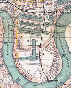

attached map of West India Docks c.1799, and painting c.1808 of the docks
