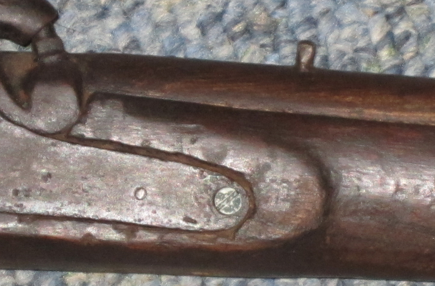

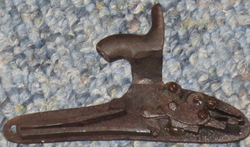

Secondly, the lockplate bears no marks at all that I can find, and nor does the lock within, save on the hammer. This has been decorated with what seem to be depictions of animals, including a rabbit, and a dotted border at its edge; I would say that this work was done by hand, judging by its irregularity and relative imprecision.

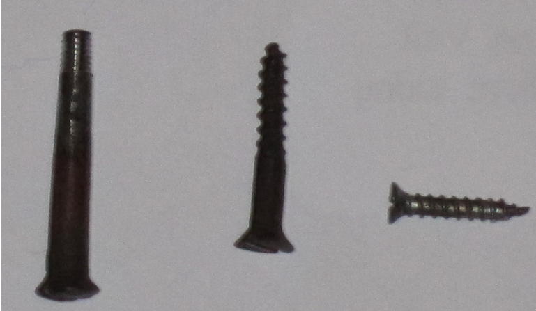

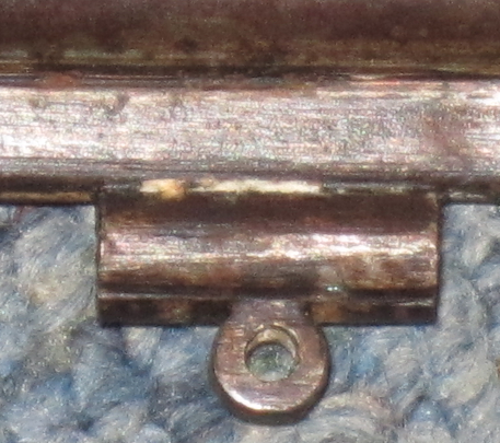

Thirdly, the build quality. The barrel displays a very slight kink (which I would put down to damage in use), but that aside, there are a couple of noteworthy points: the hammer does not strike the nipple squarely, instead striking rather towards the top of the hammer and the front of the nippkle. The snail, also, seems fairly roughly worked, without the precision I'd expect of a European gun of the period. The ramrod pipes have been brazed to their attachment strake beneath the barrel well, but roughly, and the strake itself wanders from dead centre. The trigger, meanwhile, is definitely and noticeably offset to the right, while the trigger guard (itself slightly rough) remains much more to the centre of the stock. Without wishing to malign ethnographic arms-makers, these seem a little out of place in a European sporting gun of the percussion period.
And, to add to the oddness, the whole thing is held together by modern, machine-made screws. Well, I say held together; in fact, the two lock screws do nothing of the kind. The trigger, meanwhile, pivots about a nail so modern it appears to be of galvanised steel with a chequered head!

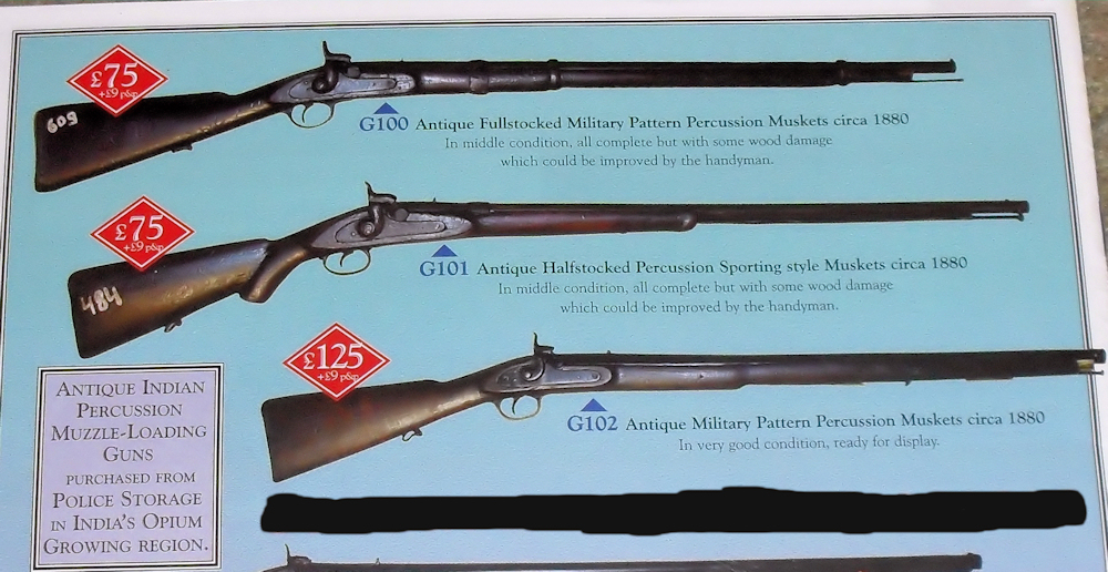

This type of gun show up fairly regularly across the UK. Supposedly from various sources, but mostly retailed by a rather 'well known' trader in the UK.
Some of them have been 'rebuilt' from separate parts, many have at the very least been 'restored' prior to coming to the UK. Including the addition of newly made replacement parts.
Yours has a newly made replacement trigger guard and some screws at least.
However, having examined a fair few of these guns, I am of the opinion that some of the main parts are in fact of relatively recent or indeed very recent manufacture.
Which perhaps should not suprise, as they are probobly still used in some places.
As Martin says, they are of 'native' manufacture.
Here is a picture of one selection of examples in a catalogue from 2001.
They were sold in grades ranging from completely 'restored', down to basically complete but needing some light work.
Yours was probobly sold missing a couple of screws and the new owner just put them in.
To be honest, the ones like you have are the better buy if you can finish them yourself.
The completely restored ones tended to be overly 'cooked' IMHO.

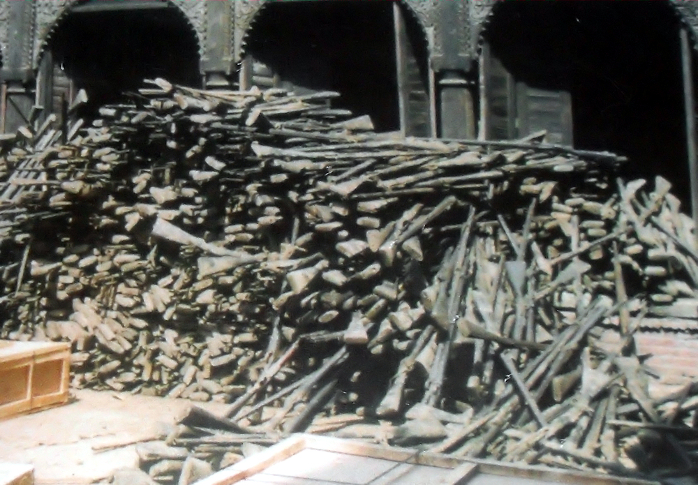

The same trader also sold 'sporting guns' from I think Nepal for a few years. There was also the huge pile of similar weapons from the 'Royal armoury of Nepal'. There are some pictures of piles of them floating about, I'll see if I can find you one.

Posts: 2,928
Here's a picture.
