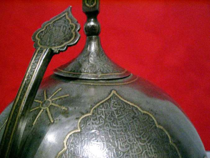

Hi
your request was; "to post as much pictures/drawings of armour from outside europe, especially from the middle-east"
this answer doesn't came very fast, but at least not the last may be
a part of my little treasures
à +
Dom
