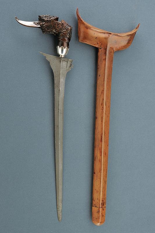

Is this a Tajong keris?
Hello Administrator, please help me to delete the last picture, Thanks.

To you question if this is a Tajong keris, the answer is no.
Tajong keris are identified first of all by the hilt form as well as the form of sarong. While we do find other types of blades in Tajong dress, the "correct" blade for a keris Tajong os generally accepted to be the pandai saras type.

Thank you David, I thougt that Keris with cross-section of a rhombus is Tajong.

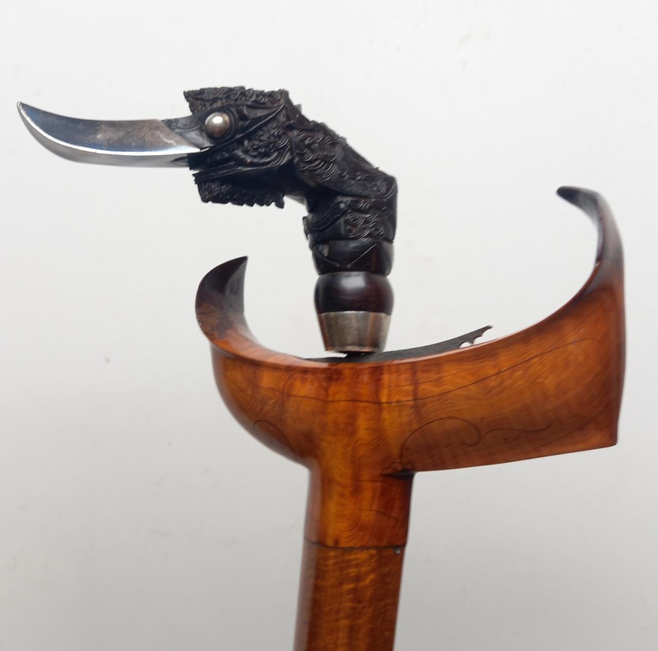

How to ID this Keris of mine?
It has an ado-ado
