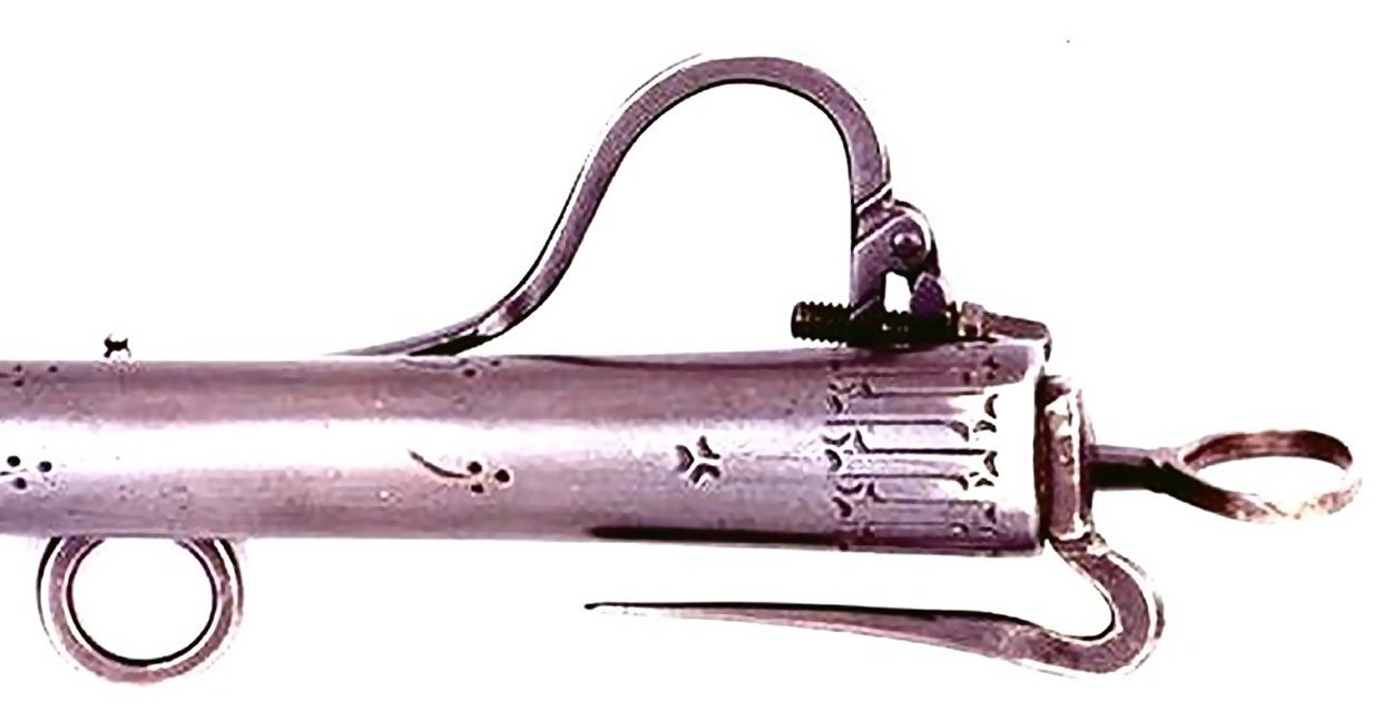

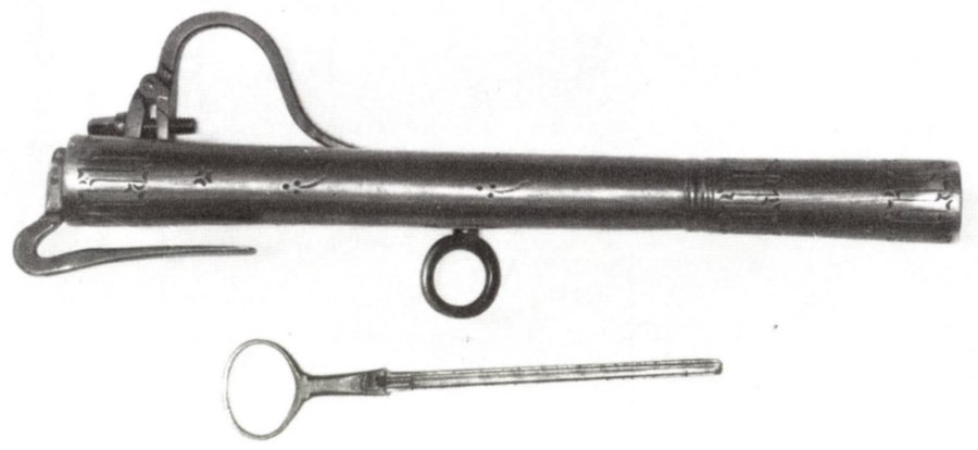

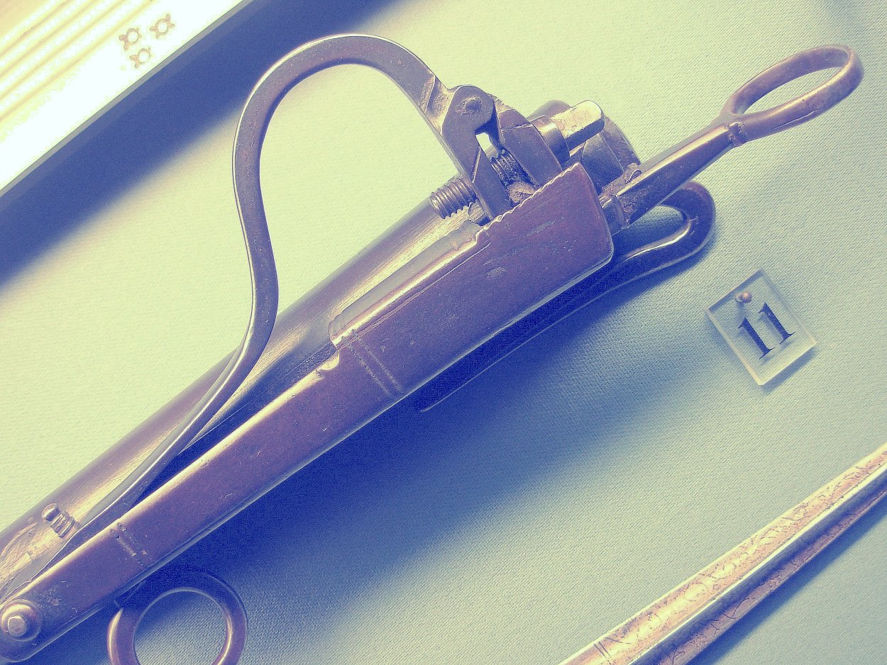

This is about a real myth of weaponry, the famous so-called Monk's Gun, which, according to the formal, stylistic and technical criteria set up by the author, should be correctly dated "ca. 1525-30", and was almost certainly made in Nuremberg or Augsburg.
Actually, the

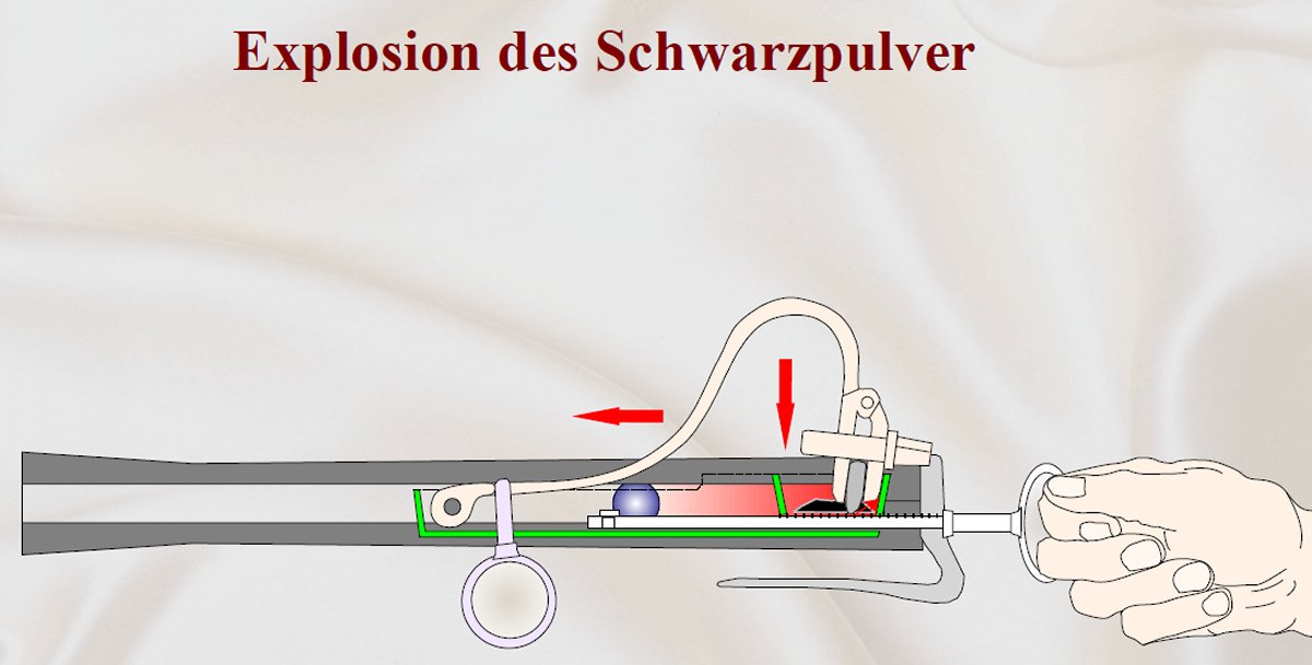

Monk's Gun is a combination of a tubular padlock and a firerarm activated by friction, when the rear ring-shaped bolt is pulled; with a usual padlock, that bolt would, of course, be a key with a threaded haft.
It is preserved in The Saxon Royal Collections, which is the Rüstkammer in Dresden.
Attached, please
find photos of the famous so-called Monk's Gun, which, according to the formal, stylistic and technical criteria set up by the author, should be correctly dated "ca. 1525-30", and was almost certainly made in Nuremberg or Augsburg.

Dating that item on the basis of the criteria defined and set up by the author for the first time, the Monk's Gun should finally stop being a "riddle" to experts of both Late Gothic/Early Renaissance ironworks and firearms.

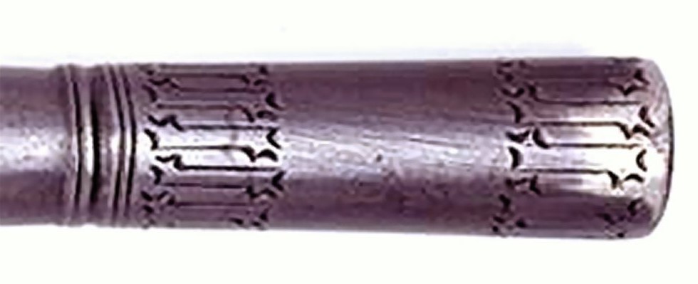

What seems to be "Gothic script" at first glance, is actually stylized letters making no sense - they are nothing but mere decoration, reminding the spectator of the past period of the Middle Ages.
The petiolated trefoil ornament
(German: gestielter Dreipass) struck as three dots and a slightly curved line, is the ultimate stylized simplification of a what originally was a bunch of grapes, retaining their stalk.

The finely made wrought-iron, blued barrel is round throughout and two-staged, with the rear section (German: Hinterstück) longer than the forward. Two-staged round barrels are hardly known to appear before the late 1530's. Up to then, the ones made of wrought iron were usually three-staged from ca. 1512-15, while cast-copper alloy barrels (brass, or bronze) for wall guns and even larger pieces were often four- or five-staged, from ca. 1515 to ca. 1530.
The earliest two matchlock arquebuses known are dated 1539 on the barrel
, and both bear the same Nuremberg workshop mark struck two times, two crossed arrows in a shield; the limewood stock of one of these matchlock arquebuses from the same series additionally shows the Nuremberg proof mark N behind the barrel tang.
The latter gun is in The Michael Collection:
http://www.vikingsword.com/vb/showth...harquebus+1539

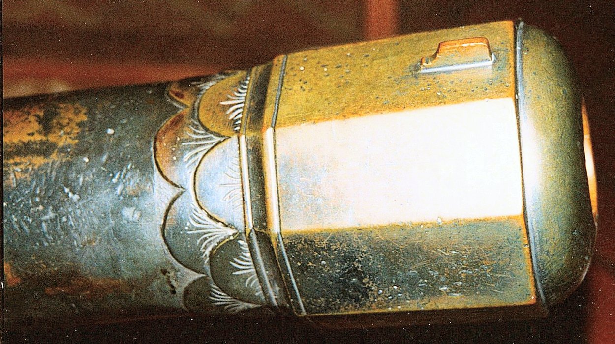

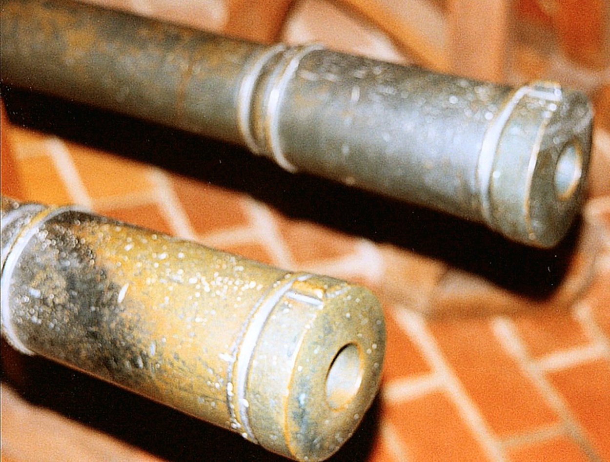

The forward section (German: Vorderstück) of the Monk's Gun is definitely elongated already, a stylistic criterion for dating that shows up on larger pieces first, and from 1522 onward. Two cast-bronze falconet barrels that were founded, and signed, by Endres Pegnitzer the Elder, Nuremberg, are preserved in the collections of the Museum at Schloss Heidecksburg, Rudolstadt, Thuringia; they came from the former arsenal of the Princes of Schwarzburg-Leutenberg, are dated 1522, with the date cast in high relief, and finely contoured with the chisel.
This section is separated from the rear by accentuated, filed moldings.
See author's photos, attached to follower post #7.

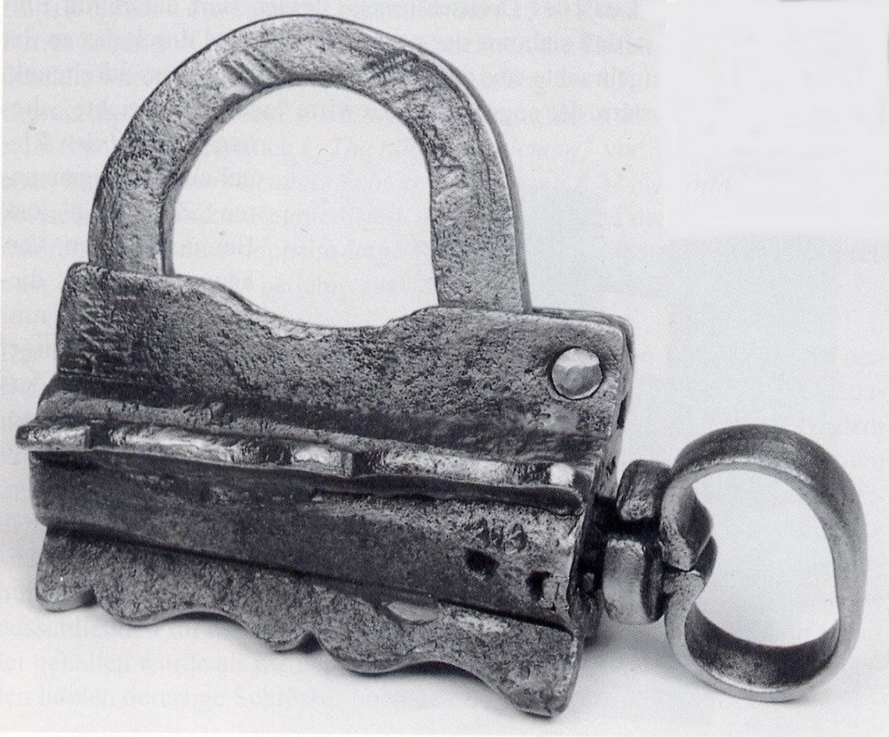

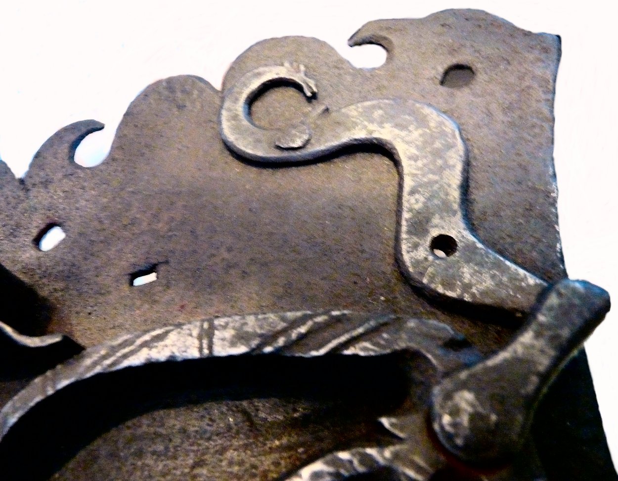

Also attached, find images of a large tubular and tapering padlock formerly in the author's collection, and also made in Nuremberg, for a heavy chest, at the very same time, ca. 1525-30.
Further, there is a source of contemporary illustration, an engraving dated 1533, and depicting two padlocks of exactly the same tapering form, securing
a large money chest.
The padlock is illustrated in:
Michael Trömner: Behältnisse für Kostbares 1500-1700. Verden, 2005, pp. 82f. and 86.
Furthermore attached are photos of similar padlocks, in the collections of the Joanneum in Graz, Styria, Austria.
