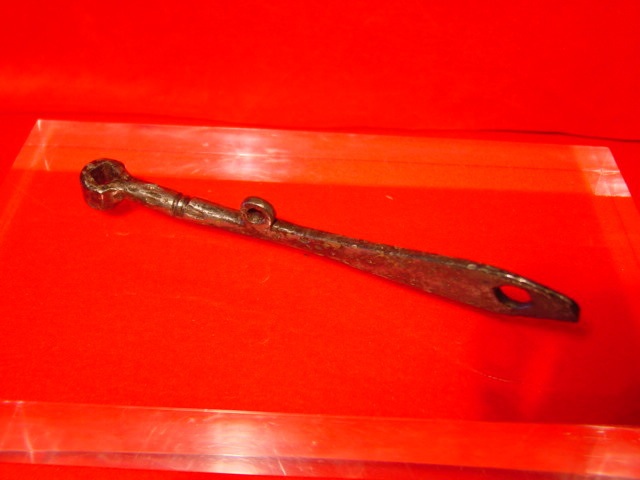

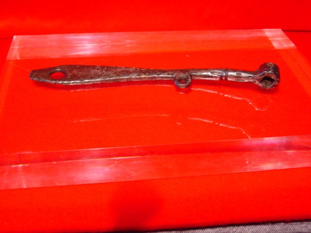

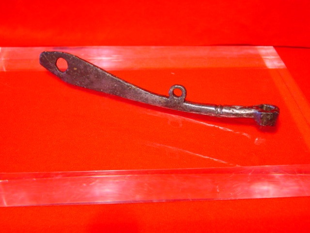

I acquired this wheellock spanner online and was wondering about the approximate dating of the piece. I have a wheellock pistol dating to the Thirty Years War with which the spanner pairs up nicely. The spanner itself is not particularly ornate, but it was a very reasonable price and certainly did not break the bank. I like the fact that both the pistol and spanner have a plain, martial appearance. The spanner is about 6" long and square opening of the spanning head approximately .25" wide.
Thanks for any input!

Hi there,
Not only is this a wheellock spanner but a combination tool, in that its flattened lower end acted as a screwdriver! The ring was for a attaching a suspension cord.
Moreover, the round hole was meant to measure and identify the caliber of the lead balls used (caliber gauge, German: Kugellehre); its small diameter denotes that the spanner once accompanied a pistol or carbine.
Tools of this kind can be dated to the Thirty Years War era (1618-48).
Michael

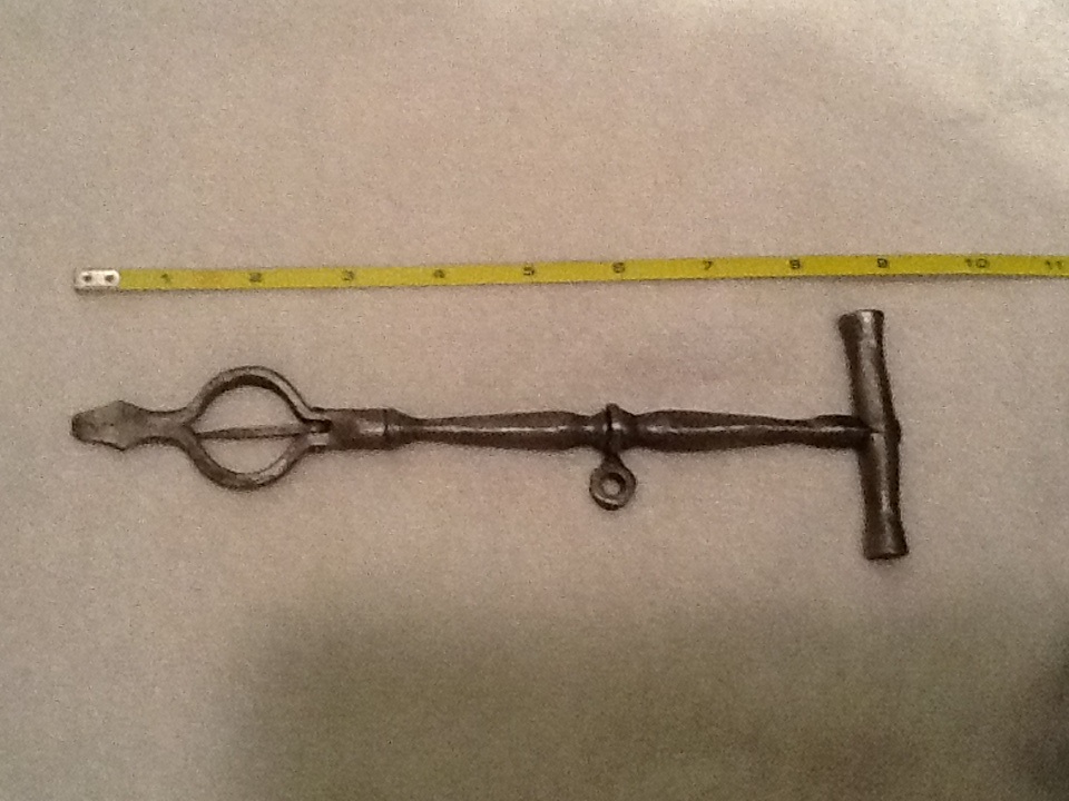

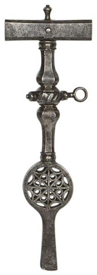

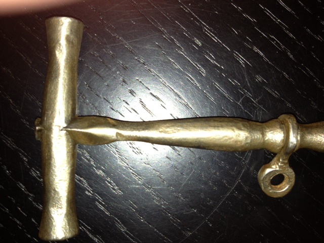

Here is another wheellock spanner I came across. Of different form than the other piece, it features a hinged spike I believe was used as a touch-hole pick, screwdriver and wheellock key. While the first example is in excavated condition this piece has only a few areas of rust. It measures 9" in length.

Hi PClemente,
Now this ia finely elaborated spanner meant for two different sizes of pinion square section, which in all probability were wheel axe and the top jaw screw of the wheellock dog, for fastening the pyrites.
This I would date to the 1580's, possibly of North Italian origin. I cannot clearly see it in the photos but the tip might be carved with an acorn and should also have a flattened section acting as a turnscrew.
I am not sure about the function of the large ring which seems to be equipped with some kind of needle - possibly a sundial? Please check this and post more images!

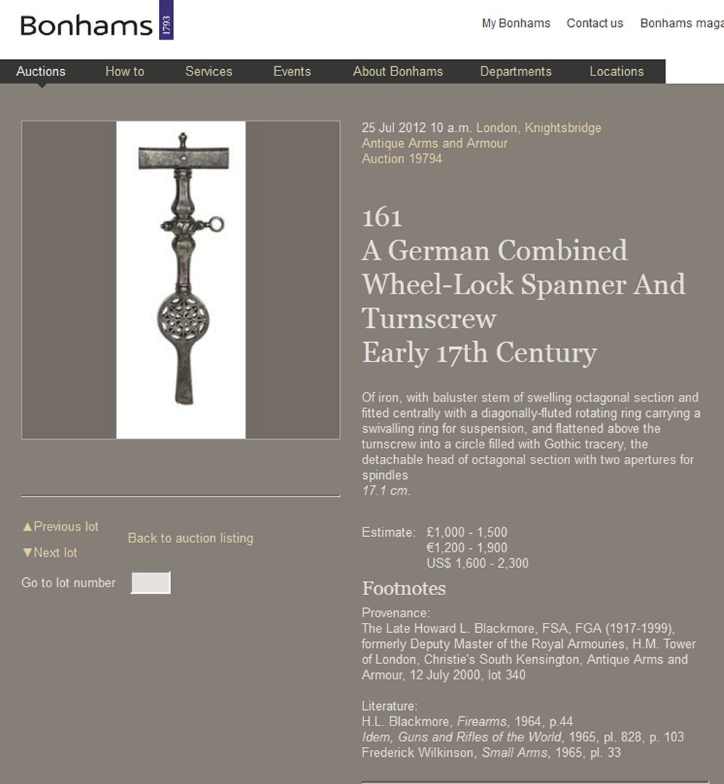

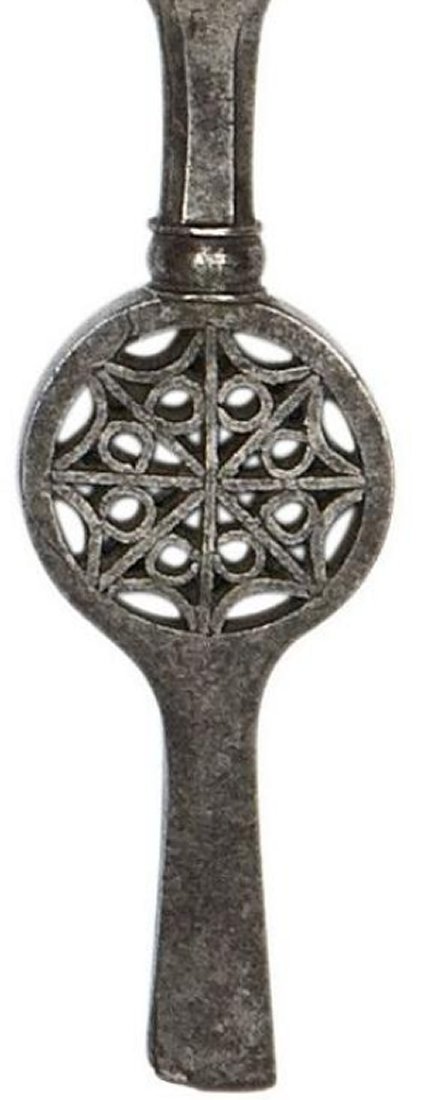

Attached find a similar spanner, the ring section filled with fine tracery in the manner the 'Venetian' keys were made; this feature, too, accounts for my assigned date of ca. 1550-80.

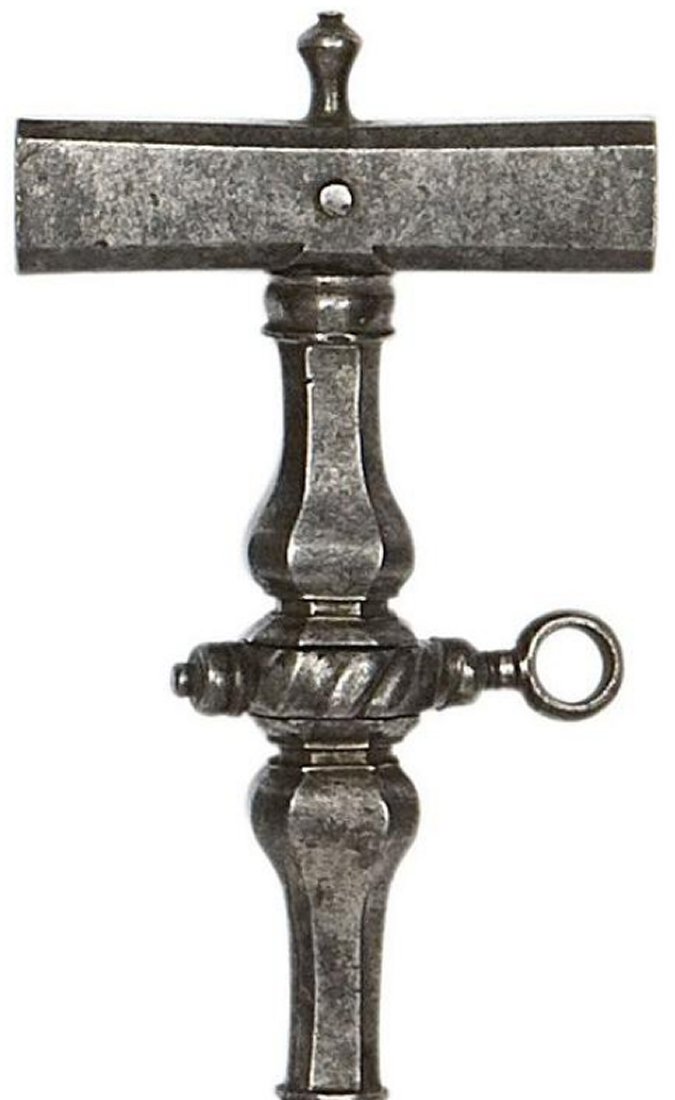

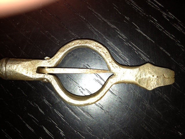

Hi Michael,

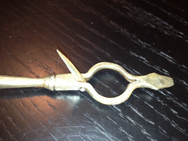

I included some additional pictures of the spanner.
As always thank you for your input!
Paul

Ahhh, PClemente,
Now I see:
It's a broach, a prick for cleaning the touchhole (German Räumnadel)!!!
I've never seen that feature combined with a spanner.
You are one luck guy then.
Michael

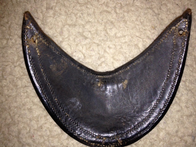

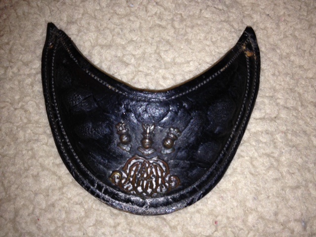

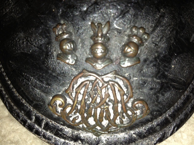

I know that it might be outside your expertise, but I have been trying to find out information about a particular leather gorget in my possession. I have received a couple of very informed and helpful ideas from a variety of sources including some from our fellow forum members, but due to your vast array of experience I thought you might also have some idea as to its specific nature. I have been told it might very well be a gorget pattern adapted during the various colonial wars here in America in the mid-1700's as officers serving the English tried to be less conspicuous fighting in the forests of North America, or a piece belonging to a Native American "gorget captain" allied with the British.
Thanks for any ideas!
