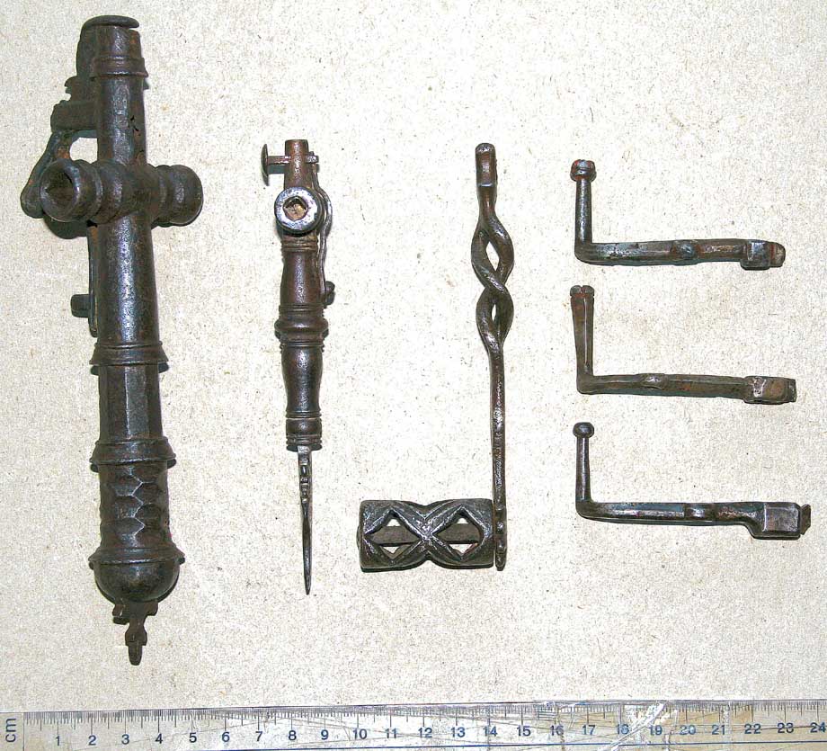

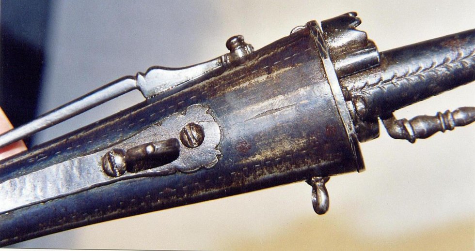

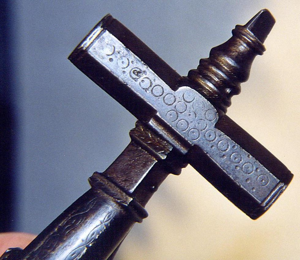

The earliest forms are, of course, the rarest to find. Many specialists in weaponry seem to have no clear basis of dating them because they (the former) lack the basic formal and decorative criteria.
Wheel-locks are known to have been in use since at least the early 16th century even though Leonardo da Vinci may not actually have invented them but rather made drawings of mechanisms he had seen to be in use.
The earliest spanner in existence is luckily in my collection. It is combined with a charger for priming powder and retains a generally Late Gothic to Early Renaissance form. Let us ompare it to the copper alloy barrel of an important Nuremberg wall piece in my collection which, on the grounds of its specific staging, can be dated to ca. 1515-20. I posted it in an earlier thread but will repost the barrel again.

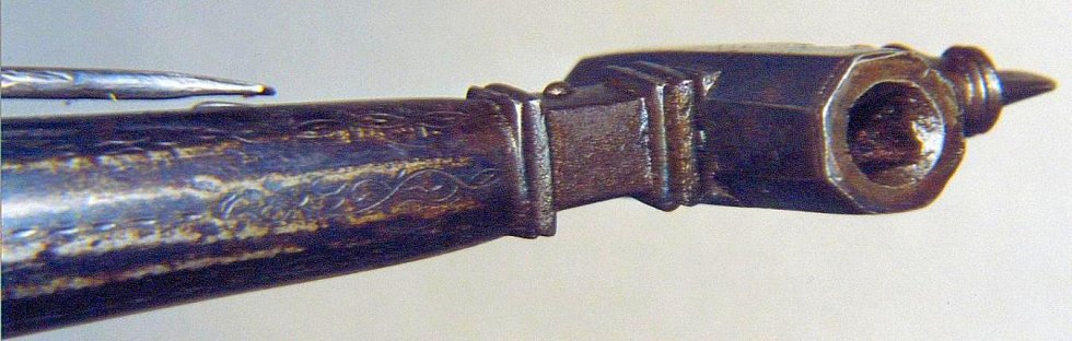

Starting at the rear, we have a cubic basal section decorated with scales on both the barrel and the spanner/priming flask combination. The next stage is octagonal, followed by a long round stage, and the most forward stage is round again. On the grounds of this comparison we can attribute the combined spanner and priming flask to the 1520's, allowing for some retardation. The trefoil shaped rear finial of the spanner is still a Late Gothic feature. The riveted ring was for suspension.
Now let us have a look at the time line of my earliest spanners, left to right:
- combined spanner and priming flask, Nuremberg, ca. 1525
- combined spanner and priming flask, Nuremberg, ca. 1560; the trefoil finial has now developed into a screw driver - a good example of an early ornament becoming a practical device. An almost identical sample was posted by cornelistromp yesterday- thank you and congratulations, Cornelis!
- North Italian spanner, ca. 1530's
- three little spanners combined with screw drivers, each ca. 1540; they were originally kept in the so-called patchboxes in the butts of the small contemporary harquebuses.
Michael

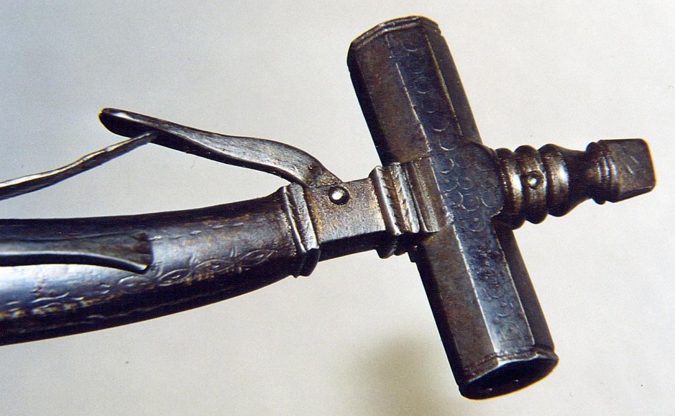

More details of my small North Italian spanner, ca. 1530, the ornamentally pierced swivel handle made in the style of Late Gothic candlesticks of ca. 1500.
Michael

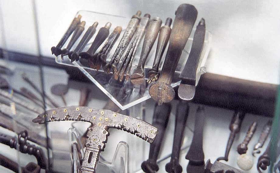

what is the afghan afghan flint hammer doing mixed with the wheel lock pieces doing there. Just kidding noticed the afghan piece on the side of pic
Old 8th April 2009, 02:53 AM   #13
Matchlock
Matchlock's Avatar
Join Date: Sep 2008
Posts: 4,310
Ward,
This combination hammer and screwdriver is not Afghan but Southern Italy, ca. 1550, and the predecessor of later Afghan items and is, of course, just part of my accouterments collection.
Michael

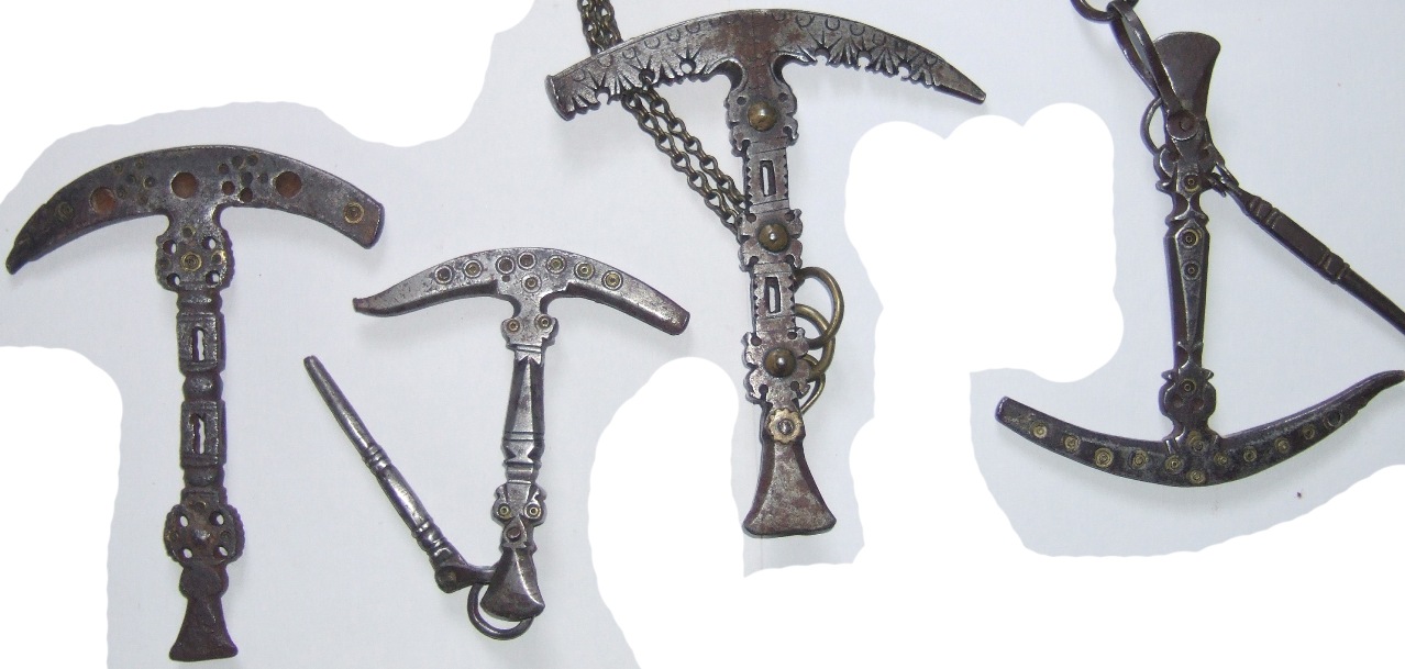

Here they are: the early Italian combined pin hammer, fire striker, pyrites hammer and screw driver, ca. 1550 (left), together with a simpler oriental form, probably Albania or Afghanistan, 18th-19th centuries.
The same decorative structure as on my mid 16th century Italian hammer is reflected by the world famous papal hammer, Rome, with which the the door of St. Peter's Cathedral was solemnly and ritualitstically opened in The Holy Year 1550. I attach a picture; please note that the wooden handle is a later replacement.
Michael

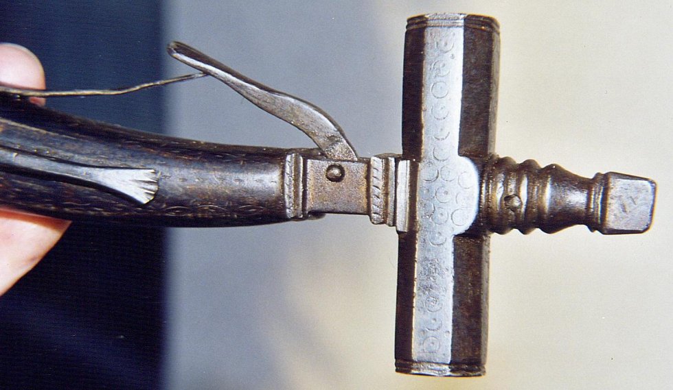

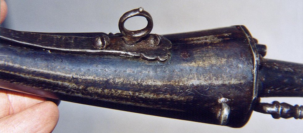

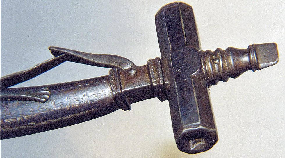

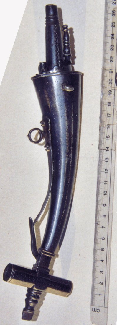

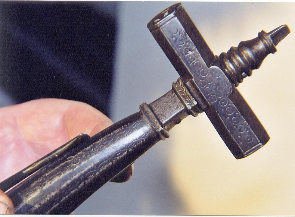

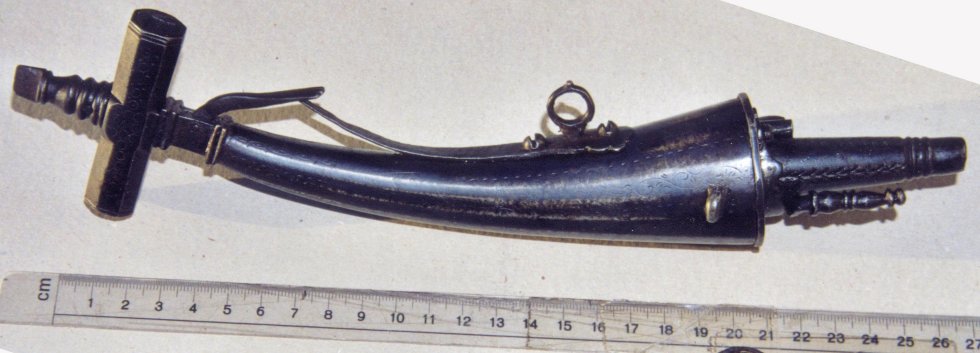

Default A Very Fine Combined Powder Flask and Wheellock Spanner

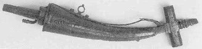

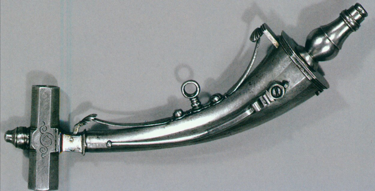

Still shaped like the Late-Gothic and Early Renaissance powder horns of natural cattle horn, which came into use again in the 18th century, especially in the U.S. The movable spanner with two different pinion squares, for the different diameters of wheel axes and tightening screws of dog jaws holding the pyrites; also combined with a screwdriver. Two rings for a suspension cord.
Northern Italy, ca. 1560, made for an arquebusier. In my collection.
Of wrought iron throughout, engraved with floral motives and a unique pattern in imitation of stitches of a seam, as they were used on early 16th c. textile covered flasks; here, this originally functional element has become mere decoration. Preserved in fine original condition troughout, retaining almost all of its blued finish.
Fitted with a long belt hook, the powder nozzle to be closed by a wooden stop plug, and with a spring-loaded cut-off lever an the top mount; the top mount lid bearing the nozzle hinged for refills.
I have documented only about a handful of surviving flasks of this kind, some of them preserved in famous collections.
Michael

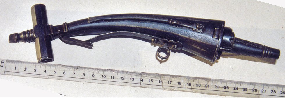

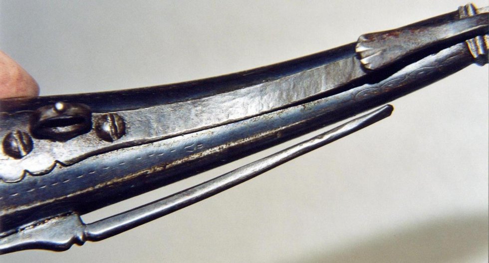

Old 27th March 2012, 05:13 PM   #20
Matchlock
Matchlock's Avatar
Join Date: Sep 2008
Posts: 4,310
The remaining photos.

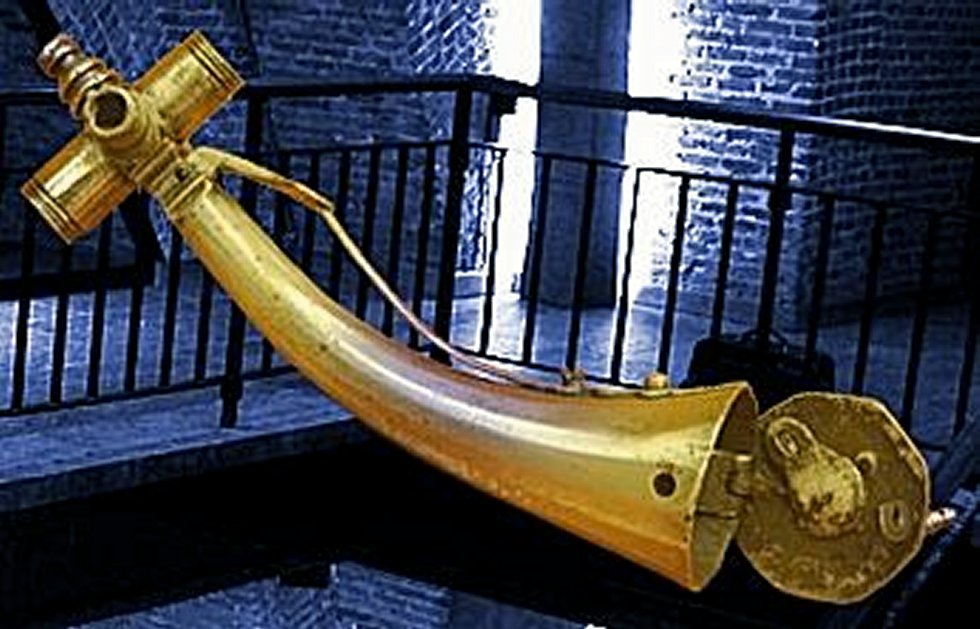

The flask attached first is the one that is closest to mine; its whereabouts seem to be unknown. The scan is taken from one of the many coffee table books that sadly do not care to give references.
Attached next is the finest known sample from the series, etched all over, preserved in the Odescalchi Collection, Rome, but both the wheel spanner and screwdriver are missing.
The following is said to be in a French private collection, the turn-lever spring of different construction.
Next is a specimen in the Musée de l'Armée Brussels, showing the hinged top mount open, the screwdriver missing.
Follows a plain sample in the Wallace Collection, London, the cut-off and screwdriver both missing.
Finally attached are two plain samples from international auctions.
These are all I have ever come across in more than 30 years of studying.
Michael

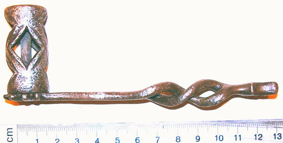

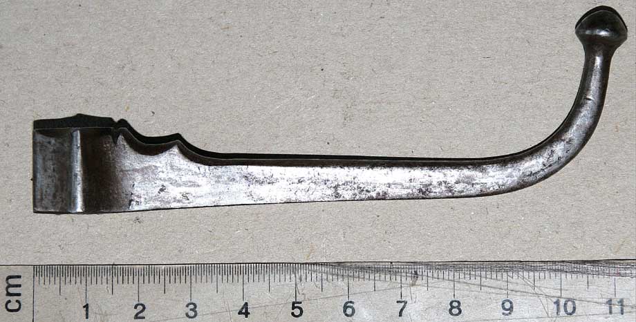

Default Unusual and Early Wheellock Spanner, ca. 1530

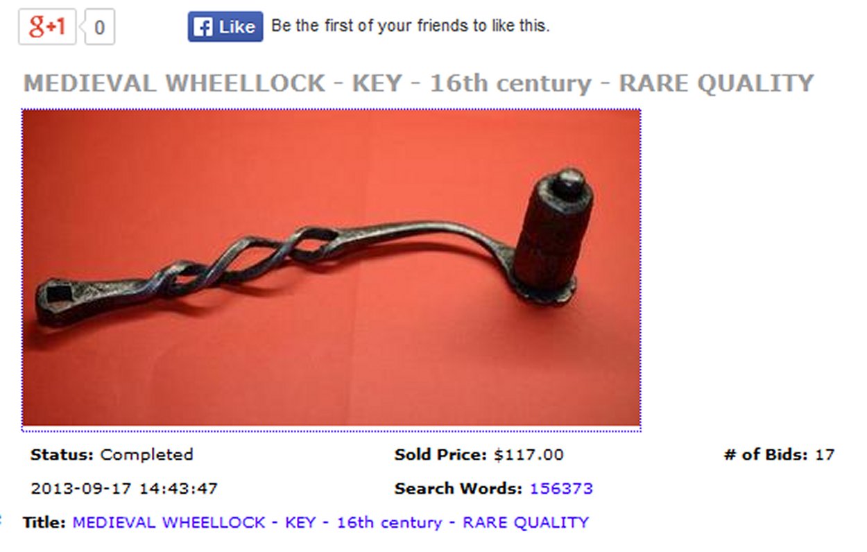

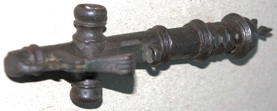

This is about the fine spanner in my collection: North Italian Early Renaissance, ca. 1530, finely wrought, pierced and twisted for decoration by the smith - see post #6.

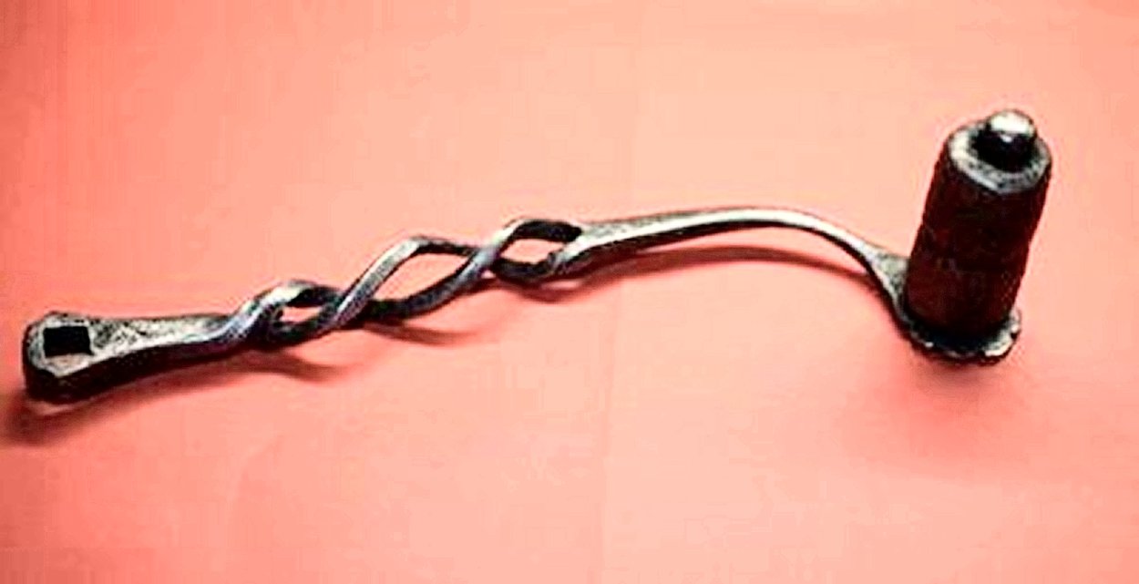

Meanwhile, I have found references for two more, very similar specimens; although they are notably plainer in terms of craftsmanship - none of their handles is pierced - , I am happy to post these photos.
For easier comparison, I reattached three photos of my spanner on top.
Attached following are:
- a spanner in the collection of the Muzeum Wojska Polskiego (Polish Army Museum), in Warsaw
- another, similar spanner, sold on ebay, 17 September 2013
Michael
