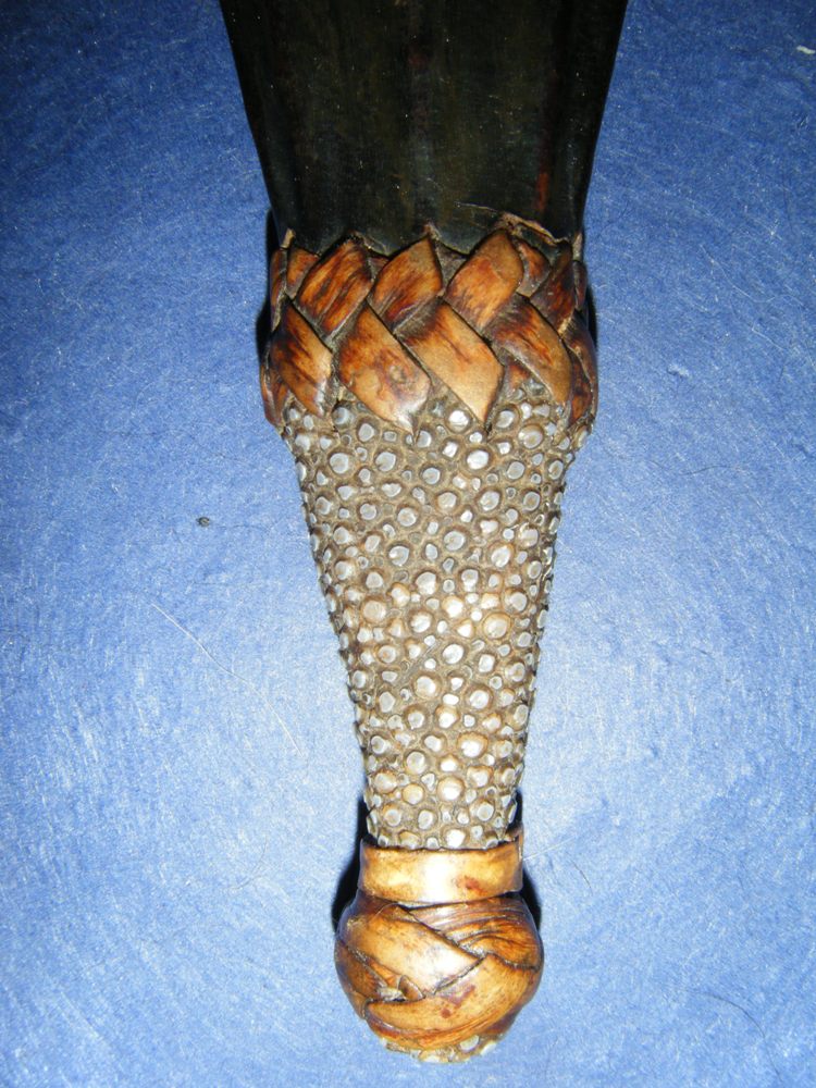

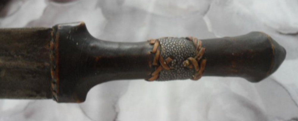

Hello dear members,
I've just purchased this West to North African dagger but I am unsure about the exact origin, the only similar example I've found is listed here: http://www.memoire-africaine.com/armes2.html and described as Touareg dagger but I doubt a little bit that this description is correct. Is someone able to confirm this description or know it better?
Thank you very much in advance, first picture is from the seller and show the dagger in question, the second picture is from the above given site. The dagger in question is 34 cm inside it's scabbard.

A good, uncommon dagger Detlef ... well done. I think I've seen these described somewhere as Baule, but whether that is a correct attribution, I can't say.
However, I am confident its not Taureg.

Old 14th May 2018, 01:50 PM   #4
No other comments regarding the origin of this dagger?

like you I've looked in direction Baule but can't find something similar. But I've looked for Manding also but sadly no match until now. Can you show pictures?
Until now I don't have it in my hands but here the other seller pictures, maybe someone get an idea by remembering a similar workmanship.

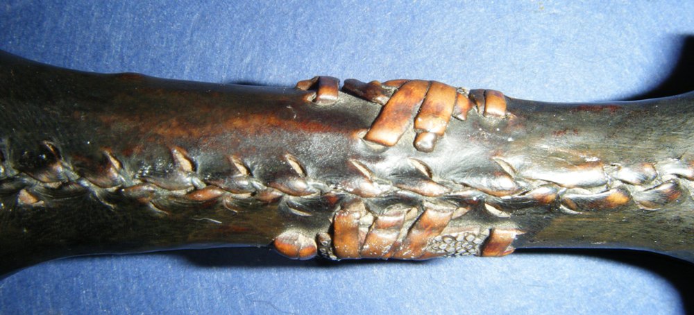

I seem to becoming obsessed with trying to pin point the origin of this knife. Is it possible to provide clearer pics as my eyes aren't to good these days. Could you also confirm the construction of th hilt i.e. Just wood or leather covered wood, material of plaited band around centre of hilt also materials of scabbard and the decorated band.s at the chapel and throat, sorry to be such a pest
Hi Miguel,
like you I would like to know from where this dagger coming. So you can't be a pest! I will post better pictures with many close ups soon as I have it in my hands, the seller was a little bit circular but it's on the way to me and will be next week here. But I think both, scabbard and handle are wood covered with leather and in up and down from scabbard and in the middle from the handle is sewn lizard or snake leather with sinew, that's what I think to see. But I will describe it again when I have examined it.
Sajen is offline

Hi Detlef,
the small sewn on pieces of leather are neither lizard, nor snake. It is sting-ray skin.
Best
Martin
Martin Lubojacky is offline

..the small sewn on pieces of leather are neither lizard, nor snake. It is sting-ray skin.
Hi Martin,
thank you for correction!

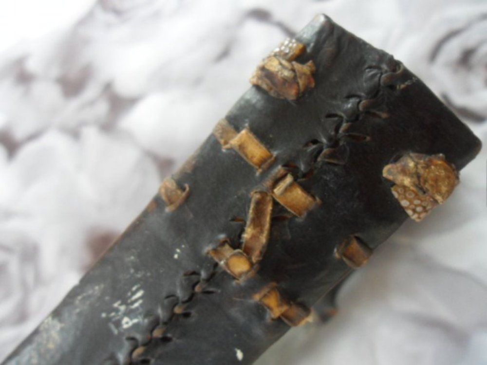

In the meanwhile I've received the dagger and it's worked like supposed, the white spots on the scabbard has been wall paint, I was able to remove it unvisible. Ca. 33 cm inside scabbard, 31,5 cm without, handle 10,5 cm long.
It's a very nice worked small dagger, maybe not extremely old or early collected in a very nice condition after it has received a little bit TLC.
Here the promised pictures. Still hope that the exact origin can get identified.

Yesterday I noticed this ID request from Detlef. Here I can help. Your dagger is from Benin, former Dahomey and belong to the tribe "Bariba". They are located in the northeastern part of Benin and today around 1 million people. Some also to find in Nigeria.
Here you can find my examples, one short sword and two daggers.

There is also one old example in the MEG
http://http://www.ville-ge.ch/meg/mu....php?id=009062 .
Last not least here some of this daggers in the Überseemuseum in Bremen/Germany and a map.
