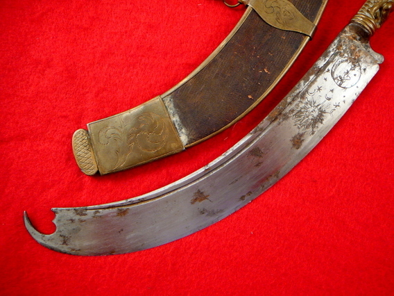

I received this beauty tonight and luckily my mom saved the auction pictures. I'm totally at a loss as to where this might be from, how old it is, etc. I'm posting it here because it's my understnading that these cast brass handles are 1800s Europe? The blade has the man in the moon, suns, and panoply markings; I think they seem copied, and not original trade markings, or is this not the case? The extreme curvature of the blade and the unusual tip is fairly unfamiliar to me.
Thanks in advance for any help!

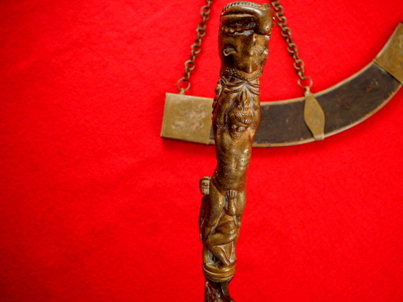

And more photos:

Hmmm...very interesting piece!
OK, I'll take a stab at it. First off, it's of the period late 18th-early 19th century, based on the scabbard more than anything. It looks French to me, with the stylized hilt classic for the period and again, the scabbard also in the French pattern. At first glance, I thought perhaps it was a cut-down blade, but now I think it is original. The markings are indeed copies of markings found on hangers and cuttoes of the period, and although not of the same exact quality, still wouldn't call them 'crude'. These markings fell out of favor by mid-19th, so I don't think its of the later period.
Weighing all this, I would say that this is either a small hunting hanger based on the markings found on other such hunting swords (definately not a fighting sword) and resembling many of the side knives seen in hunting TROUSES...or it's just a stylized piece of cutlery made as a "show-off" piece. Still, it's pretty cool. The curved point end could have been used to help split open the game/hide. Note the fuller/blood groove, again leading me to suspect hunting knive/sword.
How long is the piece,BTW?

There are lots of half-moons motifs, including one at the top of the halberd, where it's outright abnormal. The design is european, so perhaps we should look at an european country that had significant islamic presence in the mid-19th C.?
Albania, Hungary, Croatia, Turkey, Montenegro, etc...?

Thanks for the replies so far! The straight-line distance from the end of the handle to the tip of the scabbard is 14.5 in. Blade length approx. 9 in.
I did mean crude in a comparitive sense, of course. It's quite a pretty piece, and still VERY sharp, so a hunting sort of knife makes perfect sense. I wonder how the motifs of the handle may relate to hunting in some way? I'm actually quite interested in what the handle is supposed to represent. Also, do you think the stylized tip might represent a heart?
M ELEY and everyone, I would be very interested in seeing scabbards and hunting trousses in general of this time period for comparison!

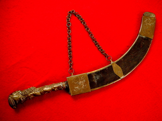

I'm jealous, that is a really nice knife. I also think hunting, the hooked part looks to have been sharpened on the inside useful for gutting game I think. Continental European and early 19th Century would be my guess, but it is just a guess. I think if you look to the classical Greek or Roman
myths and stories you'll find the meaning with regard to the handle. Unfortunately the last time I sat in a Latin class was about 40 plus years ago so you'll need someone with a more recent interest in the Classics. Again nice piece.

Isn't that suspension chain somehow 'non operational' for a field hunting dagger ? Doesn't it sugest, as the rest of the decoration, a sort of presentation cerimonial dirk type specimen ?
Sorry if i am talking nonsense .

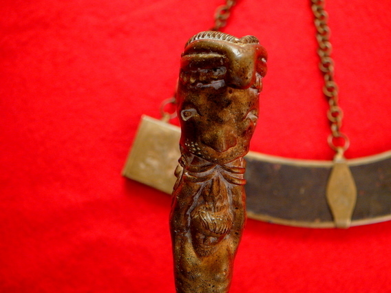

Neat piece! To me, the most surprising thing is that it's sharp. I would have guessed that it was dull, given the odd shape, the chain hanger, and all the symbolism.
I'm starting to wonder if those figures on the handle aren't supposed to be Dionysius (or Bacchus) with a satyr covering his crotch so that he wouldn't appear nude. That design has me scratching my head, because I know Greek and Roman mythology pretty well, and it isn't ringing any bells. I'm also wondering whether the design is supposed to be (homo)erotic in some way, or merely humorous. In guessing that it was something to do with Dionysius, I'm going with the humorous interpretation, but I really don't know. Perhaps Samson? I'm missing a clue here.
I'm not sure what to make of all the blade markings, but someone went to a lot of trouble to do sun, moon, starrish things and a fascus, spears, swords, and drum.

The tip is NOT sharp, nor is the interior of the "heart" shape. And the sharpening job definitiely looks intentional and by design; it goes from a very keen edge and gradually thickens to about 2 mm thick. I.e. it doesn't look like a tulward ricasso, where it goes from sharp to dull somewhat abruptly because the blade just stopped being sharpened.
The chain does indeed appear to be non-functional. In fact, suspending it by the chain makes the blade hang almost vertically upside down, because the brass handle is so heavy. Suspending it by just the attachment point closest to the handle makes the knife hang approximately horizontal.
I like the Baccus idea (there do appear to be grapes there) but the guy holding the other man's crotch is definitely a human, as you can see his toes in one of the pictures rather than a goat-foot. My brother-in-law suggested the hanging man could be Prometheus?

The curiously profiled blade tip on this piece seems to correspond with neoclassic and artistic decoration more than practicality, and seems deliberately dramatic to add to the aesthetic effect. It brings to mind the often consistantly seen features often seen on blades that seem to defy any practical purpose or symbolism, such as the deliberately placed notches on Austrian cavalry sword blade backs near the point in the 18th century.

In my humble opinnion, the chain is also fundamental to find this piece's purpose.
Say Radleigh, is the chain band placed at the middle of the scabbard, fixed (welded, riveted), or could you slide it towards the tip ... in a way that it would hang correctly, when you suspend it by the chain ? Are the chain links open or closed (welded) ?
In other words, if this piece can not be (belt) suspended, isn't it hard to conceive that it was made to be used on the field.
Wouldn't it therefore be a domestic implement ... to be laying on a table, the chain being only a fantasy. As Fearn sugested at a certain stage: "Perhaps it's a super duper fruit and cheese knife for a high end party ?" Or similarly a presentation cake knife ), offered to a big shot of the period.
Isn't its design rather awkward, blade curvature plus bizarre tip, to be used in animal surgery, or as bleeding fleam, or for butchering ?
... Just thinking aloud.

The chain seems a decorative element, much as seen on ceremonial and parade swords in certain cases, and suggests possibly presentation, or diplomatic gift type item, as does the elaborate motif of the piece.

I wish I could remember where I saw a blade tip something like this..I think it was the falchion or something like it in Stone.

That would seem sensible but a gut hook needs to be very sharp and the inside of the tip does not seem to me to be sharpened for the task; also the extreme curve would seem to make gutting prey very awkward .

That chain appears purely decorative as the links do not appear to be welded or soldered for strengththening purposes .
I'm kind of leaning towards Fernando's point of view .

That's why I called it a fruit knife back there. Anyway, there's a way to settle the "gut hook" issue. Try to use it, preferably on something soft and harmless like a piece of paper or a paper towel. Of course, most of us have bought knives that can't perform their putative functions, but if it really can't cut, that might tell us something.
The first thing that tip reminded me of was one of those faux forks on the tip of a cheese knife, and that, combined with the goat head and grapes up top made me think of a party piece.
A couple more observations. One question: is the bound figure a man or a woman? The figure below is definitely male, and while I agree that he doesn't have goat hooves, the satyrs that accompanied Dionysus didn't necessarily have hooves either (Wikipedia Dionysus and satyr picture link; Wikipedia Satyr article ). Alternatively, it could be a bound woman with a man between her legs.
I still lean towards the bound figure being Dionysus or Bacchus. Man or woman, the symbolism on the handle is more consistent with partying than with hunting, in my opinion.
