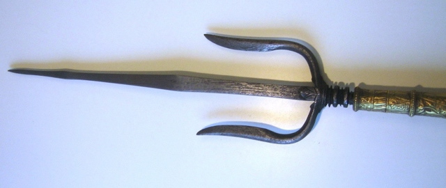

Default Trisula of unknown origin
It's not a Keris but I think it's Keris related so that's why I choose to post it here instead of the other part of the forum.
I have tried really hard to find the origin of this Trisula spear.
I have discussed it with several people experienced in Tombak but so far I have only got indications, but no definitive opinion, of its origin.
Hopefully someone here recognise something on the parts of this spear to give me a clue on where to search further?
Maybe some of the motifs or other small details that you have seen on other weapons from a specific area?
For earlier opinions and more pictures:
http://www.kampungnet.com.sg/modules...view_album.php
Michael

Hi Michael what a very nice trisula this one is from java 17 centh

Hi Ben,
What elements of this trisula suggest Jawa 17thC to you ?

This is an interesting opinion Dajak.
Will you please tell me what the specific characteristics of this tombak are that allow you to be definite on a 17th century Javanese attribution?
I would most especially be interested in your interpretation and specific classification in terms of tangguh of the metuk.

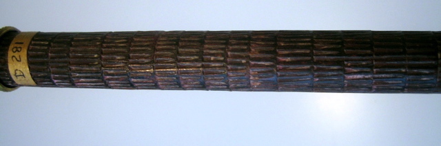

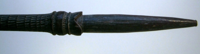

The wood is old style java with the little carving in it and trisula point is 100% from java late 1600 early 1700
This is what the Dutch Chairman off the kris club from the Netherlands told me
when it was in my collection and I showed the trisula to him he told me it was an outstanding piece.
He is more professionel on this stuf then me
I will ask him what this trisula make s it from java.
Ben

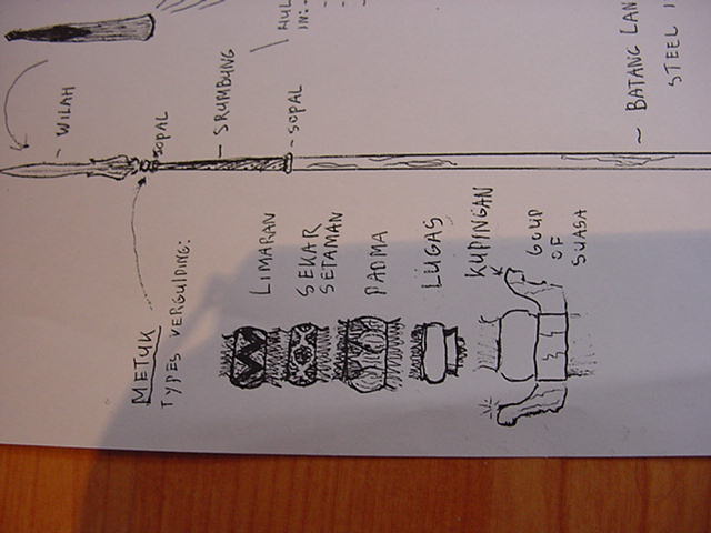

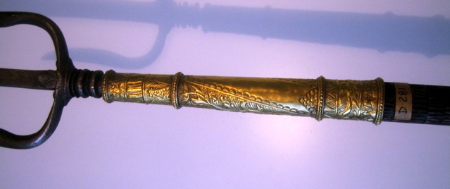

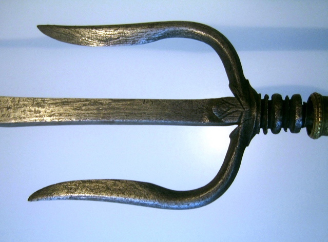

I'm not so interested in the landean , or sopal, although I must admit, to me these look Sumatran, but that is only a gut feeling I cannot substantiate. The fact that there is no tunjung I find an anomaly.
What does interest me in the extreme is firstly the metuk. I have never encountered an attribution to Jawa for a metuk such as this. It is similar to a metuk that was on a tombak in the Sydney Museum of Applied Arts and Sciences. This tombak was attributed to "Malay", and that museum was replaced by another many years ago. I place no reliance at all on the "Malay" attribution of this Museum.
Secondly the material is out of stain, and displays very little weathering or erosion.In fact, file marks can still be seen on the surface of this tombak The grain of the metal I find difficult to relate to any Javanese classification, and the fact that it is out of stain makes the reading of the material, most especially from a photograph, extraordinarily difficult.

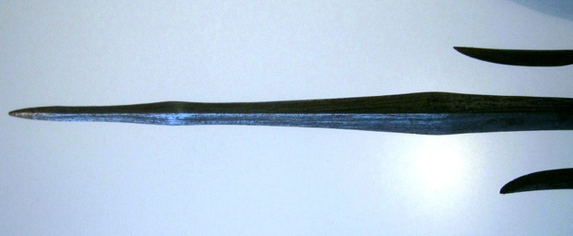

Looking at the individual sections of each component part of the three blades we have a square or rectangular cross section in the base of the central blade, we have a diamond cross section in the front part of the central blade, we have the side blades formed from round bars with the forging out to an edge only on the inside edge, not the external edge; the overall proportion is elongated and rather narrow, not at all pleasing to the eye if looked at with a Javanese standard of evaluation. There is some unusual file work and ornamentation in the base of the central blade and at the point where the side blades spread. I cannot relate this to any Javanese trisula I have seen.
Comparison of the overall form of the blade with a Surakarta Pakem book has revealed nothing even remotely similar.
Comparison of the overall form of the blade with tombak and trisula of known Javanese origin has revealed that similar characteristics to the ones that exist in this trisula cannot be identified.
Because I cannot positively identify this trisula I am not prepared to say that it is definitely not Javanese, but I am prepared to say that in more than 50 years of collecting I have never seen a trisula similar to this that has been given a positive Javanese attribution. Nor have I ever seen or handled a tombak or trisula with similar characteristics to this this one, that could be given a positive Javanese classification.Added to this I can find no reference in print that would allow even the hint of a possible Javanese attribution.
If anybody were to state positively that this is Javanese, such a statement should be backed by justification in terms of classification of material, metuk, and overall form. Other than this, eye witness verification of the actual manufacture would remove all argument.
I just reread what I've written above. The "eye witness" thing sounds as if I am being sarcastic. It is not intended that way. What I had in mind was that it is entirely possible that manufacture of this trisula could have been witnessed. If, say, it was commissioned by some Dutch colonial, in Holland it could have a family history that grand uncle so and so ordered it when he was stationed in Semarang.Some documented history such as this would put the lid on any debates based on tangguh.

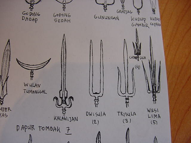

On the shape of the Trisula spearhead I found this old reference picture on the Internet.
To me it seems as if the upper Trisula has some resemblance to mine of the spear head design and proportions?
It doesn't have any further description than it's Java.
But the Keris on the same picture is of course from Madura?

I'm afraid I cannot see a real lot from that picture, Michael.
Yes, either of the top two tombaks could be considered to have a degree of similarity to yours, in one way or another, but personally I would not be prepared to make any comment as to relevance , based upon that picture.
What I have been taught, and what I have observed, is that the two overwhelming indicators for classification of a tombak are material, and the metuk.
In the case of your trisula, the material is almost impossible to read, and the metuk is so far divorced from any type I am familiar with that I simply cannot even offer a wild guess.Looking at what I can see in that trisula, I would not be prepared to say more than "South East Asia".

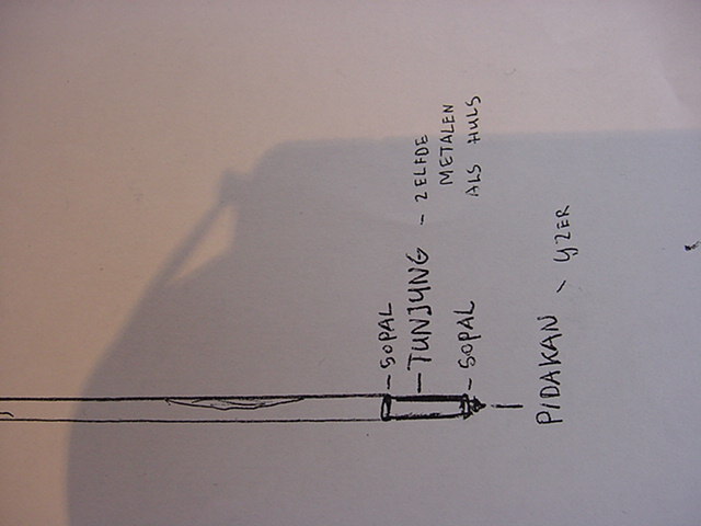

Regarding the tunjung.
I have yet to see a Javanese tombak landean that does not have a tunjung. Even simple village quality ones have some sort of tunjung. What I can see on your landean is an area of ornamental carving where there should be a tunjung. The tip of this length of carving is scuffed, which would seem to indicate that there has been no tunjung there for a very long time, and possibly there never was one.In fact, since the end section of the landean swells between its tip, and the area of bulbous and foliate carving, it would be difficult if not impossible to fit a tunjung, so I think we must assume that there never was one.If there never was a tunjung, one must ask why. Is there some area of SE Asia where tunjungs are not fitted? I don't know the answer to this question, but I do know that I would expect to see a tunjung on any Javanese landean.
The material of a tunjung in an ornamental landean will normally match the sopal, but in an old weapon quality landean, it will most often be iron, and the sopal will be replaced by iron bands and cord binding.

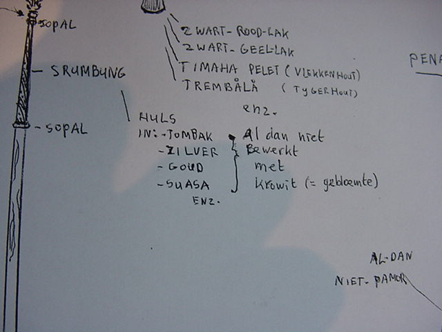

Hi The chairman did make a study about this subject and publish this on 8 nov
2005
the metuk has seen in java in silver gold suasa with or without krowit (flower)not al tunjung are in iron
Batang landeyan can be found in palmhout rozen hout enz
He says defenitly this is Java (I don t like to insult any one but the most knowledge about the keris and Indonesian weapons from the past can be found in the Netherlands In some private collections and museums we have more than than can be found in Indonesia the knowledge about these things
that we took from the early time that we been there was al written down
by the Dutch Germans English the Indonesian people by that time 1600 had not much interest in how the keris was made or develop that has also to do with the fear they had for it only a few High stand Indonesian people did have some knowledge the rich ones . who looses a lot off their stuf by gambling or mismanegemant so we get a lot in the Dutch hands .
In the early years In the Stone you can read the Dutch pandhouses have an formula to see if it is an bad or good keris.
The most study about pamor can be found by the european books.
An famous Tammens did make a big study about the kris .
He did have some krisses that are famous and one that had bring unluck to a few people not an story but al proven I see this keris and did not want to touch it becuase they cal this one the car damage keris
the story about this can be read In the book from H.W.M.J. Rijnders geloven in bijgeloof an very nice book that goes about goena goena black and withe magic demons etc.)
In the Stone page 629 is the same it says java I think we have to look what was in the past and not look how we call the parts now to avoid mistakes these weapons are from the past not from 25 years ago
Ben

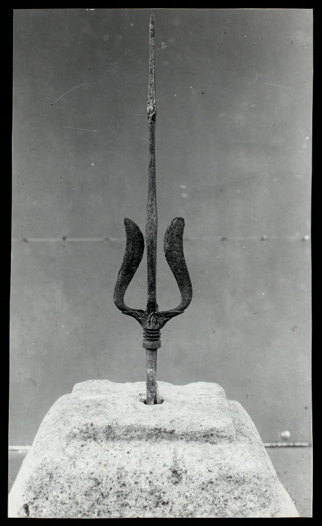

Ben, you have quoted Stone P. 629 as showing a similar trisula as Javanese.
I have an earlier edition of Stone than the edition that shows this trisula on P 629. The illustrations in my edition are much more clear than the illustrations in this later edition that you are using. Still, the trisula shown in Stone only shows an overall shape, it is impossible to see the form of the metuk, and of course we know nothing of the material.
Now it is entirely possible that the trisula shown in Stone is Javanese.

Regarding the material used for a tunjung.
I have not claimed that all tunjung are iron.
In an ornamental landean the tunjung/sopal will be a soft metal and will sometimes be ornamented with embossing or engraving, however, in a landean intended for actual use, the tunjung will be iron. I cannot say that it will always be iron, because I have not seen every landean ever made, but I can say that in every landean I have ever seen in Central Jawa, that has been made as a using landean, the tunjung has been iron.

Old 30th November 2006, 11:03 PM   #16
Posts: 7,281
Ben, forgive me if i have in any way misunderstood or misrepresented your position. I use the word Jawa because it has been my understanding that this is how the place is referred to by the inhabitants of the island of Java. I may be incorrect in this assumption. Regardless, if it is only an old world name that is no longer in use, we are certainly discussing old world Jawa and it's weapons here, so perhaps it is appropriate.
I have no doubt that the chairman of the keris club of which you speak has done his research. I likewise have no doubt that Mr. Maisey has done his research as well. So we have different opinions. I have questioned yours because you choose to validate it with this statement " I don t like to insult any one but the most knowledge about the keris and Indonesian weapons from the past can be found in the Netherlands" instead of hard facts. Mr. Maisey presented a logical agrument which in the end doesn't prove origin one way or another, but he details how and why he comes to believe that this trisula may not be from Jawa. Knowing nothing about Trisula i find myself more swayed by Mr. Maisey's argument. It is detailed and lists reasons for his conclusion.
I would tend to disagree with you that the fight in Bali had nothing to do with misunderstandings (although, from my readings the Balinese people were very good at fighting amongst themselves with no interference from the Dutch). And it had everything to do with taking the control away, not getting it back. As i have already pointed out, we Americans have done the same thing (again and again) so this is not meant as an indictment of the Dutch per se. I was just attempting to explain that Colonial powers rarely understand the cultures that they dominate. Americans were just as bad in our own country with the indians.
I realize that English is not your first language and i may have misunderstood your remarks. If so, please forgive me.

Old 1st December 2006, 12:42 AM   #17
Posts: 7,187
David, I don't think I can classify the foundation of what I have written as "research".
To me, research implies a structured search after knowledge.
This is not the base that I am writing from.
I am repeating here what I have been taught over many years by many people, and what I have learnt over many years through day to day dealing in Javanese markets.
You could probably say that I am writing from 40 years of acquired experience, rather than from a defined search for knowledge.
It would be as pretentious for me to claim I had "researched" this matter as for a carpenter to claim he had "researched" the driving of a nail.This is what I do; I live it, I don't research it.
Regarding the name "Jawa".
Jawa is ngoko for Java, Javanese, or referring to Java; the krama equivalent is Jawi.
As it is often pronounced, to your ear it would sound as "Jowo".
On any map of Indonesia where the names are in Indonesian, you will find Java identified as "Jawa". In any Indonesian or Javanese dictionary you will find the word "Jawa" with the meaning given as "Java".
Go back in history, and you can find a dozen different names given for Jawa, some have a sound close to Jawa, some do not.
The only reason I use Jawa most of the time is that I live in a house where probably more than half the conversation is in Javanese or Indonesian. In normal daily conversation I use the pronunciation Jawa. It is simply easier for me to use Jawa than Java. If anybody objects to me using Jawa, I am quite happy to go back and edit any posts I write and change the spelling. I have no problem with this.

Default added info
I just recieved this new information from Pak Boedhi who unfortunately isn't very active on the Internet at the moment:
The metuk is "called 'methuk sungsun/susun' (double/stacked methuk)". It's a very rare metuk and he has only seen it on two tombak before, both of them Trisula, in Java.
When he writes Java I understand it as the island of Java. In an earlier mail he suspects that this Trisula is from outside what Alan describes as "The Land of Jawa". So I understand it as he also thinks, like Alan, that it doesn't follow the Javanese pakems but that it could be from an area on the same geographical island.

Thanks David,
I like it too but I understand from those with more knowledge that it's a rather plain Trisula.
I have also been told that the spearpoint material isn't the best to stain.
But I still find it exciting and interesting to study and learn more about.
Michael

https://digitalcollections.nypl.org/...0-e00a18064a99
The New York Public Library, Digital Collections
Java: Antiquities. Origin unknown. Hindu and Buddhist subjects: Bronze trident. Owned by the old Bupati of Modjokerto. Origin unknown
Picture made by Lembaga Purbakala dan Peninggalan Nasional,
collected by Claire Holt,
created: 1950 - 1960 (Approximate)
Old 26th August 2020, 11:34 PM   #30
Hello Gustav,
Thanks a lot, great find! One more example of this type, finally.
As indicated, this may not really help in placing this style since pieces in the collection of a bupati might be gifts from other rulers.
