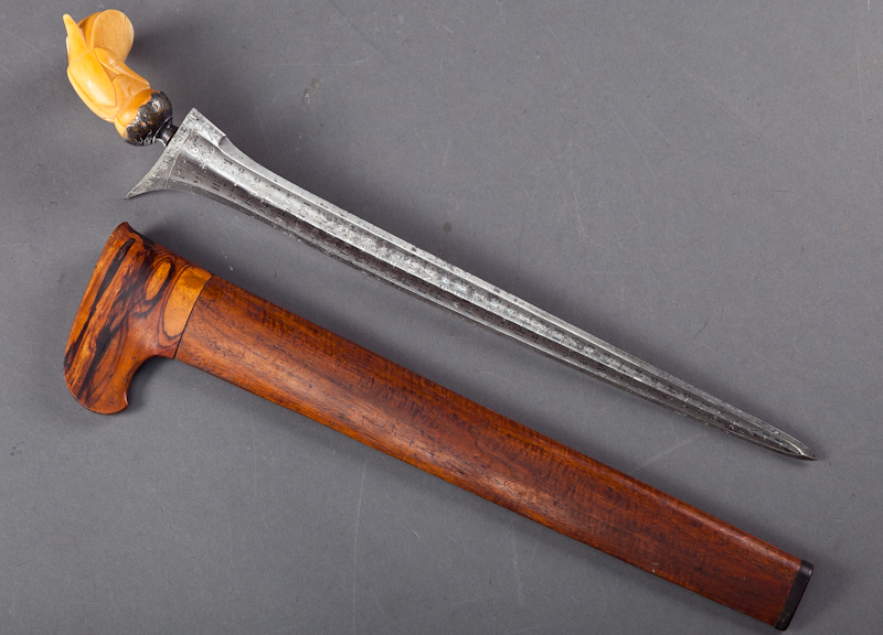

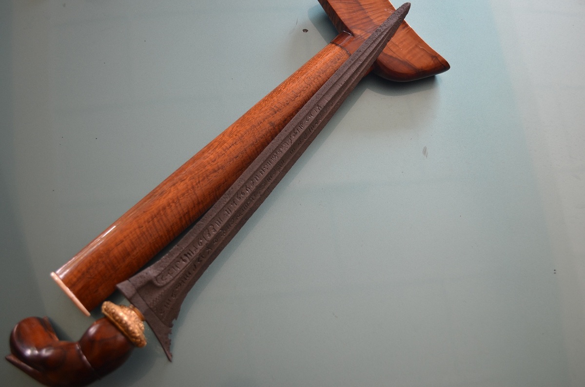

Default variation of tok chu
just for sharing. some said variation of keris tok chu

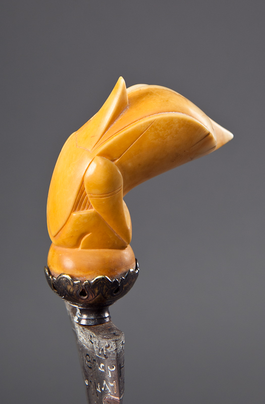

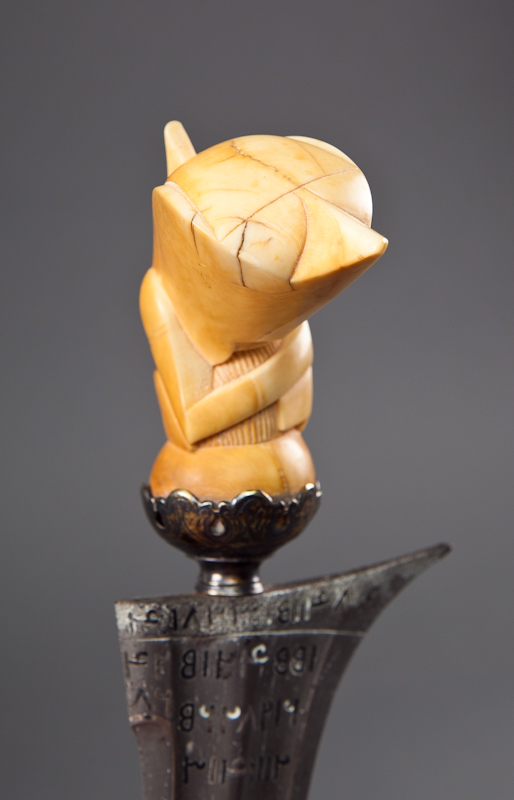

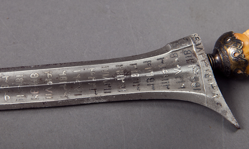

This is an immediate reaction to the top keris. I'm not posting it as fuel for any sort of ongoing discussion on the forms and merits of various types of keris.
To my eye, this top keris looks very much like somebody had seen an early East Javanese --- read "Majapahit" --- keris only once and only briefly, and then tried to reproduce it --- or maybe had it described to him.
This keris has the features of a Mojo keris, but as they would be described, not as they are executed in the original.
I find this type of thing quite interesting, just as I find the similarity of the Panataran keris to Bugis keris quite interesting. It helps to track dispersion.

I see 3 different keris in you post. Are you suggesting these were all made by the pandai Tok Chu?

I see 3 different kerns in you post. Are you suggesting these were all made by the pandai Tok Chu?
hi david,
all 3 keris belong to a senior collector in kelantan. all 3 are the variations of keris tok chu (what have been told to me and opinions from other senior collecters as well).

The first keris doesn't look to me to be Tok Chu. I suppose it all depends on how liberally one takes the term 'variantions'. I'd tend to look on it as more of a Saras variation
Perhaps one should ask someone like Cikgu Nasir for an opinion.

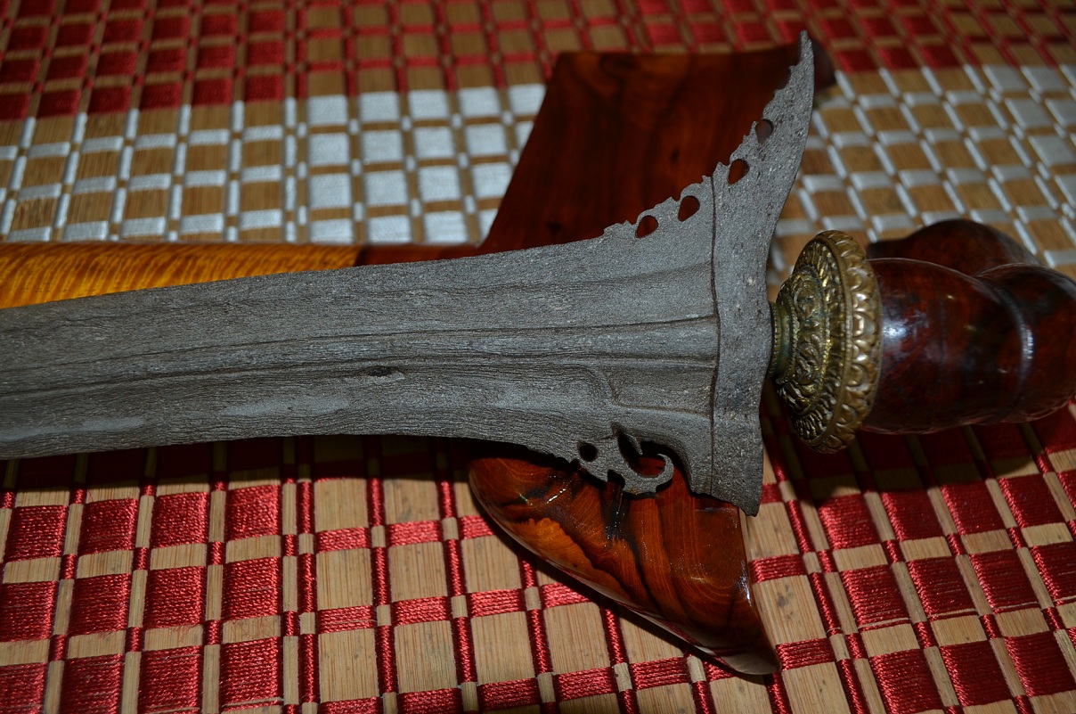

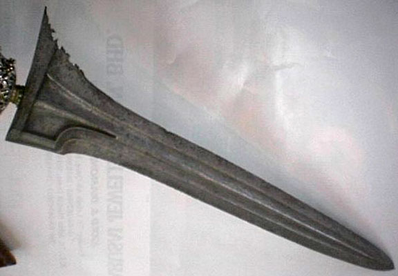

Keris I was talking about. Note the striking similarities in the gandik area.

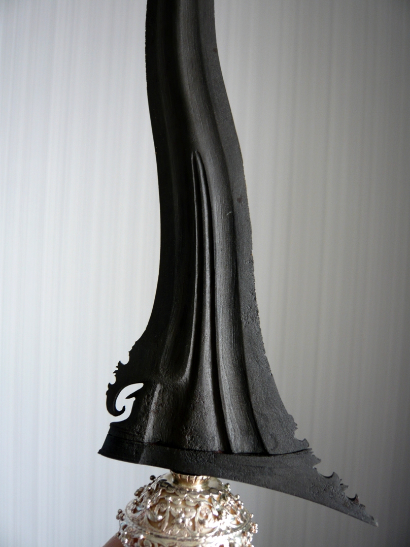

This was said to be a Tok Chu.

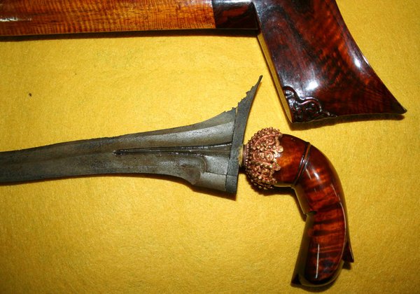

my private collection for keris tok chu with wifiq/arabic

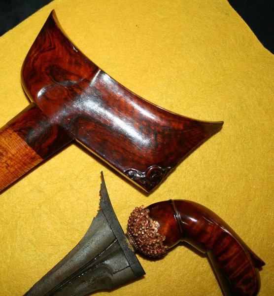

if they are not made by Tok Chu, of course there are masterpiece out there which is made by Tok Chu and been duplicated. It's may be easy to duplicate but not easy to claim and used Tok Chu name if there are no basic or evidence to do that.
what i believed and most of Kelantanese keris lover believed, Tok Chu (pandai) did not produce only 1 type of keris. But it's have variations which also called as Keris tok Chu.

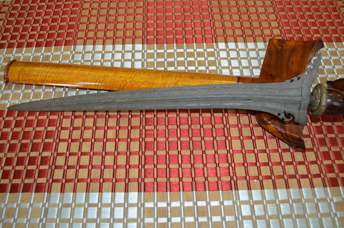

another luk 3 tok chu keris owned by a royal family. new sheath.credit cikgu nasir

Actually I suppose, the keris in Blu Erf's post (#8) is not correctly depicted, if I take a look on it's shadow. It could be longer then it seems. A pity we don't have more and proper pics of it.
As David stated, we see three absolutely different style keris in post #1, and material of them is of very different quality.

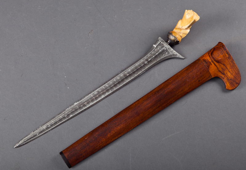

Here is one similar to post #19 with talismanic inscriptions.

Gustav, your example is beautiful. Until now i would have assumed it to be a straight carita keris...
