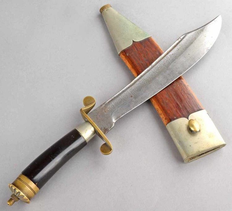

Just received this sword/parang/sabre/golok.
This is obviously European inspired but was it made for Europeans/Dutch or local Sundanese use?
Michael

It looks 100% Dutch to me, quite handsome. Tim

I can definately say it's a Indonesian sword made for the Dutch East Indies Company. I have a spear point Bowie/Hunting knife and it is marked identically as yours but with a 1907 date. I will post a picture of it when I get home tonight. By the way your sword is lovely and is an excellent quality example infact I think the same smith made both yours and mine.

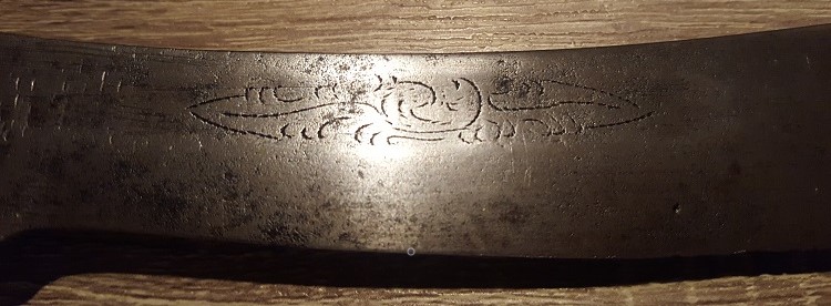

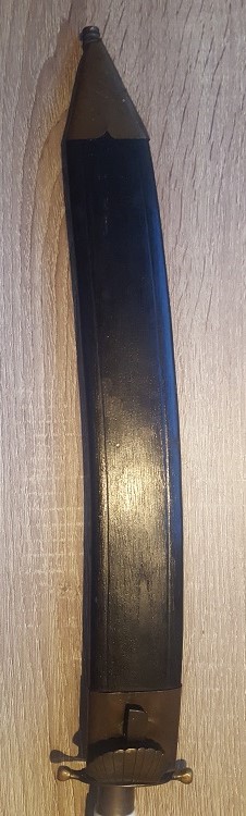

This is an example of Dutch Colonial swords made in western Java, mostly in Tjikeroeh, during the period from about 1890 to 1920. [This style of blade is similar to a Dutch military saber from the same period -- I will post pictures in the next day or so (the clipped point is very similar).]
The broad fuller and foliate engravings are characteristic of this style. Hilts have full length tangs, secured with a threaded nut at the end. Handles tend to be bone or antler with a brass guard and ferrules. Scabbards are plain, with black wood and brass accents at the throat and toe.

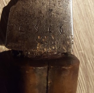

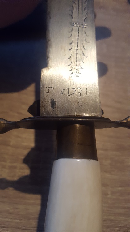

Hi Amuk Murugul:
The Dutch klewang, on which the clipped-blade saber forms of these Tjikeroeh swords are based, was placed in service by the Dutch military in 1898. So it is likely that the locally copied versions post-date that time.
I do think that the manufacture of European style knives and swords, with antler hilts and other "Westernized" features, arose about that time. These are among the very few swords and knives in SE Asia that actually carry a date of manufacture. I've not seen any before about 1890, and the most recent in the mid-1920s. The incising of the numbers can be rather confusing sometimes, and a 9 can be confused for a 7 on some inscriptions (one of mine shows a 9 that could easily be read as a 7). I doubt that any of these knives and swords date from the 18th C. -- they look in too good shape to be that old.
Ian.

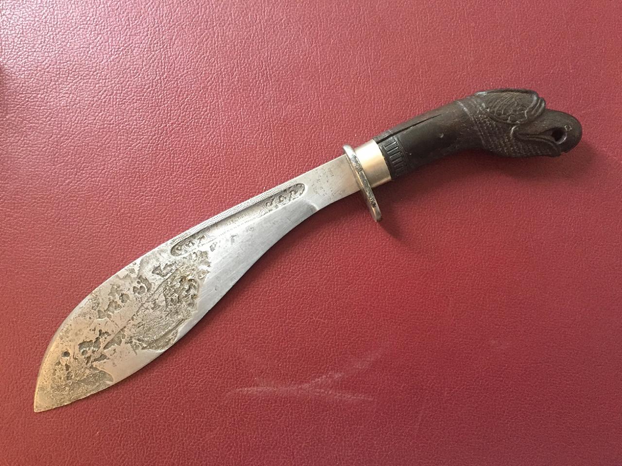

I have found this thread very interesting. It is shows the spread of decorative motifs through Malaysia and Indonesia. Untill now I had a feeling because of the decoration, that this was a tourist golok even though it had been used. I only post a picture to compare the shift in style. Tim

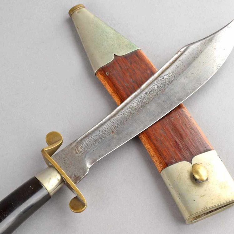

Default Golok from the village of Tjikeroeh
Here is a golok from the village of Tjikeroeh in Java, Indonesia, c. late 19th - early 20th century. The overall length is 20 ½ inches. The blade length is 15 inches. The edge is recurved in shape, with a "fat belly" at the point of maximum percussion. A single large fuller is found on both sides of the blade along the spine. The fuller is decorated in an okir pattern typical of swords from Tjikeroeh and neighboring villages. The back side of the blade is slightly concave in shape with a width of ¼ inch tapering distally to the point. The blade edge smoothly curves upward to the point and the back slopes down in nearly a straight line to the point. The hilt is carved hardwood in a typical design that is representative of a parrot. There are glue indications of a relatively recent repair to the hilt. The scabbard wood is slightly different indicating that it is a replacement for the original (if any).
More pictures at http://atkinson-swords.com/collectio...ok-tjikeroeh1/

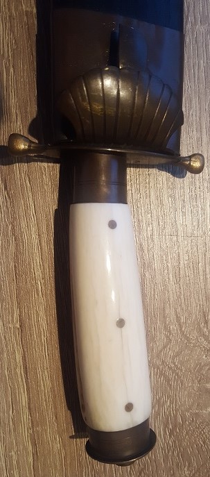

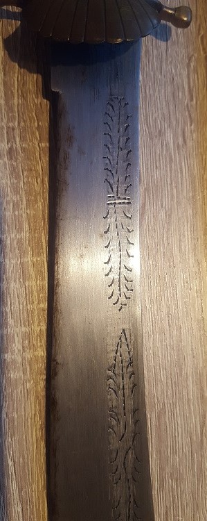

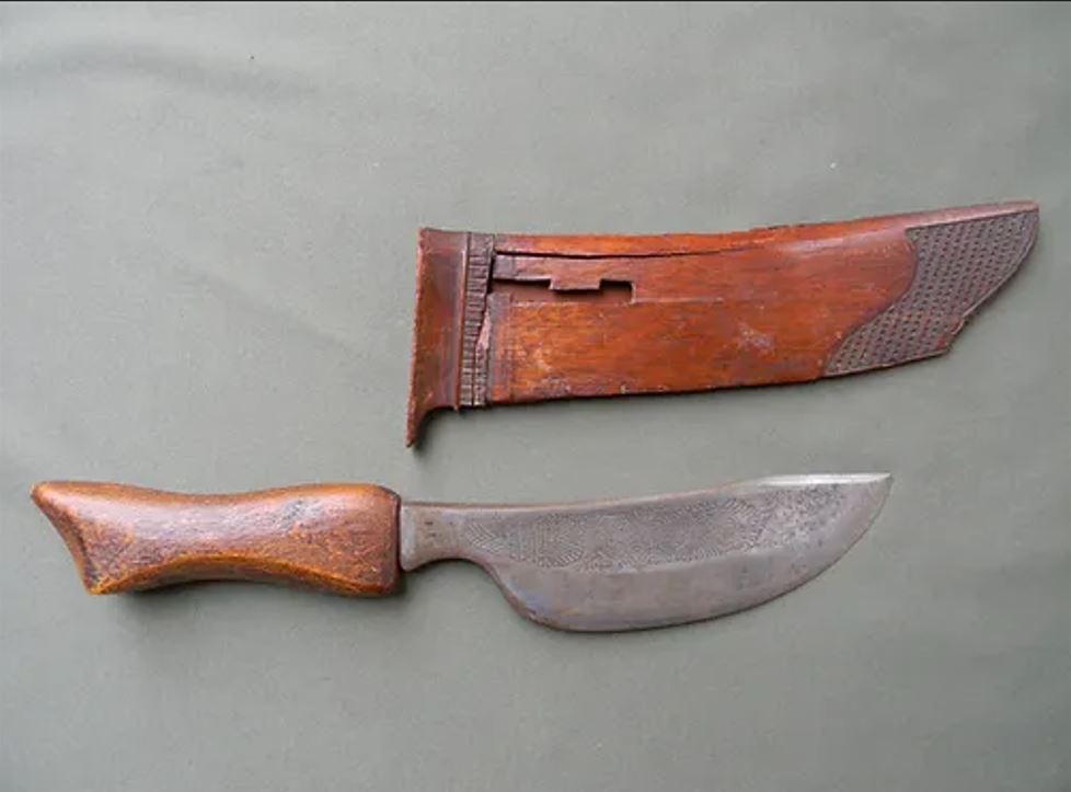

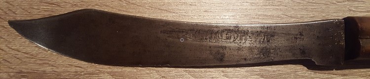

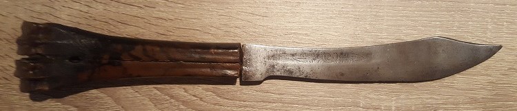

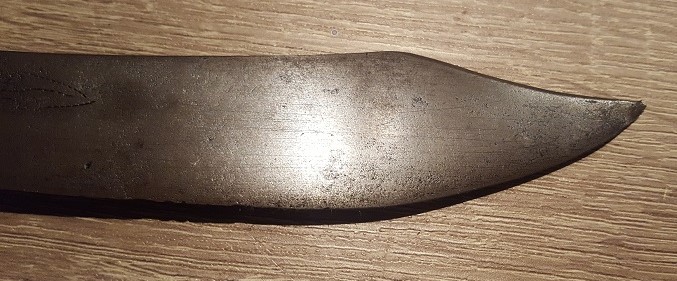

Old 18th November 2021, 07:27 PM   #16
gp
gp's Avatar
Join Date: May 2020
Posts: 1,026
Arrow

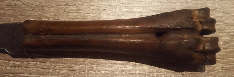

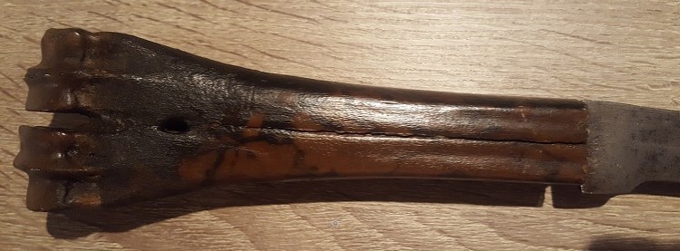

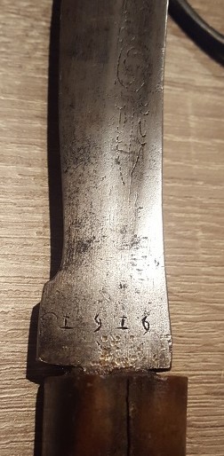

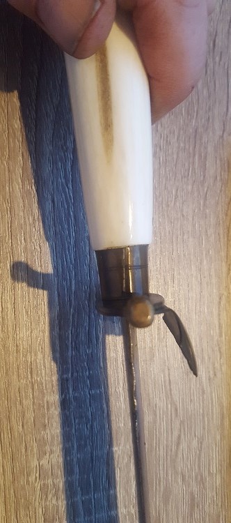

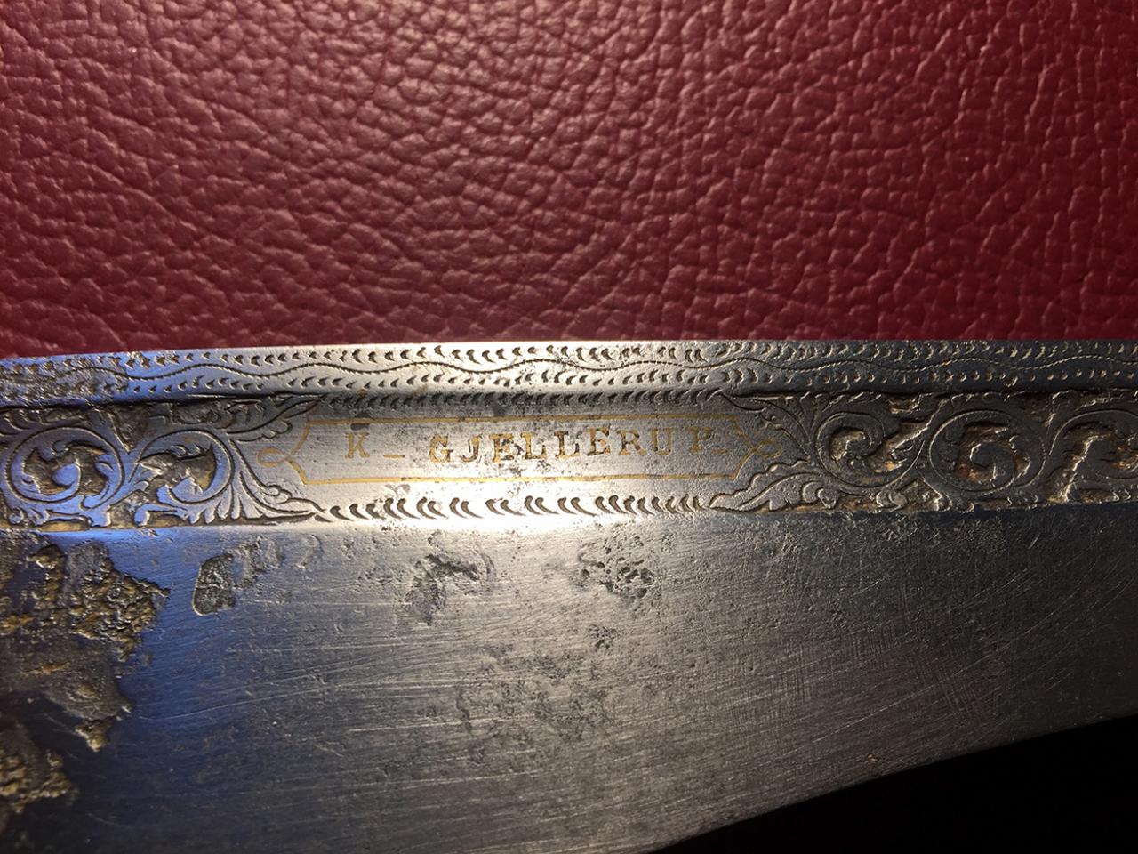

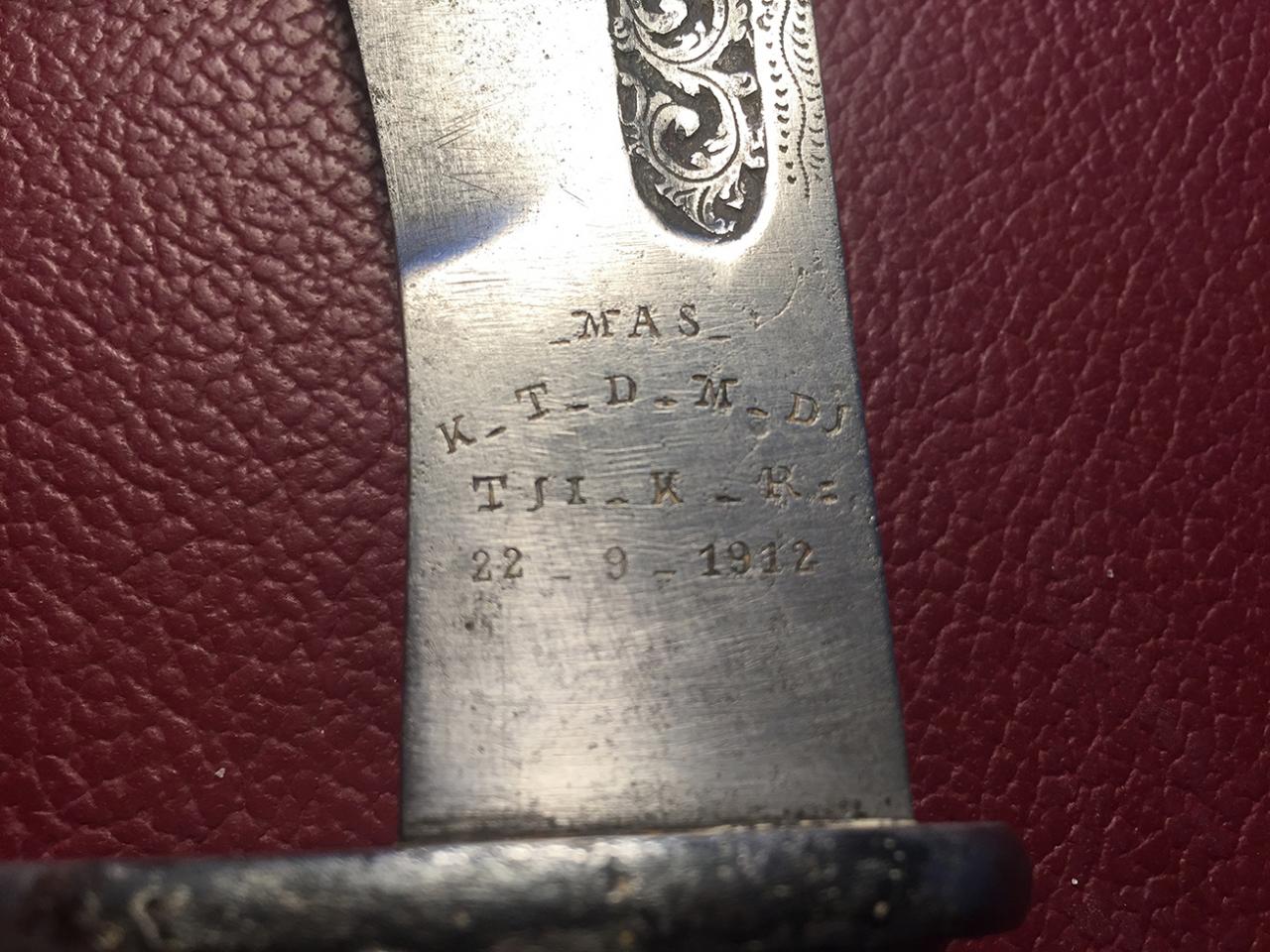

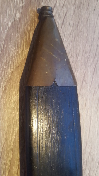

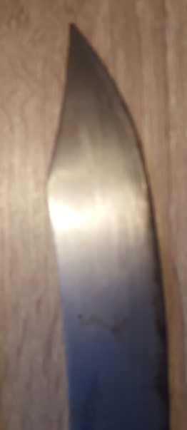

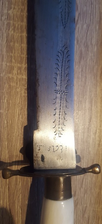

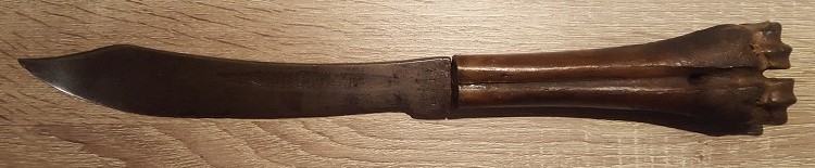

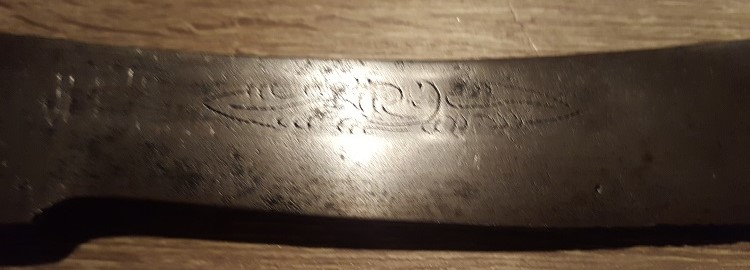

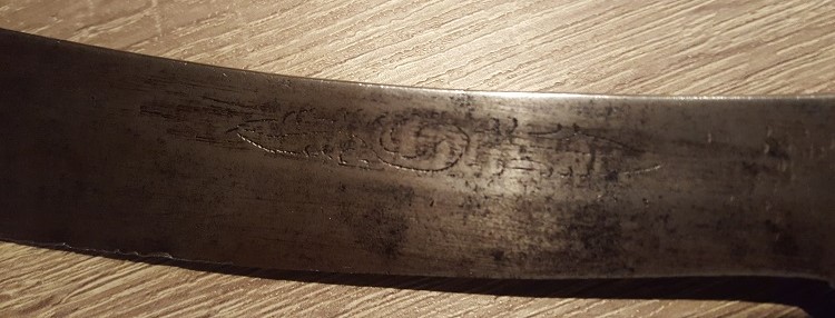

chikeru / tjikeroeh....
I do see quite a lot of threads from 2005 to 2015
some interesting, some guessing and some well...
just managed to lay my hands on 2 of them: a small and a big one
First I was advised on literature:
Keris Jawa (Haryoguritno) de Kris I, (Tammens), Traditional weapons from the Indonesian Archipelago (van Zonneveld), Keris Indonesia, Keris Bali (Neka) en Tafsir Keris (Bpk Junus)

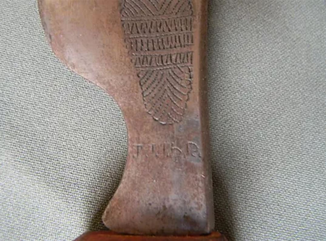

Tjikeroeh ( since 1972 Cikeruh in modern Bahasa Indonesia) is a dessa east of Bandung, Java where around the turn of the 20th century in the period between 1890 to 1920 production of weapons took place ,specially cold weapons.
Tjikeroeh at that time, just like Ttjipatjing (Cipacin) which is closeby, famous for its production of, not only local but also western European arms like sabers, knives and daggers.
A huge misunderstanding is the fact that they only produced for local KNIL ( Dutch Indies Army) or as substitute for local Dutch residents working for the railraod, government or even tourists.
A huge varity from working knives like simple bado to a fancy golok, parang, european klewang and (bowie-like) knives and dagger, with handles from bone, horn or wood.
Scabbard mostly (dark) wood, sometimes with copper, nicely decorated and place of manufatoring and date engraved. ( Tjikeroeh or variances like TJKRH, TJIKE, TJIKR, TJKR)
Regardless the “export nature” many were very good sword, due to the use of spring steel !
