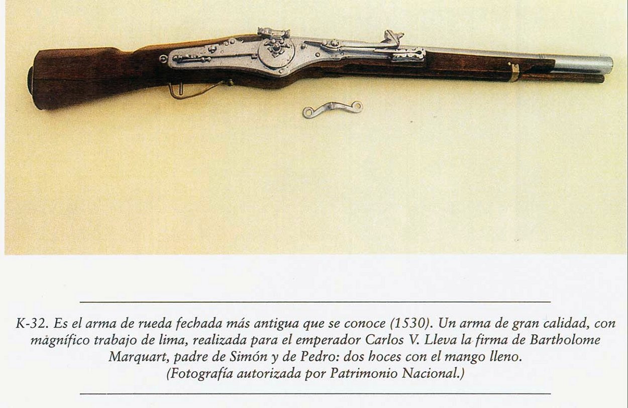

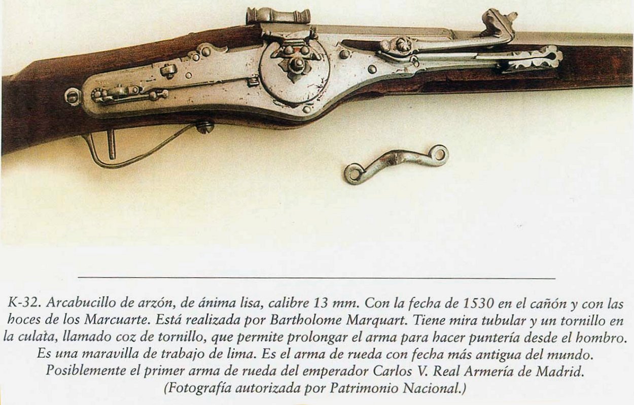

First of all I wish to emphasize the fact there never was such a thing as '15th century wheellocks'. The earliest known datable and primitive wheellocks seem to have been made in the 16th century, which is the late 1520's:
http://www.vikingsword.com/vb/showth...rossbow+munich

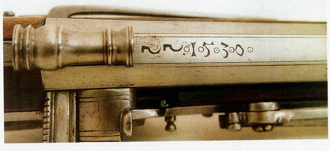

and the earliest known dated wheellock is an arquebus (a small and short gun), made by Bartholome Marquart of Augsburg for the Emperor Charles V, and now preserved in the Real Armería Madrid, inv.no. K32. It is dated 1530 (top four attachments) on the barrel.

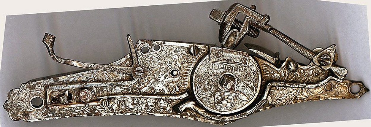

A sample of the earliest known piece of that kind of ignition is in my collection: a detached North Italian wheellock mechanism of ca. 1535-40, from a combination weapon, most probably a war hammer or axe combined with a wheellock gun:

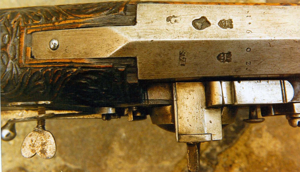

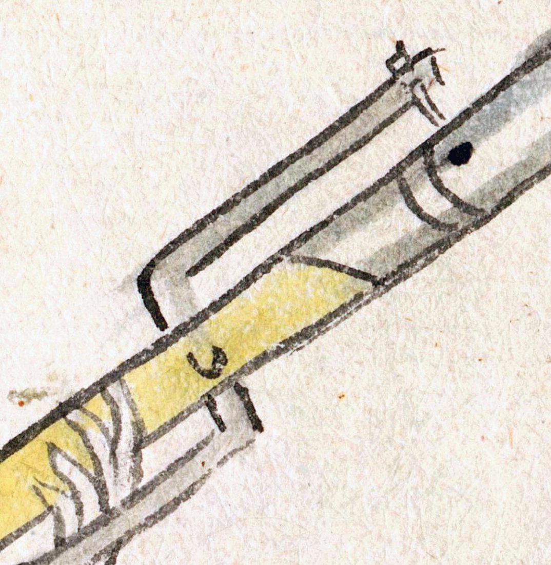

This settled, I should put it straight that the tinderlock doubtlessly was the earliest mechanical ignititing mechanism on any firearm. We have records of period artwork as early as 1411, from Johann Hartlieb's illuminated manuscript on war techniques, Austrian National Library (ÖNB), Vienna, cod.vind. 3069 (attachments #5 and 6).

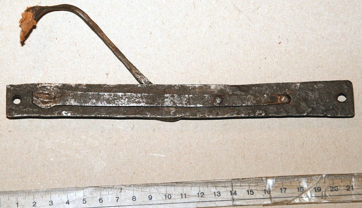

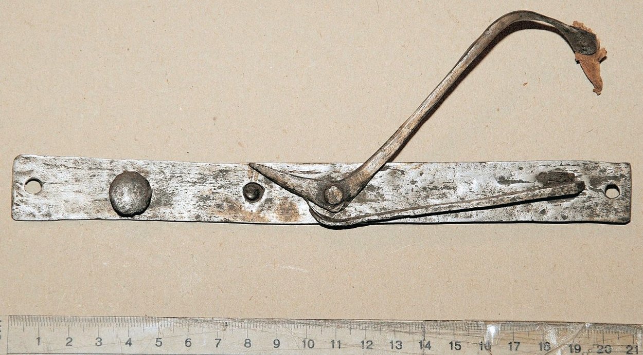

The tinderlock, mostly used in a snapping version by the early 16th c. - a fine detached mechanism of ca. 1510-15 with lateral push-button trigger is in my collection, see attachments #7 and 8) - , stayed in use at least until the early Thirty Years War in the 1620's but is [B]often found in combination with a wheellock mechanism from 1532 (a dated arquebus in the Musée d'Armes, Liège, attachments at bottom):

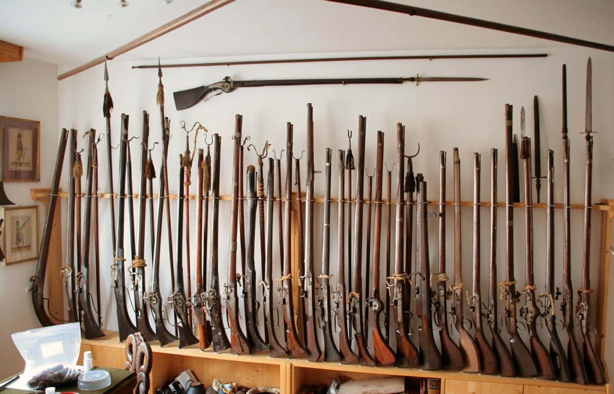

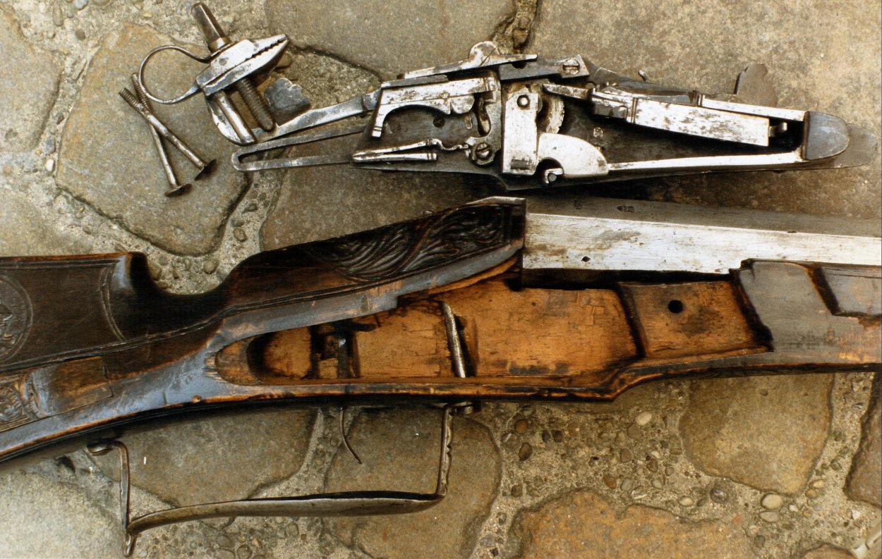

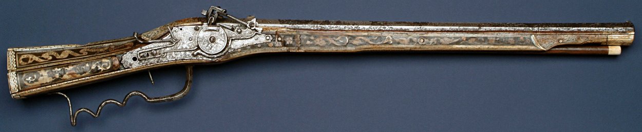

In my collection there are 4 military wheellock muskets (dating of ca. 1590, 1600, 1640 and 1652-3 respectively), 2 combined wheel- and snap-tinderlock muskets (Suhl, dated 1602 and ca. 1660-70 respectively, overview photo attached), plus a number of fine detached wheellock and combined wheel- and snap-tinderlock mechanisms (top attachment, see next follower post).

Inspired by this experience, I closely examined the locks of all my wheellock muskets. The result was that those that were preserved in perfectly original condition all had severe mechanical failures that only allowed one conclusion: they were put aside due to failures 350 to 400 years ago but never actually saw repair. Nevertheless they were kept in the town arsenals, thus becoming museum pieces - an observation I found confirmed over the decades by dismantling many wheellock muskets in the reserve collections of various museums.
My conclusion is that many wheellock weapons could not stand hard 'military' service. Their mechanism comprised between 30 and 50 parts, and they were ordered by the town councils for their arsenals because they represented period 'high tech' and were expensive. In many old arsenal orders of the late 16th century, however, e.g. that of the famous Styrian Landeszeughaus (arsenal) in Graz/Austria, we also read that an additional snap-tinderlock mechanism was explicitly required because its simple construction had proved to be much more reliable and its external mechanism was easy to repair as well.

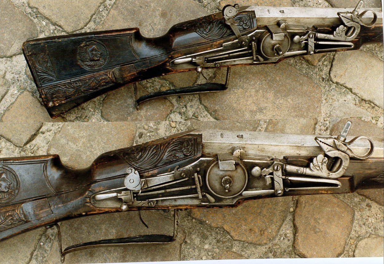

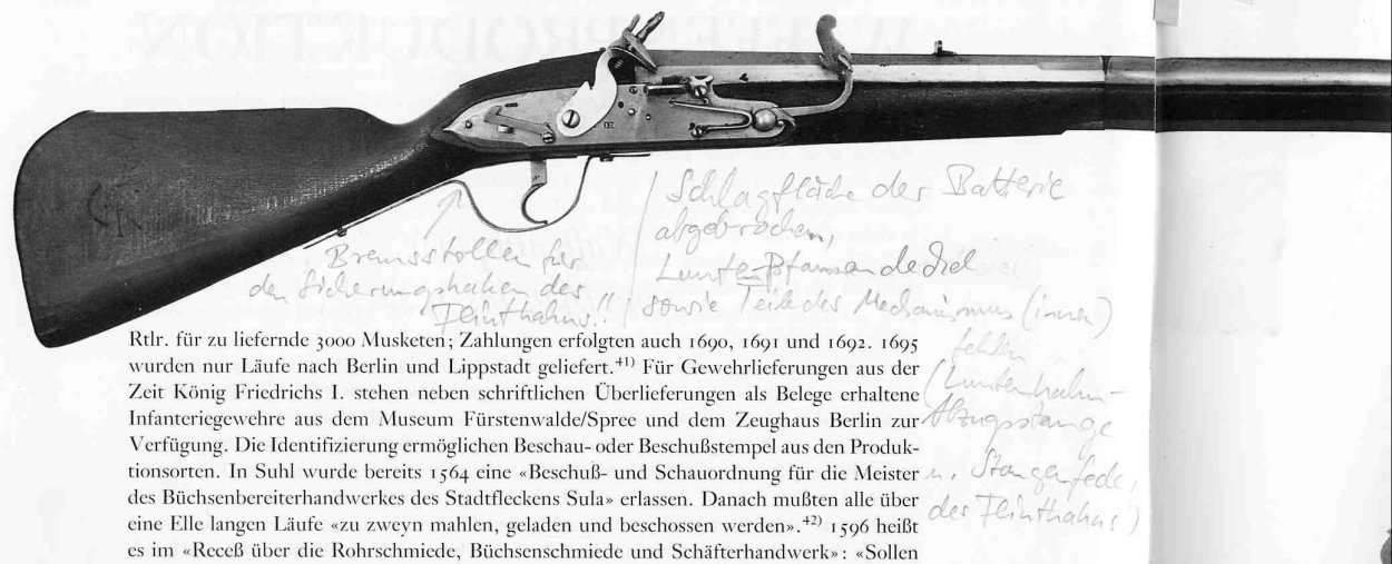

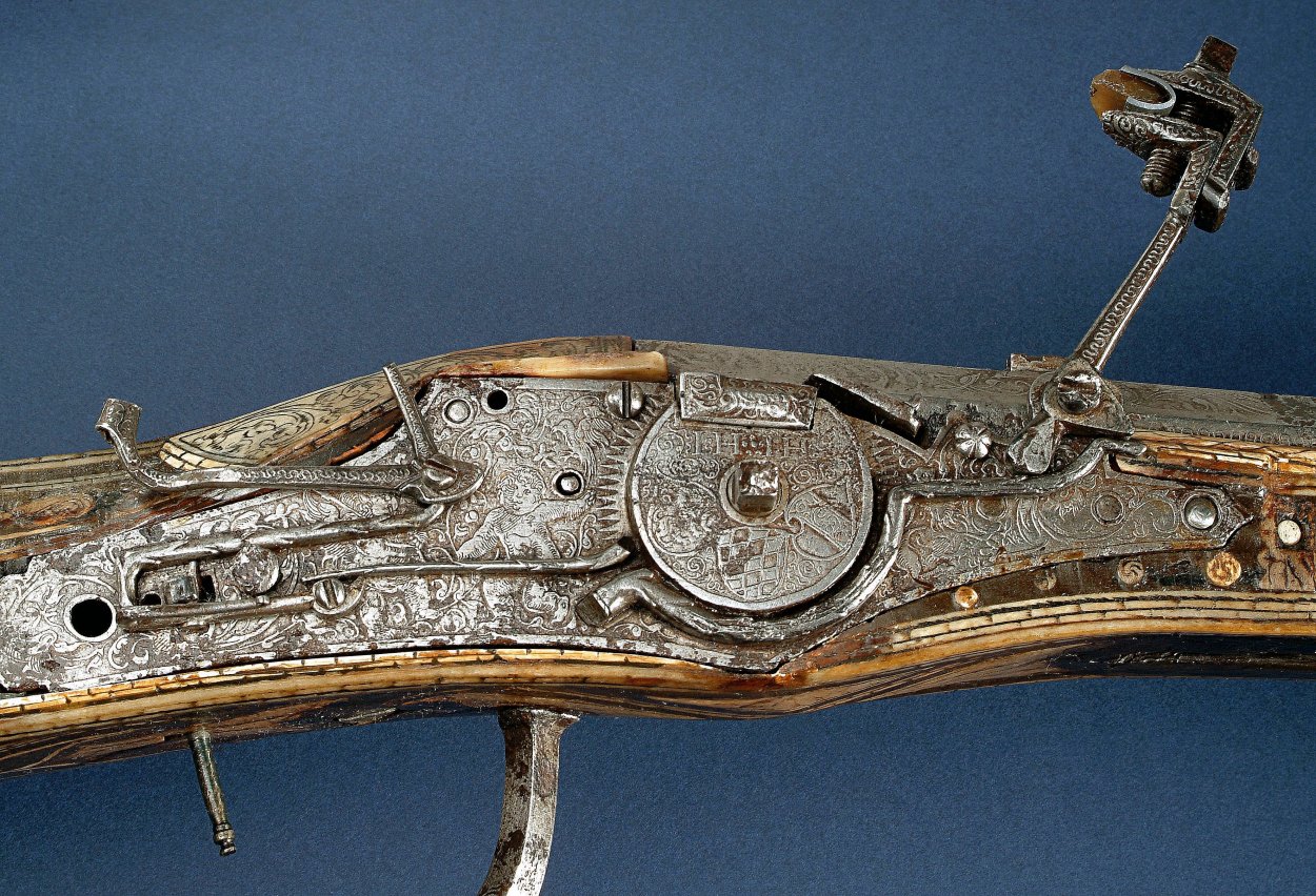

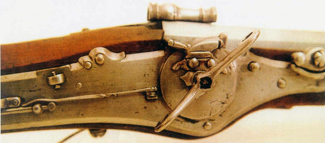

Please see an unusually fine Suhl specimen dated 1602 in my collection (attachments #2 and 3 in next follower post).

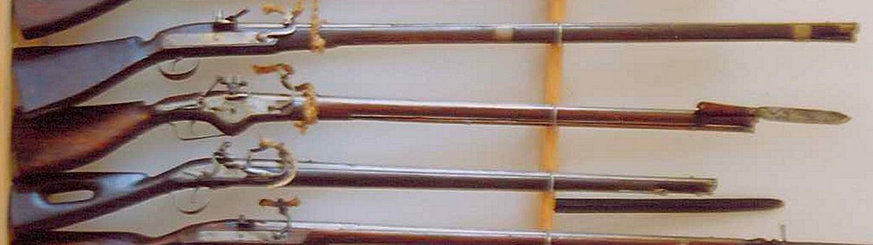

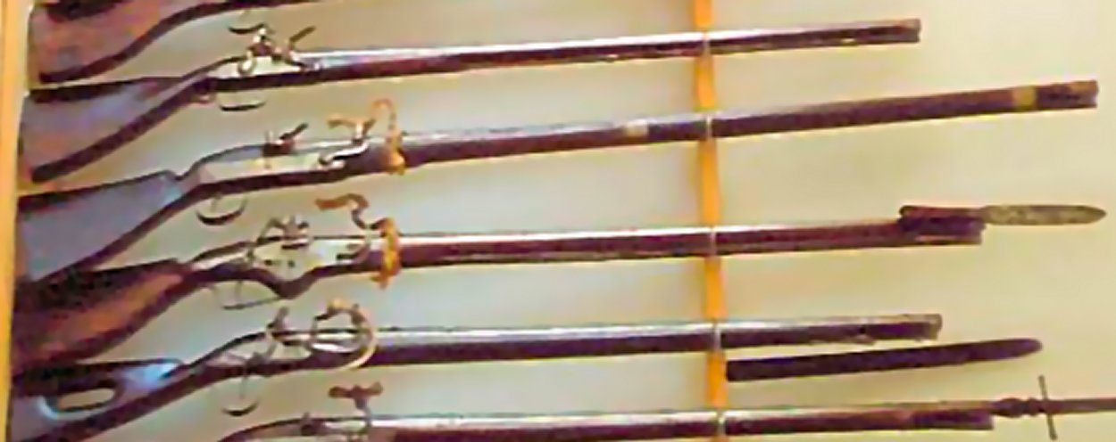

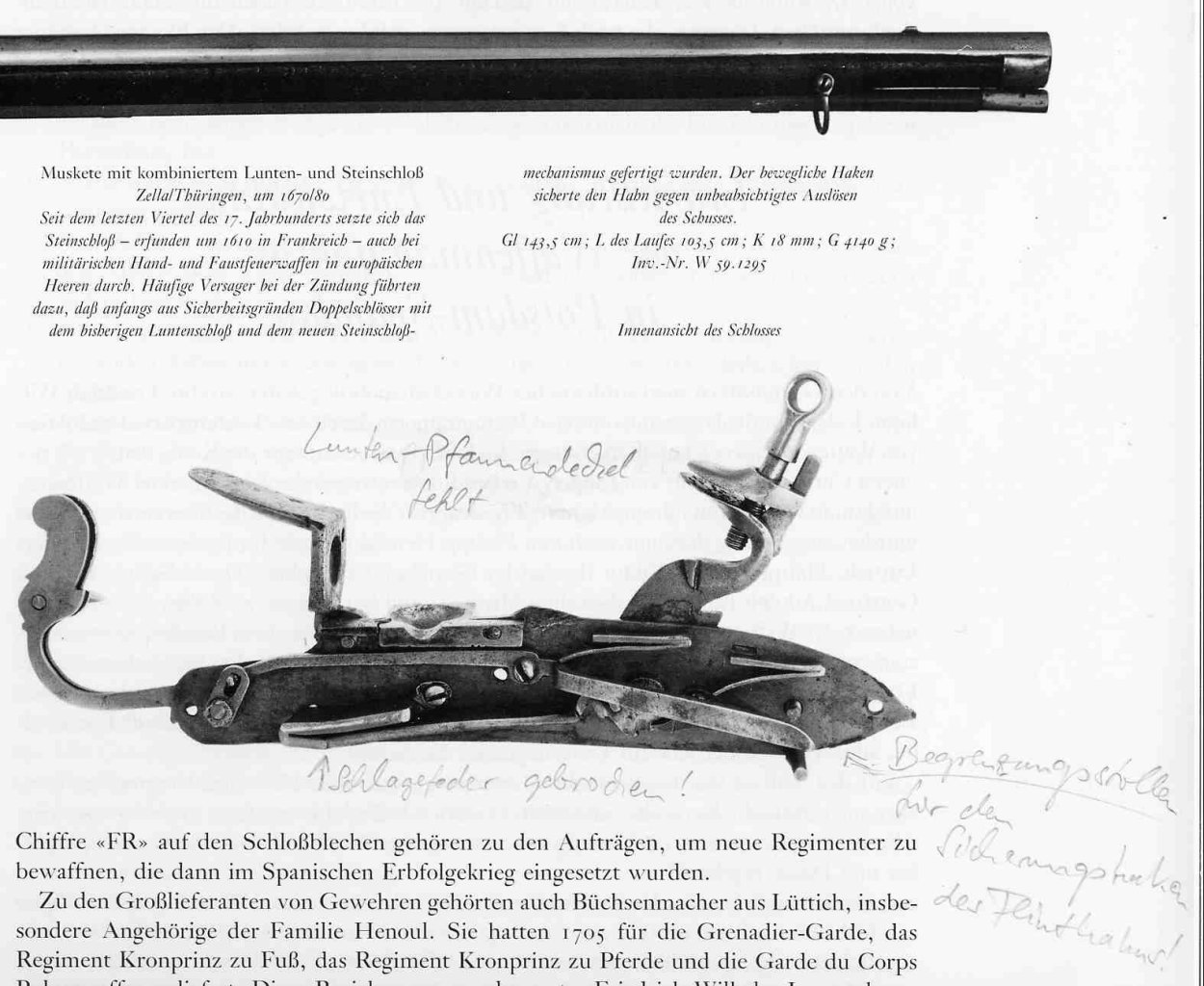

Even as late as ca. 1660-70, the wheellock as the sole ignition system was little trusted and it was combined with a matchlock mechanism activated by the same single trigger and using the same ignition pan and touch hole:
http://www.vikingsword.com/vb/showth...lock+matchlock

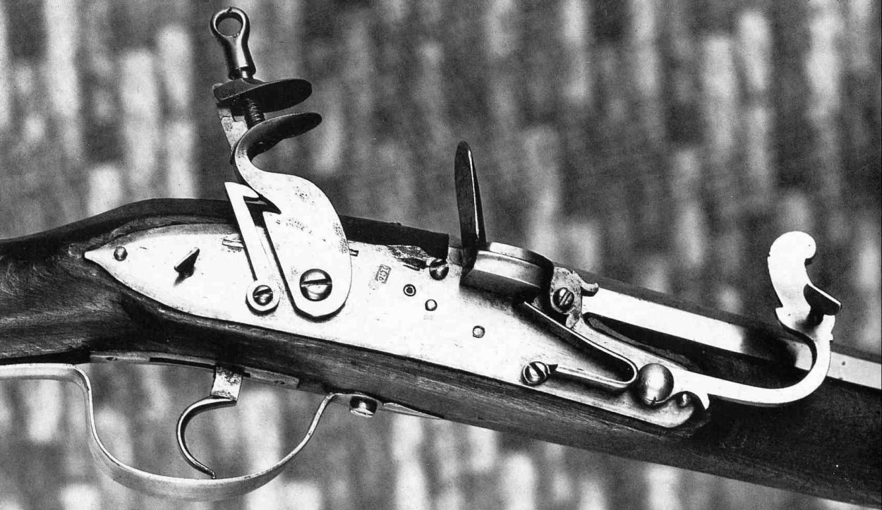

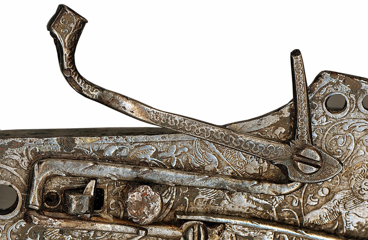

Also the first military flintlocks of ca. 1655-70 were little trusted, and they too were combined with the well-established matchlock mechanism.
I think that says it all (attachments #4 and 5 in next follower post).
