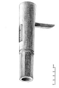

Whether there is an error in dating of this trunk? Is the wood original or faked in 19 century As it sometimes happened?

neither screws nor pans or pan covers are known before ca. 1500!
handgonne from Otepaa have pan covers. Adnd many asian handgonnes have too befor 1500
This barrel had pan cover too http://www.vikingsword.com/vb/attach...id=48227&stc=1

1. Not one single Asian hand cannon is kown to have actually been cast (they are all cast) before 1500.
2. How did you come and state that this barrel originally had a pan cover?
Sorry, not pan cover, but touch hole cover

Posts: 355
Otepaa seemsed was have touch hole cover. It dated about the end of 14 century
Yes, that´s absolutely correct. Unfortunatelly Mäesalu published only a reconstruction, but I know the look of the real fragments and the real (restored) hangun, too. There definitely is a pan cover.
As I pointed out in the other thread, the terminus ante quem for the Otepää gun isn´t usable any longer, but there is archaeological evidence (which I would prefer instead of other criteria) for dating the destruction of the castle within the 1st half of the 15th century. So the hypothesis of "no pan covers before ca. 1500" seems to be wrong. If you compare the weapon to other finds, there are also some matches, so the Otepää gun can´t be repudiated as a "non central european weapon".
Furthermore, a "trough-like" pan with upturned edges (but without pan cover) is present at the Mörkö-gun, which is dated to the 1st half of the 15th century.
