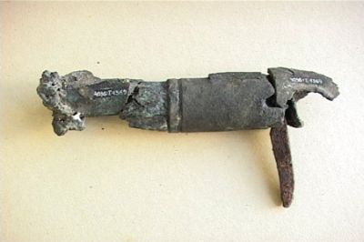

Otepää handgun- the oldest handheld firearm in the world
The earth of the Otepää hill hides the secrets of the old times and several valuable findings some of which have also been dug out under the instruction the archeologist Osvald Saare in 1950-1974. The greatest amount of valuable findings was discovered in the layer of the ruins of the medieval stone castle. The castle was reduced to ruins probably in the end of the 14th century in the course of the war between the Bishop of Tartu and the Livonian Order.
In the second half of 1396 the army of the Livonian Order sieged Otepää. They probably managed to set the castle on fire. The wooden parts of the castle evidently blazed so vigorously that even the brick walls of the buildings collapsed. Treasures were left under the ruins: the silverware of the Holy Communion from the chapel of the castle, books decorated with silver studs and pieces of rock crystals, grand suites of armour etc.
Next to those relatively rare findings the pieces of a bronze barrel that at first seems quite simple, deserves special attention. It was possible to fit the pieces together by their edges and so they reconstructed the gun that had been used more than 600 years ago ().
Originally the barrel of the gun was about 175 mm long and the caliber of its metal part was measured 18 mm, but the caliber of the gunpowder chamber was a bit bigger (). About a meter-long simple wooden stock was probably fastened to the back part of the barrel that was a bit wider at the time. The gun had another interesting addition. In casting it a cavity was left in the middle of the bottom side, it was for a special iron bar or the so-called hook. The extending tip of the latter was pressed against the wall in order to absorb recoil when firing the gun.
Gunpowder and the bullet were inserted in the breech of the barrel, then gunpowder was also sprinkled into the ignition channel on top and the handgun was ready to be used. At that time they still used a glowing iron bar or slowmatch to ignite it, although at times they already used a fuse as well. When firing the sparks, flames of fire and a good cloud of smoke flew out of the barrel and the ignition channel. Probably this is why the butt was probably rested above the shoulder (). Such a shooting position can also be seen in some pictures from the 15th century depicting gunmen.

The gun under discussion differs clearly from the firearm preserved in other places. Since the Otepää one is relatively easy to date, that very fire barrel possesses a significant role in specifying the whole course of development of the hand firearms. So far the hook guns were thought to have been invented in the first decades of the 15th century. The Otepää gun definitely dates the innovation back to the end of the 14th century. Because of the way the hook has been positioned the gun under observation is completely unique – it shows the first pursuits and experiments of the masters.
Another unique feature in the Otepää gun is a small plate mounted on the surface of the gun that could have been pushed in front of the ignition channel when needed. That and the gun’s moderate weight (743 grams) show clearly that lightweight portable guns came to be used about 20 years earlier that previously thought. The unique features mentioned make one consider the possibility that the Otepää gun may have been made by a gunsmith working in Estonia.
In conclusion I have to stress that the gun examined here is definitely not the first gun in the world, but it is the oldest among the hand firearms we have today that can be dated more precisely.

1. Even if it was made in the late 14th century - which I doubt very much - it could not be called the world's oldest handgun. This attribute is undoubtedly linked to the Loshult gun which closely resembles the earliest illustration of a gun found in the de Milemete manuscript, Christ Church, Oxford, which is dated 1326. The Loshult gun should be dated ca. 1350.
2. As discussed at large in earlier posts, the presence of hooks cannot be proven before the 1430's.
3. The presence of pan like mouldings around the touch hole seems to be an invention of the second half of the 15th century.
4. Although the Otepää gun is in heavily damaged condition now I should give a tentative date of ca. 1440-50 for it, with the longitudinal pan moulding being a later working addition.

I am still thinking about this barrel. You have given a tentative date as 1440-50. So how he was able to get under the ruins if castle has been destroyed in 1396 year?...

Hi Alexander,
I guess this was for a similar same reason as the famous Tannenberg gun was found in a well belonging to the ruins of a castle destroyed in 1399.
Just because a certain place was destroyed in a certain year, the possibility that some decades later somebody came by those ruins and probably tried to explore them cannot be a priori excluded. Then it might have been the case that our visitor either stumbled and fell, the handgonne falling deep down under the ruins, or that he was surprised by somebody else and lost his gun in combat.
Anyway, there is no doubt that both the Tannenberg gun and the Otepää gun were actually not made before the first half of the 15th century, ca. 1420-30 by the earliest, as I pointed out in a former post. So how it came they were both found between earlier ruins is completely left to speculation - dissatisfying as it may be.

Are there more photos of the excavated piece than the one I see? I'd need many more photos, close up, to get an idea of the beast under consideration. I wouldn't have such a big problem with it if it only had one departure from "conventional" contemporary gun design, but the fact that it has several significant differences causes its identification as any kind of a gun to be somewhat suspect. It reminds me somewhat of the strange industrial residue that is being offerred on Ebay these days as "nine hole cannons" or whatever.

Thanks, I watched most of the video, containing only a few seconds showing the excavated material at around the 5 minute mark. I'd certainly like to see much more detail of the fragments found. I think one could assemble them in such a fashion as to make what resembles a stopcock, or arrange them a bit differently to resemble a gate latch, or a waterspout for a fountain.

There are new informations about the excarvations in Otepää since a few years. In fact the terminus ante quem of 1396 can´t be sustained any longer. Finds of coins and pottery suggest a decline of the castle in the first half of the 15th century, so the gun maybe dates within this period, too.
