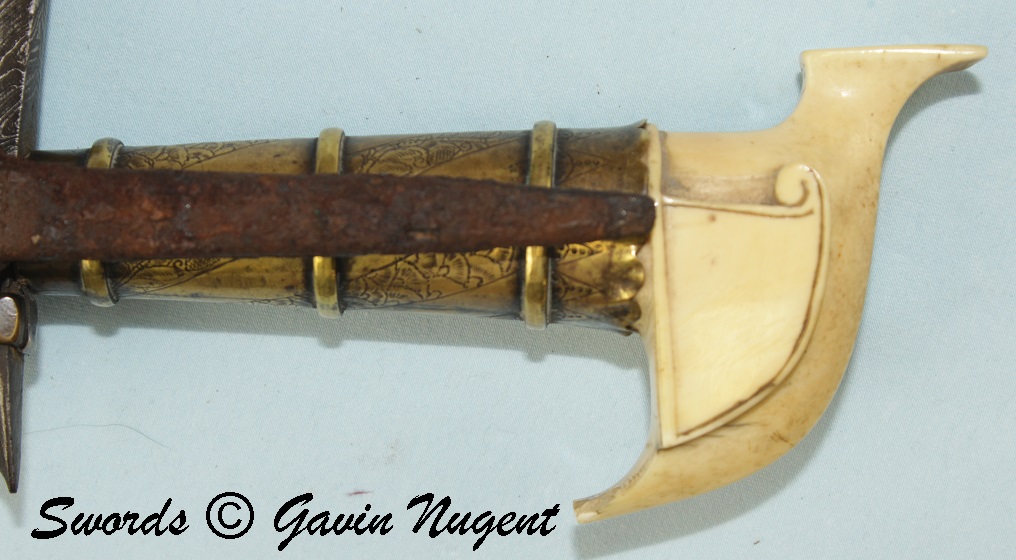

With relation to some of the conversation within the Charles S Sundang post, there are differing thoughts about the methods of securing tangs within hilts and particularly relating to the Sundang and Kris.
One school of though was that the asang-asang is what holds the blade tight and secure within the hilt, the other school of thought being that resins do the job right without the asang-asang...I am all for the resins alone

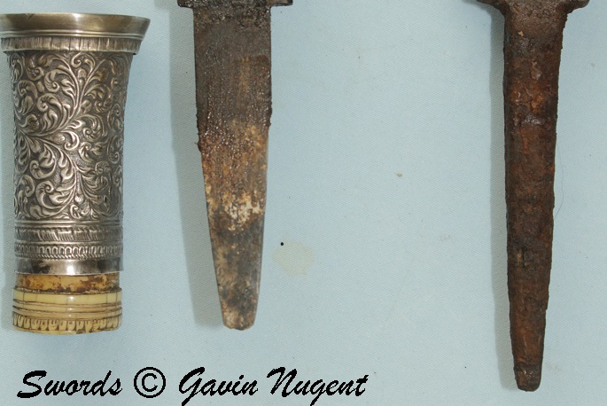

I noted my experience with various tangs and here is an image of a couple of items from my own collections to support my thoughts about resin alone.
Currently on the bench for restorations; The Laos Dah is for crushed silverwork repairs and the Barong for similar and a proper blade polish whilst it is out.
The Laos Dah;
Its an elegant blade and not a heavy weight by any stretch of the imagination. Its tang is 7.4cms long and the types are only resin set. The material the tang sits in governs the real strength of the sword in combat.
The Barong;
Its a large, thick and heavy blade with a much narrower tang. Its tang is 9cms long. Pound for pound the barong is a much heavier blade than a Sundang or Kris and generates a massive amount of force for such a "little" weapon (compared to a sword). The barong are only secured with resin.
Although not a Sundang or Kris tang, I have overlaid the barong tang to help put things in to perspective.
When considering forces that a heavy barong blade can deliver compared to a Sundang or Kris, it is easy to see that the asang-asang are certainly not the key factor in play in keeping a blade and hilt together and not really needed at all for a functional weapon.
The same thoughts can be carried through to many weapons...look at the Japanese Katana for example...friction fit and a small bamboo peg, Sumatran sword, other Moro swords, Javanese swords, African sword and a long list of others.
As my silversmith explained when we first discussed the Burmese story Dah restoration, I, in my ignorance asked if he was going to glue something in place and it was explained to me that glue will always fail eventually. He explained the long historical use of natural resins and why...why being that for example, if you are wanting to bind, ivory, silver and a steel blade, the resins will adhere properly to all of the surface types and they expand and contract perfectly with great temperature changes...our weapon making ancestors were on to something, something I am sure they experimented with over a very long time and for many weapons type, things never changed because it worked.
