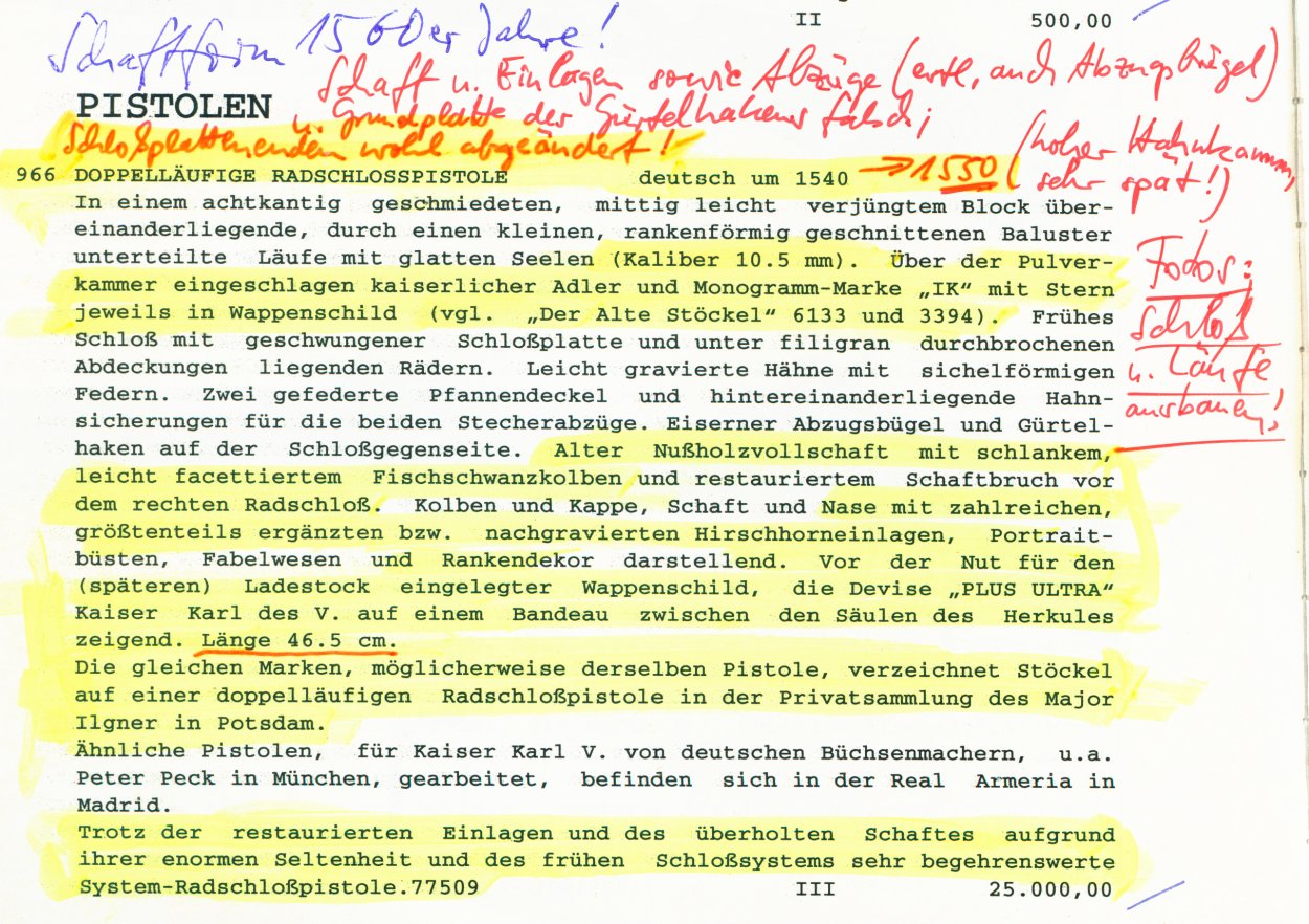

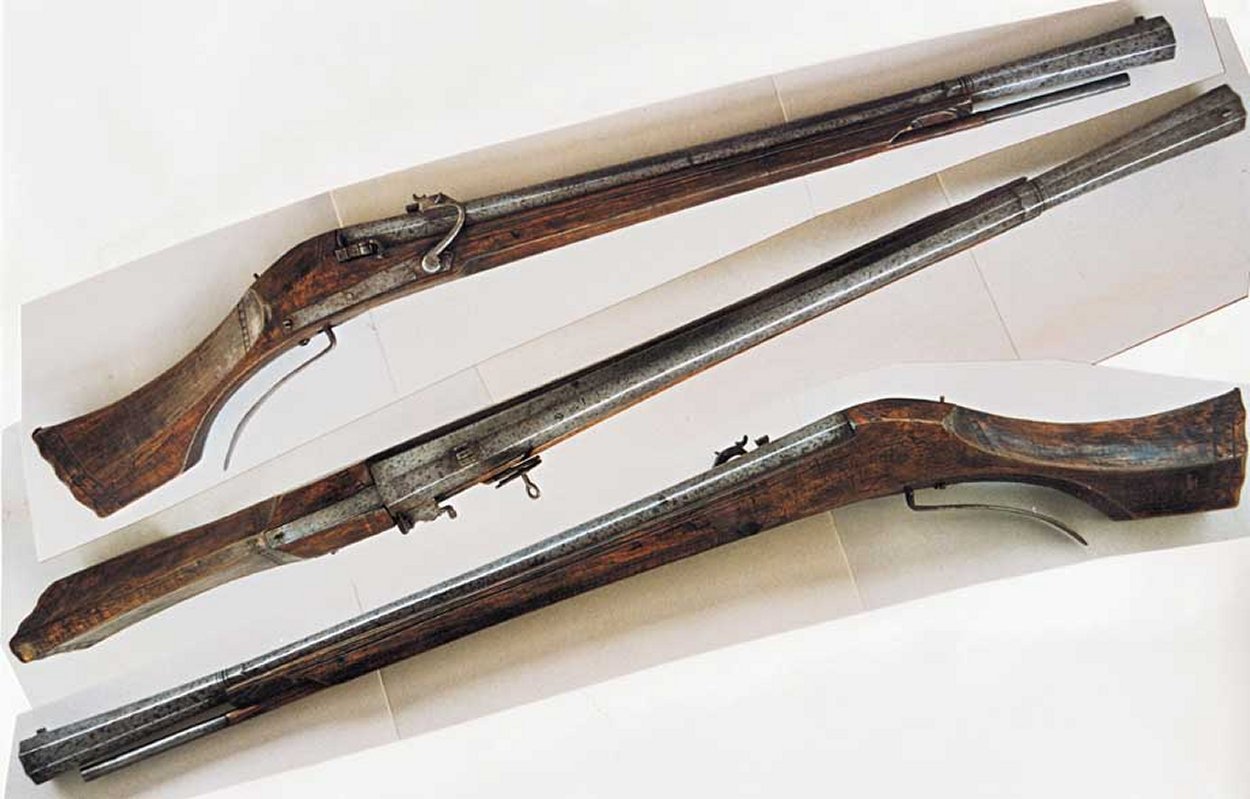

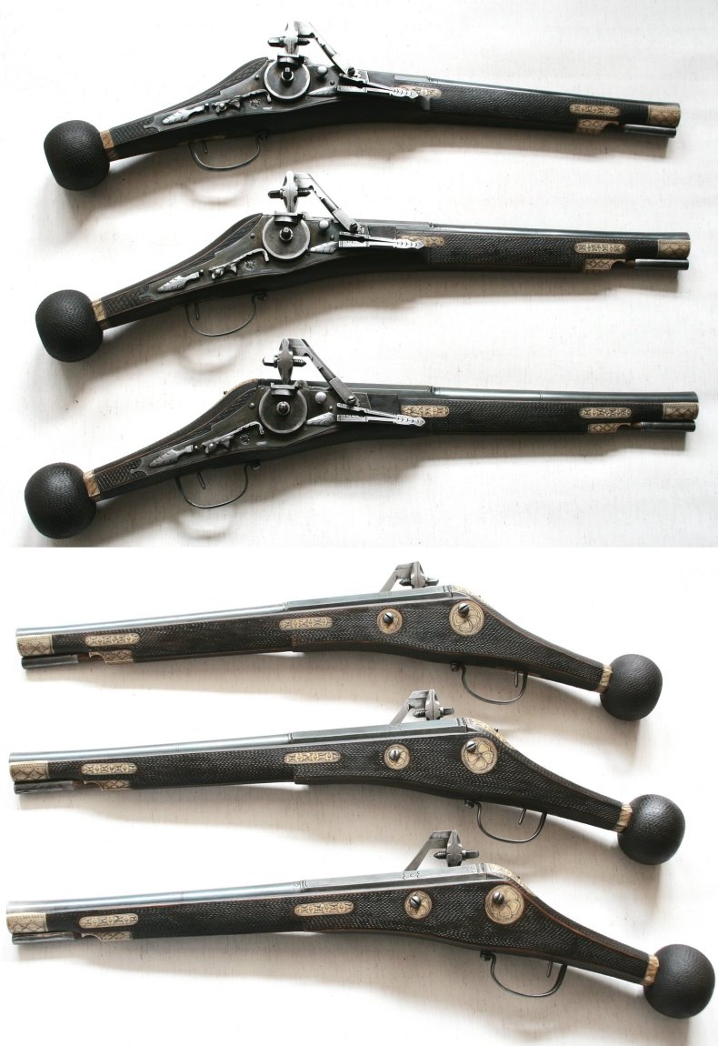

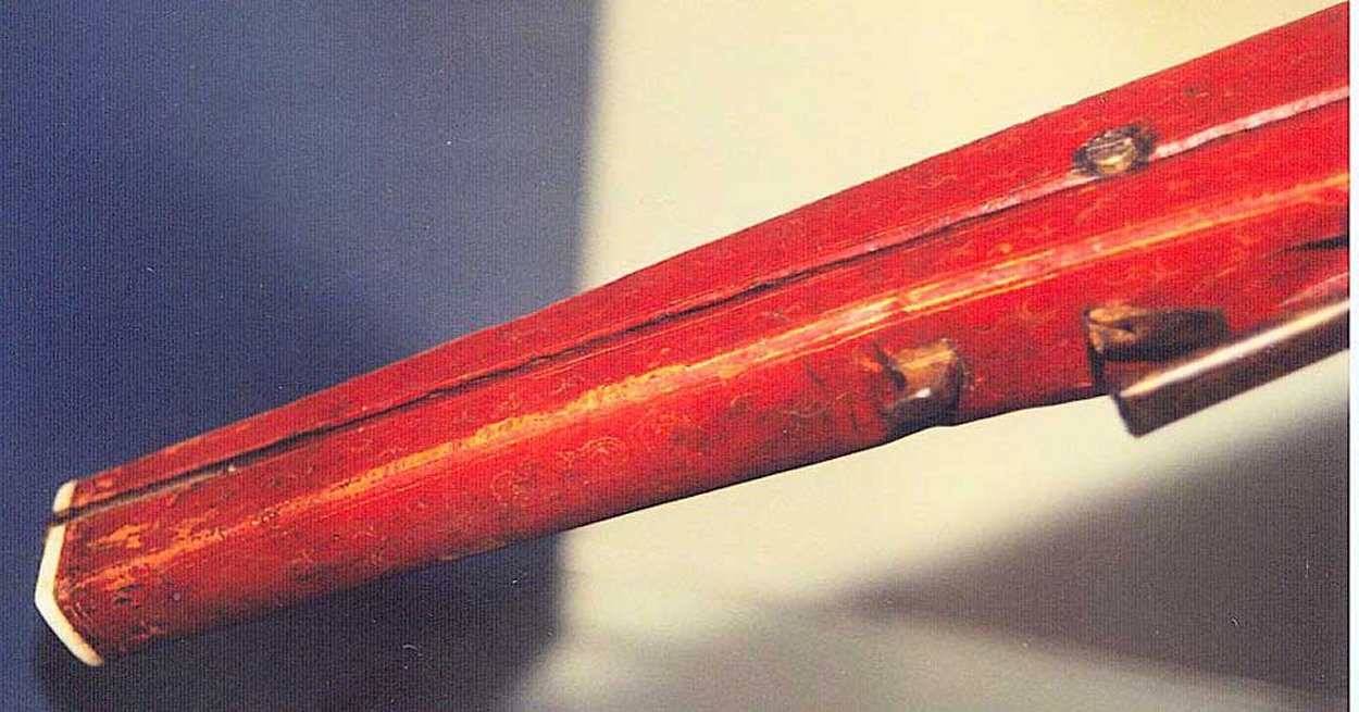

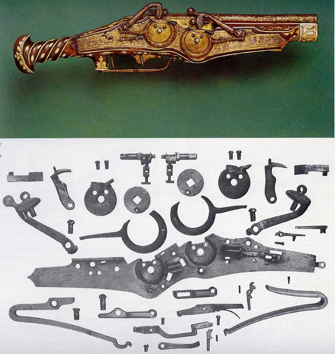

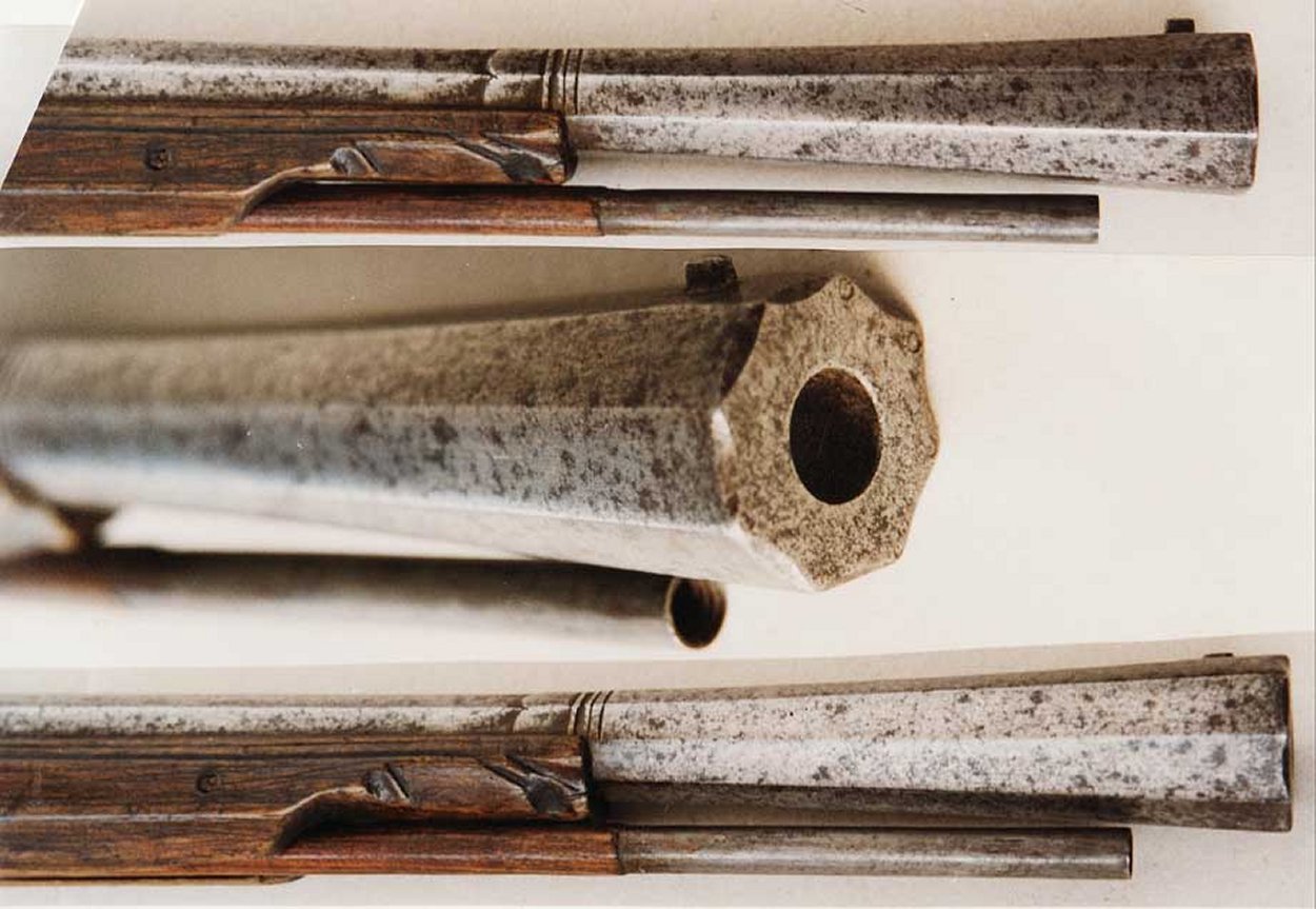

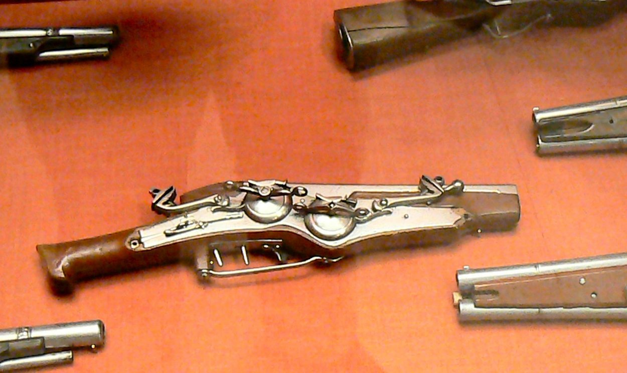

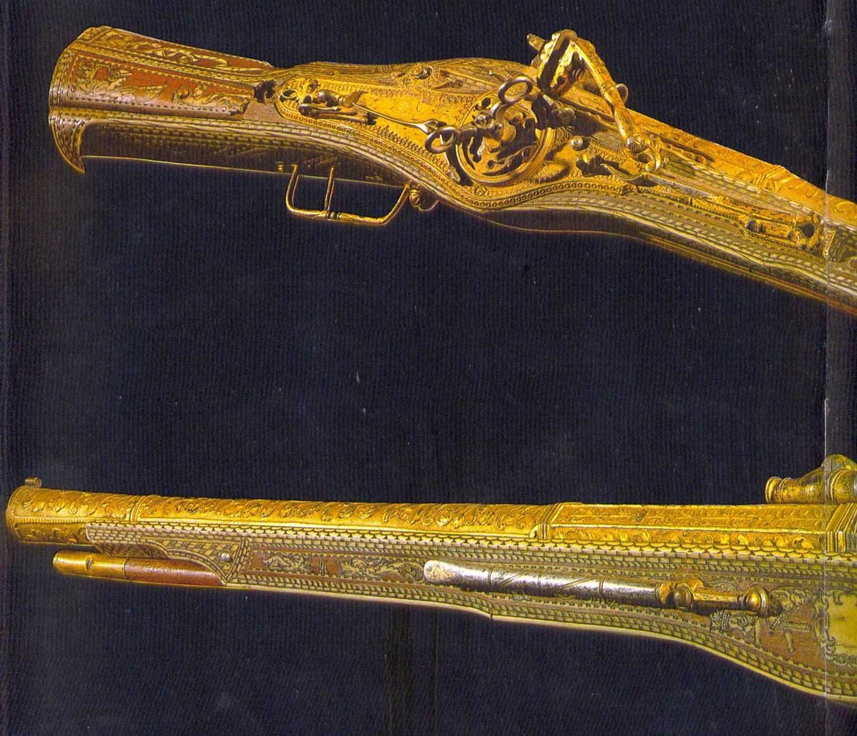

This interesting and early pistol/small arquebus showed up first in the States in Theodore F. Dexter's Scrapbooks in the 1950's and 1960's. It was then in the Frank E. Bivens and Geoffrey Jenkinson collns.
As I have stated several times, the modern term 'pistol' was not in use in the 16th c.; all that those portable small guns were called was just (h)arquebuses.
I remember Geoffrey Jenkinson telling me when we met at a Christie's sale in November 1991 that the only price he would part for from that thing was one million GBP. That price was both so ridiculous and out of my orbit that I called it quits. Moreover I knew that he did not have the arquebus any longer but that it was in the W. Keith Neal colln., Warminster.
On Nov 9, 2000, it was sold from that collection at Christie's London, lot 262, at GBP 43,475 including auction fees, which would be approximately 75,000 euro in today's money. A minor difference as compared to Jenkinson's one million pounds, I should say ... A German dealer bought it for his private collection.
There are only very few surviving specimens of dagger-grip over-and-under double wheellock arquebuses ranging from ca. 1535 to ca. 1550; most of them are in the Real Armería, Madrid, and one is in the Metropolitan Museum of Art, N.Y. The sickle-shaped dog spring running around the wheel is common to all of them.
I do not collect 'pistols', so I did not buy this one. Furthermore, I did not like the overall condition the piece was in, with the date only faintly visible and the ramrod primitively replaced - and painted red ...
After all, I own three Landsknecht matchlock arquebuses, and all of them preserved in fine original condition throughout:
http://www.vikingsword.com/vb/showth...lock+harquebus
Michael

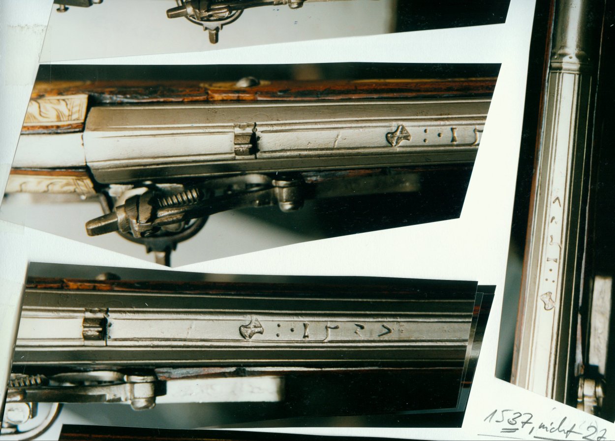

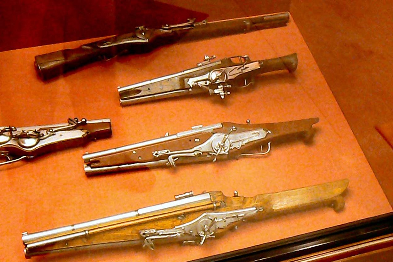

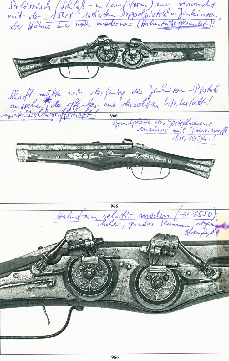

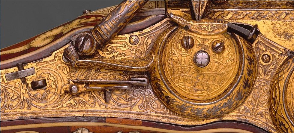

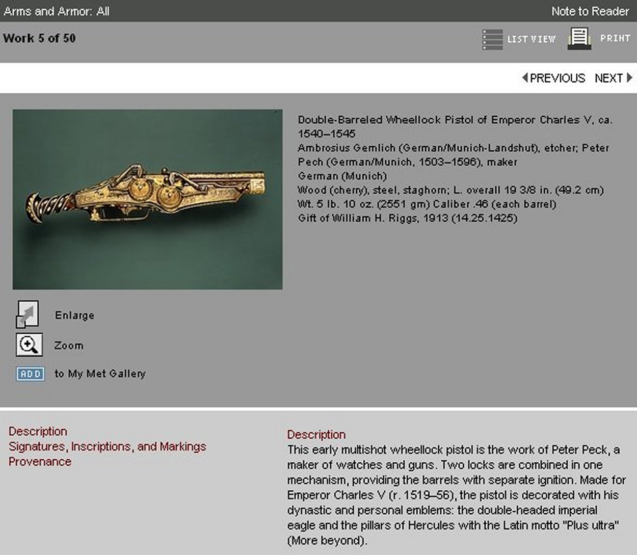

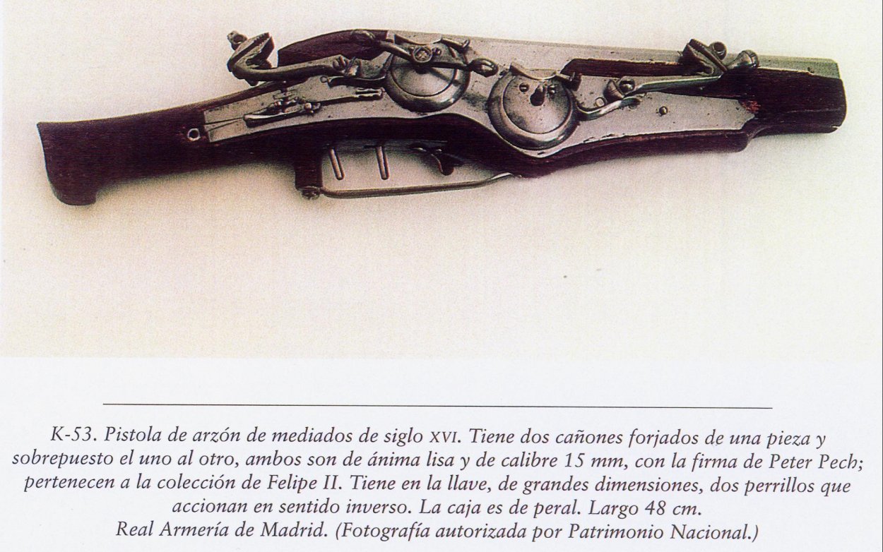

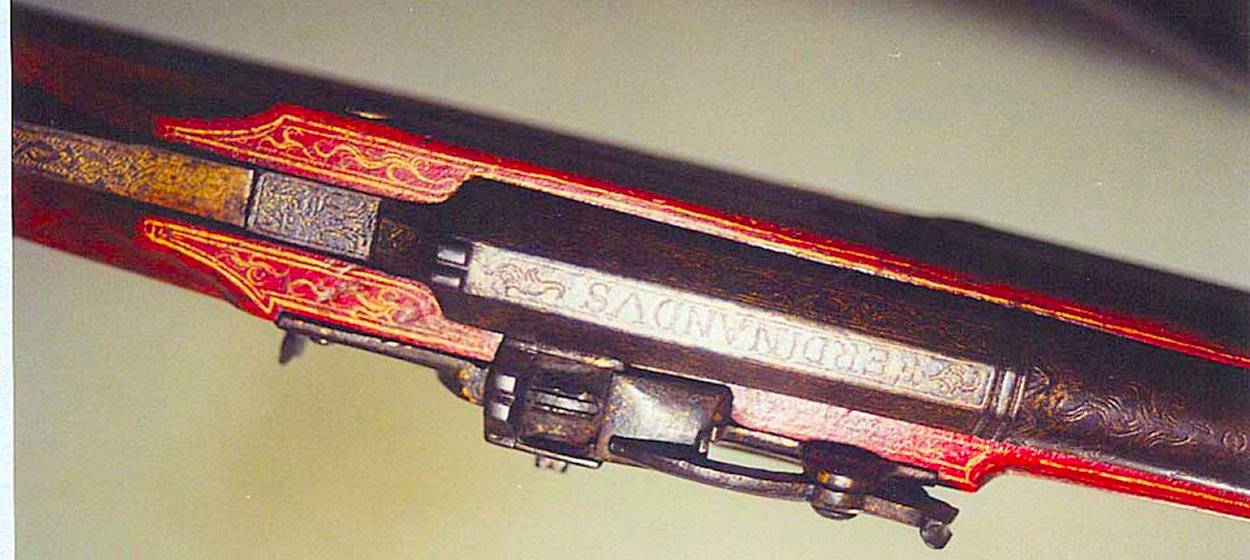

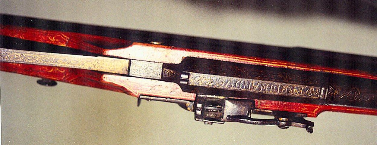

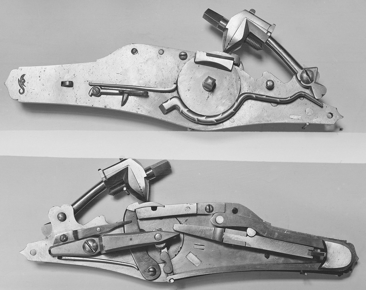

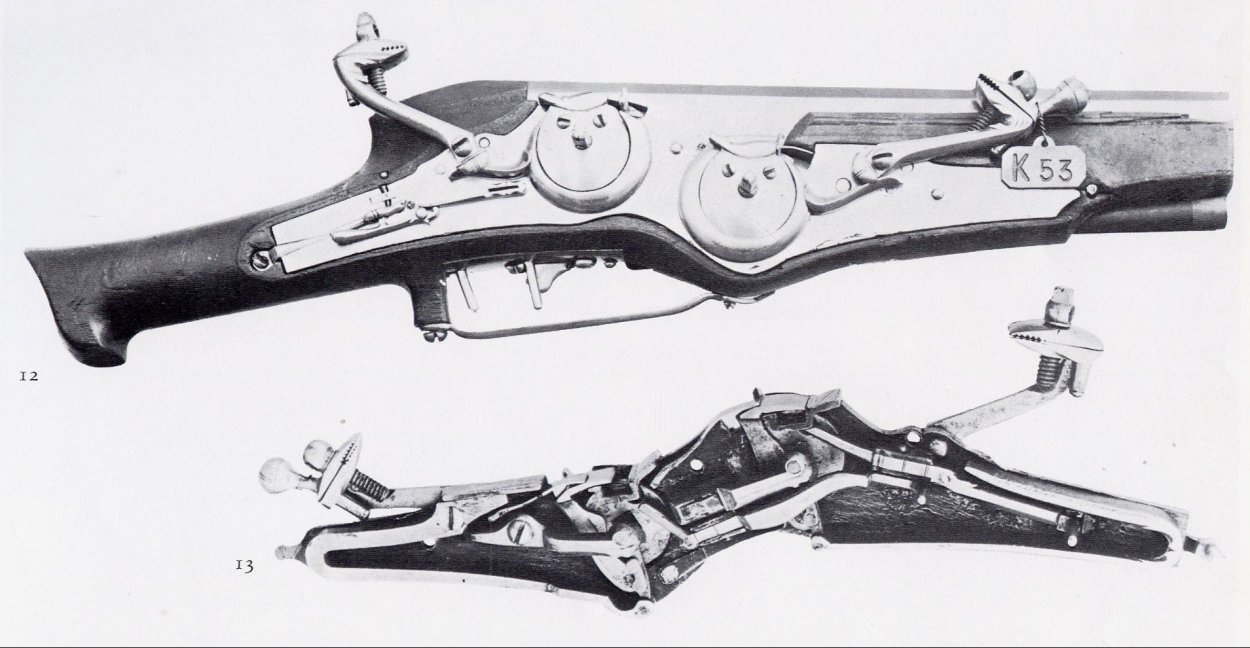

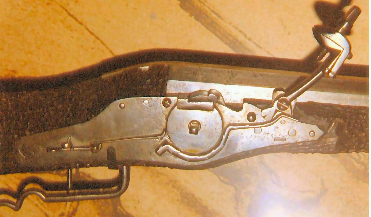

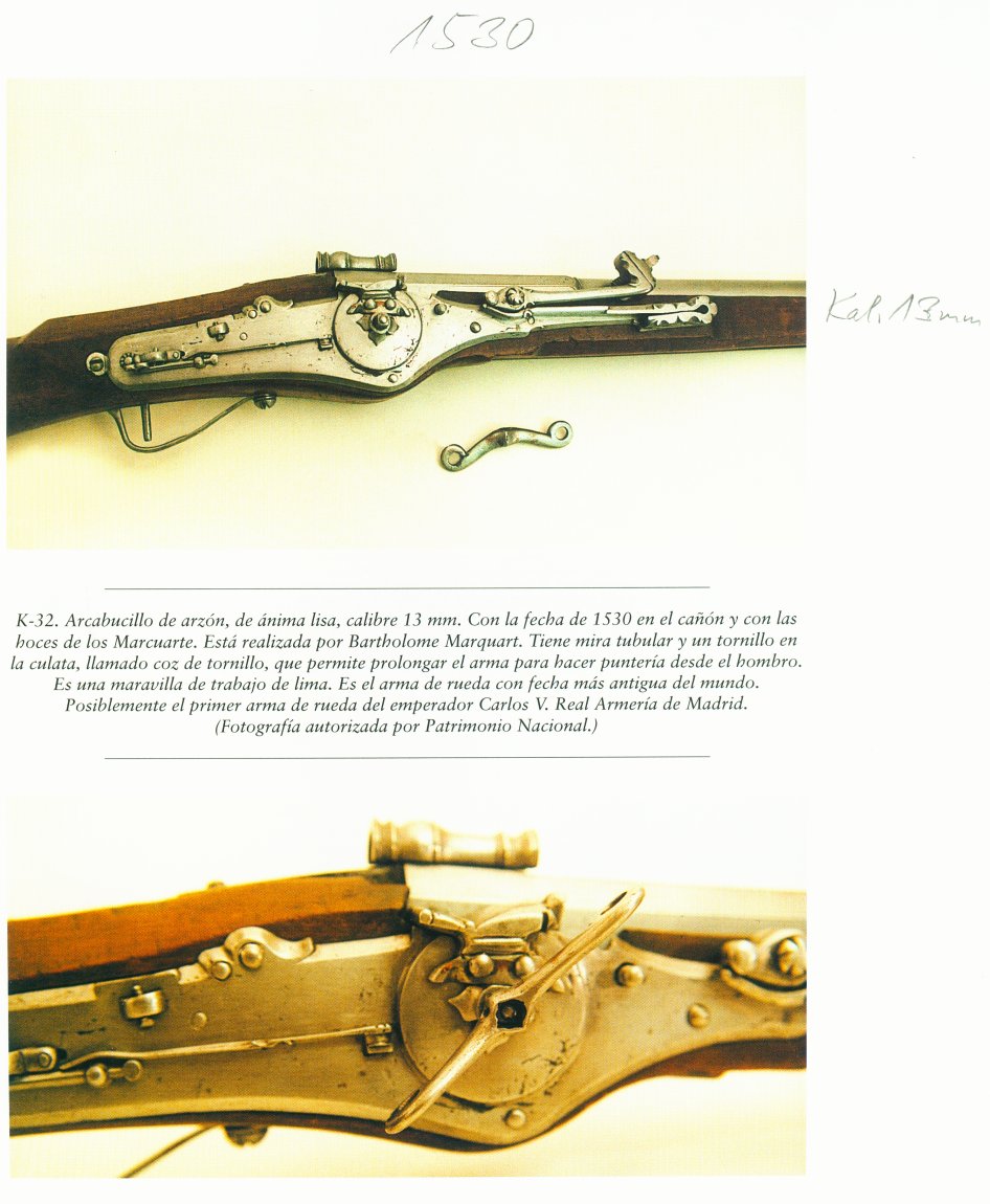

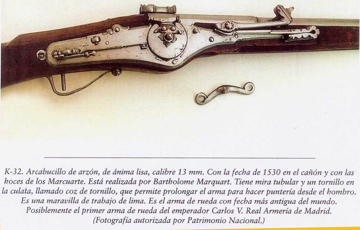

Real Armería Madrid and Met N.Y.

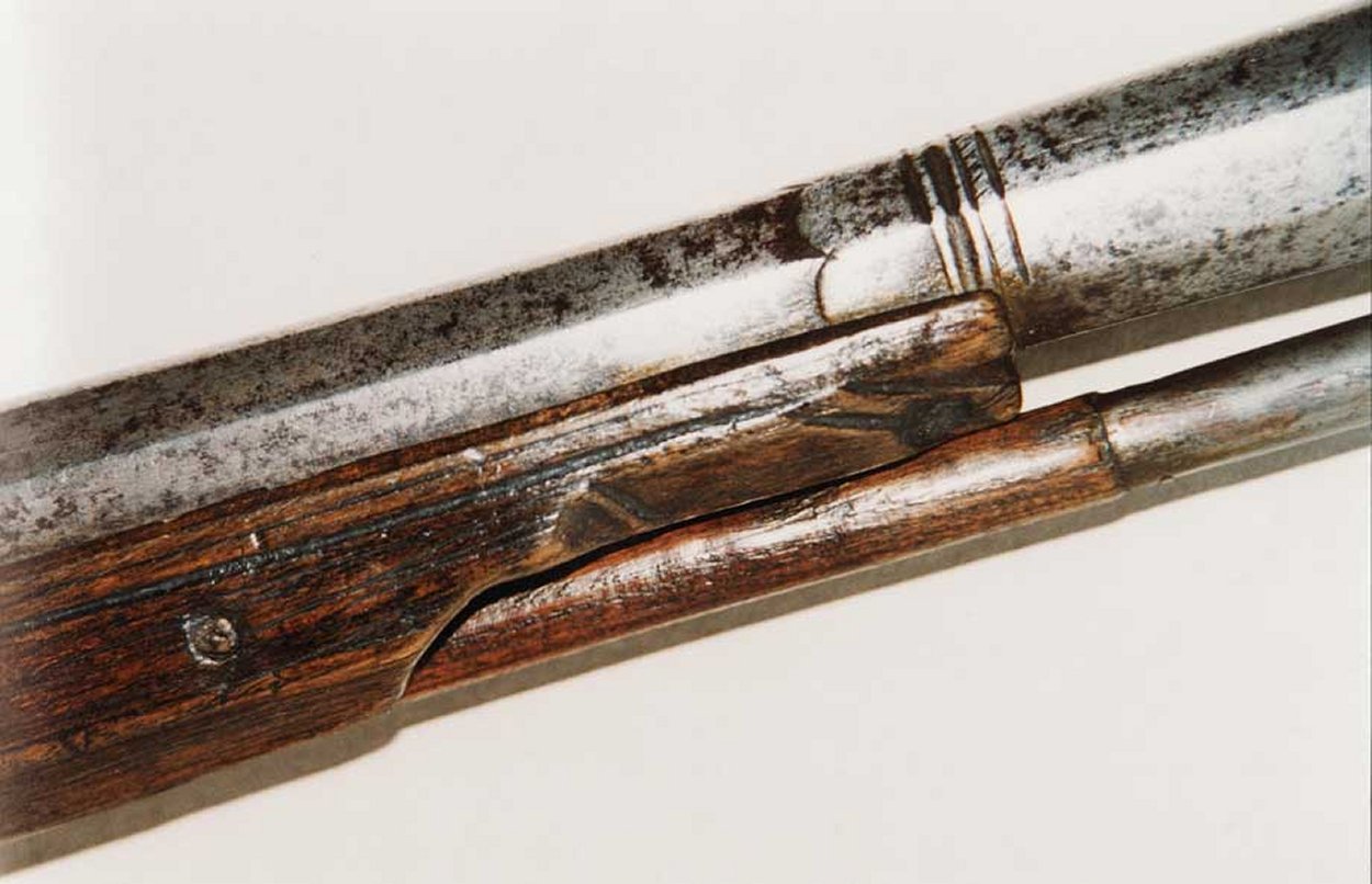

Old 6th December 2013, 07:18 PM   #3
Matchlock
Matchlock's Avatar
Join Date: Sep 2008
Posts: 4,310

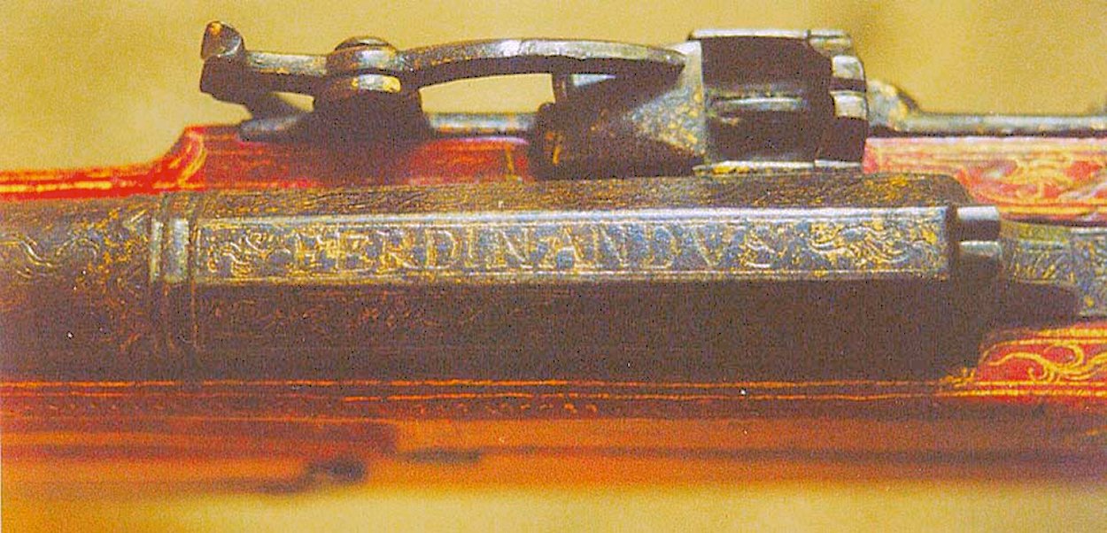

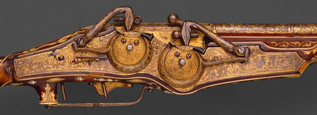

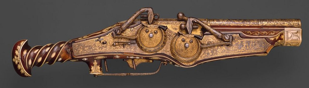

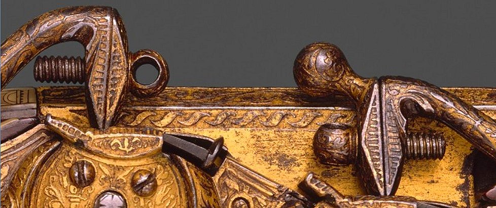

The Met.

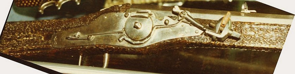

Yes , very nice . But perhaps you could have mentioned what is really remarkable about the 1548 lock is that it has sliding pan covers with button release. All the others in this group have the earlier style of hooked pan cover where the cover and arm are in one piece. Presumably , as in the Met example ,it also has two piece interlocked sears. Thus establishing that all the classic features of wheelock design were , at least in Germany, present at this early date. Which begs the question whether early Italian wheelocks that don't have these features are earlier in date. Or whether the advantages of cheapness and simplicity outweighed the occasional expense of having to compensate wounded prostitutes.
Old 8th December 2013, 01:28 PM   #6
Matchlock
Matchlock's Avatar
Join Date: Sep 2008
Posts: 4,310

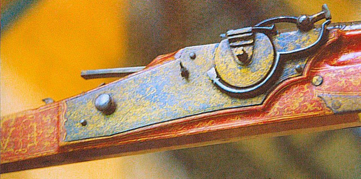

Well, Raf, the mere fact that North Italian wheellocks do not have the spring-loaded push-button pan-cover release (German Drucknagel) is not per se a hint for their being the first made.
The button is generally present in Germanic wheellocks from ca. 1530-1610.
Not all German wheellocks feature that button though, and it is gone again and for good by the early 17th century.
Michael

Sorry Michael. The point seems to have got lost somewhere. I wasnt suggesting that the push button pan release ; the presence or lack of it , was of any particular geographic or chronological significance.
It seems from about 1535, and certainly by 1550 the wheelock in Germany had achieved all its classic features . But without , as far as I am aware much evidence of a development stage. In contrast , in early Italian wheelocks , we see a much wider range of solutions to problems that look more like a developing idea. Such as single locking bars (Da Vinci ) , matchlock style slot in wheel pancovers, exposed mechanisms etc.This is not a who invented the wheelock argument but it might be an argument for independant lines of development .The question was whether we should regard these Italian locks as being earlier than the earliest known German examples or simply that the Italians did things differently and for whatever reason were slower to adopt more mechanically sophisticated (and safer!) solutions.
And yes , their is I think a simple theory why push button pan covers might have been considered a desirable neccesity on some classes of firearm and an optional extra on others....

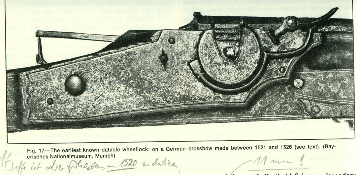

Oh yeah, Raf, I see and it's my turn to be sorry now.
On the other hand, South Eastern European countries such as Hungaria - think of the Komorn swamps and River Danube finds! - or Romania went their own separate ways in developing spectacuar wheellocks as well. For more than 30 years, in my theories I have ardently pleaded for accepting parallel individual strategies/lines of access to the wheellock development, so I am all in your corner as far as this is concerned!
I do bear my doubts though as to whether to look upon early Italian wheellocks as 'earlier in time' than Germanic ones. More archaic they may seem, no doubt.

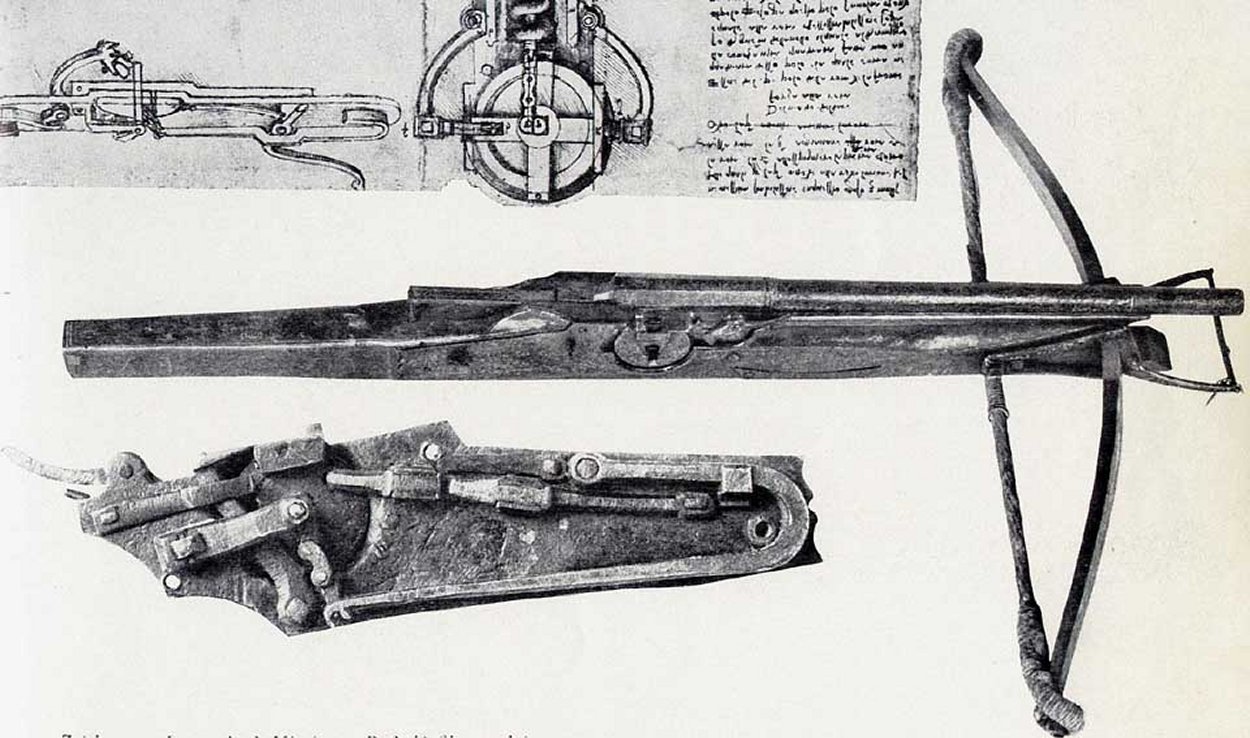

E.g., please cf. the locks of the earliest datable wheellock/crossbow combination in the Bavarian National Museum Munich, ca. 1521-26 (my personal guess is ca. 1525+, and I have handled it several times, alas without being allowed to take the lock out), and the earliest dated wheellocks in existence, a small Augsburg Marquardt arquebus of Charles V d. 1530, and another, very finely executed, of identical provenance and dated 1531, plus a completely different combined wheellock and snap-tinderlock Munich arquebus in the Liège Musée de l'Armée, dated 1532, the etching by Ambrosius Gemlich, plus an early-1530's wheellock gun in the Royal Armouries Leeds and some detached mechanisms in the Dresden Armory.
Thus we have a line of datet or closely datable wheellocks from ca. 1525-35.
Some of the wheellock combination weapons in the Doges Palace in Venice may be from the 1520's or 1530's but they are not dated, and their earliest combined crossbow and gun seems so archaic that one might assume it was made in the first decade of the 16th century (ca. 1505, as one authority believed), which is probably not true ... I have always tentatively assigned a dating of '2nd to 3rd decade 16th c.' to them, and their axe and gun combination is dated 1551 ...
P.S. It is great to have finally found somebody with a good insight in early wheellocks!!!

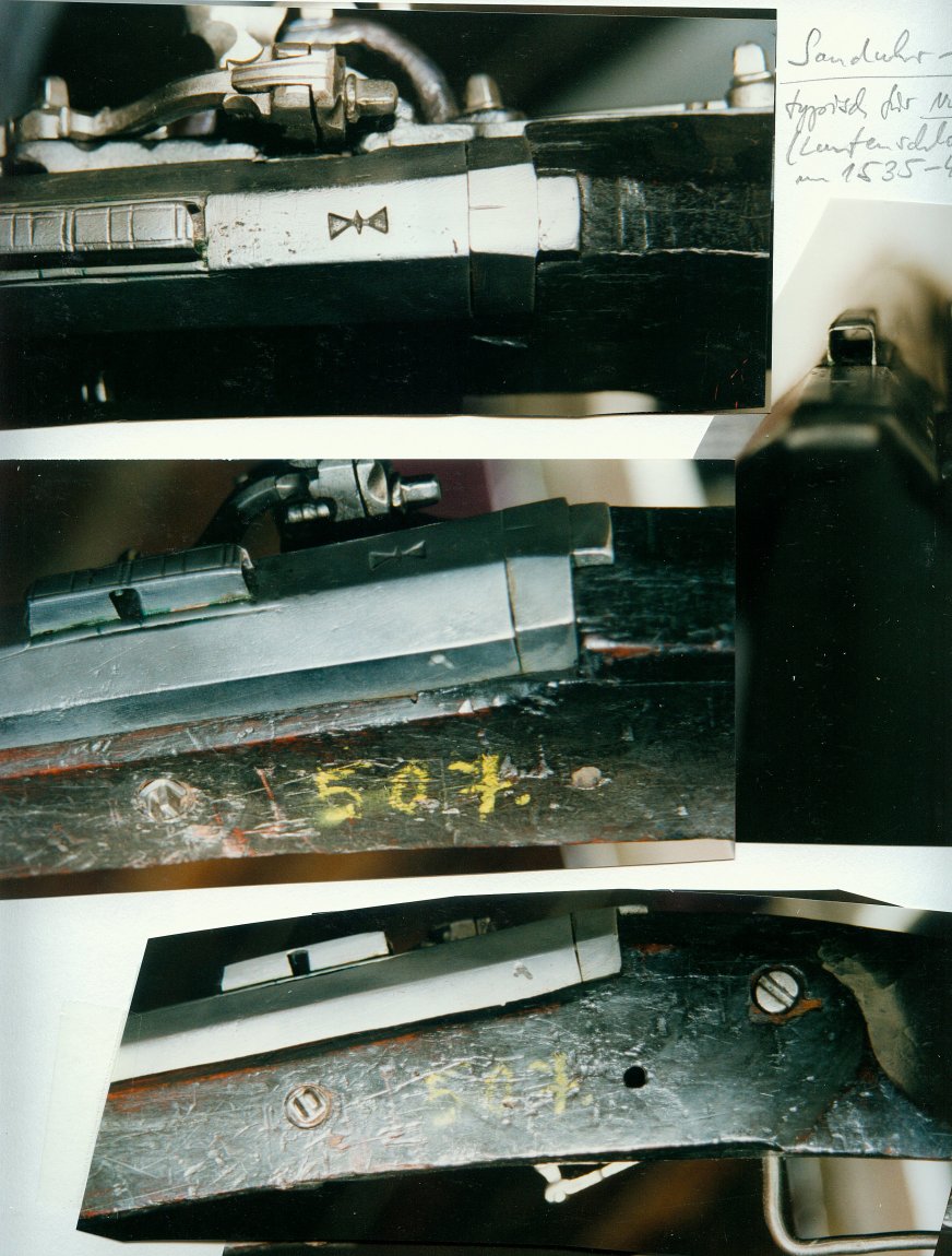

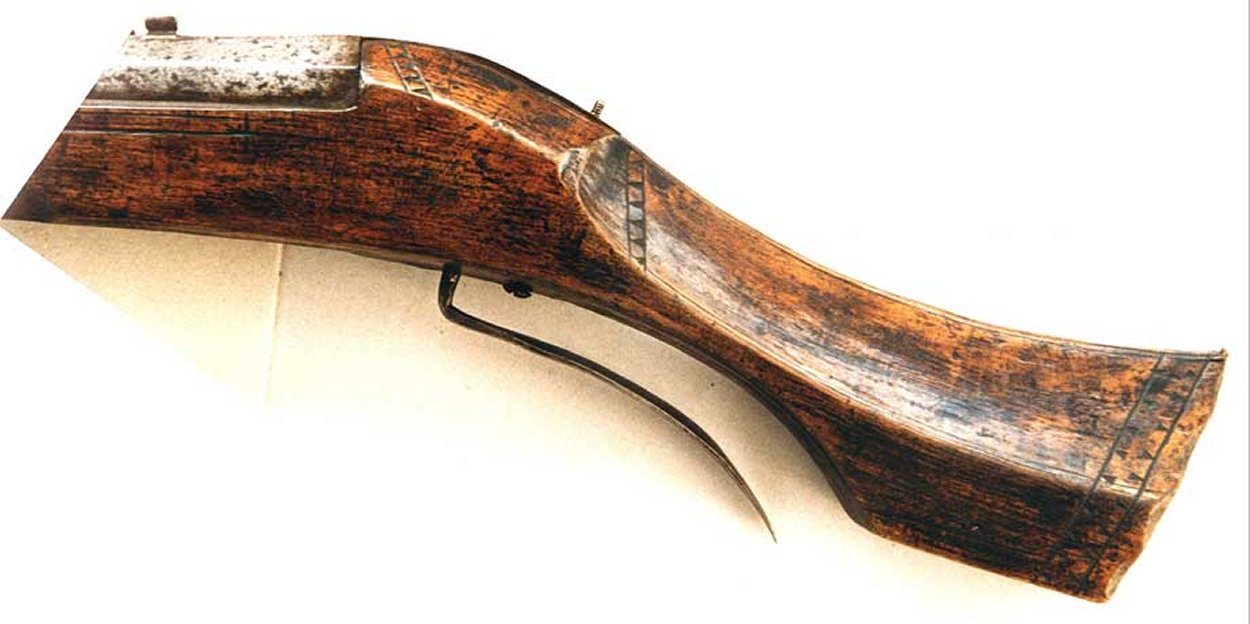

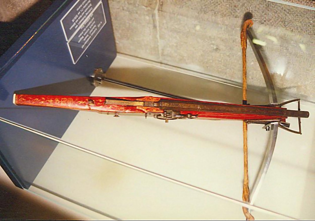

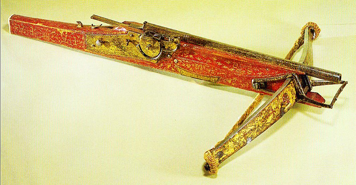

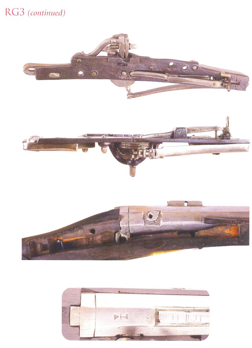

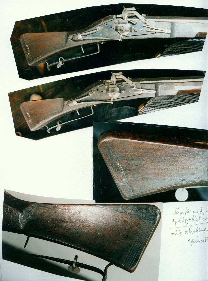

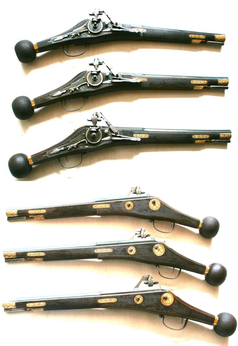

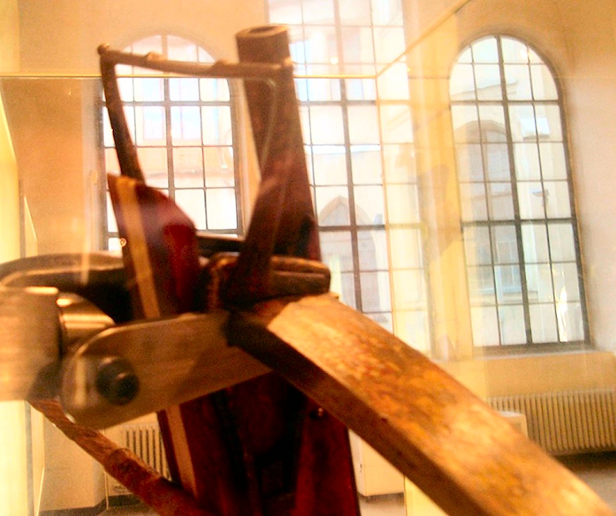

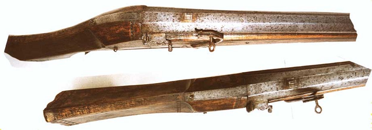

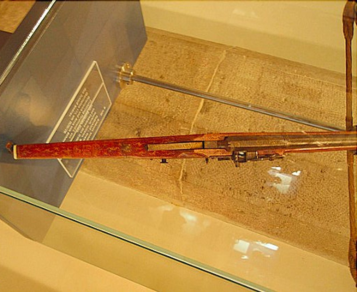

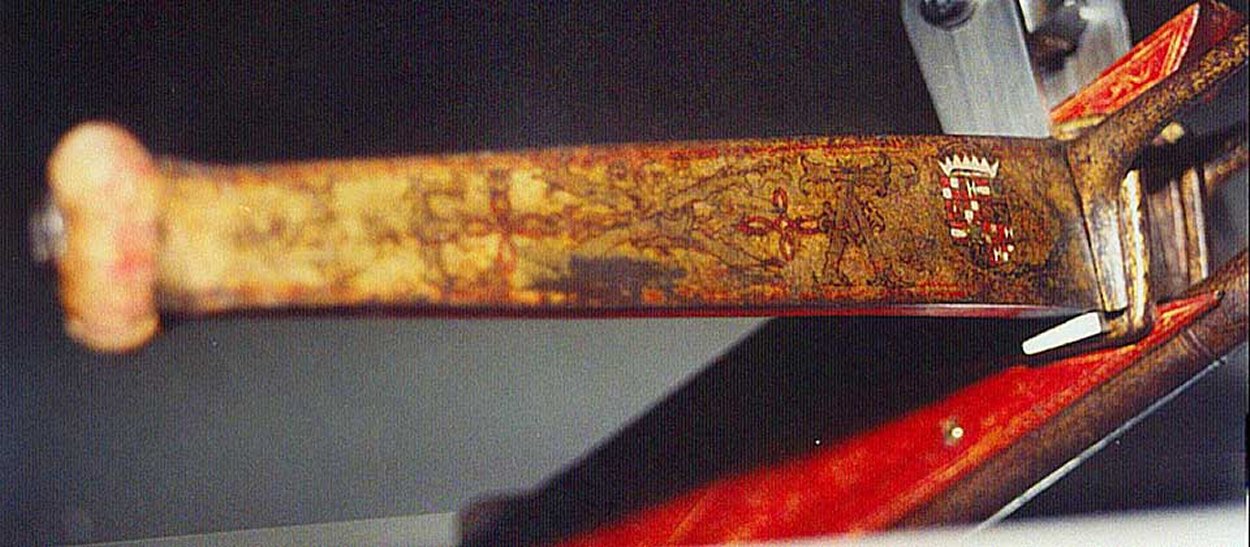

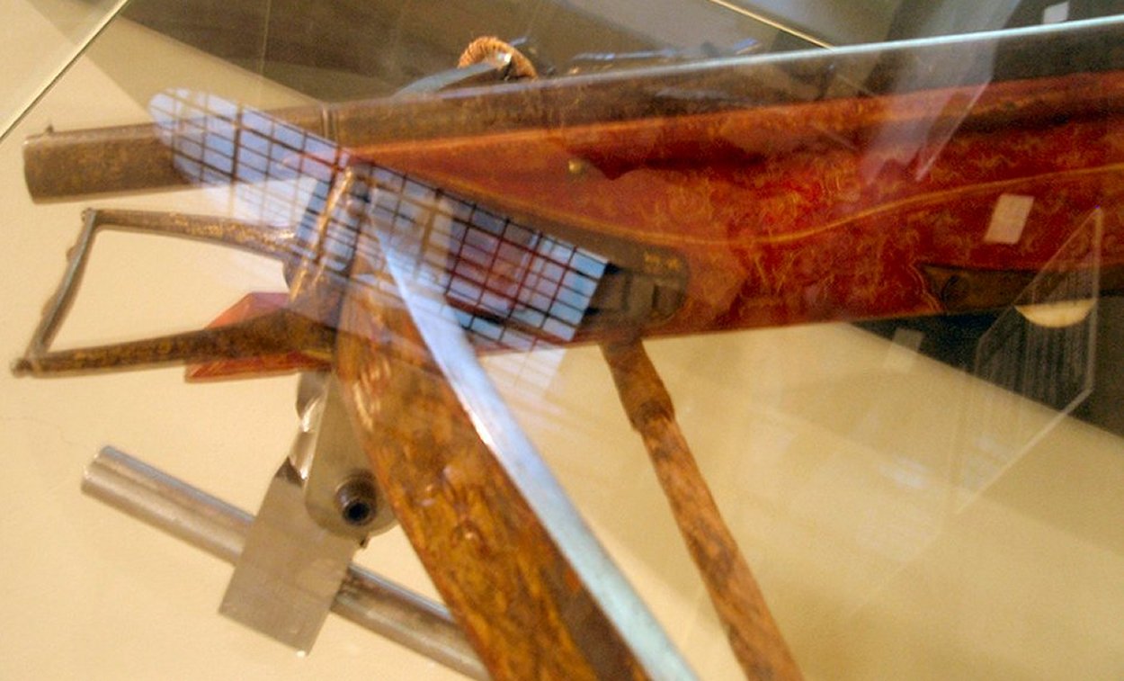

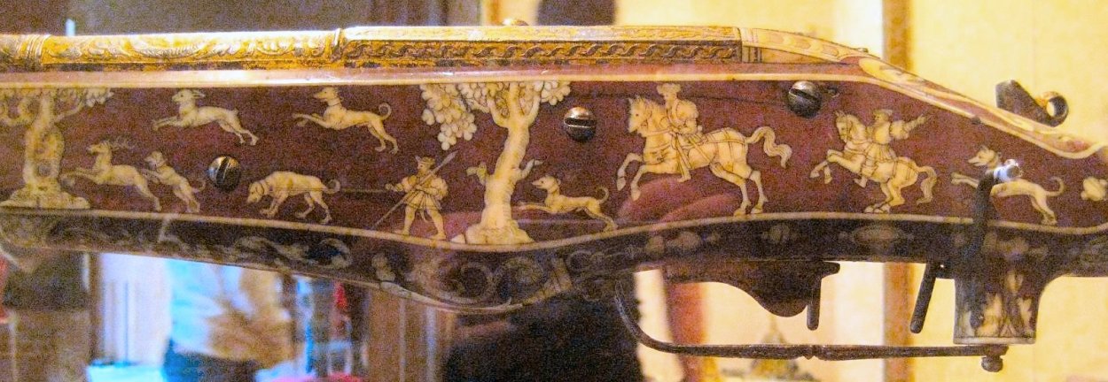

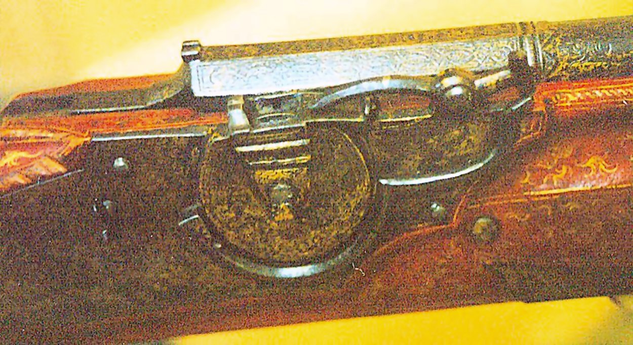

Here are all the images that the Bavarian National Museum Munich allowed me to take of their famous wheellock/crossbow combination of ca. 1521-6, the barrel signed in etching FERDINANDUS, over a span of more than 30 years (!). Some of them were taken using flashlight, which of course is illegal ... Who cares anyway? The crossbow won't mind, either, and I needed the information !
I remember posting some of them here on the forum but the search button cannot find a single one! GRRRRRRRRR !!!!
Do you have any photos of the Venice pieces?
m

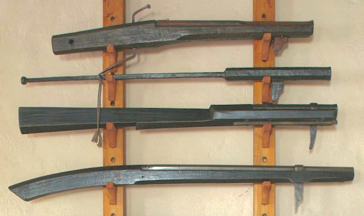

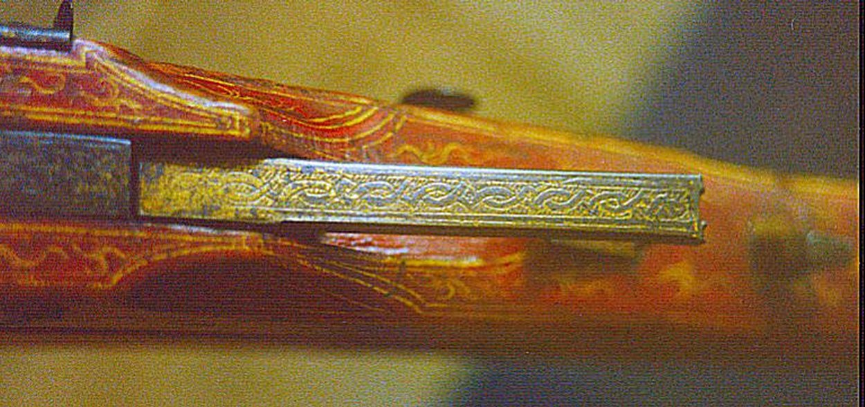

Matchlock's Avatar
Join Date: Sep 2008
Posts: 4,310
Old 9th December 2013, 07:15 PM   #12
Matchlock
Matchlock's Avatar
Join Date: Sep 2008
Posts: 4,310
m

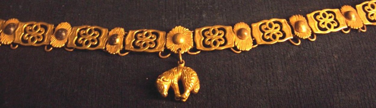

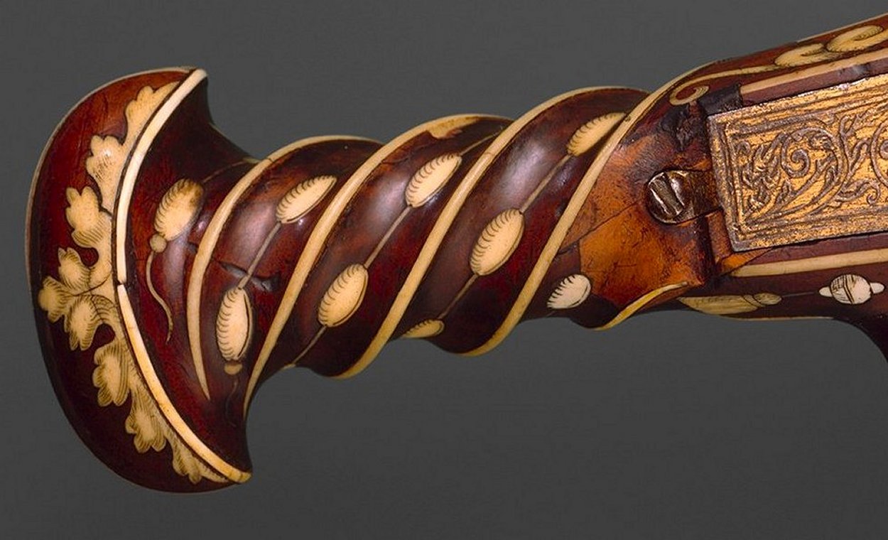

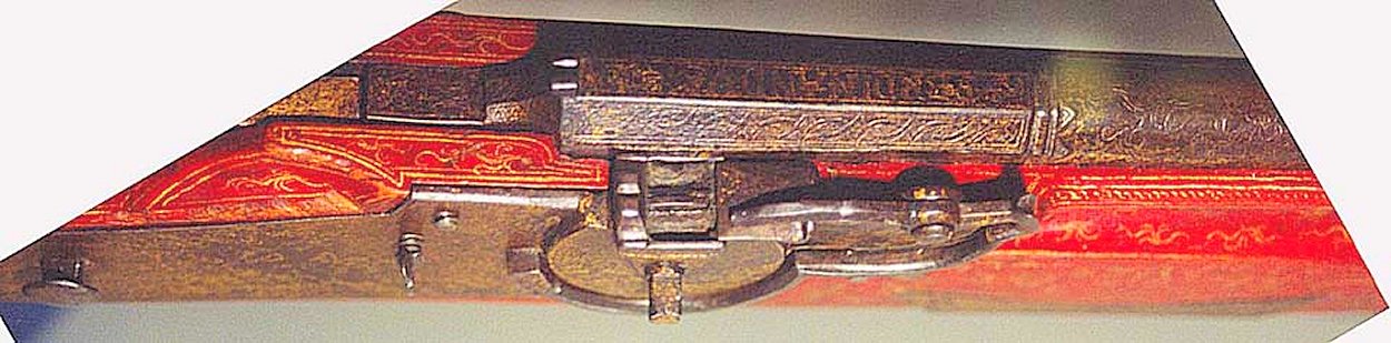

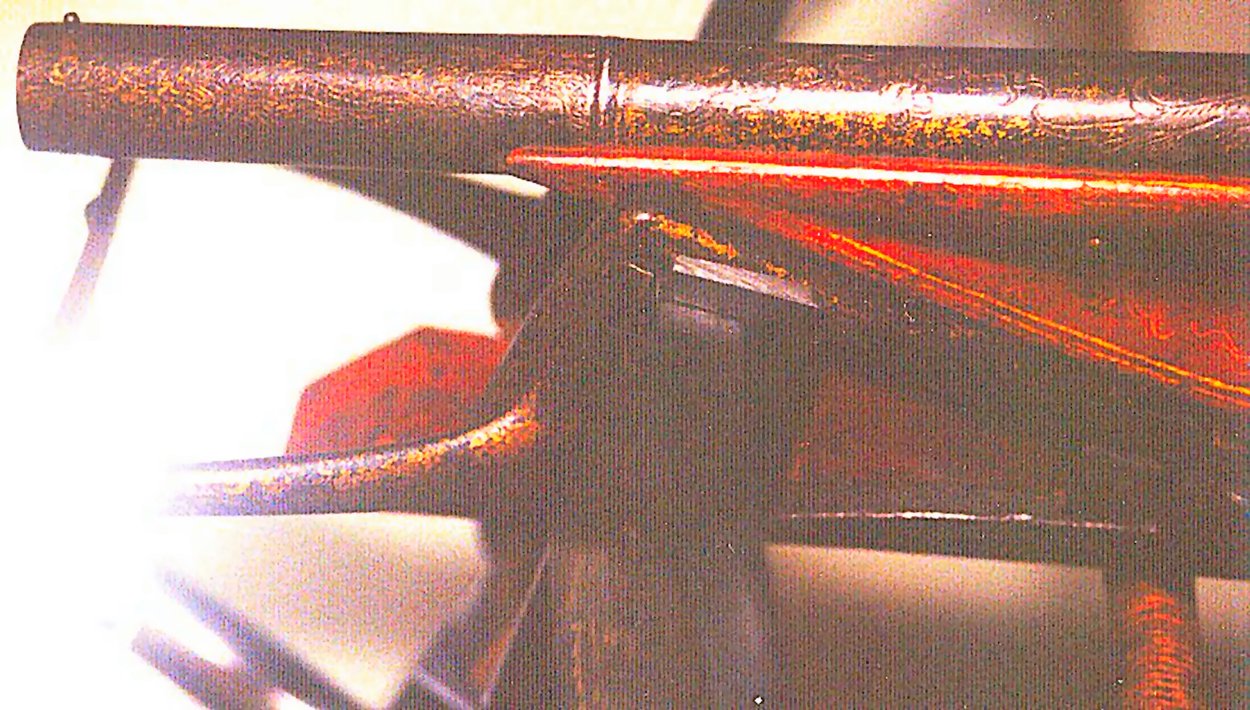

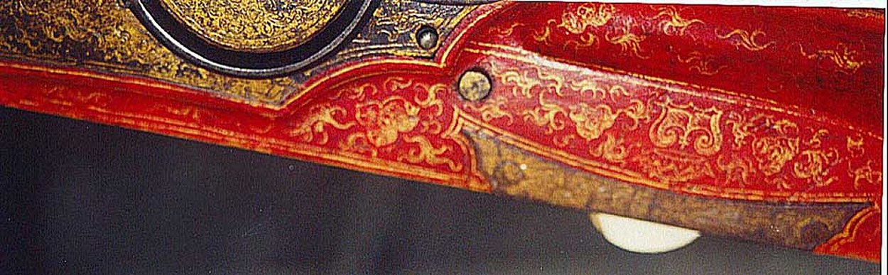

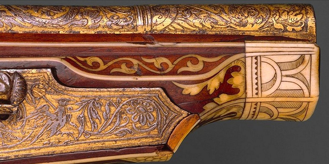

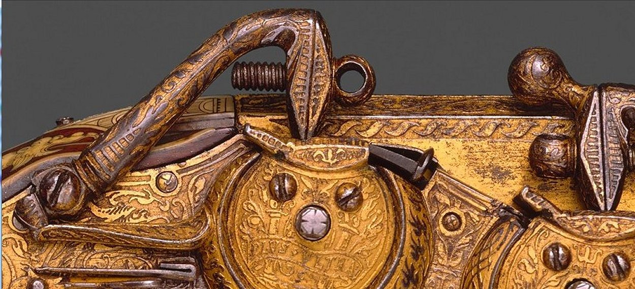

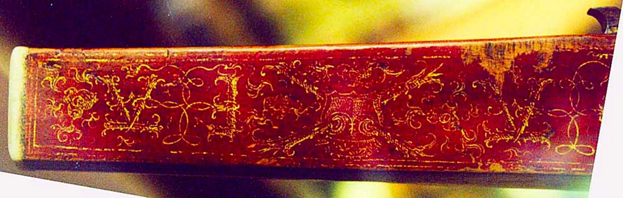

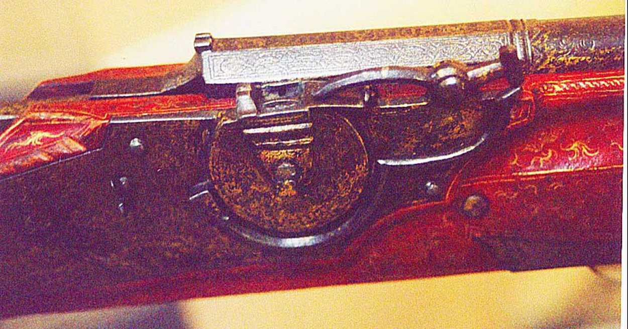

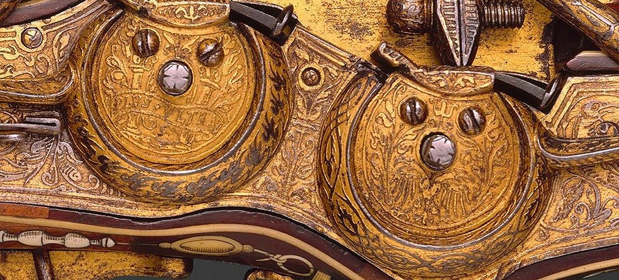

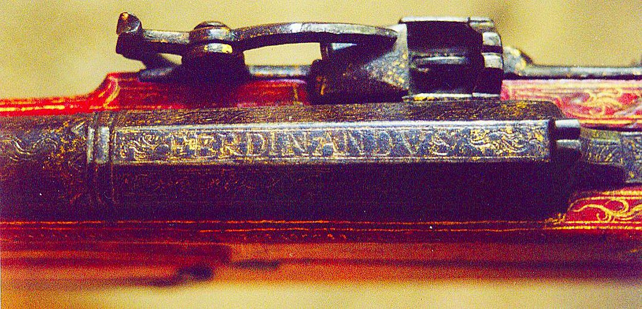

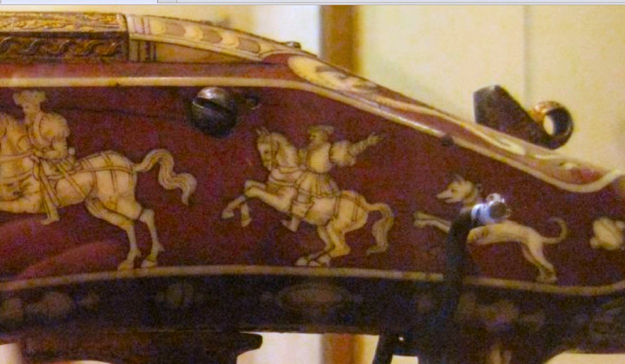

A few details of decoration:
the Cross of Burgundy and the Chain of the Order of the Golden Fleece (Kette des Ordens vom Goldenen Vlies).
m

Thanks for the picks .Did our posts cross somewhere? Compared to the Venice crossbow / wheelocks ( c 1510 ) the german version looks like its from another planet. Rather makes my point . With the exception of the hooked pancovers these early locks have all the classic features of later locks and one is left wondering where the development took place, how it was so rapid and why we don't see in German locks the same kind of 'primitive' features we see elsewhere. Please reasure me that the B and W pictures of Royal Armouries X11 1566 is a modern copy. Not the orrigional lock attacked by the Conservator from Hell...
Old 9th December 2013, 07:53 PM   #15
Matchlock
Matchlock's Avatar
Join Date: Sep 2008
Posts: 4,310

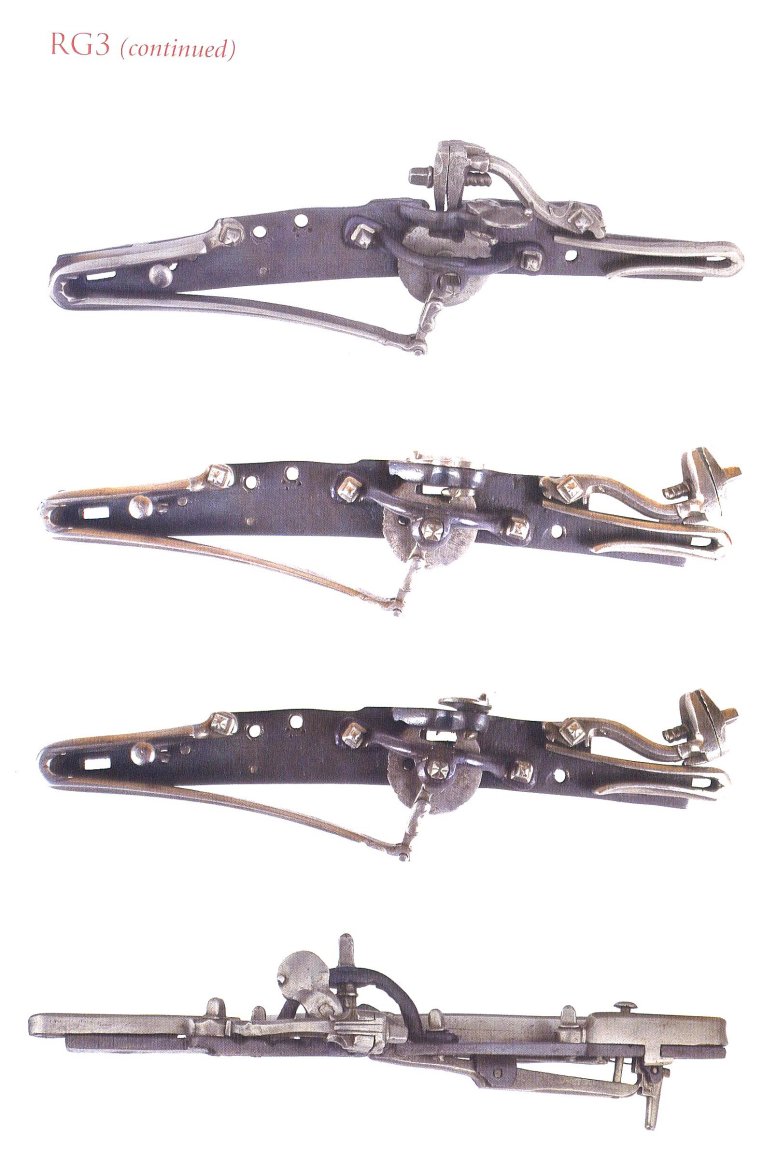

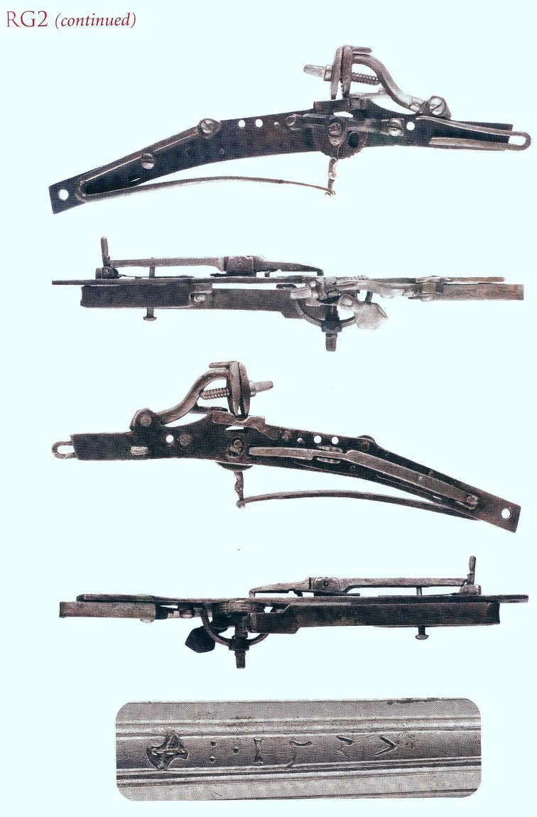

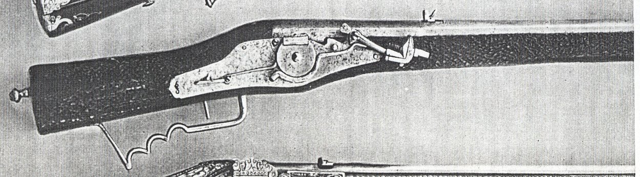

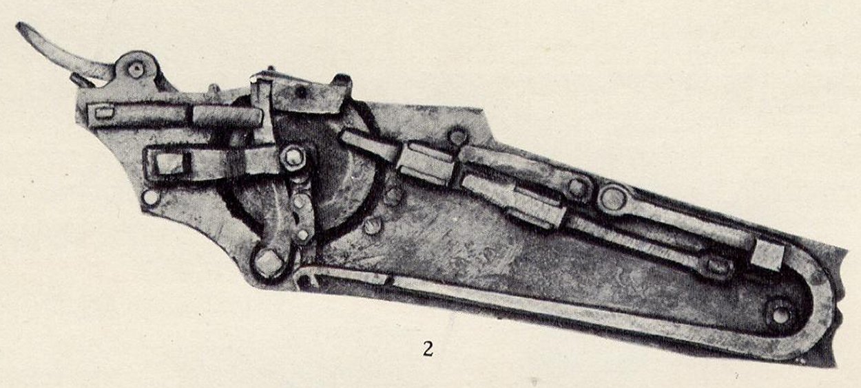

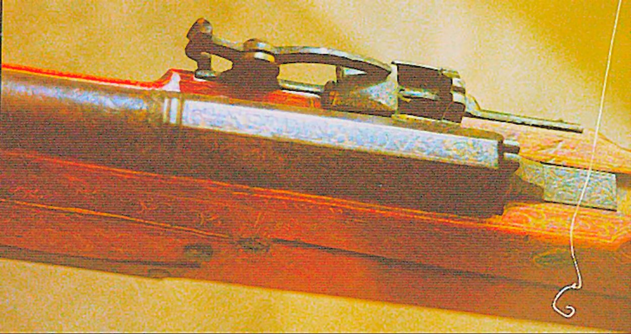

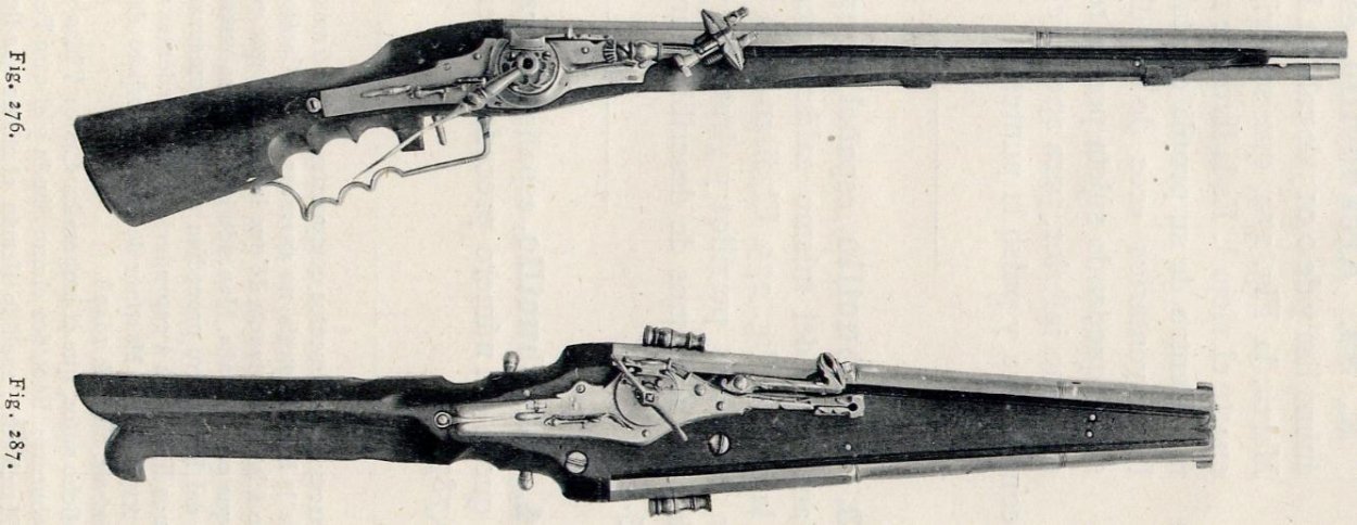

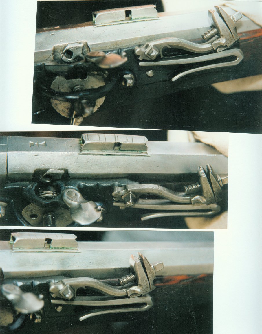

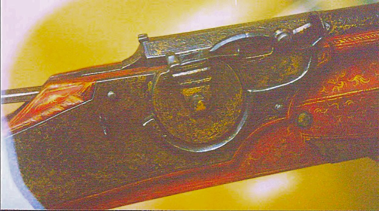

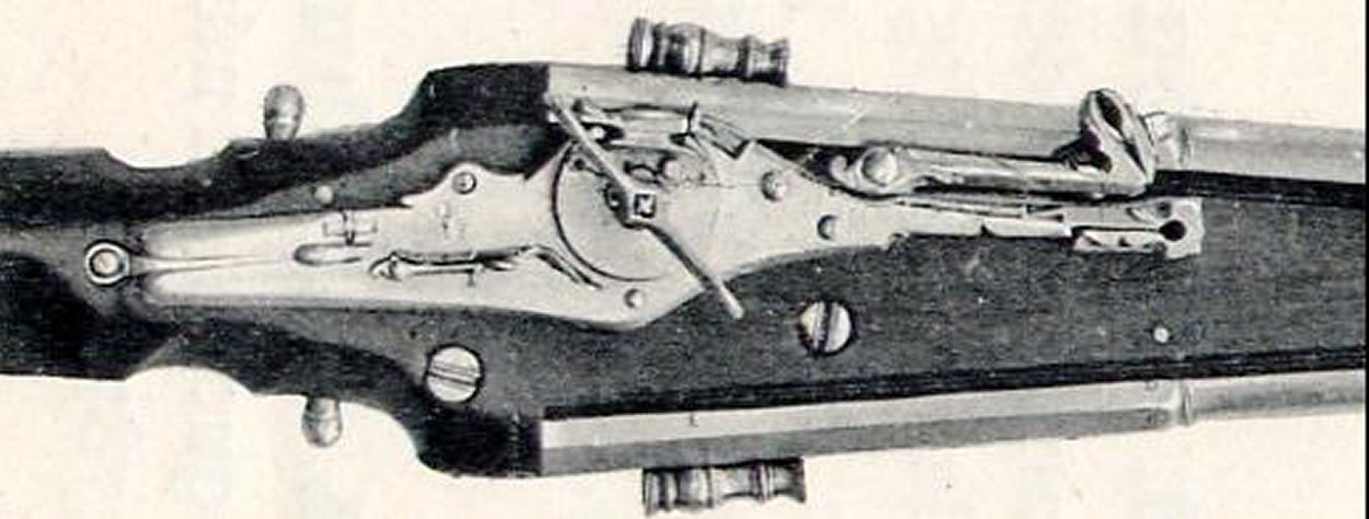

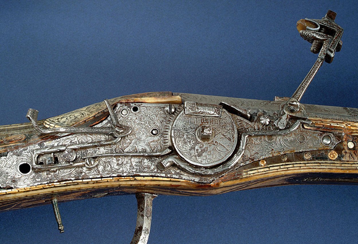

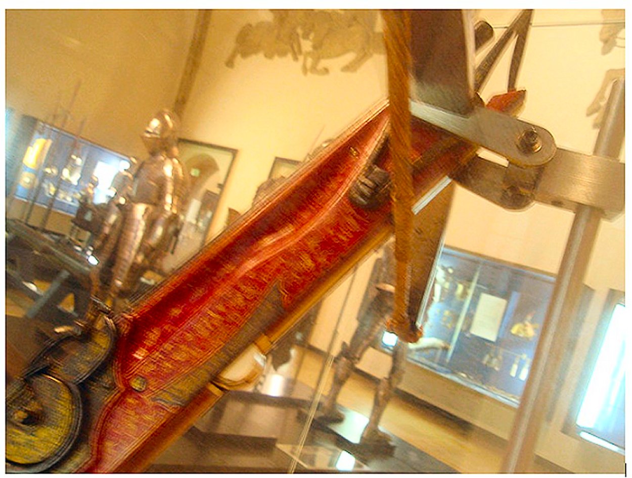

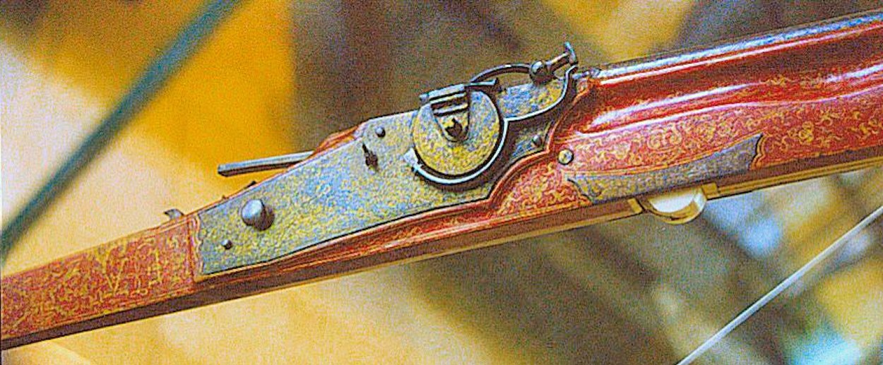

I'm not sure what picture you mean but this ca. 1530 Augsburg/Munich lock is in the Dresden Armory and is preserved in the same perfectly original condition as the gun with the same makers mark (a dolphin??) on both lock and barrel of a long arquebus in Leeds, the stock all veneered in natural staghorn (bought via Fischer, Lucerne, in 1932).

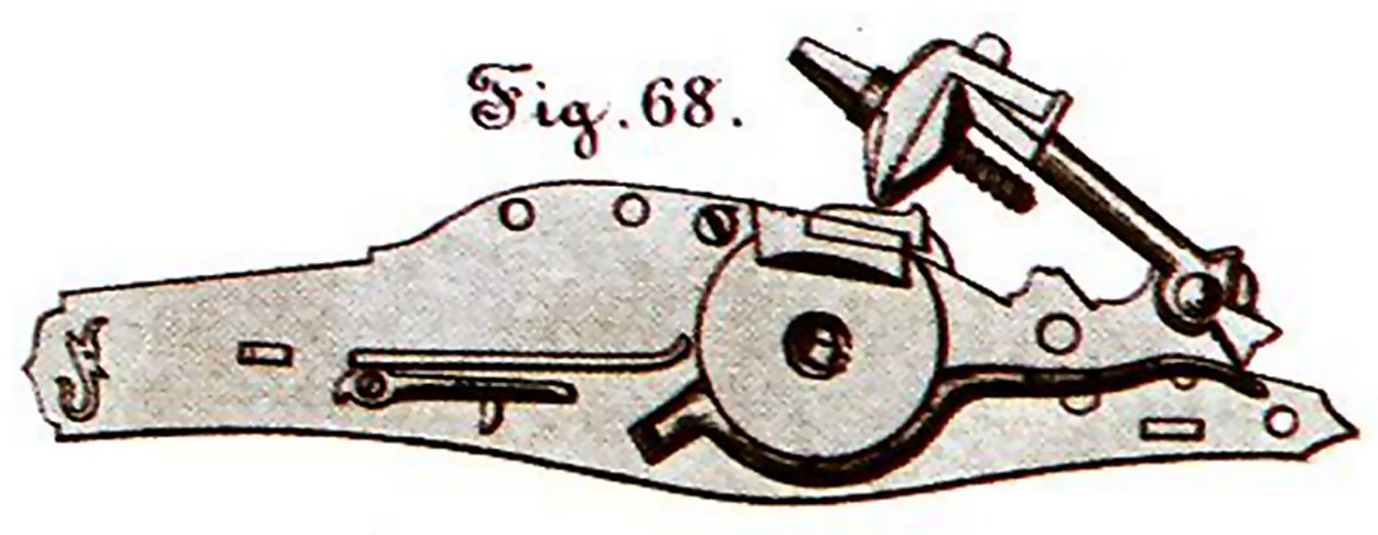

In the 1870's, Moritz Thierbach had a line drawing of it made for his work Entwickelung der Handfeuerwaffen ...
Just because they are almost 500 years old these items do not necessarily have to look like pieces of dirt or as if they were excavated.
E.g., take the famous Monk's gun ...
I do keep many extremely early items in my collection that still are in perfect overall as-new condition (plus patina). I bought them because they were in such a good condition!
m

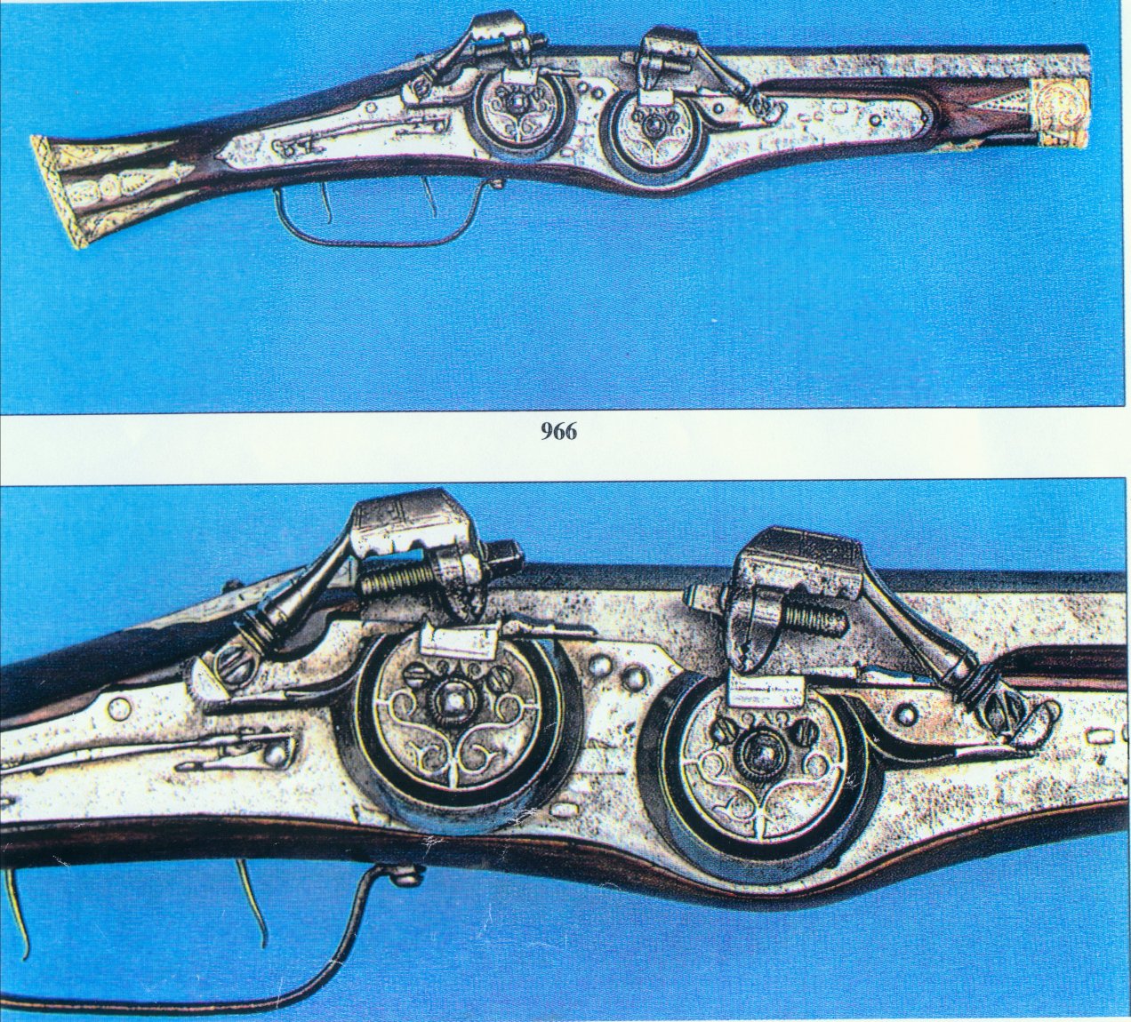

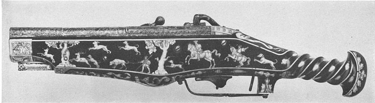

Back to the roots for a moment, meaning the short double-barreled arquebus from post #1.
A very similar small arquebus (nowadays commonly called a pistol), the iron parts ca. 1545-50, of similar dimensions (overall length 46.5 cm) but sadly newly stocked in 1560's style, was sold at a German auction: Hermann Historica, Munich, 33rd sale, 22nd March 1996, lot 966. The almost identical lock, the prite dogs and pierced wheel covers were characteristic of the mid-16th c. Nuremberg style.
Michael

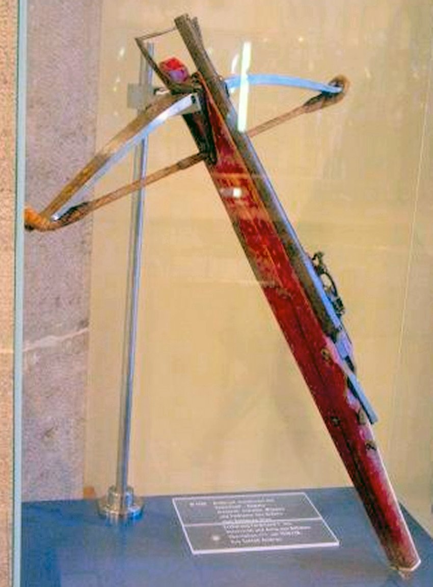

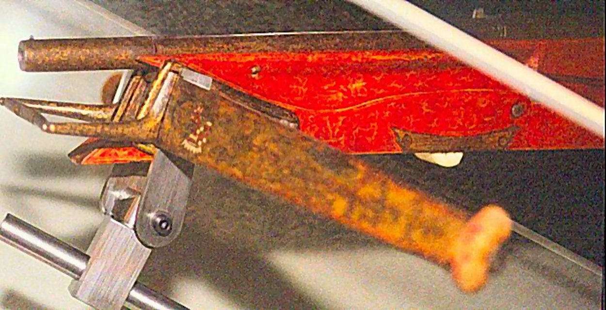

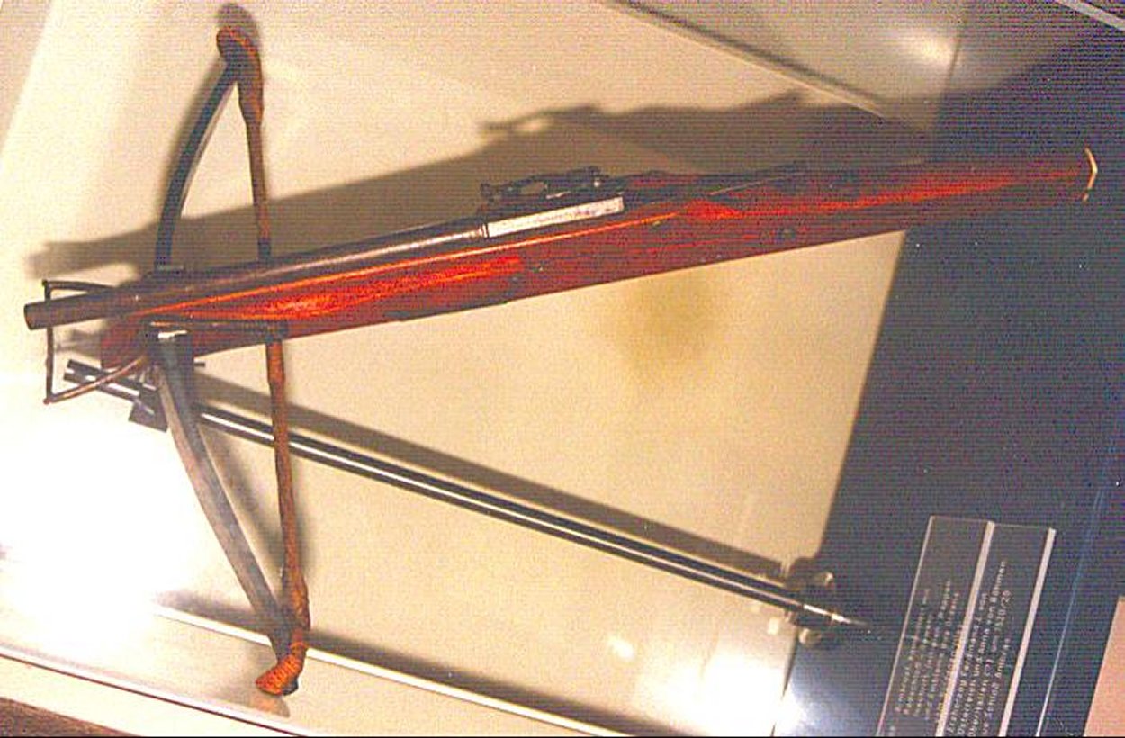

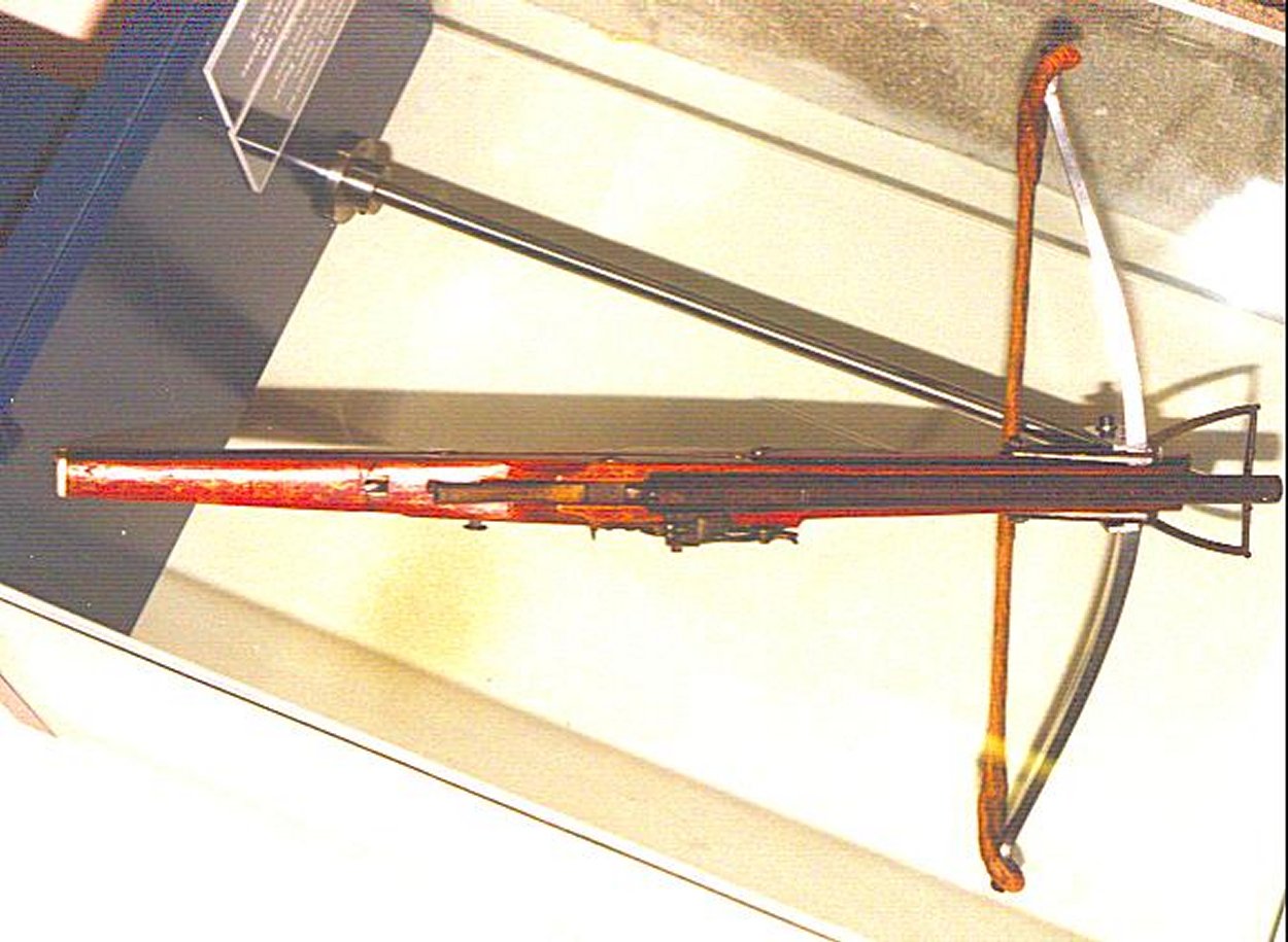

Default Munich BNM Wheellock/Crossbow Combination

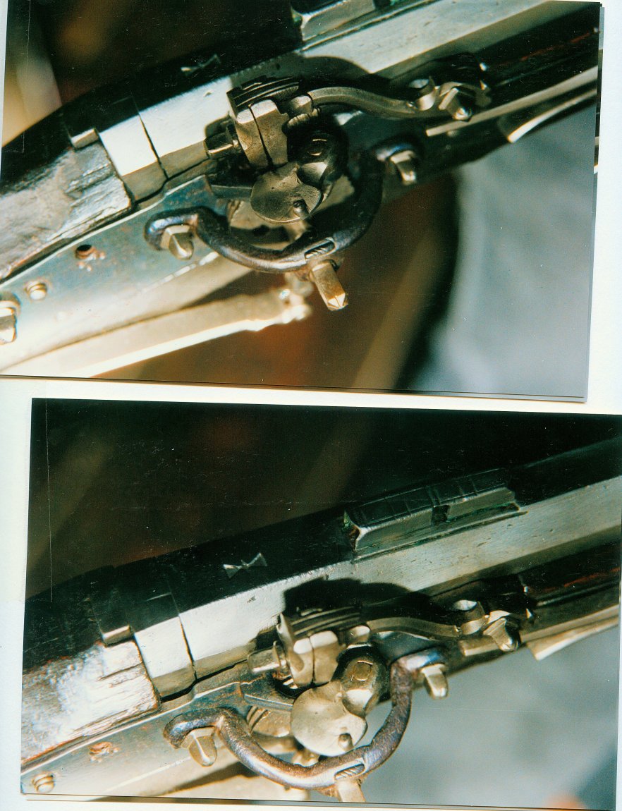

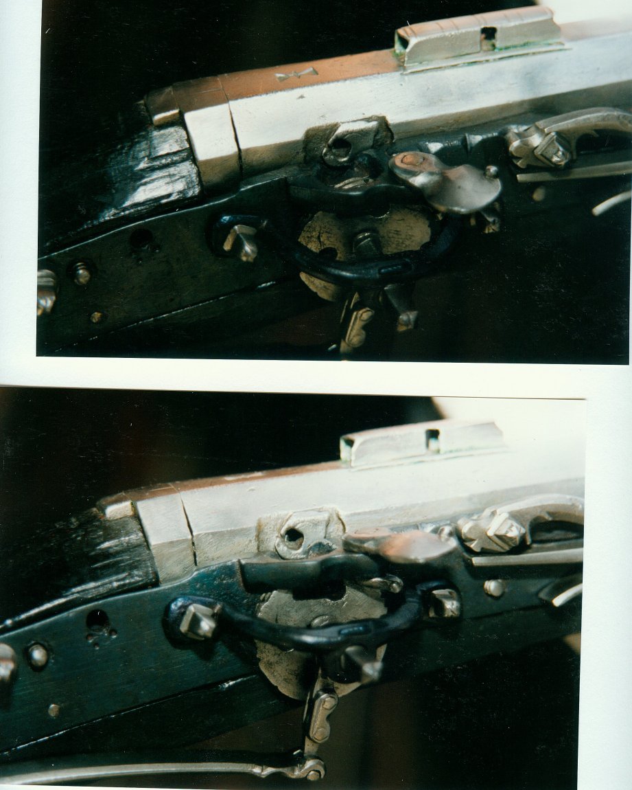

Hi Raf,
I was beginning to like our discussions a lot - would you still care to respond?

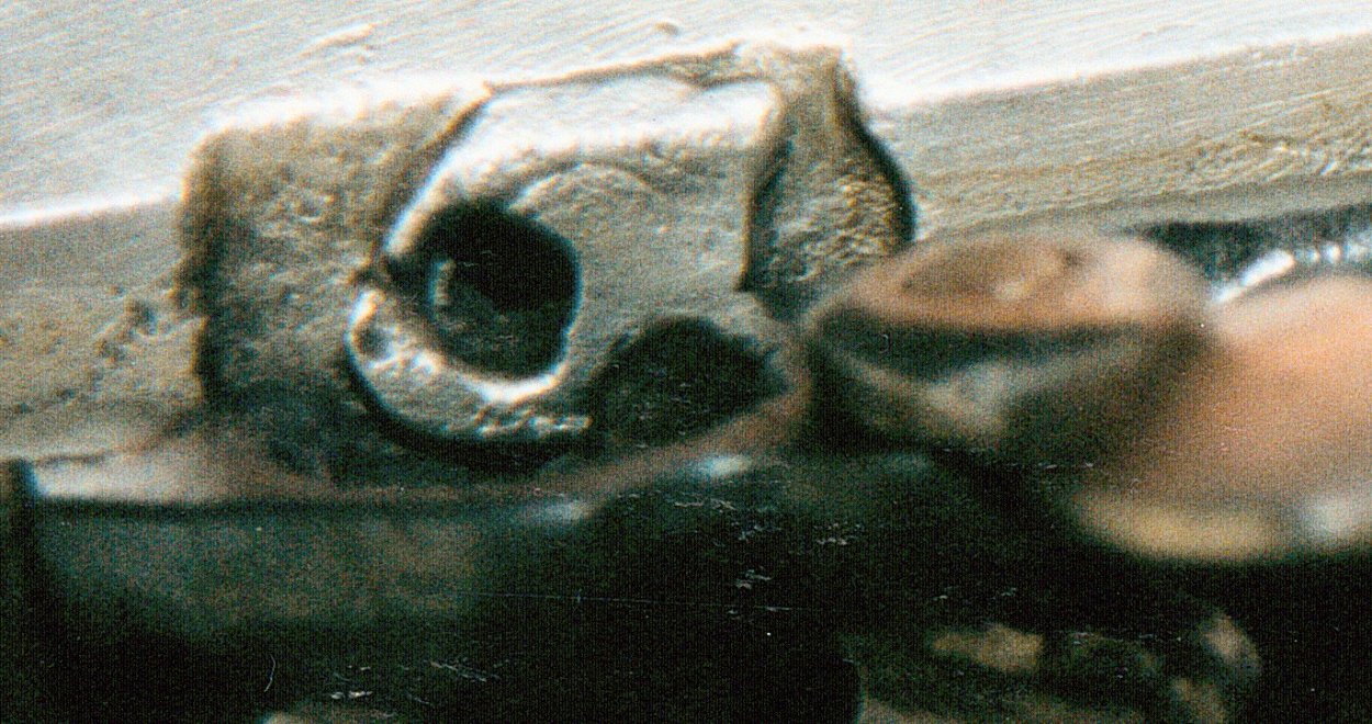

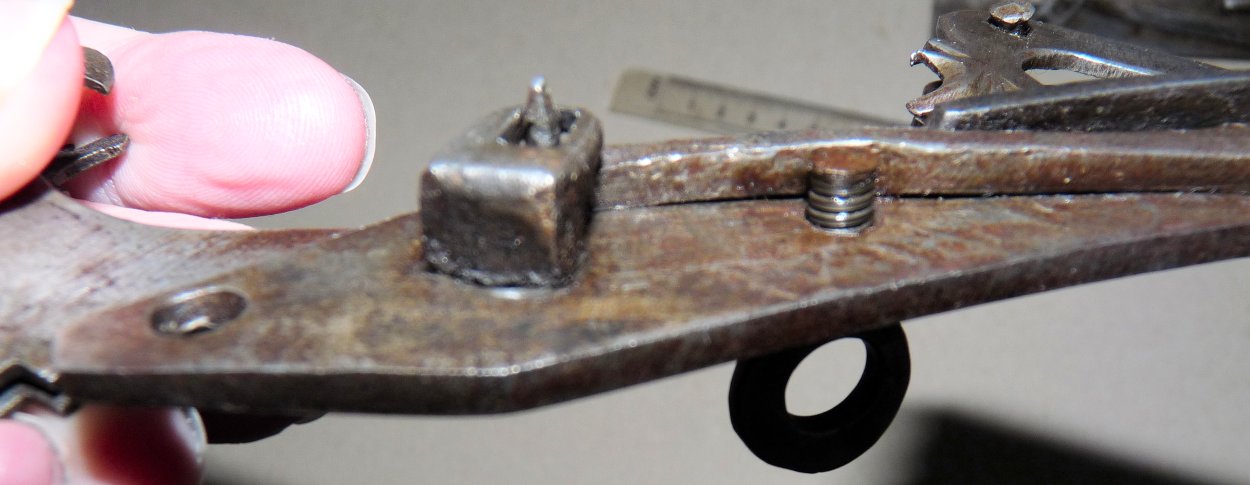

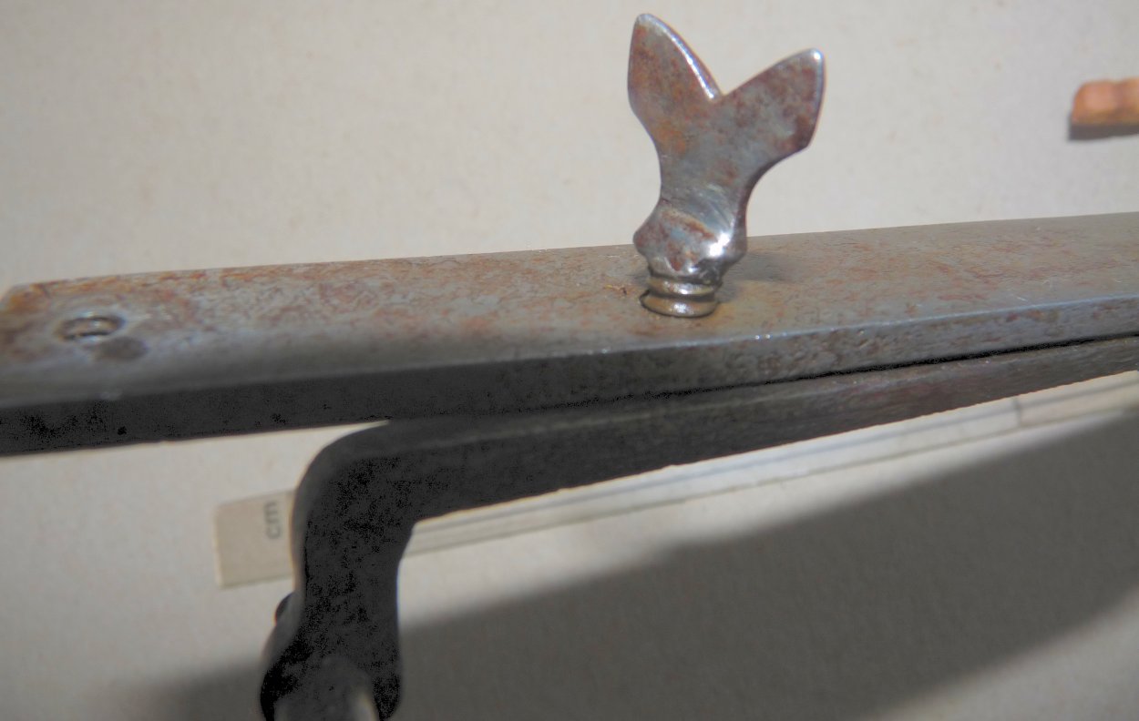

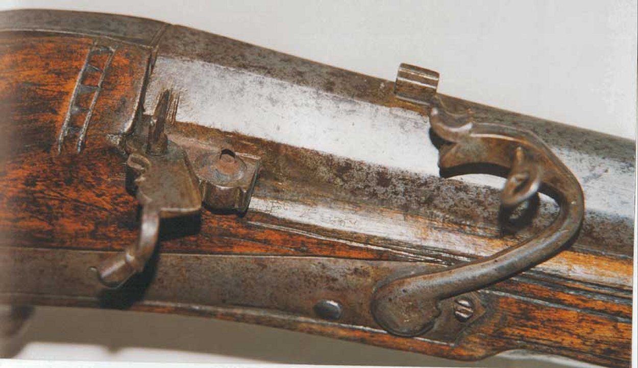

Do you know what the tiny wing nut to the left of the wheel of the BNM (Bavarian National Museum) was meant for? And the vertical push button? I do ...
Michael
Old 10th December 2013, 10:11 PM   #18
Raf
Raf's Avatar
Join Date: Nov 2013
Posts: 252
Hullo Michael. No I dont know and since this is not a conventional set up it would have to be a guess. I assumed the button was the trigger release for the secondary link . In view of the early date assume sear pushed into wheel slot by spring and disengaged by front end of the secondary link pushing down on the tail of the sear arm when button is pressed. In which case the wing nut is threaded into the lockplate and when fully screwed in pushes the tail of the primary sear out meaning the sear is locked into wheel so it cant fire. But ; has the secondary effect of making sure the sear always fully enters the wheel slot. So its a sort of compromise between the single piece locking bar and the later locking bar with prop. If this is right then it implies that at this early date the deficiencies of the single locking bar were known but the problem had yet to be fully resolved . Did I pass ?

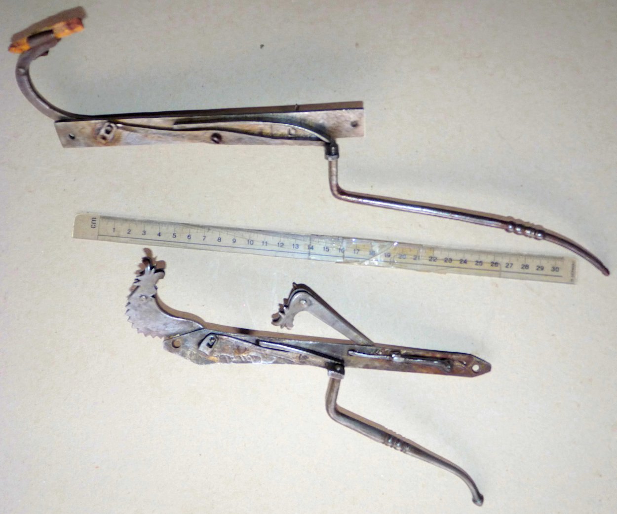

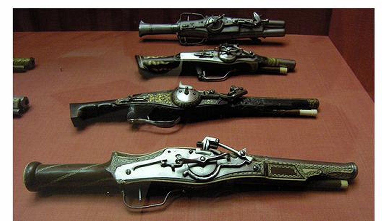

Don't mean to interupt your personal discussion but am i right to assume that the developement of butstocks was gradually? From the dagger grip of the early 1510-30 the fishtale butstock of 1530ish to 1560ish and the pommel variation like those on the trabanter leibgart (like those of Augustus I, earliest know of those is 1586, last year of Augustus his reign)
I also found a few pictures like this (presumably) Dutch wheel lock with Spanish barrel.
The detached lock as discribed by Michael
A pistol with first signs of a rounded nob/pommel (?), gilded and decorated with plaques of ivory
I will look up the books etc later

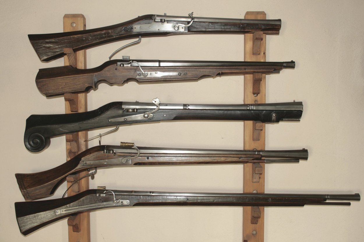

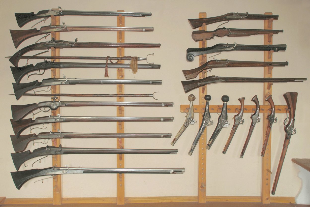

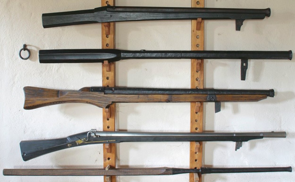

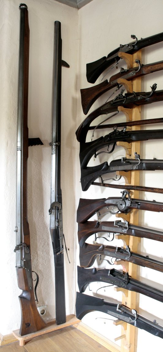

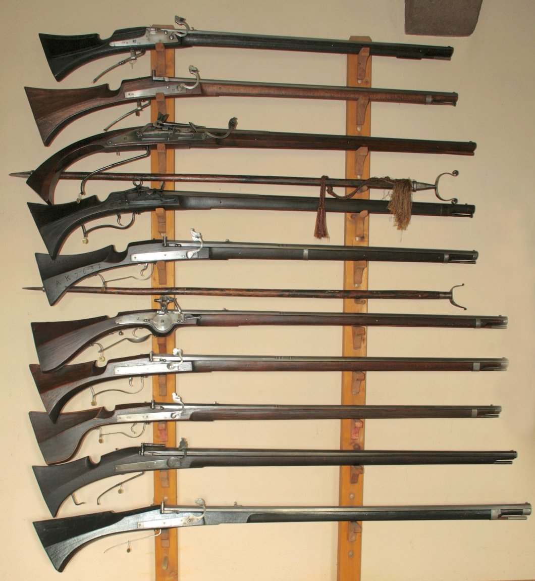

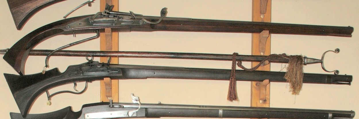

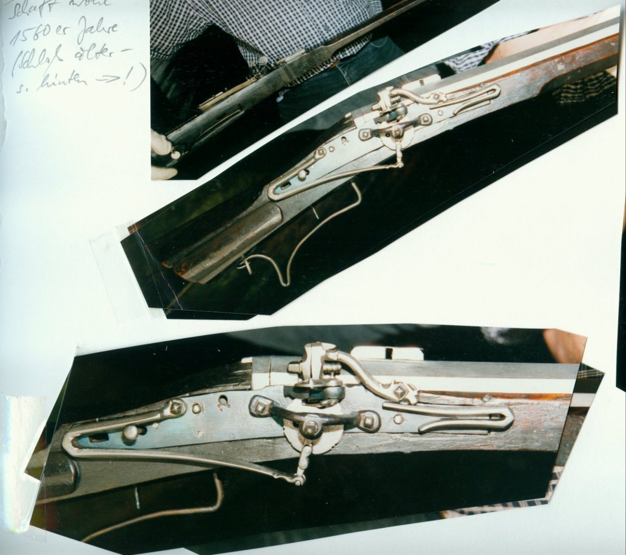

Enclosed please find photos from early wheellocks in the Landeszeughaus Graz, Styria, all employing the lateral push button.
Please note that the first, all aspects considered, is ca. 1540, while the lock and barrel (dated 1537, not 1527 as erroneously read by the Graz curators!) are Nuremberg, the stock was renewed in about 1580, and both the lock and barrel have undergone considerable later alterations ...!

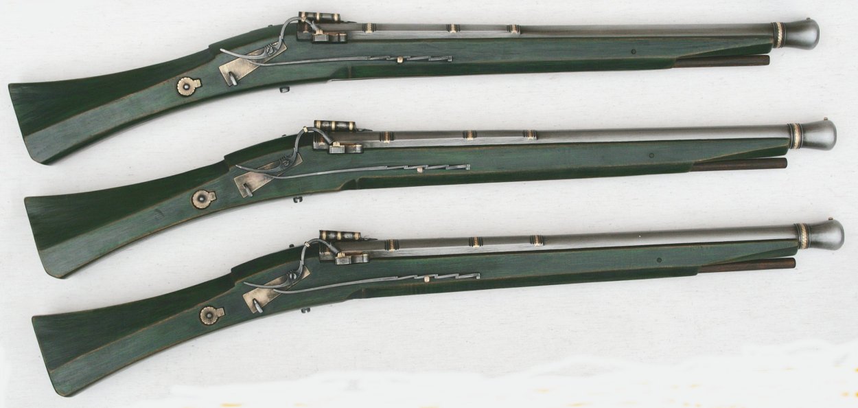

For comparison, I attached images of a fine Nuremberg Landsknecht matchlock arquebus, the barrel featuring the same crossed arrows mark and dated 1539; the counterpart to m gun is preserved in the Germanisches Nationalmuseum Nürnberg, but in much worse condition than mine!
The last in row is dated 1568 on the Nuremberg barrel that was almost certainly made by Hans Mörl, whose hourglass mark we know from matchlock mechanisms.
Michael

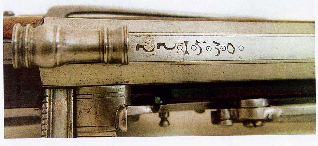

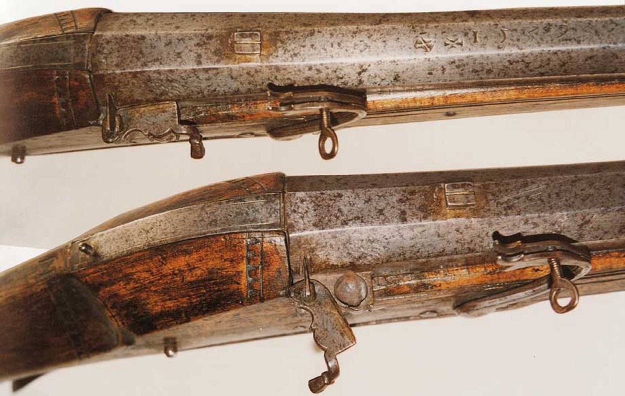

Attachments of my fine Nuremberg Landsknecht matchlock arquebus, the barrel double-struck by the Master of the Crossed Arrows.
The exact counterpart, with identical marks and date, only much worse in condition and acid-cleaned, is preserved in the Germanisches Nationalmuseum Nürnberg.
I have record of a great number of fine cranequins, most of them dated, and a few arquebuses in the museums at Ingolstadt (Bavarian Army Museum) and Nuremberg, by this prolific and good Nuremberg workshop that was active from ca. the 1520's to ca. 1550; both cranequins and matchlock arquebus barrels are known that are struck with dates ranging from 1532 to 1545.
m

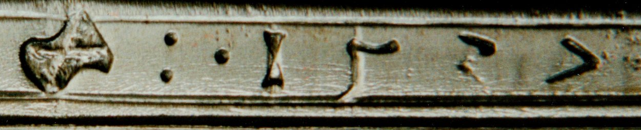

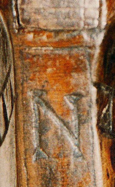

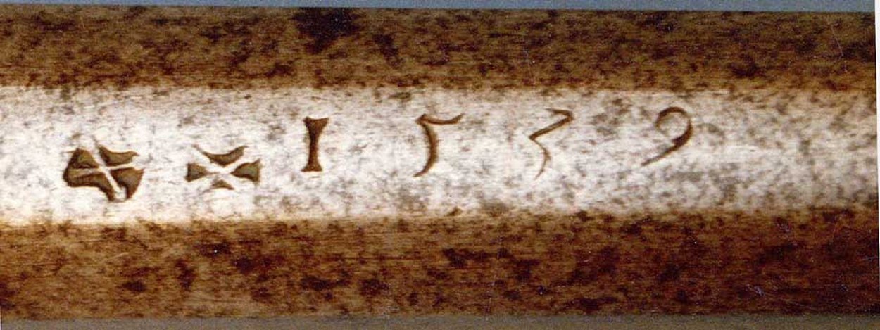

And a close-up of the marks and the date 1539 - cf. the way the cyphers on the Nuremberg barrel '1537' (now in Graz) are struck!
m

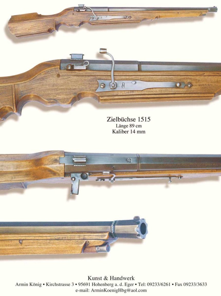

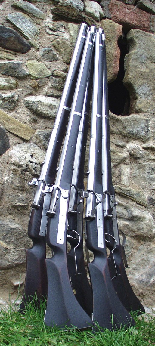

I am afraid we have been stating some things completely wrong here as lateral push buttons on early wheellocks are concerned.

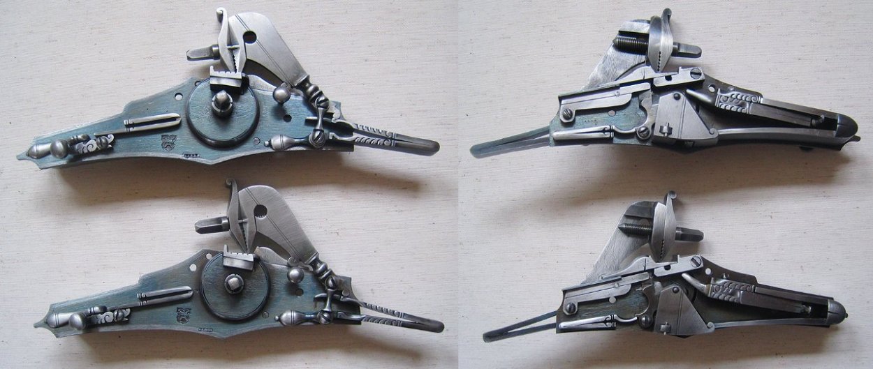

I have had a long talk with a friend of mine. His name is Armin König, and be builds the best firing gun replicas by far, the best I ever saw!!! He builds them so exactly after the best originals in big museums and from my own collection that they are exactly identical to the originals - down to the last milllimeter and to one or two grams in weight!!! We have often examined guns together, be it in famous museums or at the viewings of big auction sales houses; it usually takes him four to five hours to completely dismantle a gun, draw a plan and take all the single measurements and weights of each tiny part!!! Nobody is allowed to get near him during that time of utmost concentration. He builds everything with his own hands, not with the help of an engine-lathe. He is as devoted to his work as I am to mine - mine basically is the forum. He is a walking phenomenon and what he builds is pure perfection. Our minds think alike. And he, just like me, loves cats.
He categorically does not do any restorations to antique objects. When some tiny part is missing from a pistol in a museum or in some private collection he calls it a pity but would never touch and replace any part of an original piece. The reason being that he builds everything strictly after an original piece; never would he change the slightest detail or/and build what he and I both call 'fantasy pieces'. As nobody can tell for sure how exactly a missing piece looked he leaves damaged weapons alone. When a ramrod on a piece he has set his mind on rebuilding seems to be a replacement or is missing, he will build the piece with a ramrod that anybody would call 'replaced'.
As some people have presented the 'works' of their favorite gun constructors here, please let me show a few things of the best of them all.
Please allow me to link him here, he is an absolute idealist and a great person:
http://www.engerisser.de/Bewaffnung/.../Firearms.html
http://www.engerisser.de/Bewaffnung/...ockmusket.html
http://www.engerisser.de/Bewaffnung/...s/Caliver.html
http://www.engerisser.de/Bewaffnung/...ockpistol.html
http://www.engerisser.de/Bewaffnung/...ockpuffer.html
http://www.engerisser.de/Bewaffnung/...lehackbut.html
http://www.engerisser.de/Bewaffnung/...Bandolier.html
http://www.engerisser.de/Bewaffnung/...Wheellock.html
Well, Armin read our discussion on the forum. At first he was d'accord, but a few hours later he got back with me and told me the truth. I used to teach him many of the things he knows today and I still am his sole 'authority' as to dating objects. But I am proud as a peacock and thankful that he taught me in this aspect. What more can a dedicated teacher expect than his best-ever student surpassing him?!
Now here are the mere facts, and I stated them as short and precise as I could:
Most of the earliest Germanic wheellock mechanisms had only a sear spring that acted so that it prevented the nose of the sear from resting in the notch of the wheel. 'Earliest' meaning from the beginning, which certainly must have happened during the second half of the 15th century, until at least the mid-16th c., in many cases well after 1600, though.

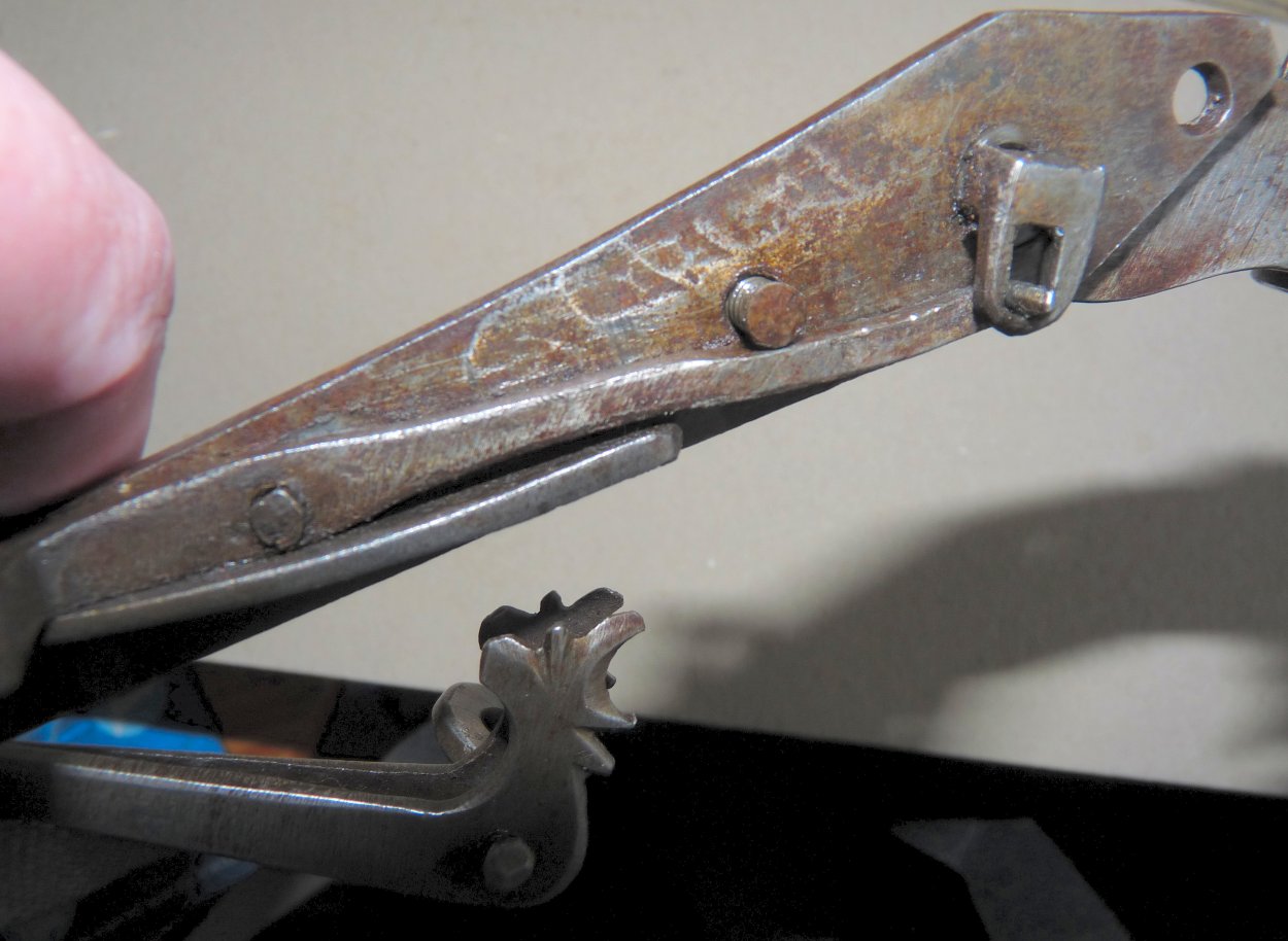

In order to force that nose to safely rest in the notch of the wheel when the wheel chain was spanned, all locks of such an early Germanic type of construction - this neutral formulation helps avoiding regional or dating problems - needed a lateral push button outside the lock plate that had to be pressed. When you press that button you can feel the force of the sear spring counteracting. Only when that push button 'clicks' into its assigned position the nose of the sear has safe contact with the depth of the wheel notch.
So that's all there really is to that push button discussion. May I advise you to closely study Robert Brooker, Landeszeughaus Graz, Austria: Radschloss-Sammlung/Wheellock Collection, Hong Kong 2007, ISBN 978-0-9795532-0-2.
On p. 77, four views of the North-Italian type of lock (Robert thinks that the lock is ca. 1520, but actually it should be correctly dated 'ca. 1540') of RG 3 are represented; in the bottom view you will see the tiny sear spring, cf. also the second view on the following page.
Let's go to p. 80, RG 4: the barrel dated 1558 and the lock contemporary. In view 4 of the Germanic-type lock, you can see the same spring principle, this time combined with a lateral push button to force the nose of the sear into the notch of the wheel.
As the 16th c. proceeded, Styria contiuned holding on to the archaic type of push button as it promised maximum safety. On p. 92ff, there are images of a heavy wall gun, FRG 285: the barrel and lock are Styria, ca. 1560, the stock was renewed in ca. 1700! Views 3 and 4 on p. 93 clearly demonstrate that the push button on this lock now has its own spring on which it acts.
Robert's book is basically very good work and worth buying; you literally get thousands of images although the Chinese printing greatly quality varies from page to page. When Robert attended me and my collection a few years ago, I explained to him my criticism as to dating many guns and pieces of accouterment, and he accepted it.
I wish to tell the following in no uncertain terms: even for museum standard people (!), the competency of the present Graz staff is horribly low!

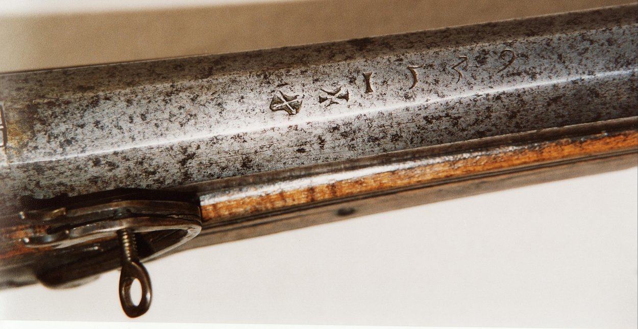

E.g., they misread the date struck on the Nuremberg barrel of the arquebus RG 2 as '1527' though it really is 1537. They did not even know the mere facts that the barrel was of Nuremberg make and that complete arquebuses existed with barrels bearing the same characteristic type of arrow marks and dated of 1537 and 1539; they are preserved in the Bavarian Army Museum Ingolstadt, the Germanisches Nationalmuseum Nürnberg, and in my collection. Please see post 23f. in this thread above.
Misled by that wrong type and the archaic impact of the North Italian type of lock, Robert misdated the lock and barrel as '1527'; what he correctly remarked though is that the gun was restocked at the end of the 16th c.

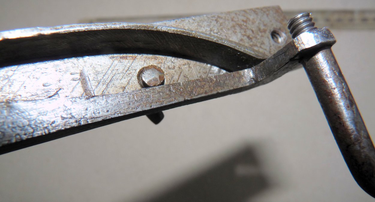

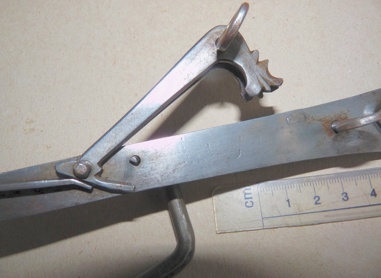

Now finally here are some impressions of earliest firearms that my friend Armin König rebuilt - enjoy!
Michael
Old 12th December 2013, 07:02 PM   #27
Matchlock
Matchlock's Avatar
Join Date: Sep 2008

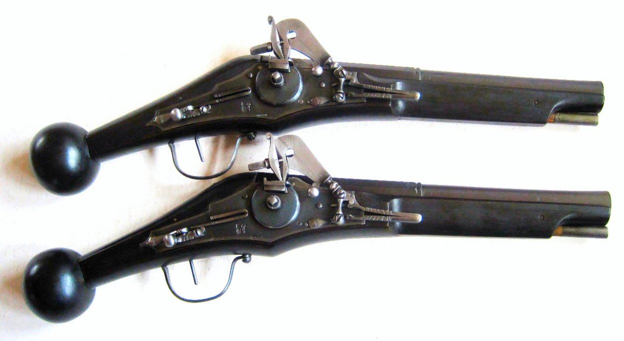

Posts: 4,310
More for your enjoyment!
m
