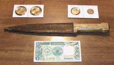

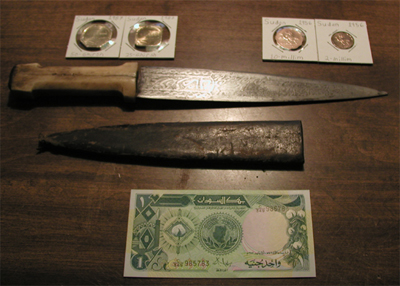

Here is one of my recent finds at a militaria show at Harrisburg, Pennsylvania.
I believe it to be a late 19th Century Sudanese dagger. I don't think it is an 'arm dagger', it does not have a arm strap or any evidence of ever having one.
Since this does not appear to be an arm dagger, how would this be worn since it does not have a 'belt loop' either ?
"Damn you Fuzzy Wuzzy with a bone stuck through your hair, you're a bloody heathen but you broke a British square"
- Kipling
Any comments / information would be most welcomed and appreciated !
Thank you and enjoy the posted pix !
Mark....

Three things pop immediately to mind, one being that many in the Sudan don't wear "belts" as such , but rather a wound sash......of what use is a "belt loop" to a person wearing a sash?
Likewise, many are just tucked into the top of boots, with the third instance being a seperate "frog" such as the turn of the century Philippine knife that I just aquired from Vern, where the "loop" is a seperate piece of leather through which the scabbard/sheath proper slides in order to be carried on a western style belt.

Hi Aurangzeb,
Outstanding find! What you have there certainly does appear to be a dagger from the 'Mahdiyya' (1881-1898) in the Sudan. I should point out though that I don't think in this particular instance the Mahdi was ever termed 'mad'
I think the term considered was possibly from that used to describe the 'Mad Mullah of Somaliland' Sheikh Sayyid Muhammed c.1903, in events very similar to the the Mahdist revolt and British entanglement in Egyptian affairs. At this time of high Imperial attitudes though,the term may have been applied in singular instance, as it was often used to describe the religiously based and intense opposition of any individual to British rule.
The British writers of the period tended to interpolate many narratives of colonial events with slang and terminology often derisively toward the 'savages' . For example the term 'dervishes' was typically used to describe the native warriors, and was actually a term which came from more common use in India (Pers. darvish=religious mendicant), used colloquially by the British military from the Raj there. It should be noted that the Turkish derivation of the word, and certainly found in Egypt, meant loosely beggar. Although the term dervish was once applied to themselves, the Mahdi opposed its use and applied the term 'ansar' (from the Koran =helper). He actually installed strict punishment for those who insisted on the use of the formerly applied 'dervish'. The term 'fuzzy-wuzzy' was directed to the much feared Hadendowa tribal swordsmen.
While these slang terms were used often colloquially and in some perspective, derisively for the many groups of Mahdist forces, the poems by Kipling reflect the general consensus of British forces,that native warriors were actually not only feared but highly respected for thier courage in battle.
This dagger is very similar to an example associated with weapons from Dongola province in northern Sudan, near the 3rd cataract, and interestingly is the region that the Mahdi himself, Mohammed Ahmed ibn el-Sayyed Abdullah , was born. The simple elongated hilt form is similar to the broad hilt 'jambia' daggers of Mughal India (Pant. p.161, fig.464) and it is interesting to note that other Indian weapon forms also appeared in the Sudan in this period, and were accordingly decorated with 'thuluth' motif.
As has been noted , this is clearly not the typical arm dagger often worn by Hadendowa and other tribal warriors, so actually has little to do with 'fuzzy wuzzies but seems actually to belong to tribal groups farther north.
I very much like the way you have displayed the dagger with associated Sudanese coinage and currency, extremely impressive and really enhances the historic nuances of the piece. Actually this recalls the many times we have relied on nusimatic evidence in the identification of many ethnographic weapons. Nicely done!

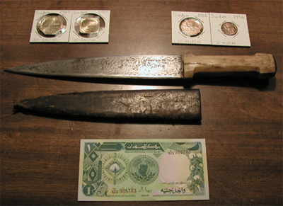

Thanks for all the help on my Sudanese dagger.I personally think the dagger might have even have been tuked in the sash of the warrior.The coins depicted with the dagger are only a small fraction of my Islamic/Sudanese coin collection.I do have several questions:First,are there any recommended books on sudanese weapons and the British-Sudanese war?Second,this question may seem dumb but,Why is Sudan sometimes called"The Sudan" instead of just"Sudan".Also the tip of the dagger protrudes from the sheath slightly,chould anything be done to fix the minor problem? Finally,what is the fighting style with this dagger type,is it like the fighting style with a kaskara?
Any further info whould be appreciated,thanks to all...hopefully i'm not beeing a pest.

Is my idea that my dagger might have been tucked in the sash logical or illogical?Also thanks Tim ,I immeadiatly went to Ebay And found one of the books you told me about.(and of course bought it )
P.S.-The Sudan has already sucked me in,and is slowly taking my money,but I find it fasinating!

IIs there any way to bring out or restore the worn Koranic inscriptions on the bade of my Sudanese Dagger?
Any help would be greatly appreciated.
Thanks.
Aurangzeb is offline   Reply With Quote
Old 25th March 2005, 11:31 PM   #14
Posts: 6,431
I think , in this case the best course of action would be to leave it alone . There is not much that you can do for etched resist lettering other than darkening the entire blade and then sanding or polishing the script which would wear it down even more .

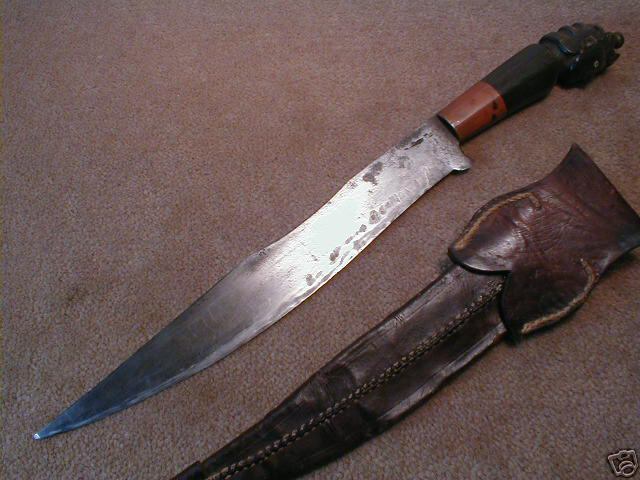

Old 26th March 2005, 01:52 AM   #16
Posts: 6,431
Well a dagger is for stabbing and a meat cleaver is for chopping so I'm not sure what weapon you are referring to .

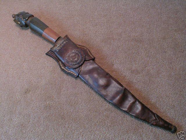

Talking chopper
Hi Rick!
The type of dagger i'm reffering too isfor chopping,I have heard that many daggers of this type were made after the soviet union broke up in 1990 or 91.
The sheath usually swallows up some of the handle and a few were on Ebay a while ago.Hopefully what I have attempted to describe will help.I have no clue what the type is called or spelled.

Old 26th March 2005, 02:11 AM   #18
Posts: 6,431
Ahh , a kindjal or a qama perhaps ?
