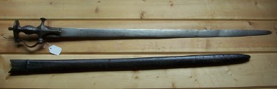

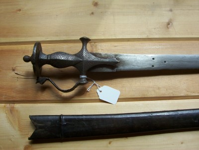

Default Photo for this thread
Here is one of mine to go with the subject. Quality blade circa 1850.
Cheers
bbjw
Old 5th May 2009, 11:42 PM   #4
Posts: 10,852
Yay BJ!!
Well there you have it, they definitely do exist!!
While still no defining term for one of these, the hilt appears to be Rajasthan style and about the date you assess.
In the immortal words of Desi Arnaz, "Ok , 'splain THIS Lucy!!!''
Thanks for posting this BJ,

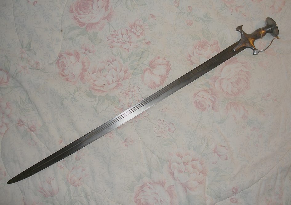

Posts: 6,421
Here's another, wootz, Bikaner marked .
Old 6th May 2009, 04:17 AM   #6
What are they called? Dhup? Sukhela? I am away from the books.....

Default Well thank you gentlemen
Well thank you gentlemen.
If only I had your library Jim, your years of research shine through again.
The Tulwar I handled was exactly the same styles as you all presented and single edged. Most interesting and thank you for sharing examples you have in your collection guys. Thank you BBJW and Rick...wooooooottttzzzz...hmmmmm....yyuuuummmmmmm.
Seeing the differences in quality certainly adds to my thoughts that these in some circles were a very respected sword and not just produced for the masses.
Best regards
Gav
