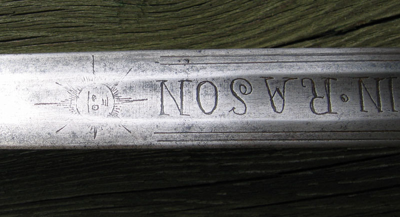

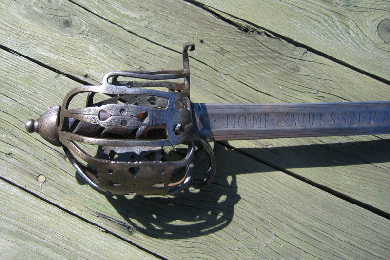

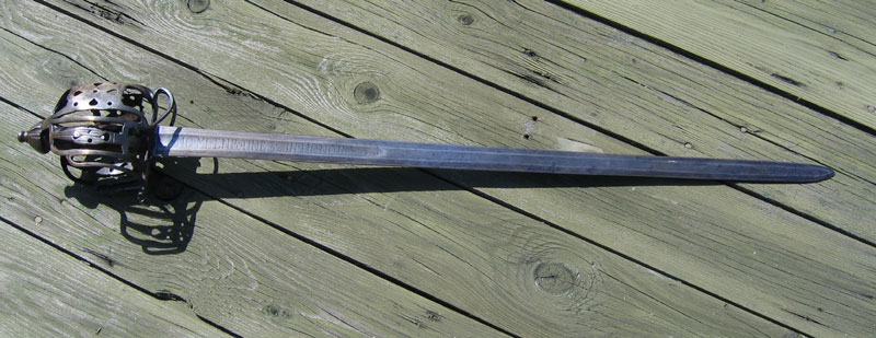

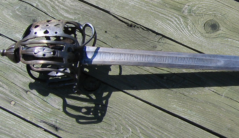

I had promised Jim and Tom that I would post photo's of this recent purchase on a previous thread. This appears to be a Stirling hilt on a German blade, I have my own theory's on it date but, I would very much like to hear what every one else thinks. I will post photo's of any details requested. All comments good and bad are very welcome.
Jeff

I dont see why you think this is German blade. This fine inscription was used mostly in spanish blades (but not only).
NO ME SAQUES SIN RASON / NO ME ENBAINES SIN HONOR [Do not draw me without reason/Do not sheath me without honor]). What wise and heroic words! I think it is the best of the mottos we find in swords.
It looks very old to me! But I will wait our friends who know better for the age estimation. Good catch Jeff!

Beautiful piece, indeed! I've always wanted one, but still can't afford it! It is the classic Spanish broadsword with the 6-sided blade and typical marking. These blades were imported and seen on many weapons for the period, just as many German blades marked "Solingen" were seen on basket-hilts. I've also seen Spanish broadsword blades on colonial American and some early English swords.

Hi Jeff,
This really is a beauty!!! and it is probably mid 18th century, a good example of the Highland baskethilt. While I'm away from my resources at the moment I wanted to comment although I know we've discussed this on another thread.
It seems that German blades prevailed on most Scottish baskethilts, and it sometime early in the 17th century the very marketing savvy German blademakers began to use established Spanish marks and names on thier products. Spanish blades had gained favorable reputation for thier quality and the German smiths simply insured marketability with these markings.
The inscription on this blade is indeed referred to as 'the Spanish motto' (Aylward, 1945) although I believe it is actually in Latin, linguists please correct me if that is not the case. Some years ago in research on Spanish colonial weapons I discovered that this motto or phrase appears to have developed sometime in the early 18th century, presumably on Spanish blades. The same wording occurred later on some French swords in French of course and if I am not mistaken, it occurs only on several Italian blades, but it is without doubt a Spanish affectation.
The hilt is of 18th century form as well, and the pommel suggests mid 18th century. The beveled blade cross section and the 'motto' suggest the blade is 18th century Solingen product, with similar combinations occurring on the familiar latter 18th century Spanish dragoon or military broadsword blades.
It would be interesting to discuss this 'motto' more and find out how many trade blades might have carried it. Could anyone out there present other examples found hilted in other hilt forms, cultural spheres? It seems these trade blades often went other directions i.e. India, Africa....anyone seen a firangi or kaskara with this motto?

Hi Yannis,
You are correct this could be a Spanish blade as the Scots are known to revere them. The German makers were well aware of this and often "borrowed" the Spanish marks. In addition to the German and Spanish blades, French blades can be found on Scottish baskethilts. I think this is a German blade by its style as well as a detail which I have left out of the photo's. I will post it later as well as why I left it out once everyone has been able to comment.
Hi Mark,
Thank you for your comments. I think the main reason these tend to be expensive is not the usual market forces, but, the superior haggling skills of the Scots . I went 30% over my absolute maximum on this one. My 1/4 Scotch ancestry was no match for a thoroughbred.
Hi Jim,
I think you are right on with your dating of both the hilt and the blade. As I explained to Yannis I left out a detail which I think confirms this. It should also help confirm a theory I have. I will also start looking to see the sphere of these blades with this motto.
Thanks for all the comments so far.
Jeff

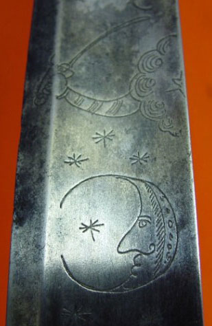

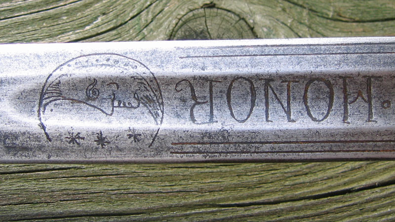

Ok, does this change things?
Jeff
Old 31st May 2005, 12:47 AM   #7
Rivkin
Posts: 655
I'm probably the most ignorant of all of you, but it looks like Solingen's sun and moon motiff to me.
Rivkin is offline   Reply With Quote

Hi Rivkin,
I totally agree that it is the star and moon motif typical of Solingen. I have always thought that they were used between 1780-1830.

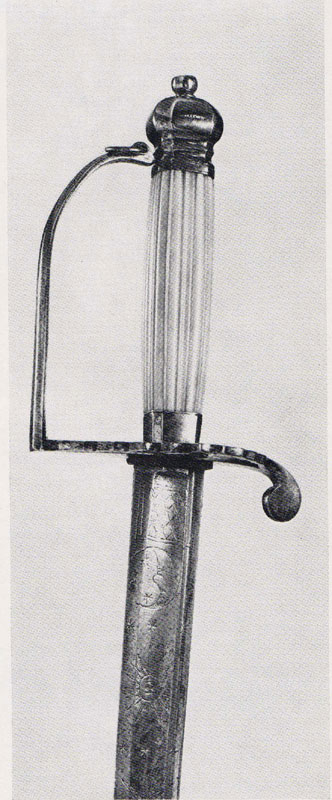

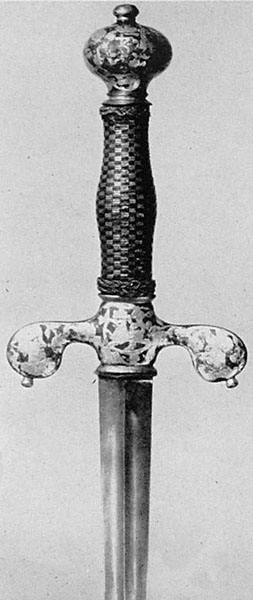

However what do you think of this? The description is; "Small-sword, French, c. 1750 (top), from the collection of the Duke of Northumberland; and closed-hilt broadsword, English, c. 1590 (bottom)."
Similar blade similar star and moon?
Jeff

Originally Posted by Jeff D
Hi Rivkin,
Jeff
I'm not troubled by this - if french blade is made by Manufacture d'Armes Blanches d' Alsace (Klingenthal), then it's easy to explain - all ranking masters who worked at Klingenthal were initially from Solingen.
As far as I remember english attempt to revive the native sword productio also included inviting a few solingen families.
Old 31st May 2005, 10:06 PM   #11
Posts: 10,862
The moon and sun figures are characteristic cabalistic markings used on Solingen blades from the first half of 18th century onward and may have even been used in variation earlier. The very large block letters are also found in a number of Solingen applications imitating Spanish markings, including 'Toledo' and 'Sahagun' for some of the most common.
The Solingen blade cutlers during the 17th century did expand into not only England (Shotley Bridge and Hounslow) but by the 18th century into many other European cities to set up small businesses. Another key location was Vira, near Stockholm, in the 17th century.
Enrique, thank you for confirming the motto is indeed in Spanish, as it should be One must admit, it is a grand and perfectly worded motto.

Thanks engar.
Hi Rivkin, it is not the English atribute that bothers me it is the date. The blade is undoubtedly German and the hilt is English. 1590 seems way to early. But who am I to contradict Oakeshott!
Hi Jim, As we have discussed this before, these moon, sun etc. motifs seem to occur in a fairly narrow time period starting in the later 18th century. I am still looking for a datable sword with this motif that is earlier than 1750. I suspect Oakeshott dated this by attributing the markings to Peter Munich. I don't know if he is correct. This is also why I left out the symbols on my original posting as my sword is quite datable by the other features as you expertly displayed. Thanks!
Does anyone have photo's of a pre 1750 sword with these symbols, or any photo's of known Peter Munich swords?
Thanks All.
Jeff

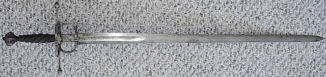

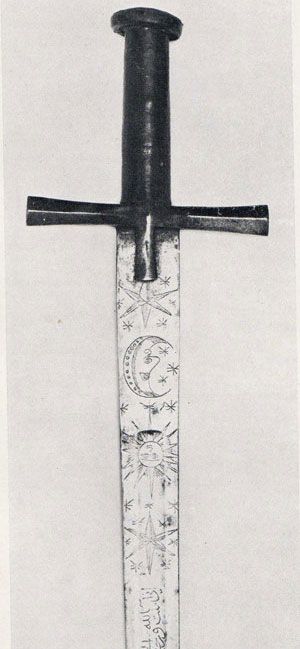

Unfortunatelly it probably won't help you much, but there is one of Munich's swords from C. Blair, European and American Arms, no. 145 with description:
"Pillow-Sword" of Federick III of Denmark and Norway (1648-1670) (...). Blade signed "Peter Munich me fecit Solinge". Danish, c. 1650, Rosenborg, Copenhagen.
wolviex is offline   Reply With Quote

Thanks Mark and Wolviex,
I think the continued use of the sun moon symbols is what we all have been accepting. But unlike Andrea Ferrera, I can't find examples that are definitely pre 1750. For instance we know of Ferrera, running wolf, orb and cross, as well as Sun moon signs are popular on Scottish swords. Yet a datable collection such as the blades from the battle of Culloden has examples of all except the sun and moon. I am sure there are some examples of the pre 1750 sun and moons out there but I am convinced the vast majority date to the later 18th century with a few mistakenly attributed to Peter Munich. I would love to see a photo of your Dutch hanger!
All the Best
Jeff

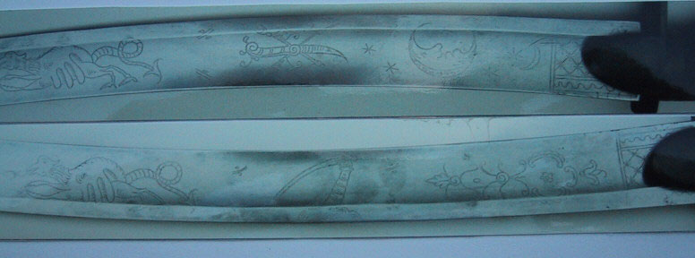

Hi Jim,
Thank you for sharing your excellent research. Since we originally discussed this I have constantly been looking for these stars and moons. They are very prominent on later 18th century English military weapons with German blades. 1788's (top) and 1796's (second from top). I have pasted a few of the examples I have found. I suspect Castle's observations are regarding civilian weapons.
If I find any pre 1750's with the etched symbols this will be the first place I will paste them.
Thanks again Jim!
Jeff

Hi Jeff,
Outstanding examples!!! Thanks very much for posting them!
We'll keep looking OK? There must be examples out there of blades that may be early 18th century with such markings (still curious on Wagners illustrations of Munich examples with his very early period of activity).
Also have yet to see actual examples of the Spanish blades mentioned.
All the best,

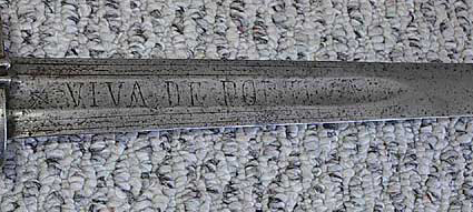

Hi Jeff D.
i like your piece!
intriguing inscription ... looks like its missing a part, though !
i'll explain: when you have this type of wording, you either wish to express " viva portugal" or "viva el rei x de portugal". the term "de" means "of", it only fits in the second statement. you are either long living the country or the king of the country. isn't there another wording on the other side, to adjust the phrase, even with an od composition? or is this sword a short piece, like a left hander, only with space for condensing the actual statement, figuring in full in the larger matching sword ? funny idea !
its really intriguing, at least for my humble knowledge, although i was already familiar with this type of inscriptions but i'll keep thinking about it ... while you please answer my above little questions, hoping i made myself clear.
kind regards
