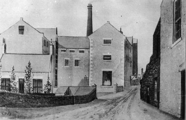

Default recent photo

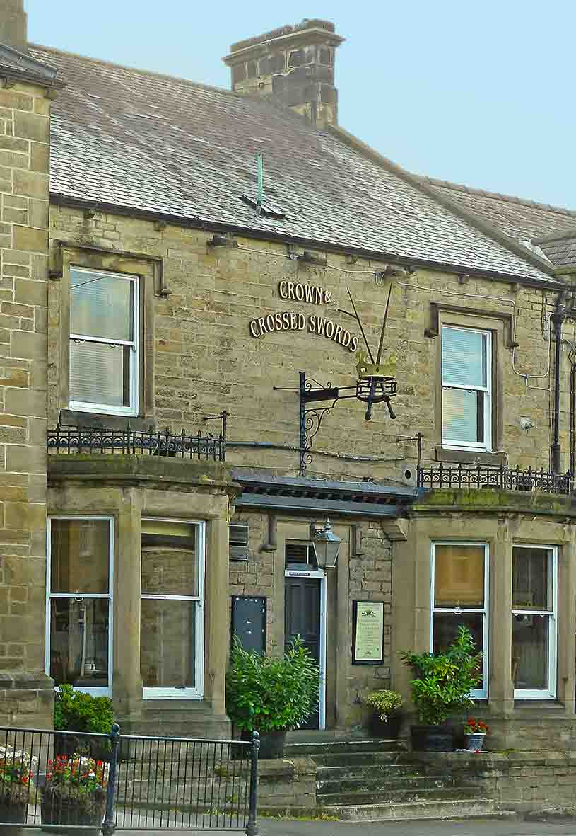

I took this last week when I was out at Shotley Bridge.[IMG]

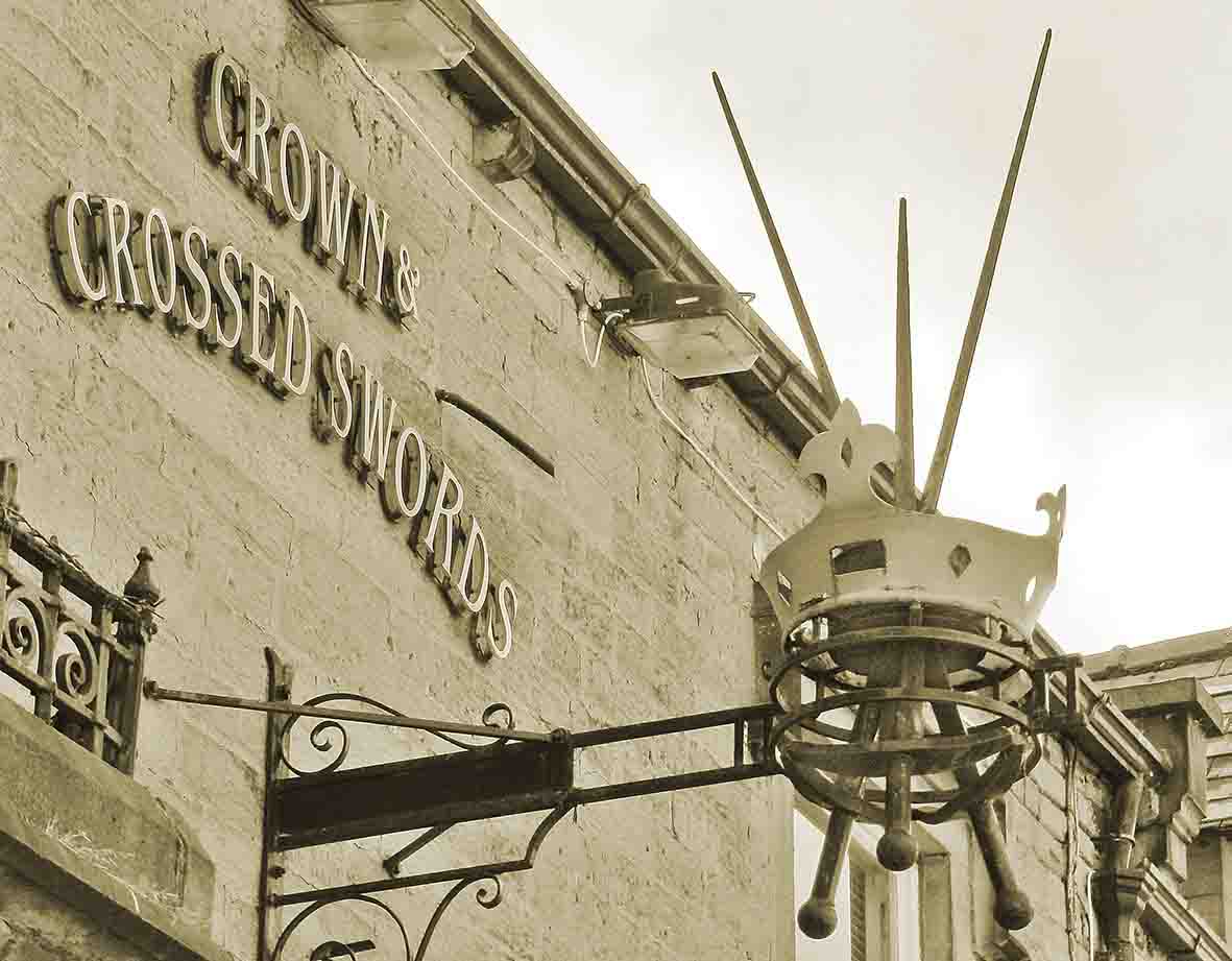

Thank you for the excellent additions to library ... I am on page 50 of your first copy and how interesting it is... There are many interesting features which I need to compile ..
As a matter of interest the sign on the Crown and Crossed Swords is a relatively new one ... Apparently the old one was removed in about 1965 and this new one was the replacement and quite different to the original. The previous sign being more the crossed sword form, flatter and of the basket type...

Hello Ibrahiim. Yes, that is how I always think of the sign, so I must be recollecting old images of the village; can't say I'm much impressed with the replacement. I was in the adjoining bar, which is dreary and forlorn, (a typical old English village pub) and the barmaid mentioned guests, but I have to confess the hotel did not look like it was doing business; the main front door hasn't been opened in some considerable time, and the insides of the big windows were dirty. There's plenty of money thereabouts, so it could do well as a typical rural gastro-pub with the right chef and manager, but that's not the way it is at present. Sad.
However, I am certain Mr. Richardson and Mr. Bygate would be happy to know their work lives on in the right circles. Actually, I must check to find out if Bygate is still alive - he may not be dead, as it was only 17 years ago when that book was published and he was not that old then.[IMG]

I think that was the adjoining place and is mentioned in a document I saw about architecture in the village as being quite different in construction to the original Crown and Crossed Swords which was to the right. That could make that The Commercial Public House ...Possibly now absorbed... I think the Menu Sign to the right of the door has the original style of Crown and Crossed Swords on it?

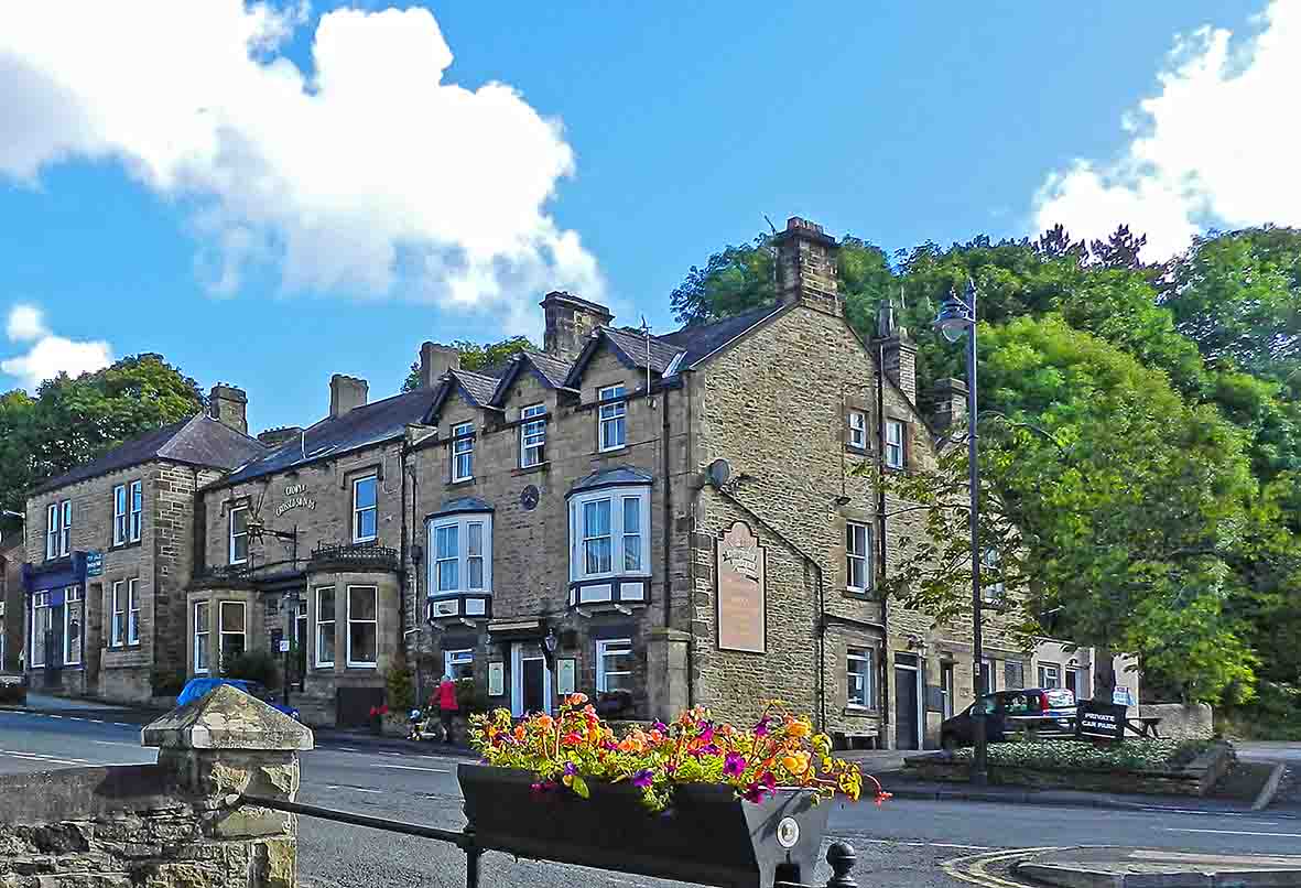

here's the other half, and the original half, of the pub.[IMG]

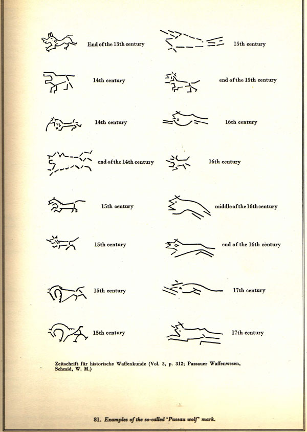

To the WOLF/FOX:
In the considerable research I have done on these markings, which concur with Ibrahiim's notes here, I have found that the conundrum of these curious images cannot be conclusively asserted. What does seem clear is that the 'running wolf' (called the Passau wolf for its believed origin) was used in Solingen by the 16th century. These often incredibly stylized (sometimes indiscernible) 'animals' were placed on a single side of the blade and typically chop type marks filled with brass or copper.
These were not standard by any means, as they were placed by workers of varying degree of skill (certainly not artistic) and often resemble the prehistoric cave type figures almost. Thus they could never be assigned to a particular maker, nor even period or any sort of chronology (as Wagner's chart implies). They were simply and arbitrarily placed on a blade as a kind of imbuement of quality.
As the Hounslow operations ensued in the early years of the 17th century, the Solingen makers who went to England undoubtedly used these simple marks, and in the almost stick figure manner a tradition in Germany . Meanwhile many blades there were imported from Germany and fitted to the developing hilts of Hounslow form.
The reputation of the Hounslow blades was well known, and while the operations ceased by 1650s it seems, the blades continued to have long working lives as heirlooms and rehiltings, even well into the 18th c.
With the advent of the Hollow Blade Co and Shotley Bridge in 1685, it seems some of the Hounslow families were involved. Though there is a great degree of doubt on the production of 'hollow blades', there were a number of military type blades and hunting sword or hangers it seems. Some of these indeed have the German wolf (no doubt brought forth by the German members) of the stick type image with Shotley Bridg inscribed.
As noted, no Shotley Bridge blade as far as known ever used the 'fox'.
The Shotley Bridge entity is said to have continued after the collapse of the very dark Hollow Sword Co. but no swords marked with the wolf or Shotley Bridge markings are known beyond the first years of the 18th c.
The wolf as a blade marking had been long gone from Passau, but at this point it seems to be gone from Solingen as well.
By the 1750s, Birmingham was determined to redeem its value as a blade and sword producer, and the maker Samuel Harvey began to use the canine figure once again, certainly recalling the now fabled 'running wolf' character but now with a British twist ....it was a quite discernible running fox with its distinctive plumed tail. He placed his initials SH within.
It was noted however that on occasion, the fox did not have initials (though some had only an H). It now seems that at least one other Birmingham may have used the fox, but no initials.
In a short time, it seems these 'foxes' ceased, and only Harvey's name appeared on the blade in various configurations.

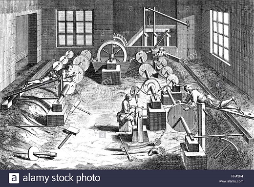

Coming back to Shotley: I've been considering the issue of a three-wheel grinding machine, inasmuch as I cannot find any evidence that they brought one with them; the declaration cited in the Charter by Sir Stephen Evance only states that they used such a machine in Solingen - not that they brought one with them. However, let's be realistic here: even if they didn't bring one with them, and it seems reasonable to suppose such an enterprise was impractical, they would certainly not be at a loss to manufacture one in Shotley Bridge once they got settled. So, the top and bottom of it all is that they could have produced innumerable hollow blade short-swords, if that was what was demanded.
But! The three original smiths who arrived in SB in 1685 had to be supplemented by an additional nineteen families two years later; so if the first three had no experience of the specialist grinding machine - which is not unlikely, considering they had been in England since the Hounslow days - then the new arrivals certainly did. Yet bringing nineteen families and no grinding machine indicates that the original enterprise of producing hollow blade short-swords was abandoned almost immediately as a result of the inevitable enormous demand for military blades.

Do you realize you used a very interesting phrase above...Delve ! This is old German...to dig!! and I believe the German miners who came to England at the time were the ones initially digging at one site...They must have named it after the German word. In Delves Lane. About 5 miles from Shotley Bridge.. at Consett the nearest town.
From one of your pdfs~
Of course, the steel had to be of the highest quality, and certainly the swordsmiths would try to ensure this, by overseeing the various processes rigorously. In the beginning the Germans seem personally to have sought out and extracted the ore from sites along the Derwent and in
the surrounding countryside. One area where they almost certainly dug (or delved) was later known as the Delfts; later still this gave rise to the name of the road leading to the site (now part of Consett) - Delves Lane, at that time of course open land. Local lore also said there was a seam near Hownes Gill, known as the German Bands Seam, worked by the Oleys.ll.

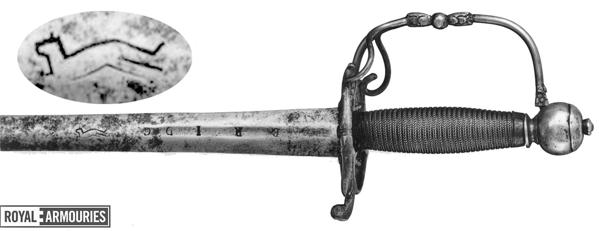

From the Royal Armouries in Leeds[IMG]
Old 1st October 2017, 08:55 PM   #76
urbanspaceman
Join Date: Sep 2017
Posts: 736
Default ps
Note the orientation of the image on the blade.

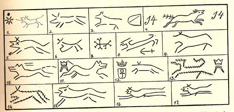

Default comparisons
[IMG]
One of the above is definitely number 11 but minus the crown, and that's a variation on the wolf right? Not a fox.
I'm suspicious of the Hunting Hanger as it doesn't say Shotley or Bridge, and the animal looks more like a lion; I wonder if the RA have got it wrong and it's not an SB blade?

Keith, that is excellent....the orientation of the fox in the second image, which surprisingly a 'fox' NOT the running wolf of German character. If this can indeed be proven SHOTLEY, then this would dispel the idea that the fox simile of Birmingham never occurred there.
The other Shotley blades are clearly marked to that place along with the German running wolf.
This hanger with running fox is curiously similar to the Birmingham use of that image, which as I described earlier, in my opinion was quite plausibly a keenly placed simile of the British fox used in the manner of the famed running wolf of Germany.
As I mentioned, in Shakespeare, one instance ( Henry V, Act IV, scene 4; "..thou diest on point of fox". The term was used to describe a well made sword, of course probably Solingen blade rapier.
With Birmingham struggling to regain their market share against the long emplaced German domination, it would seem remarkably clever to use the fox in place of the highly esteemed German running wolf, and in its character.
I came across another case of these markings, surprisingly in an American hanger c. 1755-83, in Neumann p.88, 81.S ("Swords and Blades of the American Revolution", 1973). The blade seems clearly of the German form which also became produced in Birmingham c. 1755. It must be remembered of course that America was at this time a British colony, and though the blade is described as German made......it has the running wolf..but on both sides of blade, and with a star.
Germany, as I mentioned, was not as far as I know using the running wolf this late. Further, it was not on both sides of the blade, only on one, and typically latten (brass) filled.
This example has the same fuller as the Birmingham blades, but has been shortened to about 20" from the usual 27". Obviously it has been rehilted with brass guard and antler hilt in British manner.
While I cannot see the mark, whether fox or wolf, the dual application is atypical, as is the star of some type.
We have seen that makers in Birmingham intended to capitalize on the German use of the wolf, and while Harvey's fox is well known, it seems almost certain that other makers may have used variations of either wolf or fox.
That may account for the blade on Keith's sword, which has the canine figure on both sides, however degenerated or poorly applied on one. Also that use of a star MAY have been applied in tandem with the wolf on some blades made by some yet undiscovered maker there.

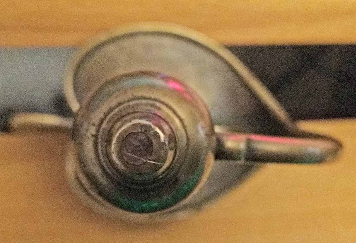

Just to wander off Piste again: is this an indication of a re-hilt?
[IMG]

The chart showing variations with years is from Wagner, "Cut & Thrust Weapons", Prague, 1967. Eduard Wagner was a museum curator, and appears to have compiled these examples from sword blades he had seen or catalogued, but that is just my presumption. There has never been any sort of pattern or consistency to any of these, so chronological development, as implied in the chart, is completely implausible.
It is almost as if the chiseling of the 'wolf' was an imbuement, and its artistic value irrelevant, but temporally observed as perhaps talismanic as much as indicative of quality. Possibly the worker who emplaced the mark felt a certain individual embellishment as a kind of personal touch.
We have seen this in many well known markings, which sometimes have deviations or nuances which might signify different family member or workshop or possibly even a heraldic kind of placement. We can only speculate as we search records, public listings and genealogical data, and evaluate examples on weapons as they are discovered.
I think the Harvey use of the fox was brilliant, and well placed in the history of this canine marking phenomenon, and the lore of swords and blades.

Default Royal Armouries.
I've contacted the Blades Curator at the Royal Armouries in Leeds to enquire into the provenance of that hunting hanger with the curious fox stamp (post 75). It's listed as Shotley Bridge and I would be fairly surprised if they have got it wrong, but it's not beyond the bounds of possibilities. Just waiting to hear back from him. It's such a singular image that it may well be a one-off created for the occasion. Waiting patiently.

Salaams Kieth, The trouble with this animal is that it does not resemble a stick drawn wolf nor does it look like a fox... I wonder if it is a copy of the running fox mark done by who knows? We wait to see.

Hello Ibrahiim. Yes, indeed, my thought exactly. The first thing to confirm is that it is a Shotley blade; assuming it is, then our imaginations can run amok, because - unless there is a known history - it could amount to anything. Someone went to some trouble to engrave that image though; it's not your Neanderthal stick drawing is it?
I am also looking into other marks used by the SB smiths because I can't imagine that if they were turning out the numbers of blades thus far indicated for the military, that they would be bothered chiselling Shotle Bridg et al on every blade when a tang stamp would suffice.
I'm also beginning to wonder if they ever used the Passau wolf/fox at all, or if the unfinished blades came out of Solingen already marked. How much work is done on an unfinished blade? Would it remove the marking?

Keith , I'm glad you are contacting the RA as I would really like to hear their explanation on this one. I think you're right, there is no way they could have put out significant volume of blades and stamping or engraving all of them.
As it is, it seems only a select number of blades were so marked, and as you point out, could they have been already forged and stamped in Solingen prior to export?
In the top sword in #75, this is a Walloon type sword as thought to have been from Shotley Bridge in latter years of 17th c.
The 'wolf' seems in the proper orientation in the blade center, and the somewhat irregularly stamped letters for Shotley Bridg placed as they arrived in Newcastle. It seems that the running wolf in Solingen was always upside down, and typically in latten (brass filled) .
The second sword looks to be a hanger of mid 18th c. which of course aligns with the Birmingham works and Samuel Harvey's use of the fox. While this rendering looks atypical to the other known examples of Harvey's, it is known Dawes (perhaps others) might have also applied fox marks.
If this example could be irrefutably provenanced to Shotley Bridge it would be monumental as in my view, the fox was used by Birmingham to in effect mimic the German running wolf, in the 1750s. So why would German smiths in Shotley use a fox on a hanger blade? and when they were presumably fashioning blades for small swords? In fact, it is a puzzle why the only reference found to Shotley sword cutlers is in Aylward (1945) in the list he shows which transcends 18th c. to 1808, with about 10 names.
Possibly more will be found in Southwick, or Annis & May, both volumes listing sword makers, but cant get to my copies for a month.

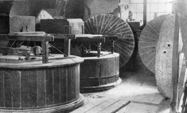

Salaams Jim and Keith, Slightly to one side ...That odd grindstone that I was tod was leaning against a wall on the river...I never found it. but...have a look at these .... what are they....? They are from the Shotley Mill shown. look at the striatians in the stone grinder faces....
Old 5th October 2017, 07:13 PM   #87
they are millstones for grain, the striations are grooves to allow the milled flour to work it's way out and fall down into a large funnel and then into the flour sacks underneath. the cylindrical wooden structures surround the stone and have an opening for adding the grain into the centre of the upper millstone which is adjusted in distance from the lower one depending on how fine the miller wants the flour. bit like a huge coffee grinder. the stones would wear and require regrooving , the propped up ones were likely spares. after they are too thin to reuse, they get sold to architectural salvage junkyards who resell them to trendy yuppies for inclusion as features in their homes and/or gardens.
see https://www.youtube.com/watch?v=hC-wzAML-oY
and https://www.youtube.com/watch?v=jBEagbZxc6Y
solingen knife/sword makers used a vertically mounted stone. no occupational health and safety laws back then:
Old 5th October 2017, 07:41 PM   #88
Posts: 10,867
Hey Wayne! thank you for joining us here on this, and especially for the great insight on these huge wheels. In many of the references I have checked, the mills were converted from grist mills for corn and perhaps others.
Could these same wheels be used for the functions required in metal work, or are the surfaces changed in some way?
This might explain the accessibility of wheels for the makers.
Old 5th October 2017, 07:45 PM   #89
see my updates above. much different stones driven at higher rotational speeds... the water driven mill wheel of course could be a power source for a variety of blacksmiting tools, grinders, drop hammers, bellows, etc. lots of open belting and gearing to grab the unwary.
Old 5th October 2017, 07:57 PM   #90
Ibrahiim al Balooshi
Ibrahiim al Balooshi's Avatar
Join Date: Jul 2006
Posts: 4,408
Thank you for the excellent detail in your reply... I was just looking at a French sword factory and the English Reeves factory and realised the same ... The grindstone outside next to the river I was told about must have been a grain grinder and was adjacent the grain mills. I place a more ancient water wheel driven wheel arrangement for interest. Many thanks.
